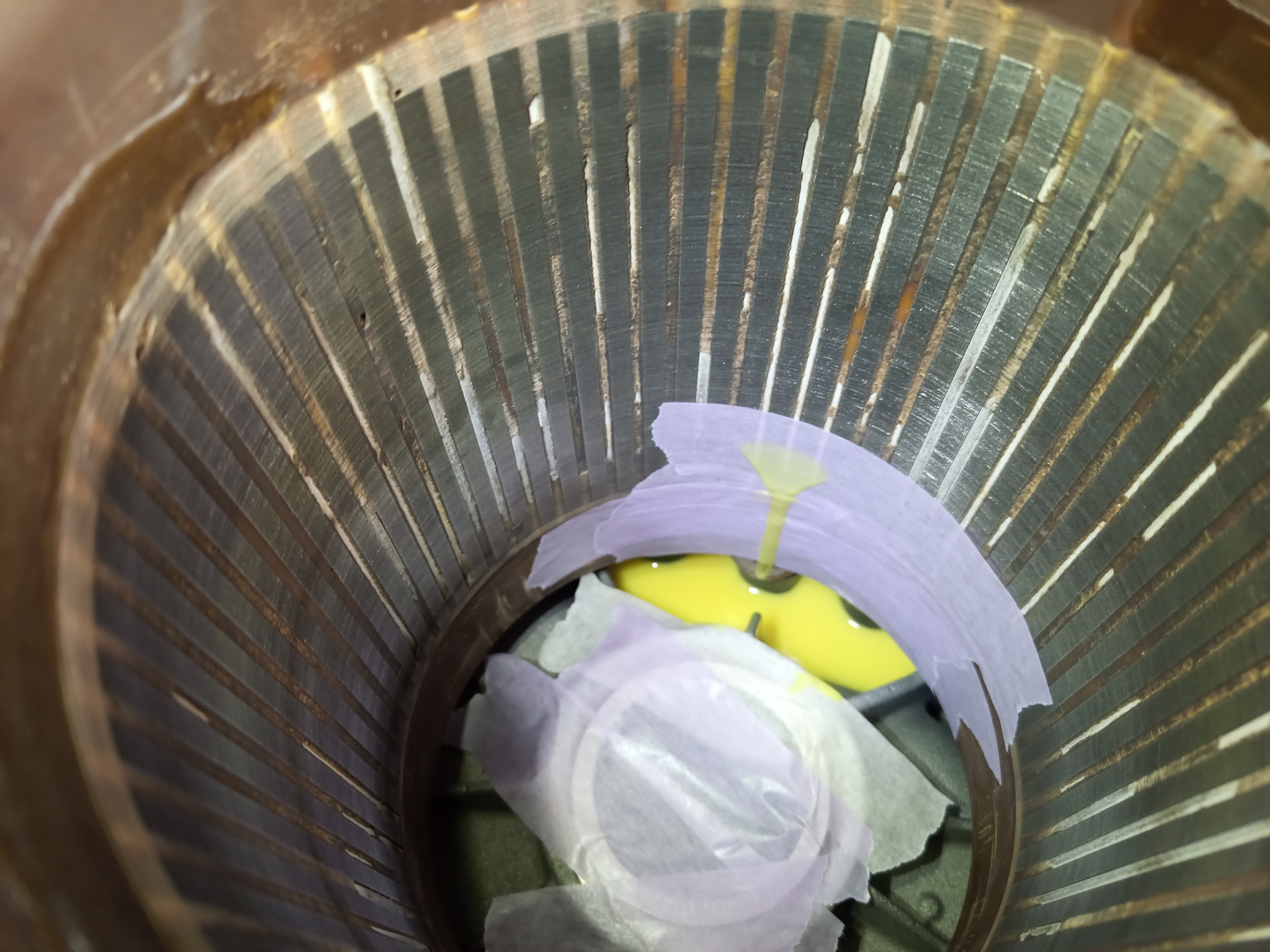

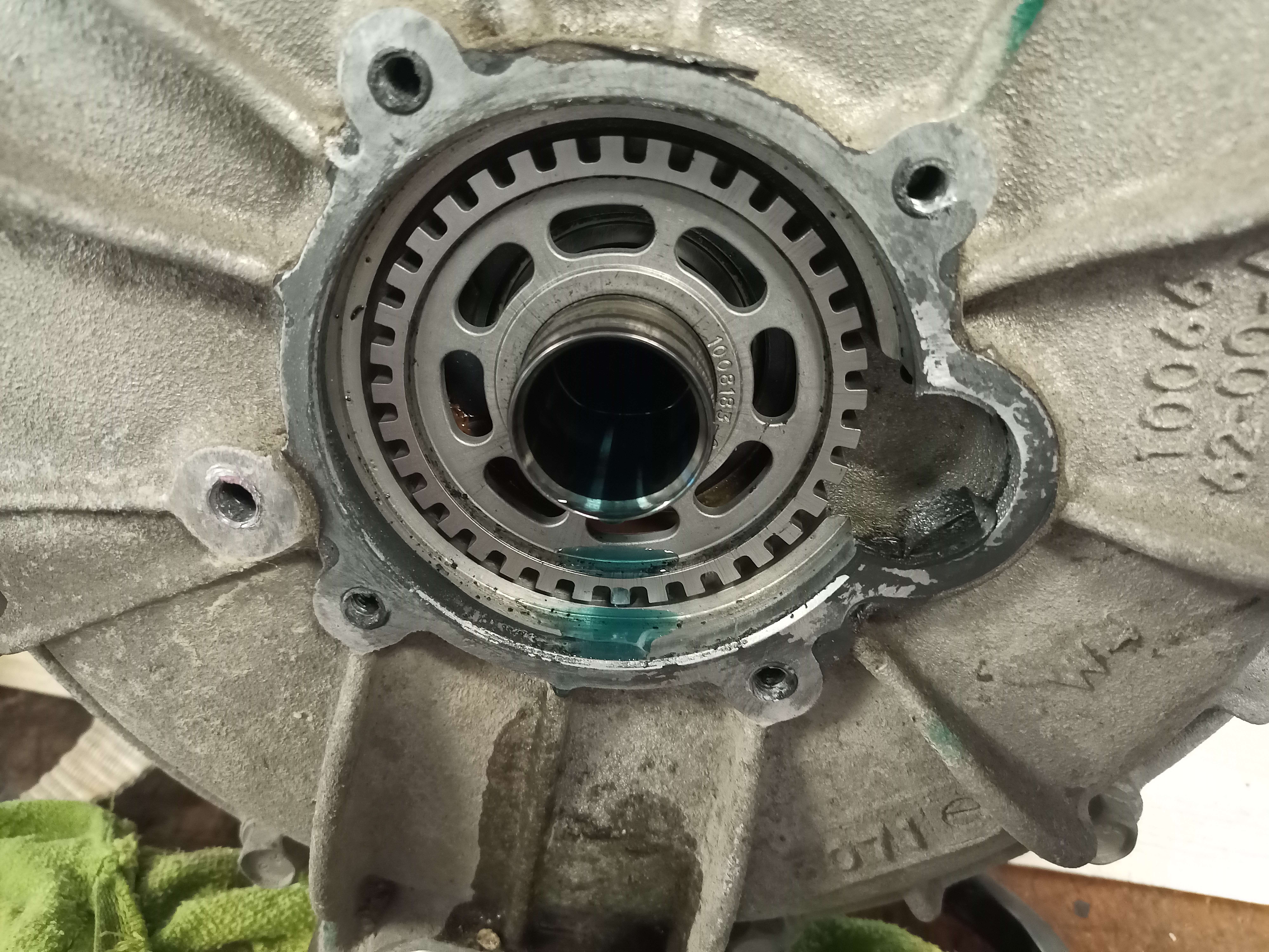

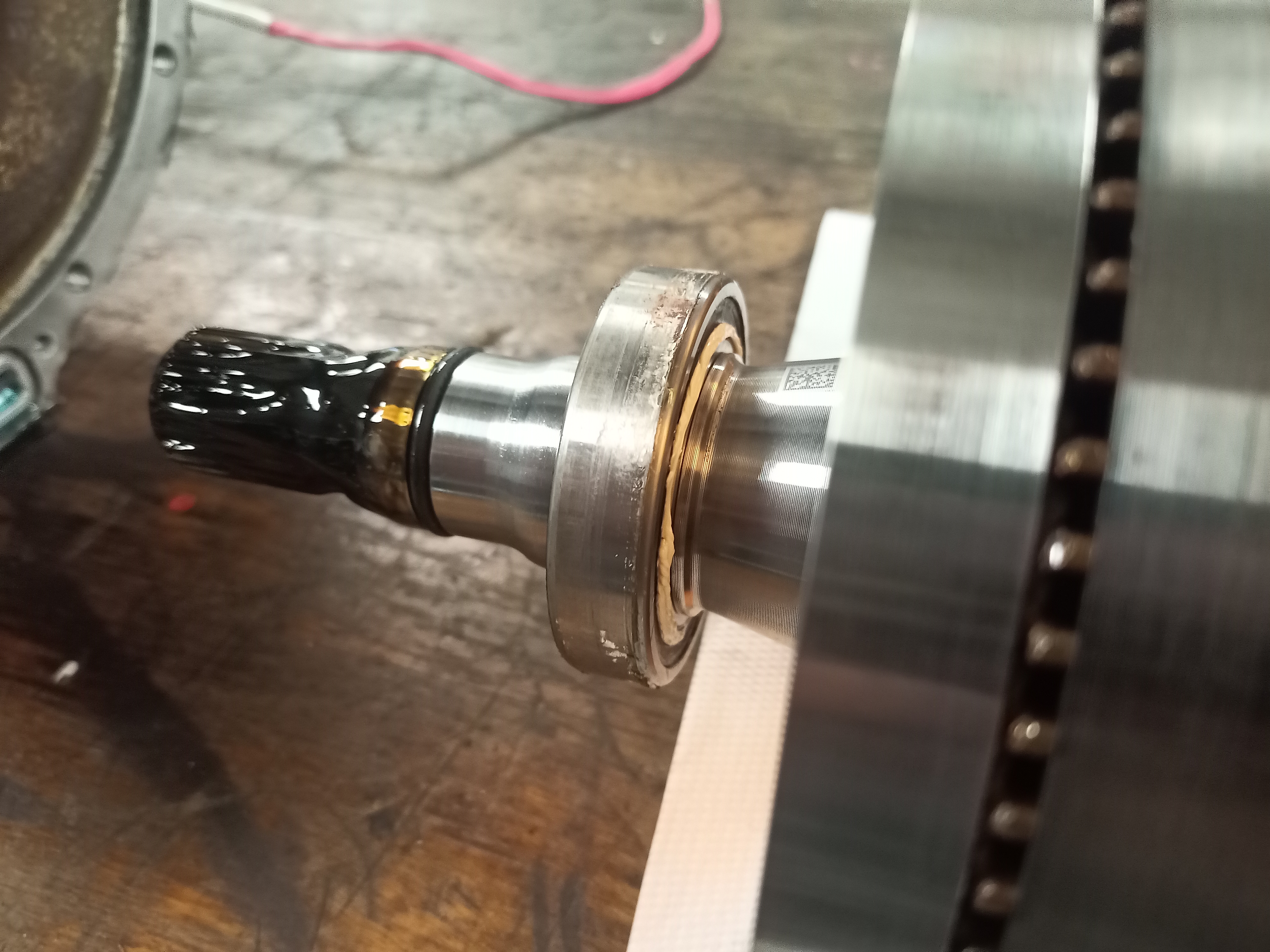

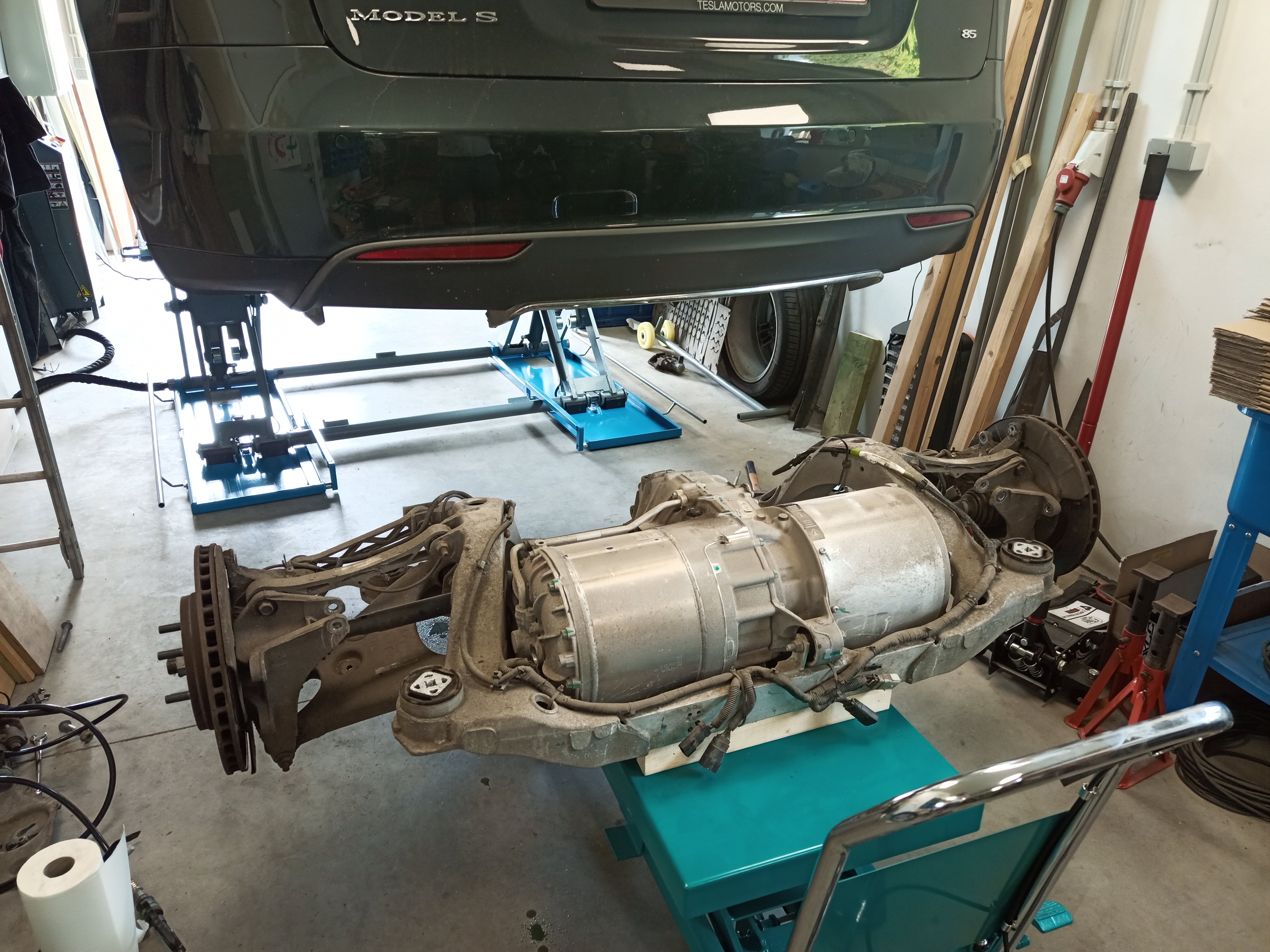

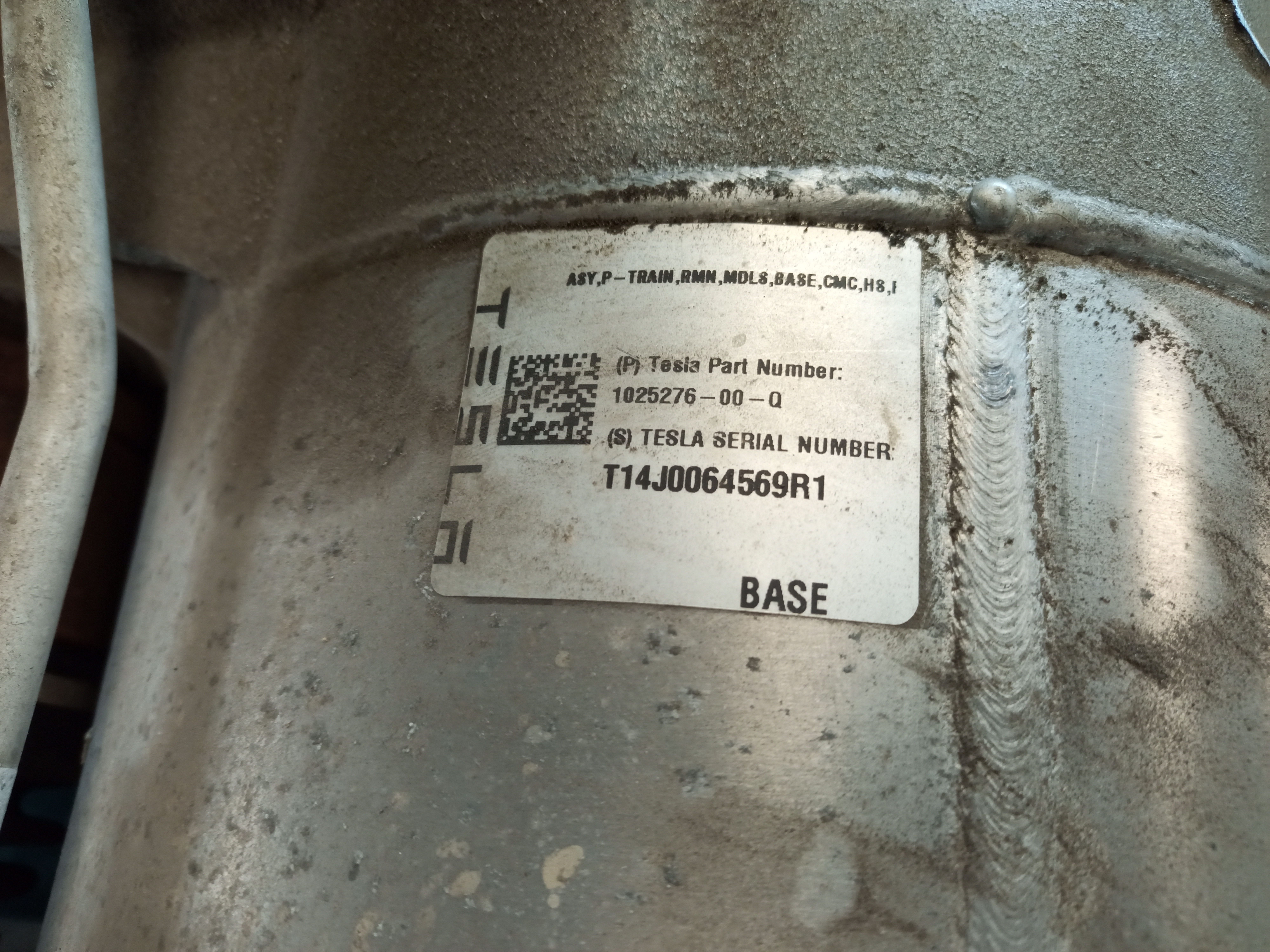

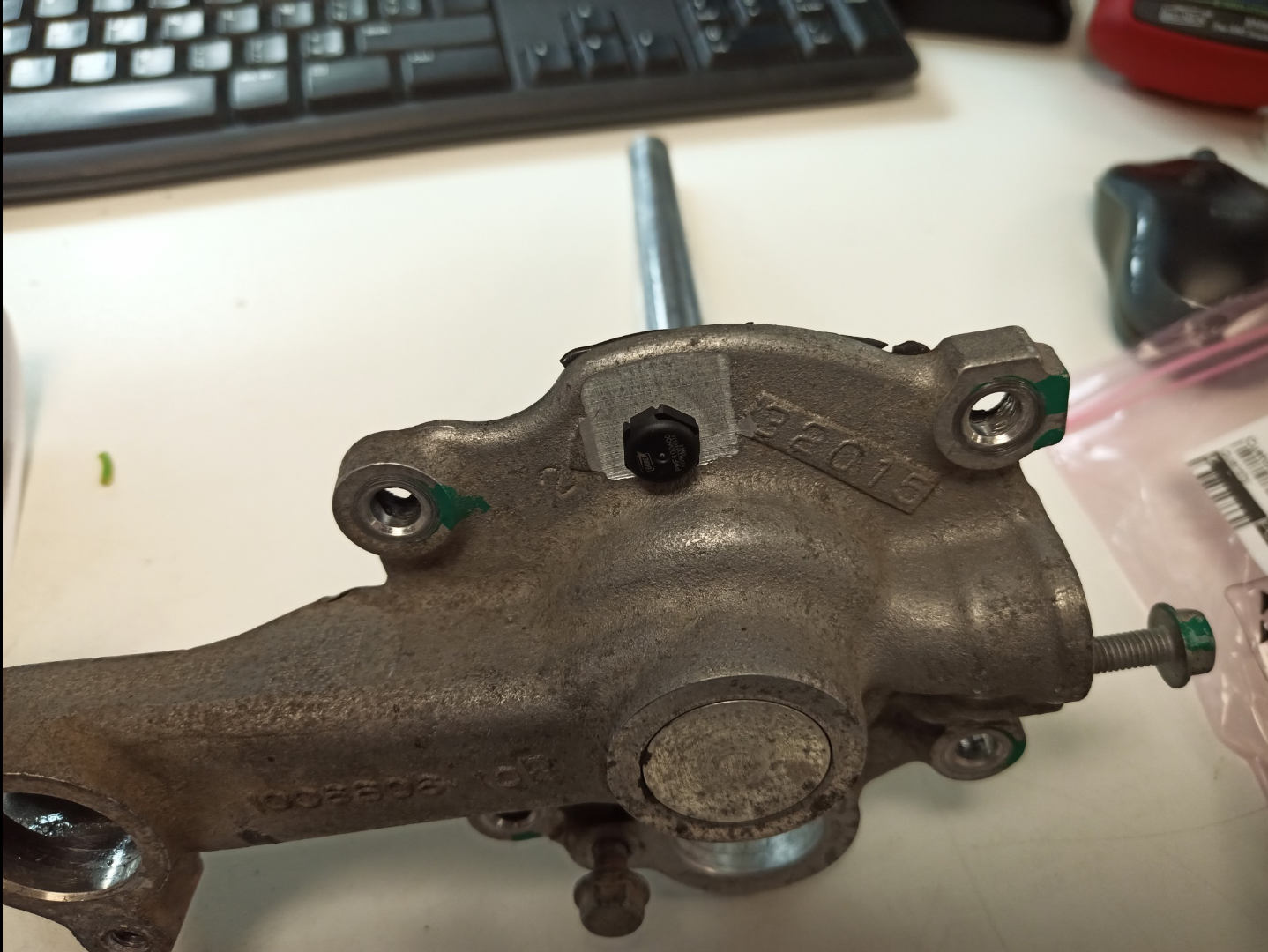

I took apart mine yesterday. Bought the car in the beginning of this year, checked the speed sensor and noticed some condensation. Had no time to do the repair until now, so kept driving. Still drives fine without bearing noice or errors.
The drive unit is a rev Q. Replaced under warranty in 2017 at 70.000 km. The car has 145.000 km at the moment.
Although i've driven at least 10 months with a small leak, the DU is perfectly clean and dry (besides some coolant drops around the seal.
The seal surface on the rotor is pretty rough. Maybe it wasn't in great condition when the DU was remanufactured?
The grease of the rotor bearings is at the outside of the seals. They are perfectly clean and dry, so it's not washed out by coolant.
I'm going to use a speedi sleeve, Ceimin seal and new bearings. Potting the phase wire tunnel and add a few vents and drains.

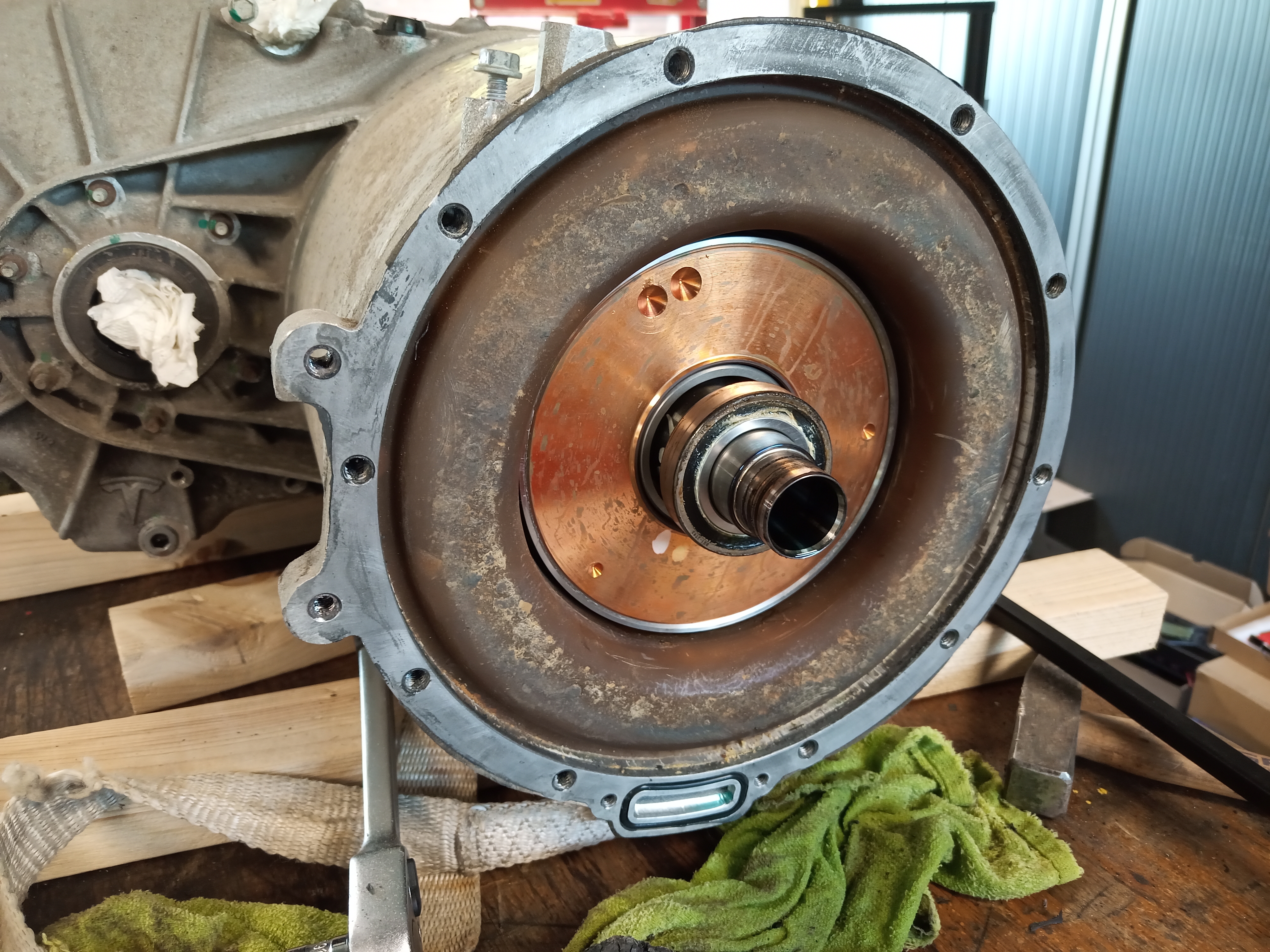

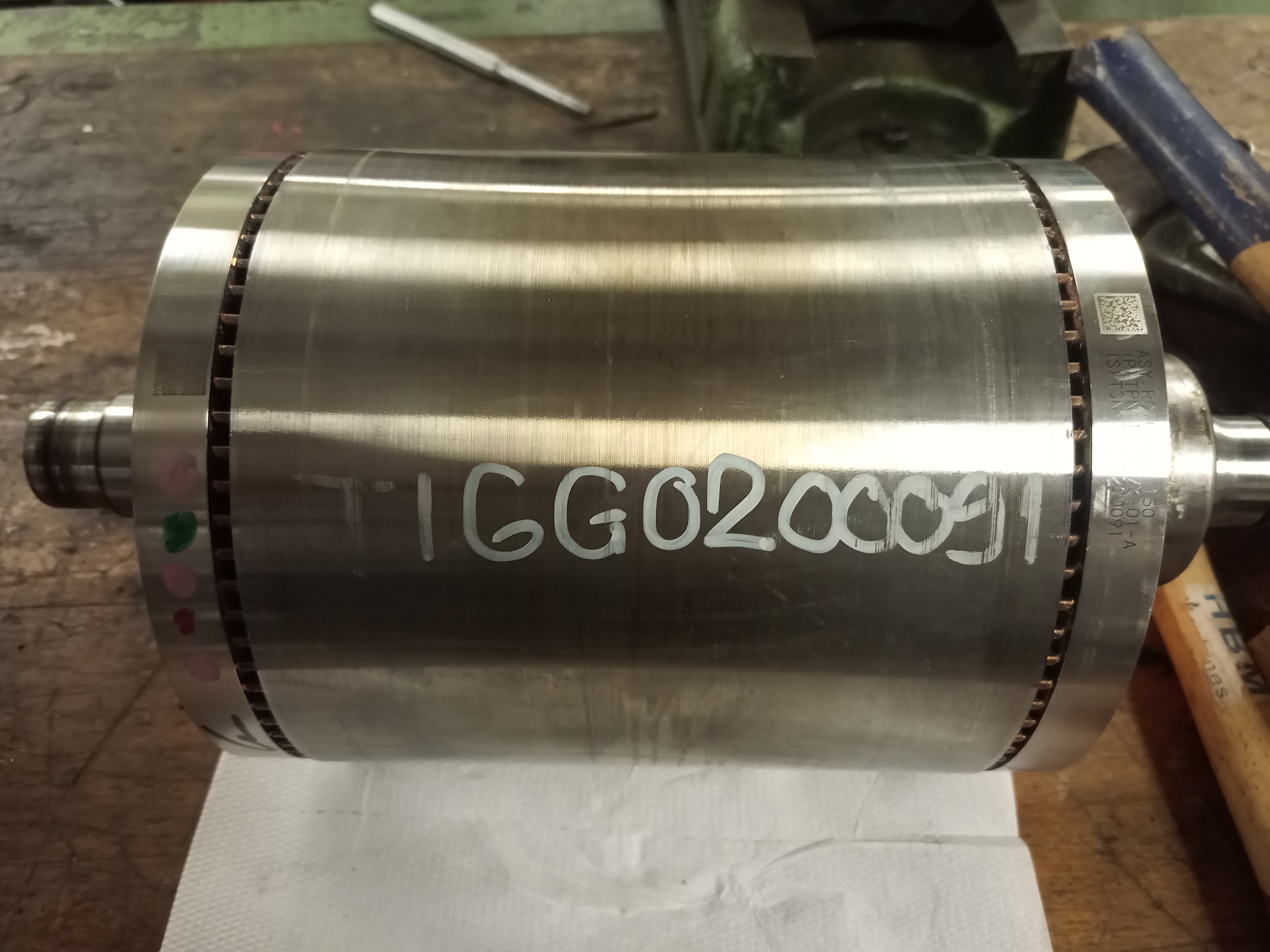

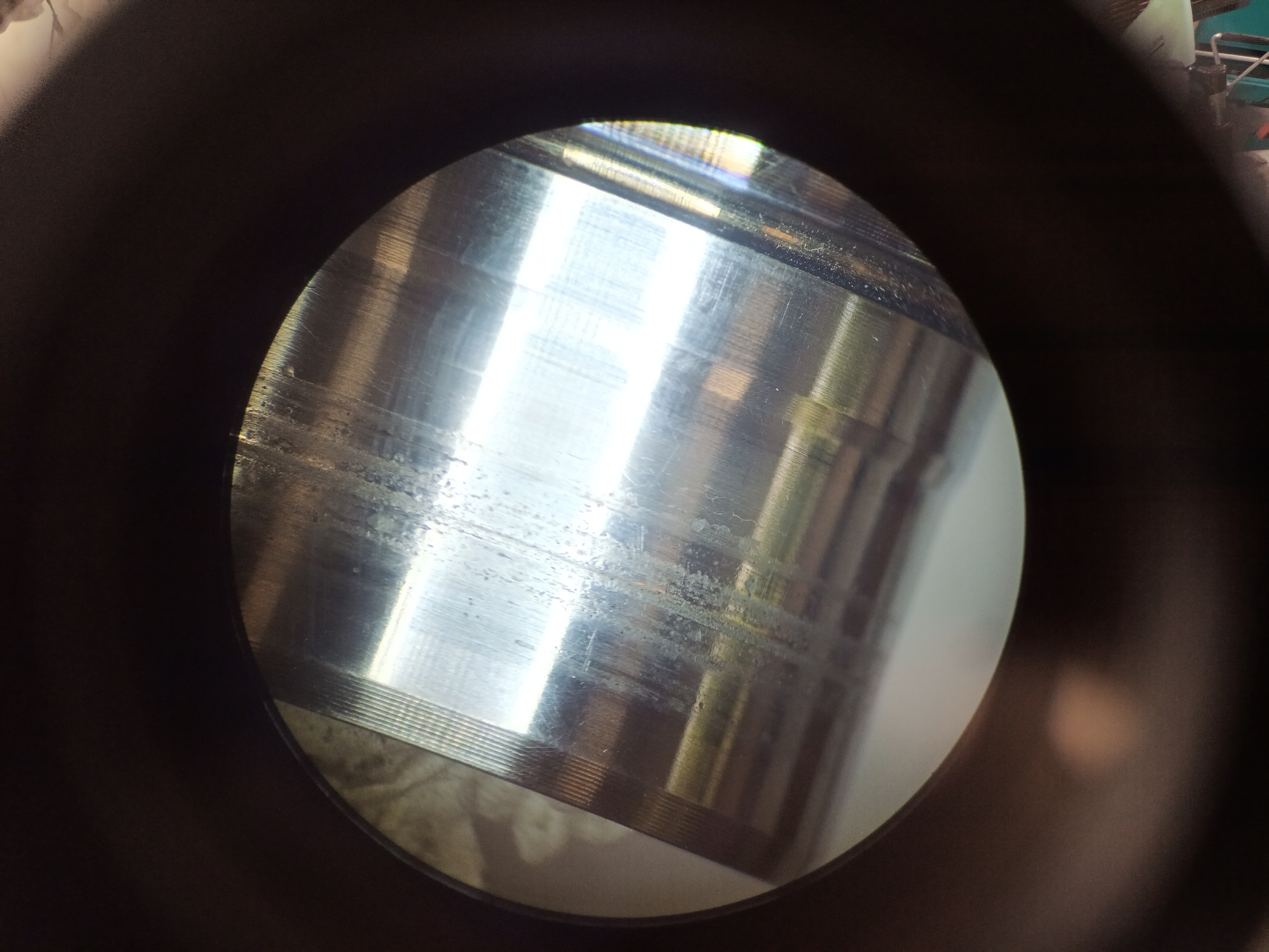

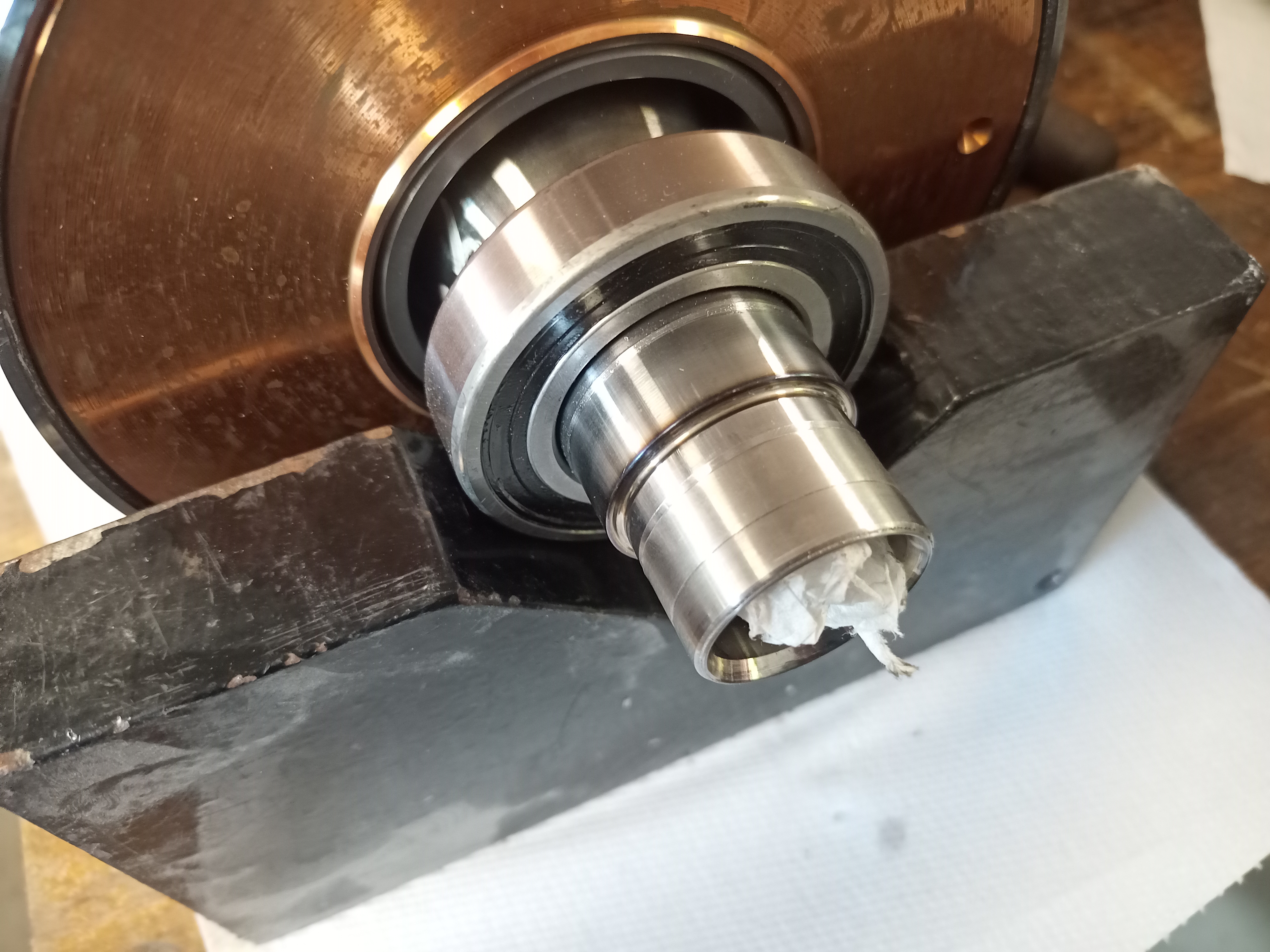

A few photo's of the rotor before and after cleaning and the seal.
The rotor has way to much wear to use without sleeve or welding and grinding.
The seal is a tripple lip. It's disintegrated pretty bad. Maybe the rotor already was rough when they rebuild it? I'm suprised there wasn't more leaked coolant.

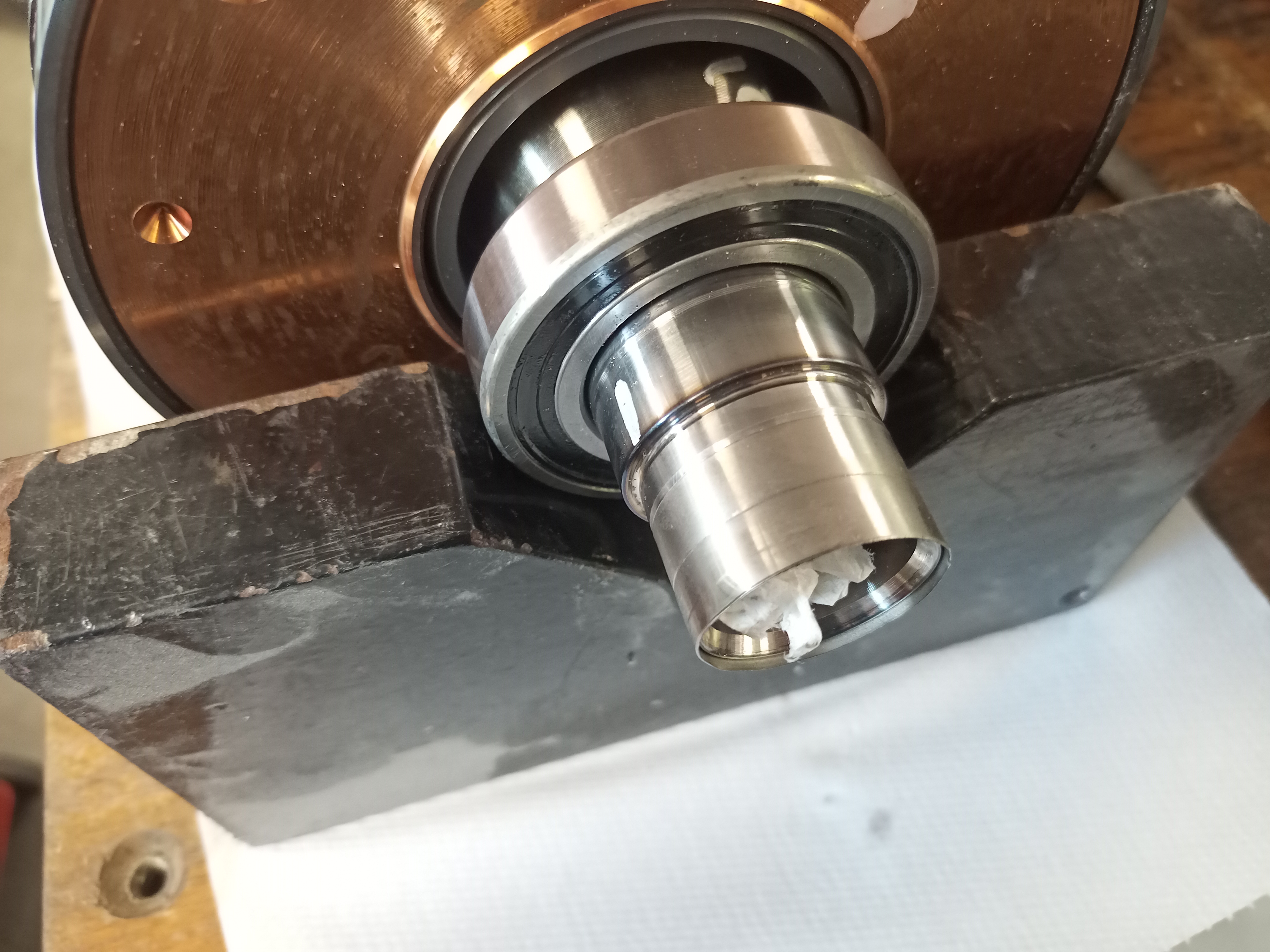

Fresh bearings and two sleeves fitted. The sleeve is grinded flush with the rotor.

WimV wrote: Sat Oct 01, 2022 11:33 am I'll try to make a good picture, but all of them looked pretty bad.
The phase tunnel is potted.

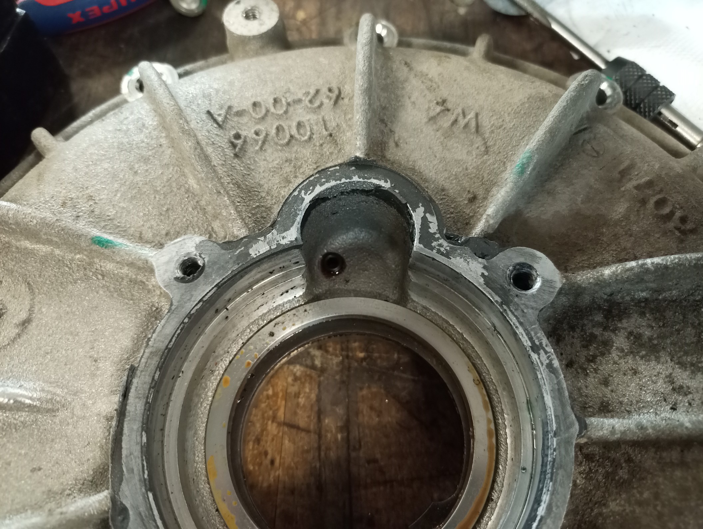

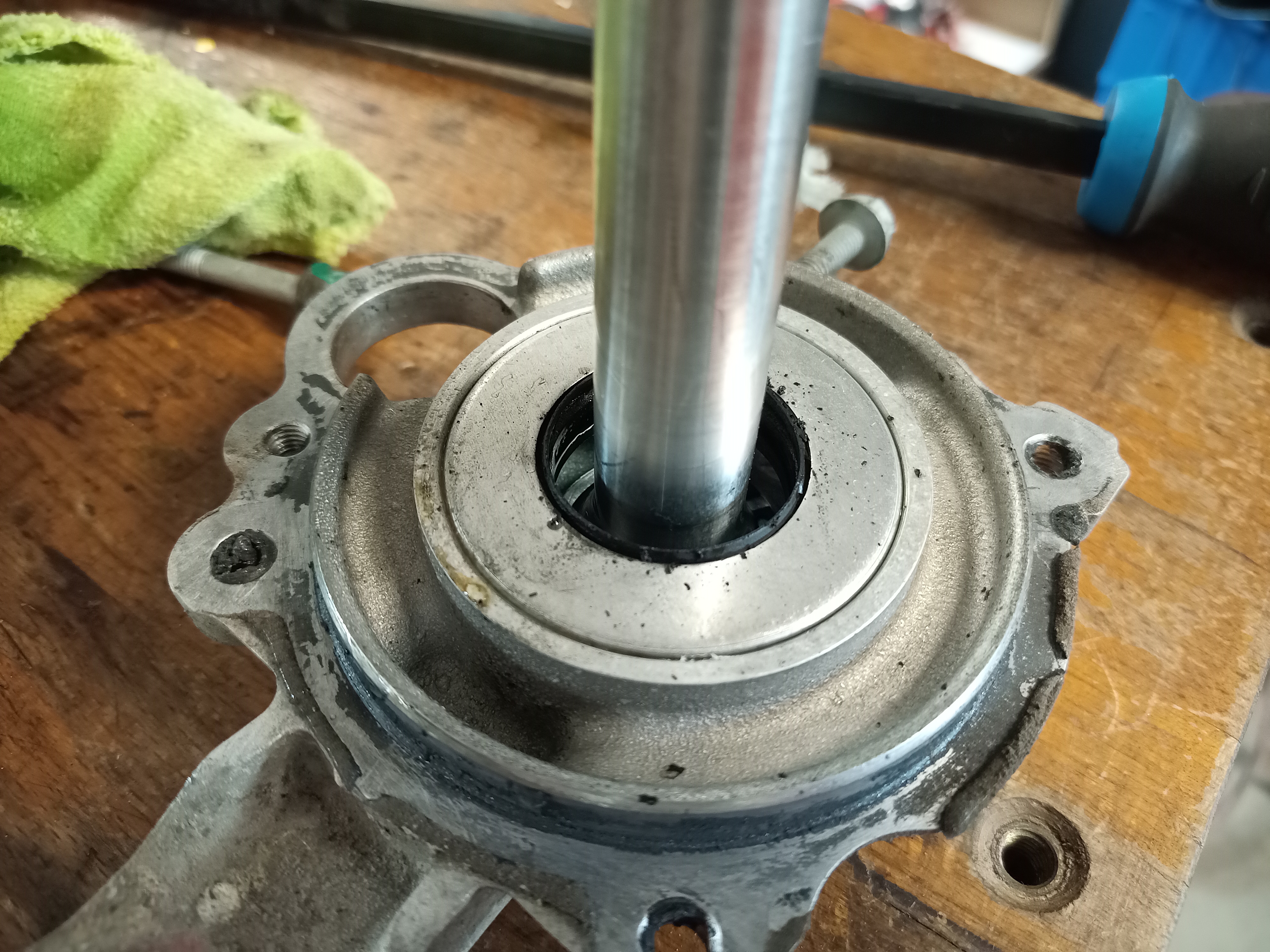

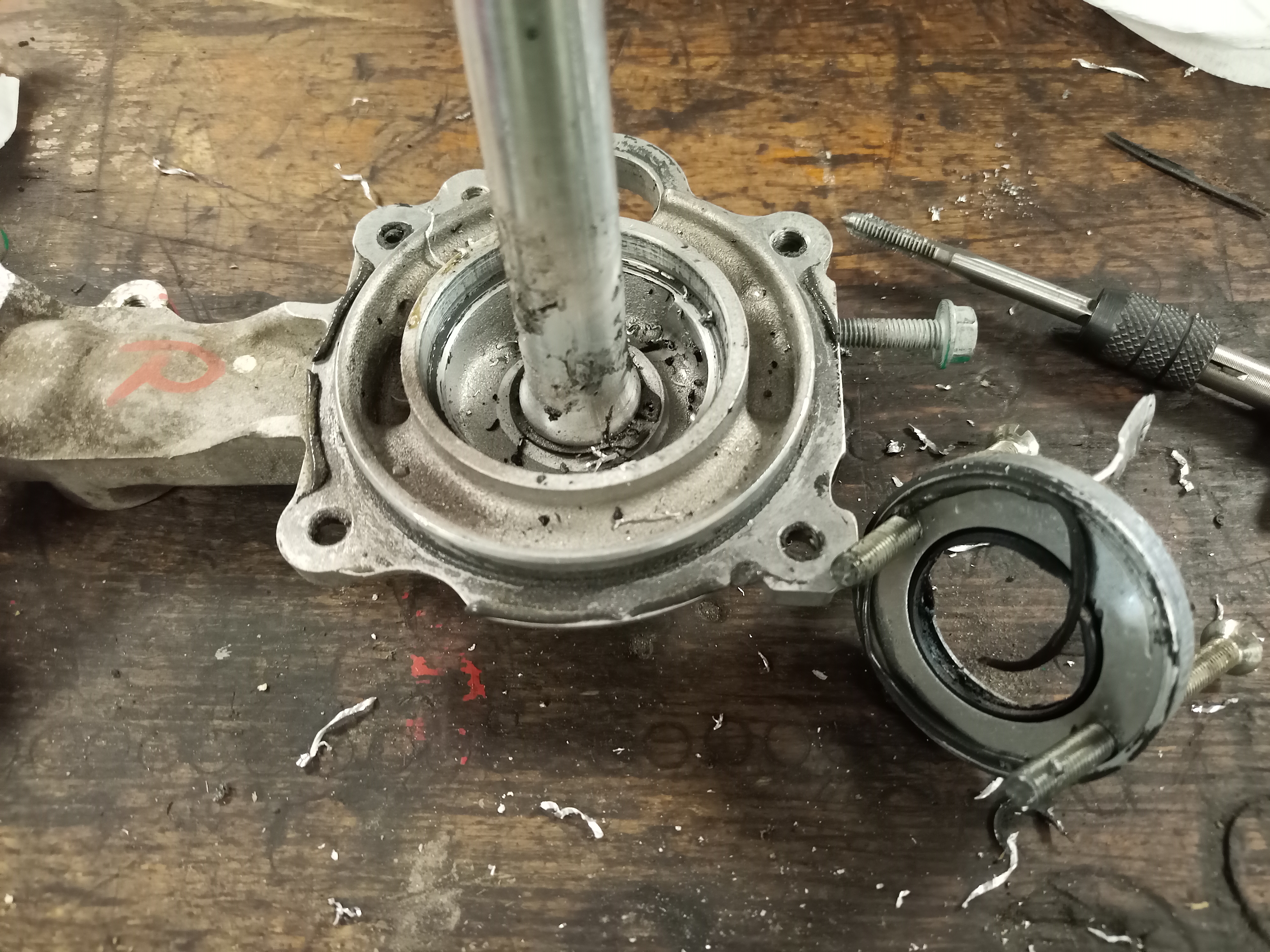

I just removed the seal. Started cutting it, but then I noticed the steel was pretty thic. Tapped two holes in it and pushed it out with two bolts. Works perfectly, seal is removed within 5 minutes.
The lip at coolant side was, as expected in best shape. Other two rings were very worn and had a lot of black sticky mess on them (probably ptfe dust mixed with coolant).

Post by WimV »

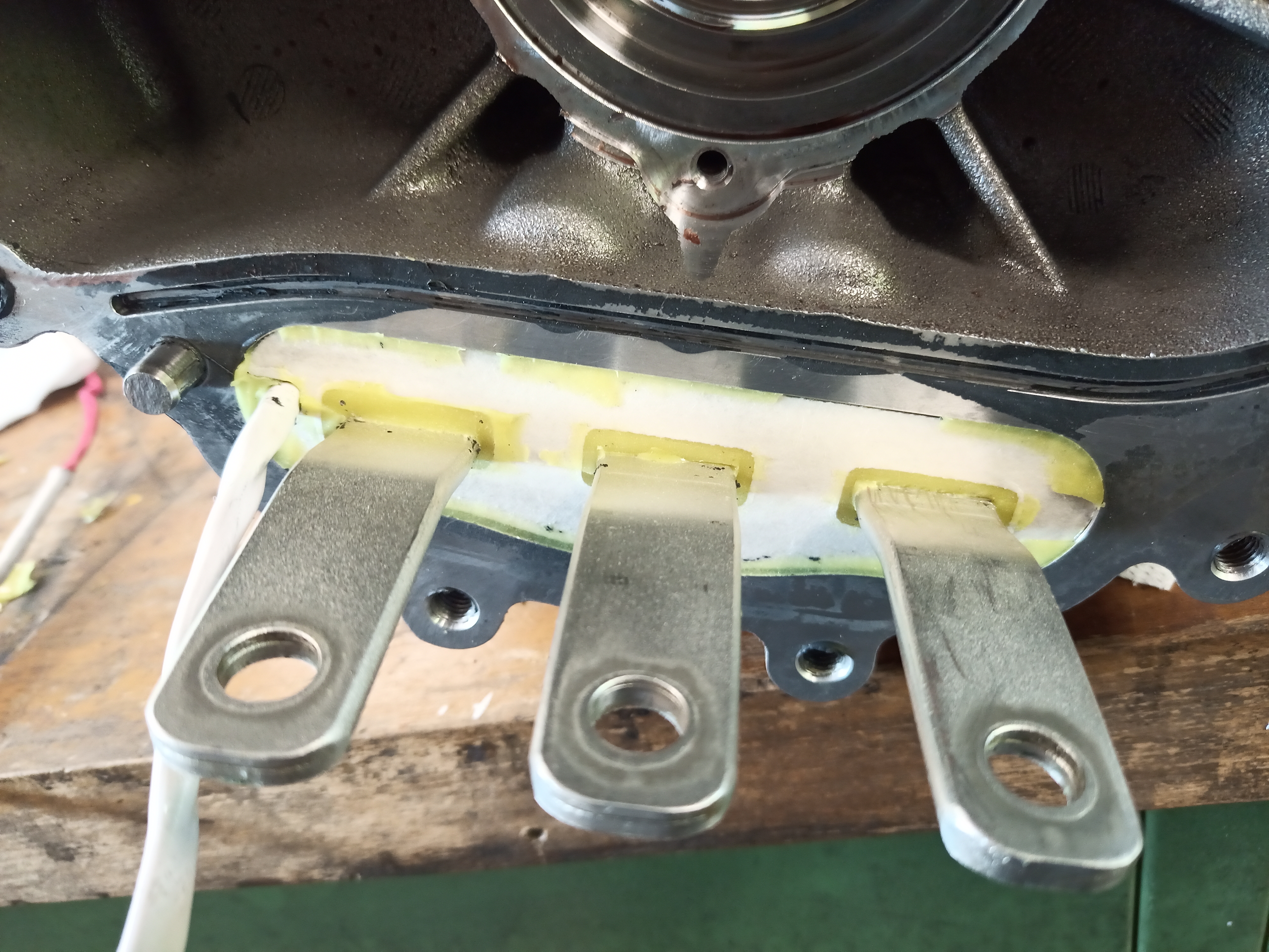

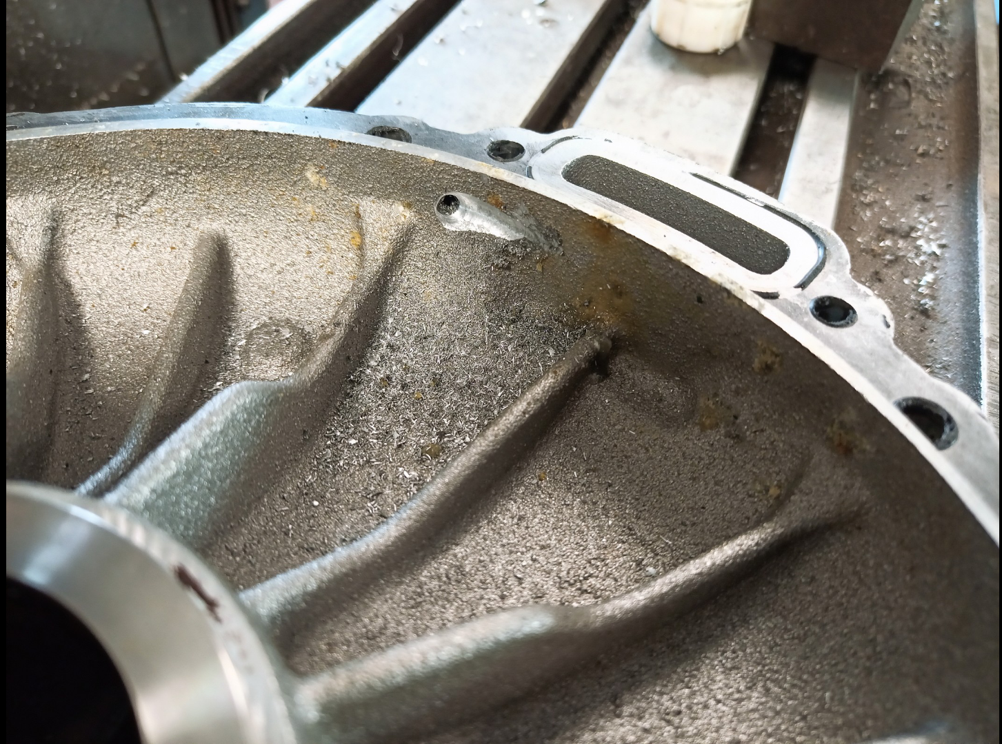

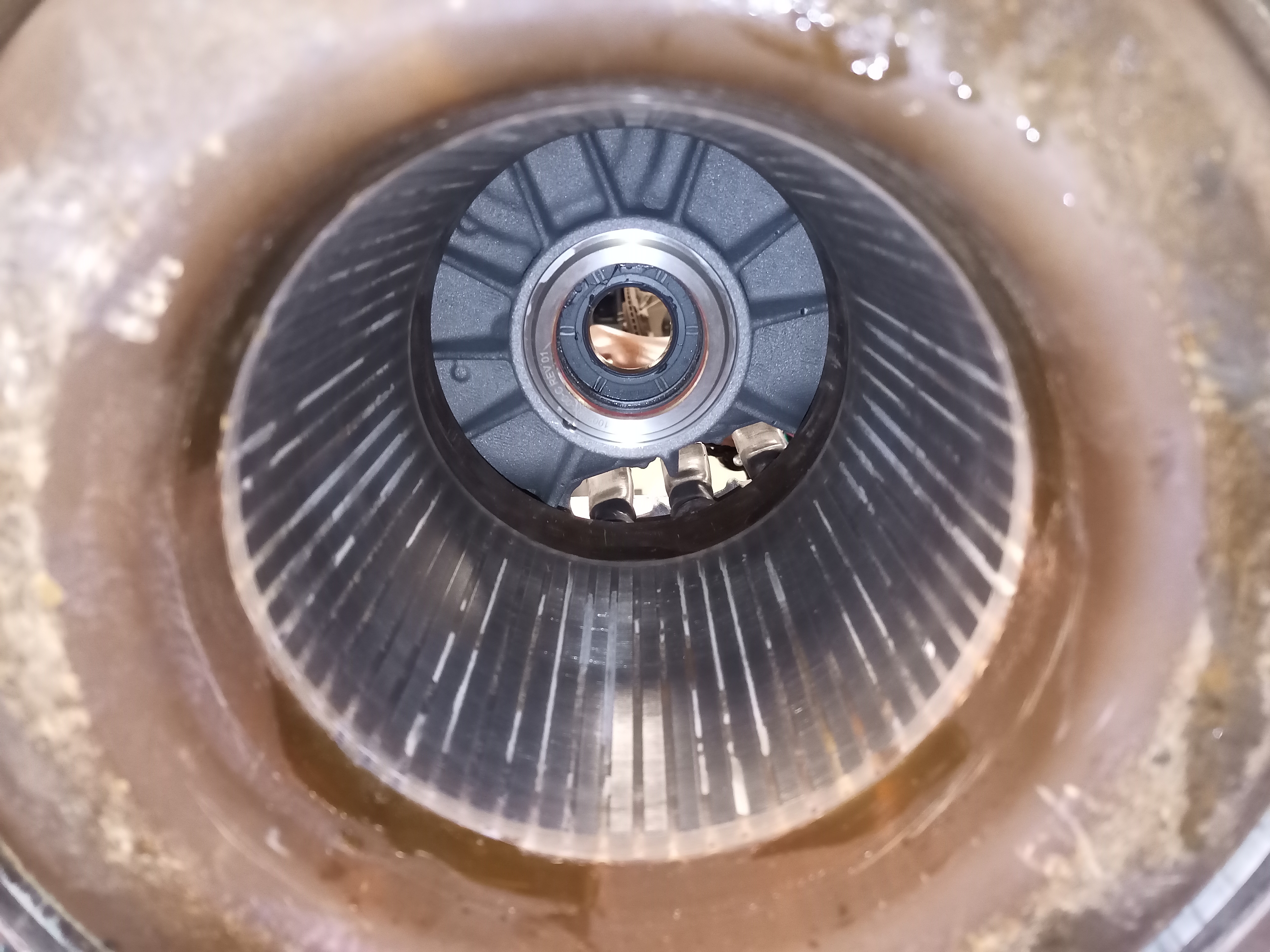

Plugged the hole between reluctor wheel and stator, added vents and drains to reluctor housing and stator housing.
Now cleaning everything and reassemble (and adding a drain to inverter housing).

Post by WimV »

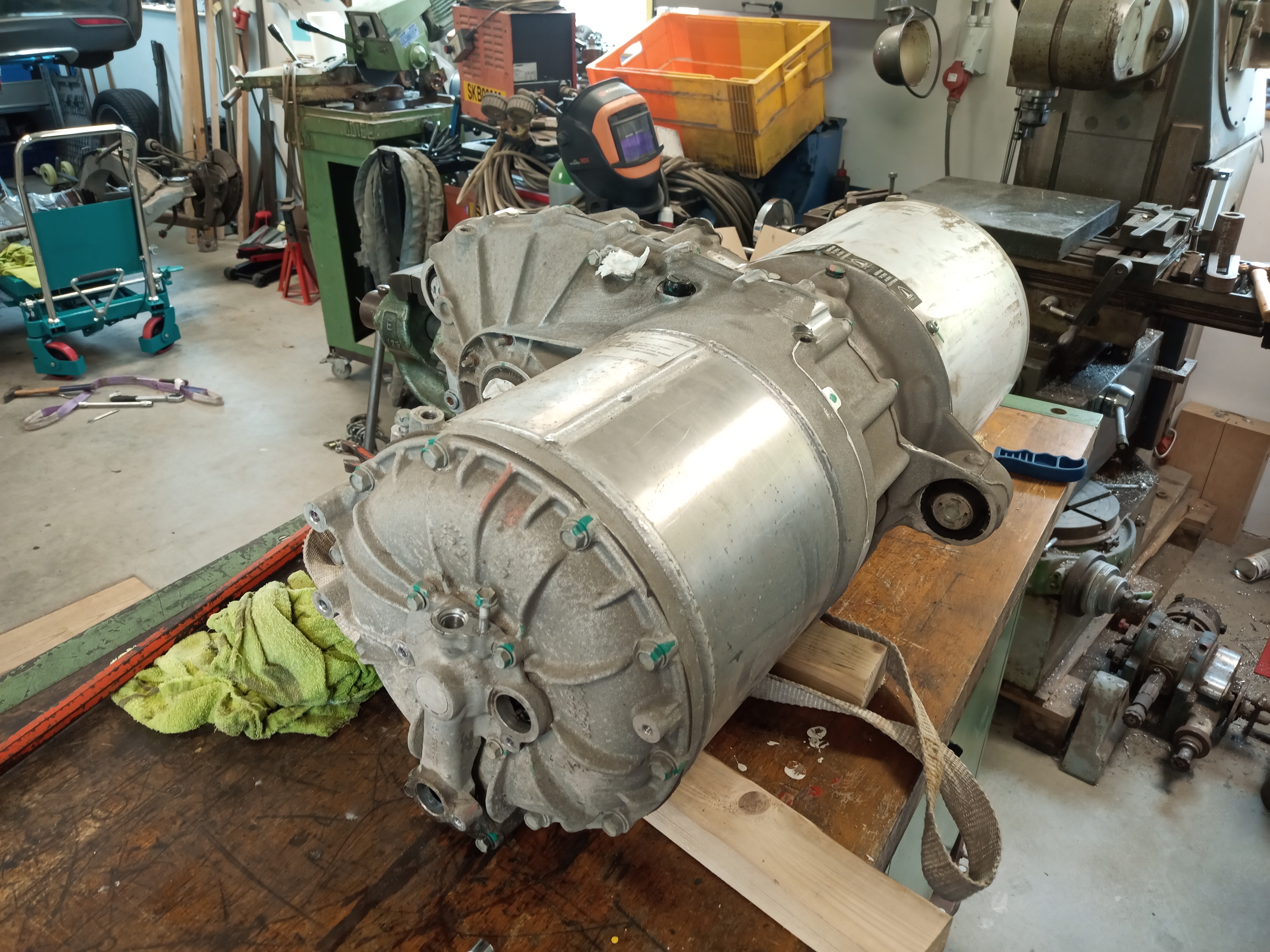

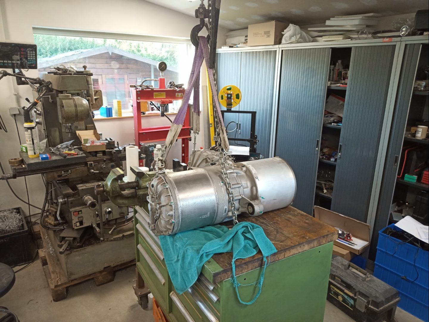

I used a wiring harness sleeve to pull the temp sensor wires through the tunnel, worked very well.
The motor is assembled. Going to put it in the subframe now.
How do you guys purge the cooling system? Is it necessary to fill the motor before connecting the cooling system in the car? Or will it purge itself while driving?
