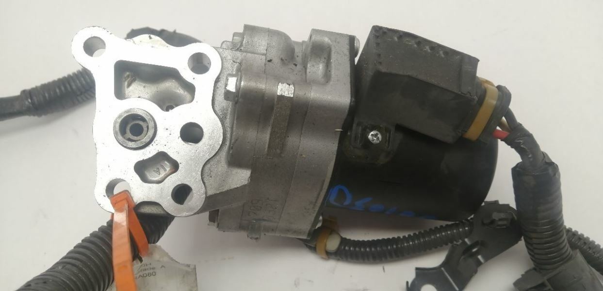

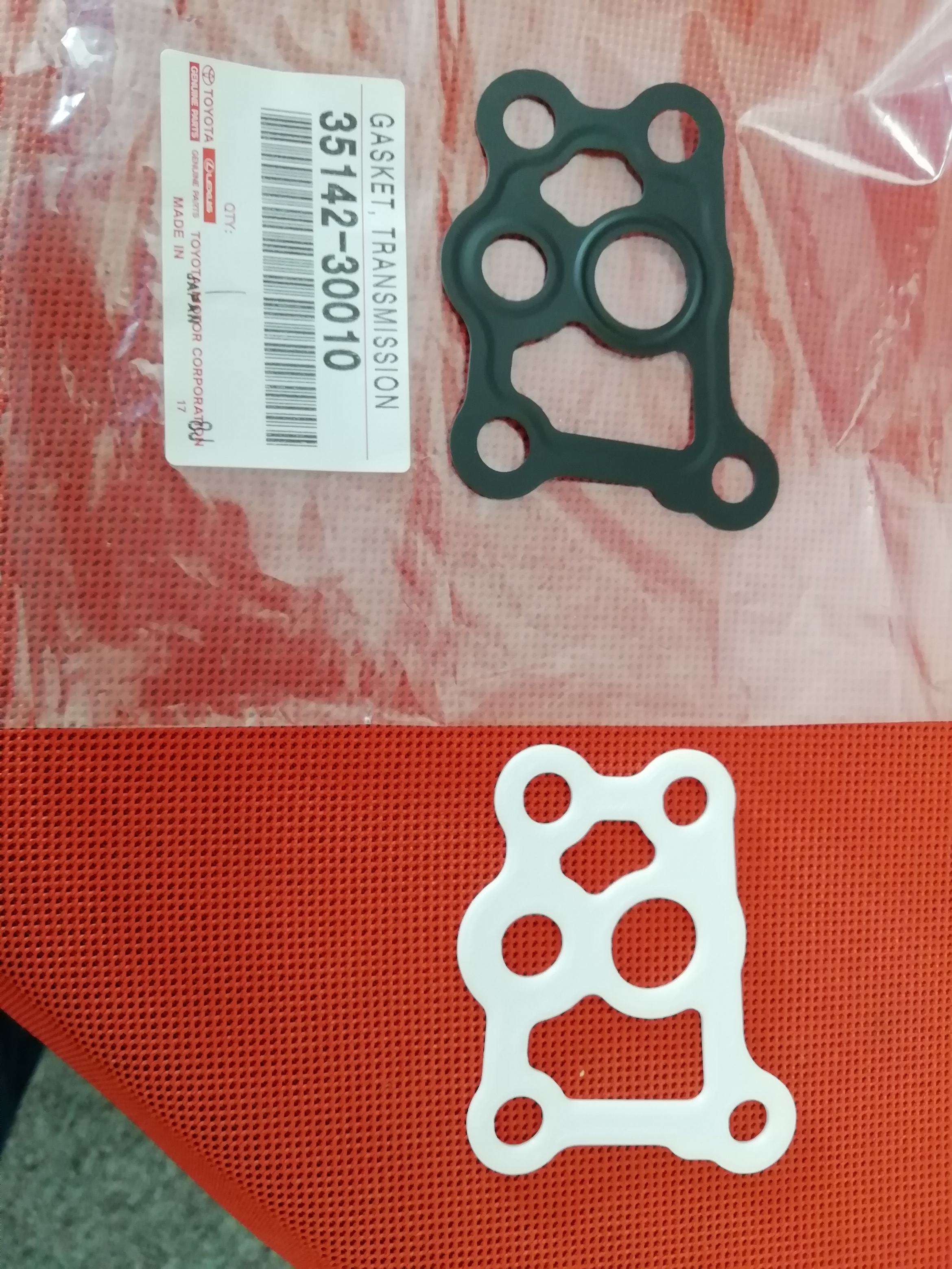

If it helps I've (hopefully) attached some CAD of the oil pump gasket face. BMW use a pump on their auto gearboxes that might be suitable P/N 7834496 from what I can determine this should be fine with the temperature , pressure and type of oil but I haven't found anything about controlling it. They are expensive new - about £450 but are available cheaply second hand. I've got one ordered and will report what if anything i can work out plus CAD of the mounting face when I get some spare time.

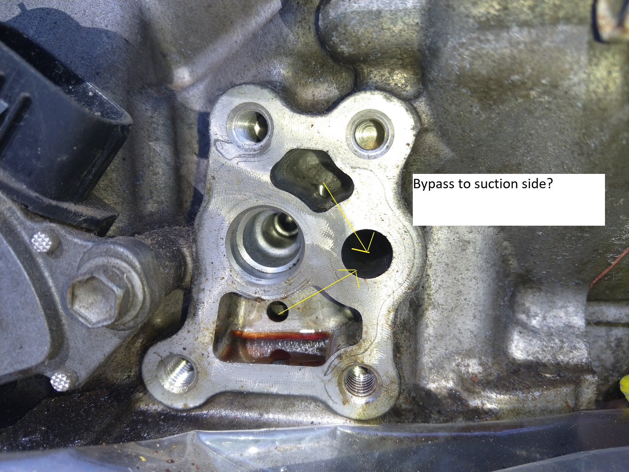

I recently acquired a transmission without a pump and figured it would be a good opportunity to machine an adapter plate for an alternate. My guess is that the left port is the pressure side and the smaller is the suction.
Is it safe to assume that a couple crossover ports need to be made from these two pockets to the suction side?
Since I don't have a pump in my hands I can't tell exactly but it looks like the smaller odd shaped port on the pump goes to nowhere.
The BMW pump looks pretty strait forward to mount but I am also considering a remote pump with a line set to the adapter plate.
Thanks for any insight.

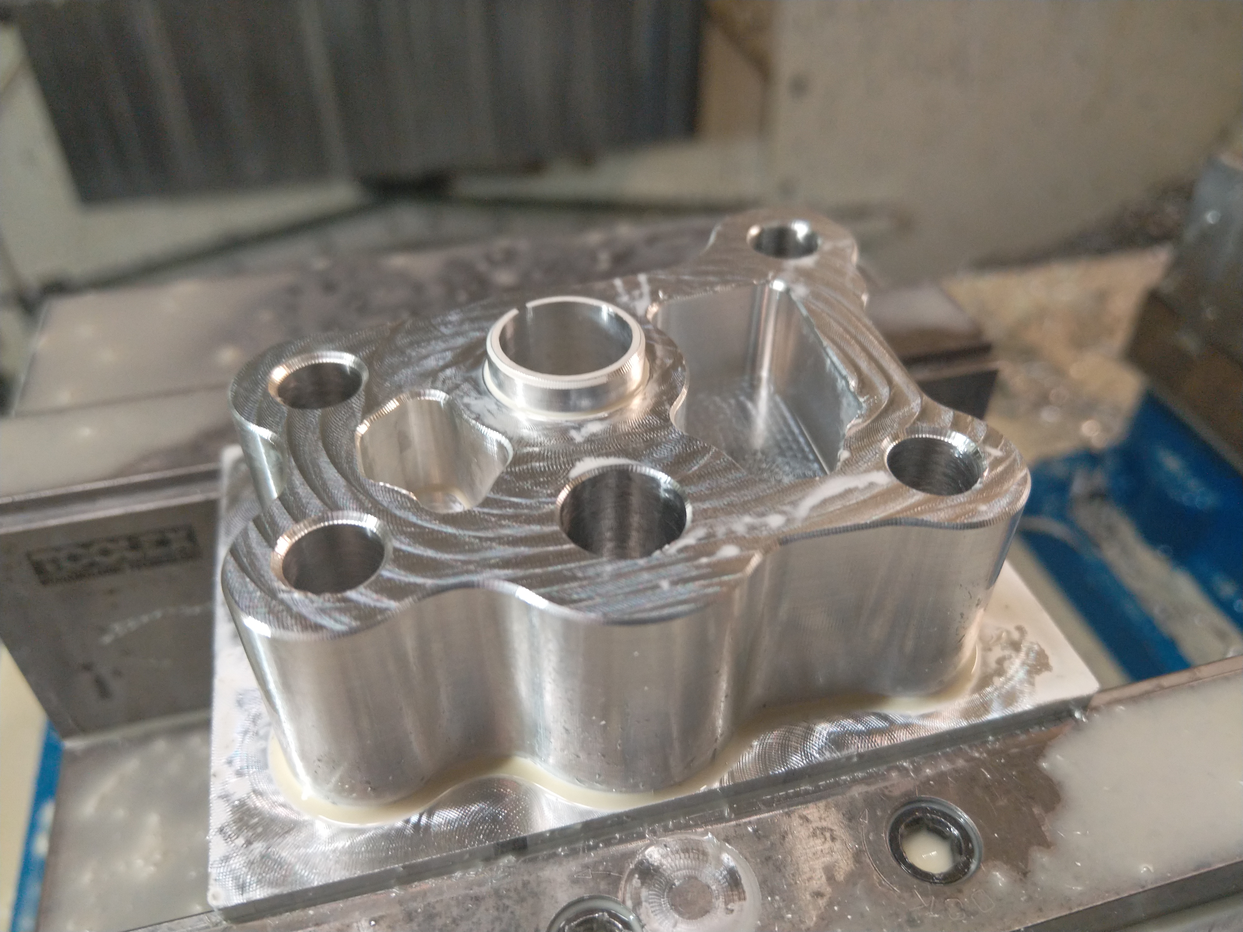

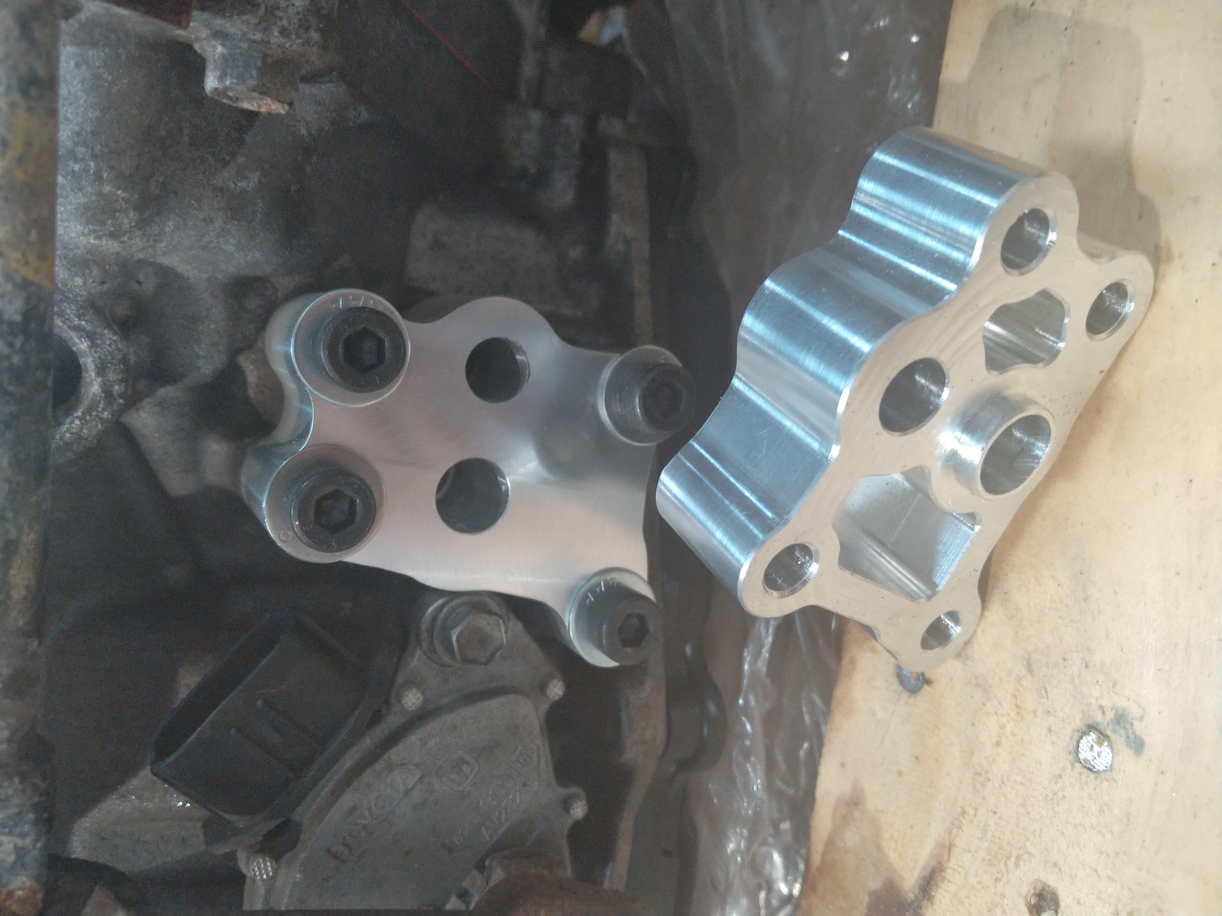

Made some progress. If anyone wants one let me know. No pump yet.Bustedprop wrote: ↑Wed Oct 12, 2022 2:56 am I recently acquired a transmission without a pump and figured it would be a good opportunity to machine an adapter plate for an alternate. My guess is that the left port is the pressure side and the smaller is the suction.

Looks like you're a CNC guy too. Nice work.Bustedprop wrote: ↑Wed Oct 19, 2022 7:40 pm Made some progress. If anyone wants one let me know. No pump yet.
Do we know the pump curve for the original L110 pump? (Flow on the X axis and pressure on the Y axis)
Perhaps That helps in finding a suitable 3rd party replacement?
Most power-packs I've encountered are stupidly loud and far more bulky than the OE Lexus pump.
Maybe a common power steering pump with a scabbed on brushed DC motor can do this in a less offensive way?
The flowrate must be small for this transmission while meeting the minimum pressure is probably critical.

If anyone wants to keep pushing this forward I just listed adapters on ebay. https://www.ebay.com/itm/175936880476 My apologies for such a delay. I recently acquired an Triumph TR4 that I hope to make some progress this winter. I would also consider bartering for some assistance with my ZombieVerter board.
