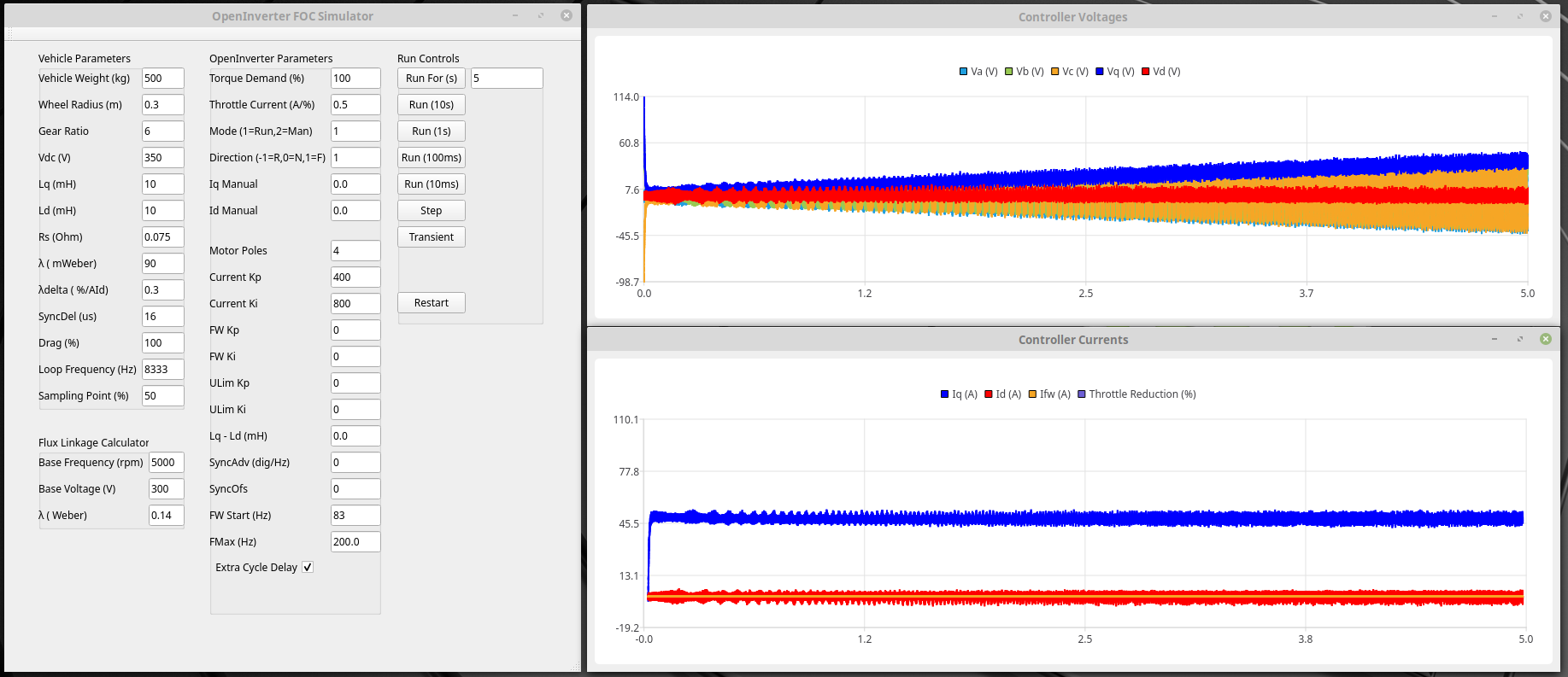

Finally, how I would go about tuning. Please note that I haven't tried this on a real car, the results below are from the simulator. Only try tuning this way if you are comfortable that you know what you are doing and understand the process.
Before starting make sure that syncofs is correctly tuned.
Edit - This process will probably work best with 5.20 on firmware which has had a bug in the integral part of the PI controller fixed.
The first thing to say is that this is not tuning for how a car drives, accelerates or feels, it is aiming at tuning the Iq and Id control loops so that they can best control Iq and Id. This does not depend on the car or gearbox but on the motor and inverter, more specifically the motor inductance, measurement/filter delays and the inverter loop latencies. Now this statement may not be correct, I think it is, but if it is it means that these ki and kp parameters can be tuned with the car, and motor, stationary. The things that affect the tuning are relatively constant and unchanging with motor speed.
So the way I would start tuning is with the car stationary, in gear (if there are gears), handbrake on and footbrake on. The aim is to lock the motor shaft so that it can not rotate. I'd reduce throtcur to a few tens of amps and then monitor Iq and Id on the webpage graph while using the throttle pedal to introduce transients. The low throtcur and handbrake should keep the motor and car stationary but I would keep the other foot on the brake just in case. Whatever you do do not do this with the motor unloaded (out of gear, clutch down, or on the bench), if you do there is a very good chance the motor will overspeed and be damaged.
Before starting disable MTPA (lqminusld = 0),disable field weakening (fwki and fwkp = 0) and set ki and kp to zero. With is set like this the throttle should have no effect on Iq and Id as seen on the web plot.

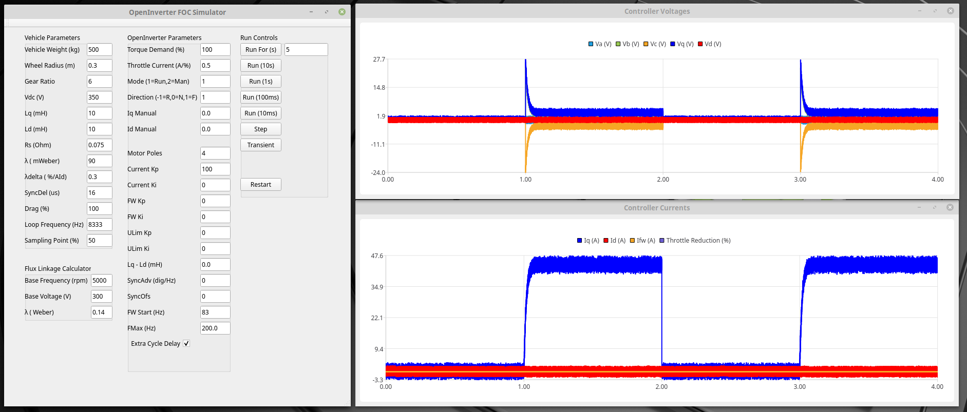

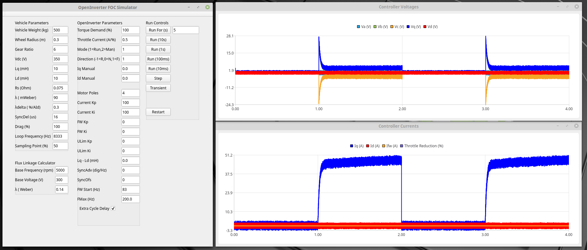

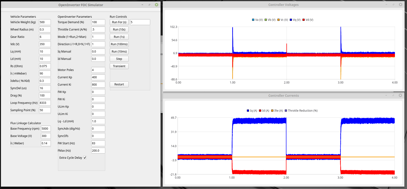

First set kp to a low figure, say 10 and see what effect the throttle has on Iq and Id. You should see something like this:
First ignore the noise on teh plot, I've just artificially added that to make it a bit more realistic and check the tuning process copes with it OK.
Now on the simulator throtcur is set to 0.5 and full throttle is used, that should give 50A. It doesn't only 20ish, this is because the P term gain is too low and so needs a large error to drive the output. Also note the slow rise, this is down to the motor inductance and the low gain.
Now increase Kp, the next plot shows it for 100:
You can see this improves both the risetime and the error.

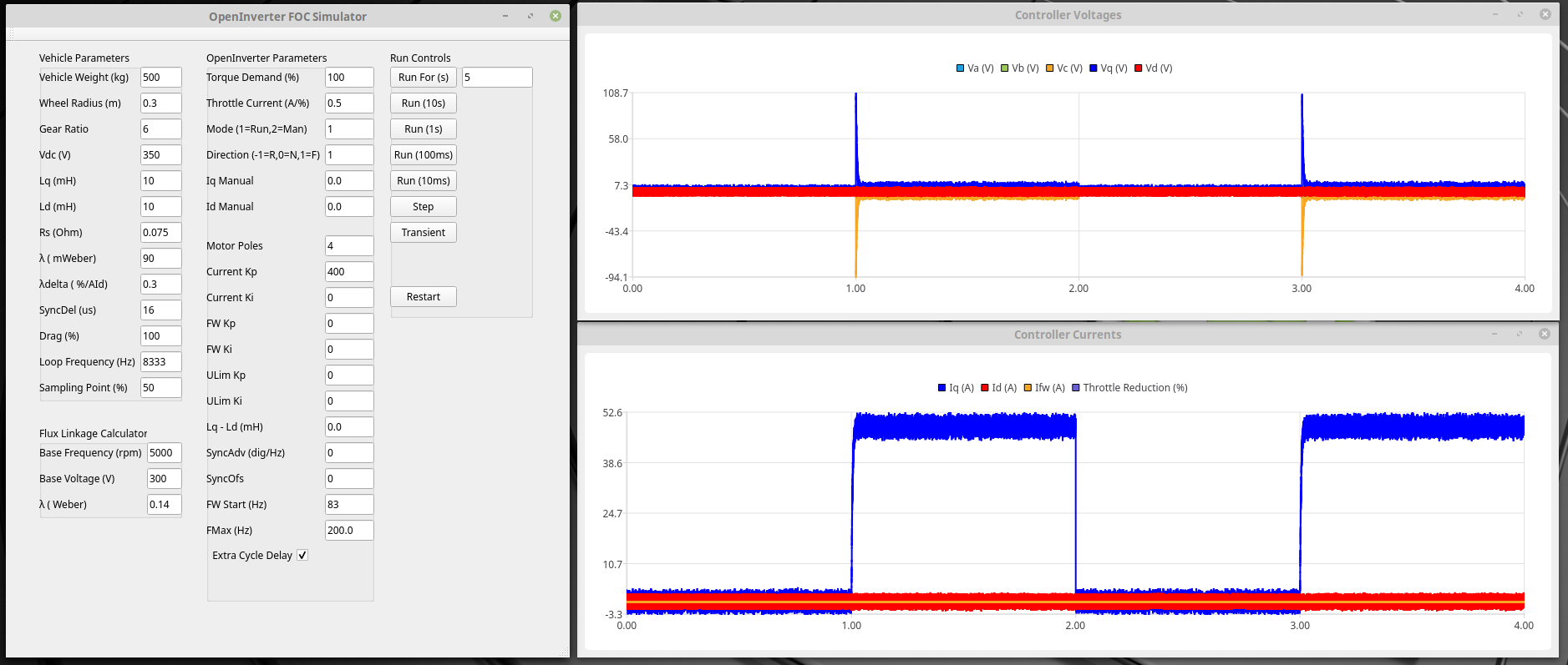

Now keep increasing, kp=400:
A bit better again.
Increasing to kp=1000:
This looks a bit better again but you can also see that the noise level on the voltage traces is starting to increase. This sis a sign that it is starting to overshoot slightly so personally I would set it back to 400.

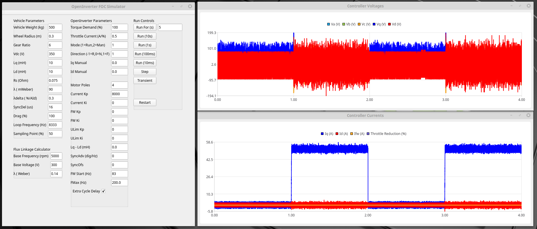

Just to illustrate the point increasing to kp=8000:
A big increase in noise for minimal improvement in risetime and error.

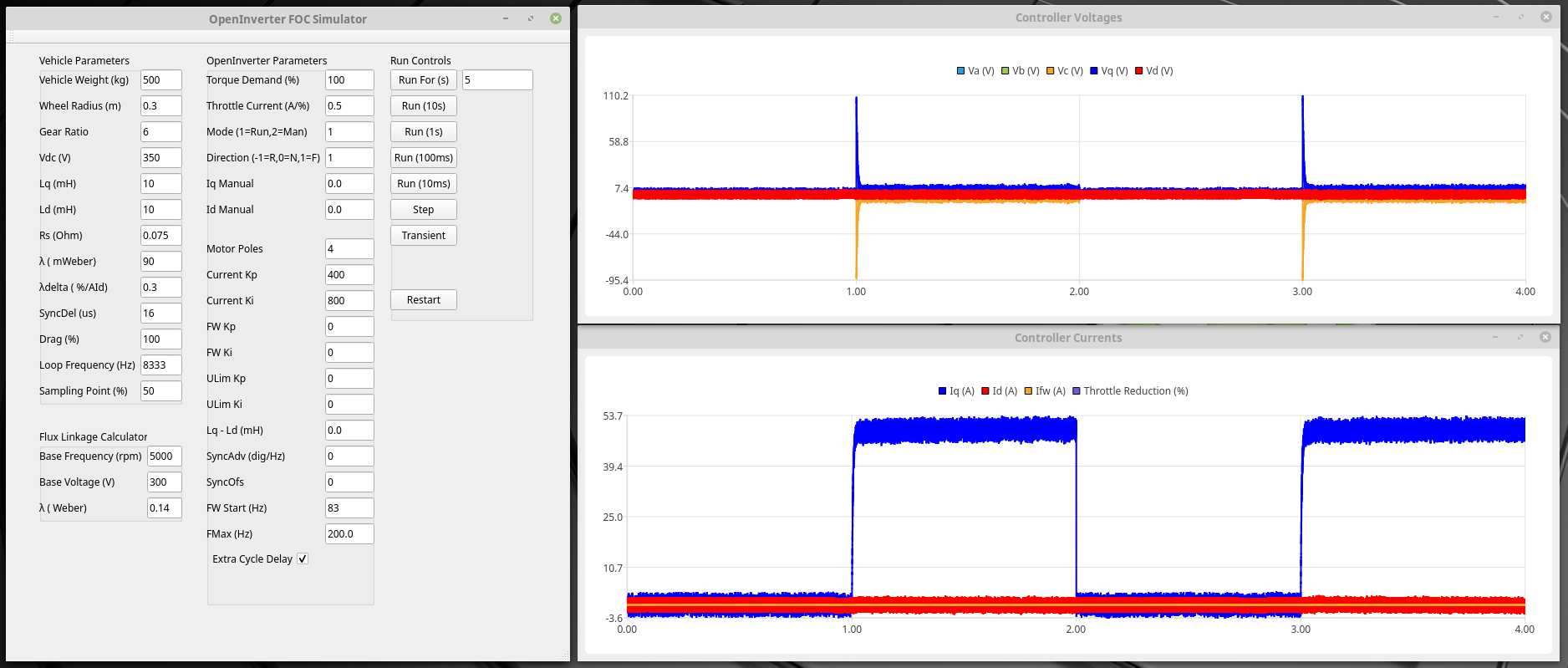

So in this case I would settle for a kp of around 400.

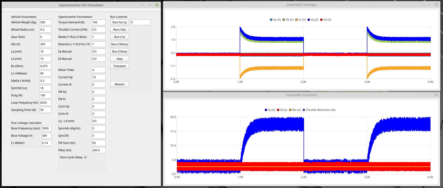

Moving to I. Now it's very difficult to see the effect of I on a stationary motor while P is properly tuned so what I suggest is back kp down again to where there is a significant error visible, say kp=100 in the above and then start introducing ki.
Here is the plot for kp=100 and ki=100:
Compared to the earlier kp=100 you can see that the I term is coming in during the pulse to reduce the error and is just about getting there by the end of the 2sec throttle application. Too slow though.

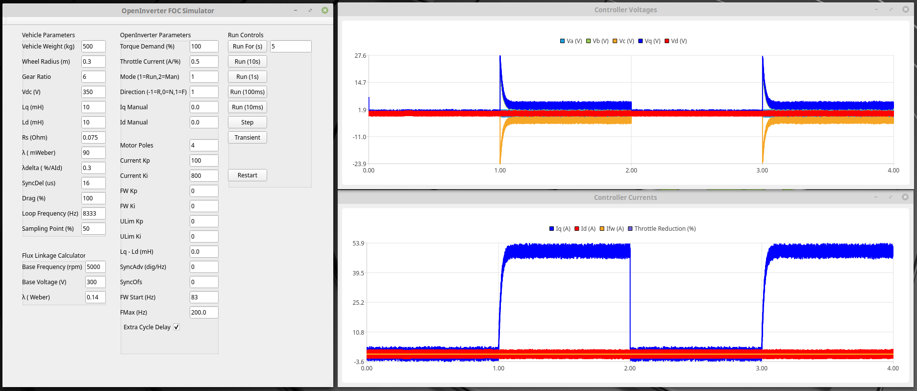

kp=100, ki=400:
Improved but not there yet.
kp=100, ki=800:
About right for me, maybe a bit slow for others.

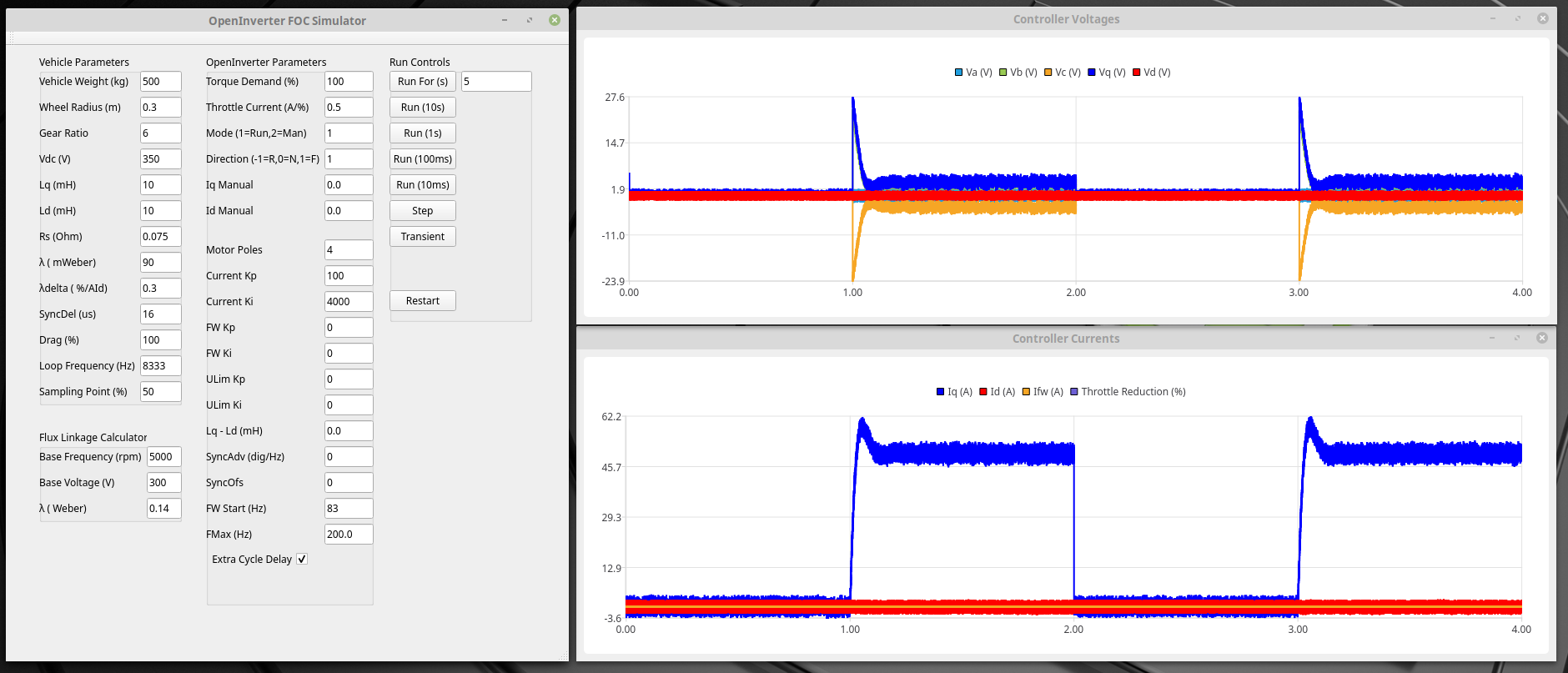

If you go too far it starts to look like this, kp=100, ki=4000:
The overshoot at the start is a sign that the I term is too big. If you are after ultimate performance then maybe but it's also going to start affecting stability.
So I would set it to kp=400 and ki=800 which gives this:
Good rise time, minimal error and reasonable noise.

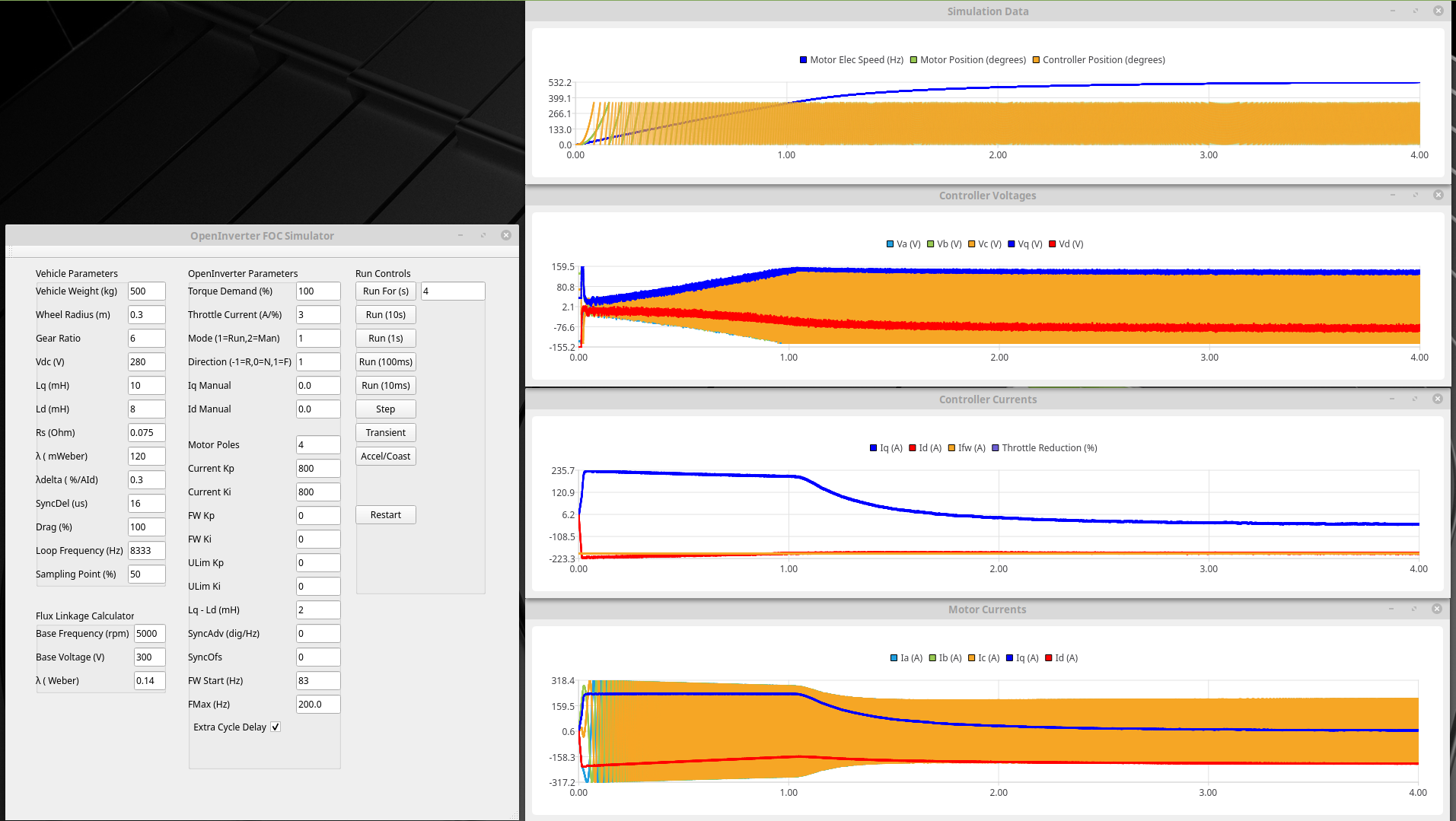

Next I'd turn Mtpa back on and check the Id looks OK too:
Which it does,
If that all looked OK I'd wind throtcurr back up a bit and then, very cautiously, try driving the car (keeping below base speed as FW is still disabled) and check the plots looked OK with the motor spinning.

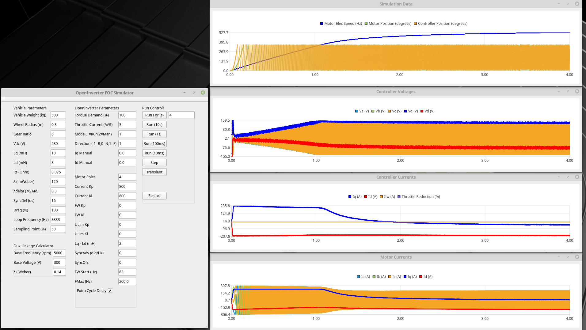

Edit - when looking at the plots for driving Iq and Id should be stable in the steady state and shouldn't overshoot or oscillate following throttle or load changes.
Please note - I've only tested this process in the simulator (I don't have a working car yet) so only try this process if you are comfortable with it and understand the process. It is untested in the real world and in particular goes against the results found when tuning the parameters in the past so be carefull. Interested in results, positive or negative, as they all help develop the understanding of how it all works.

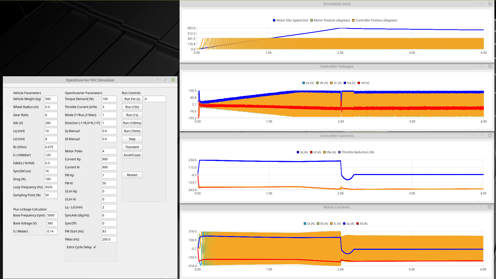

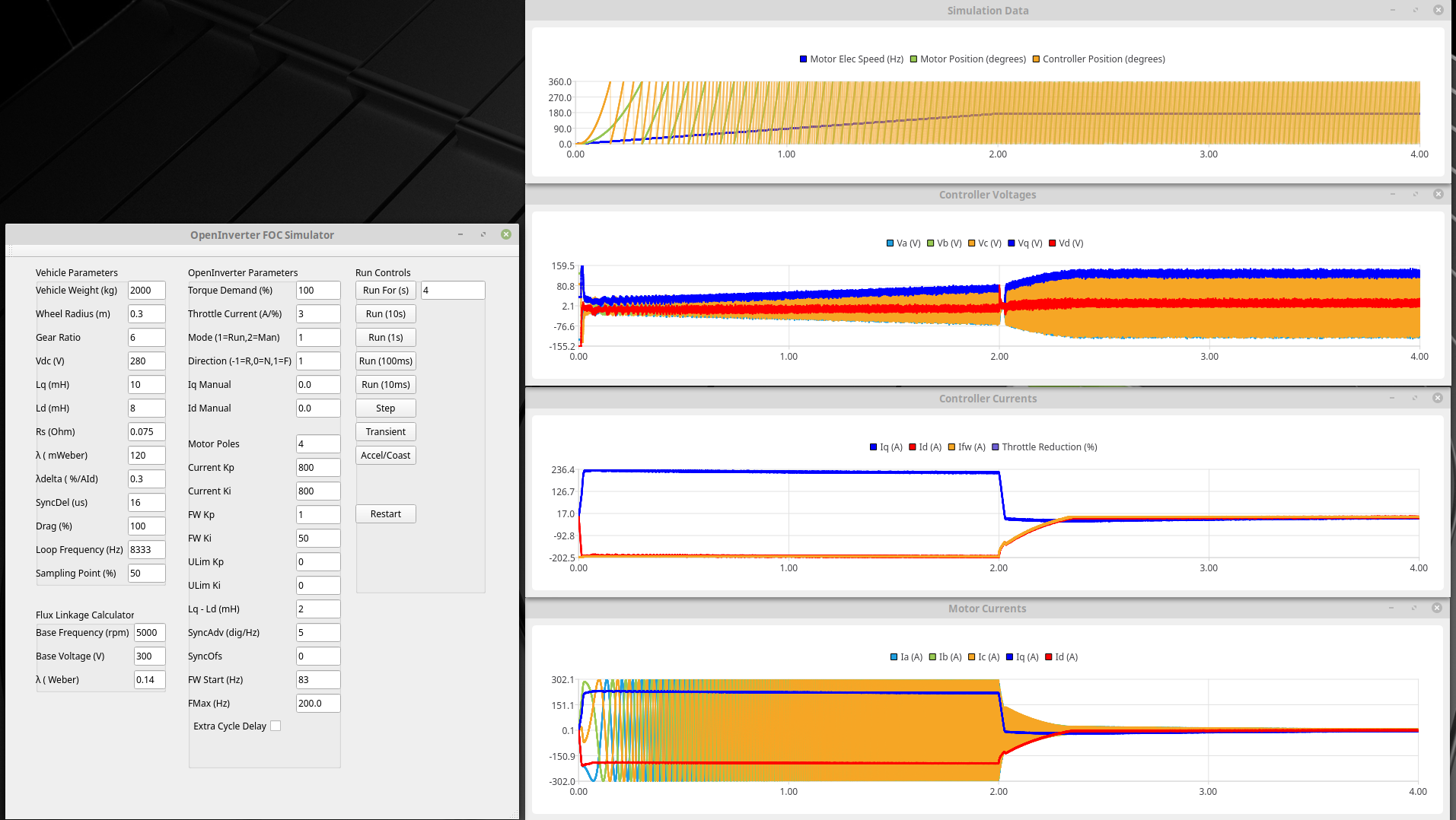

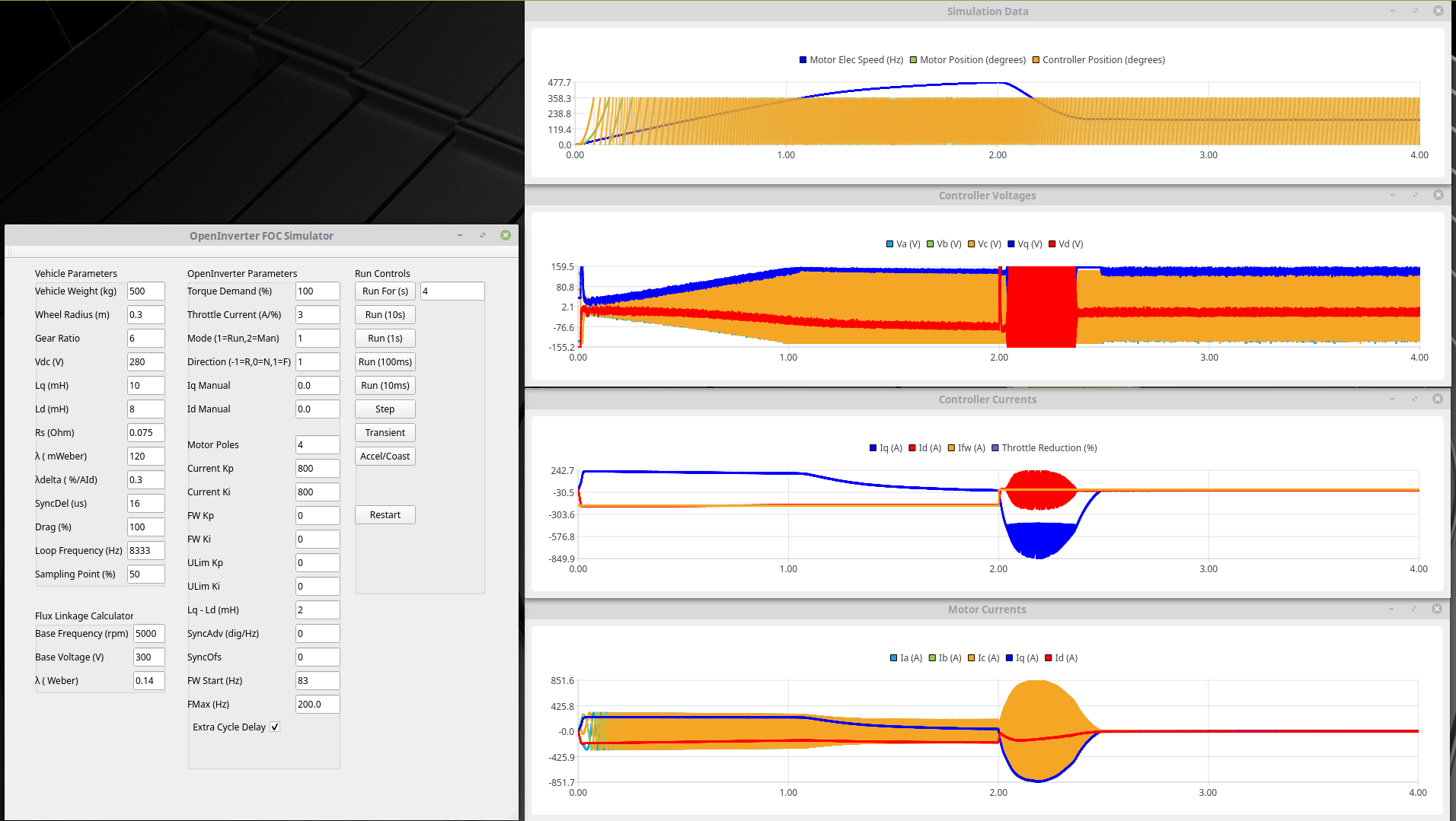

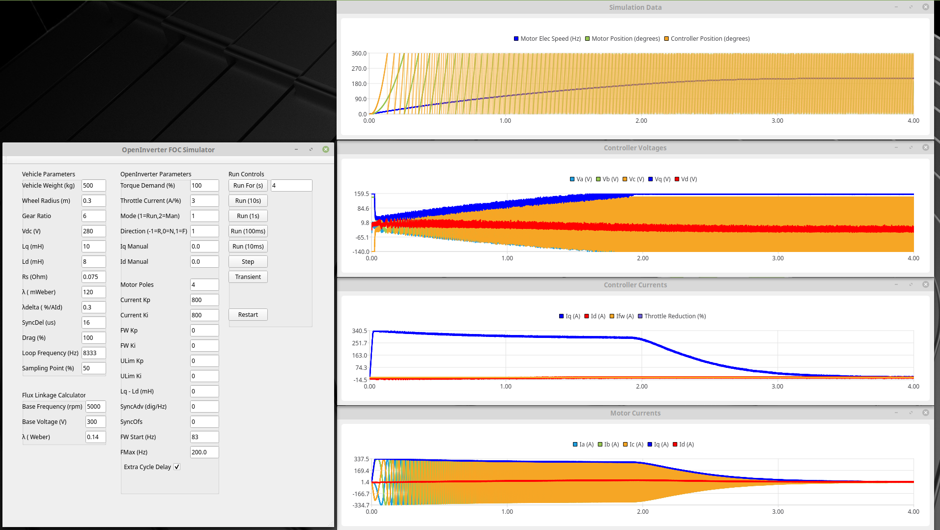

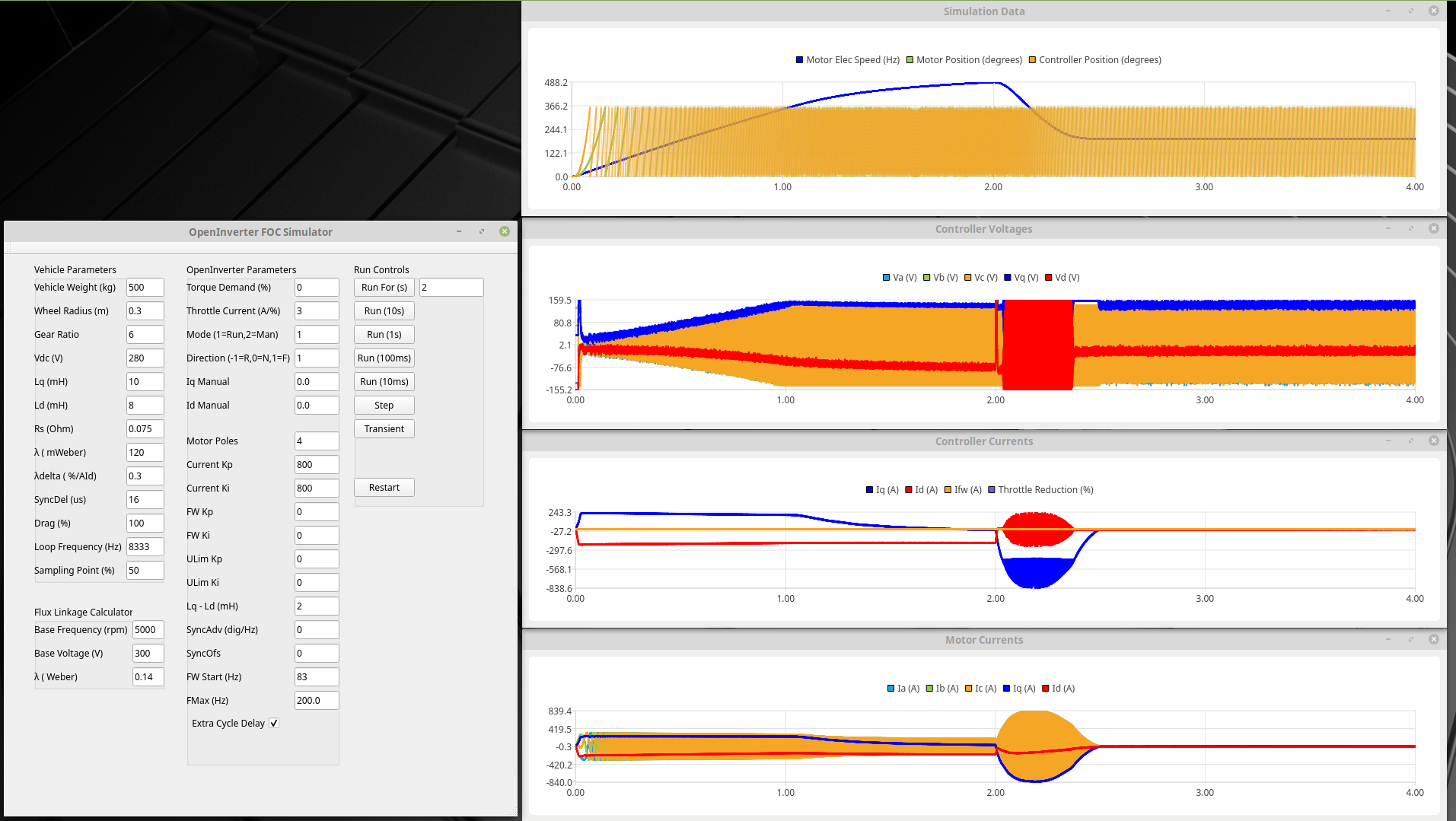

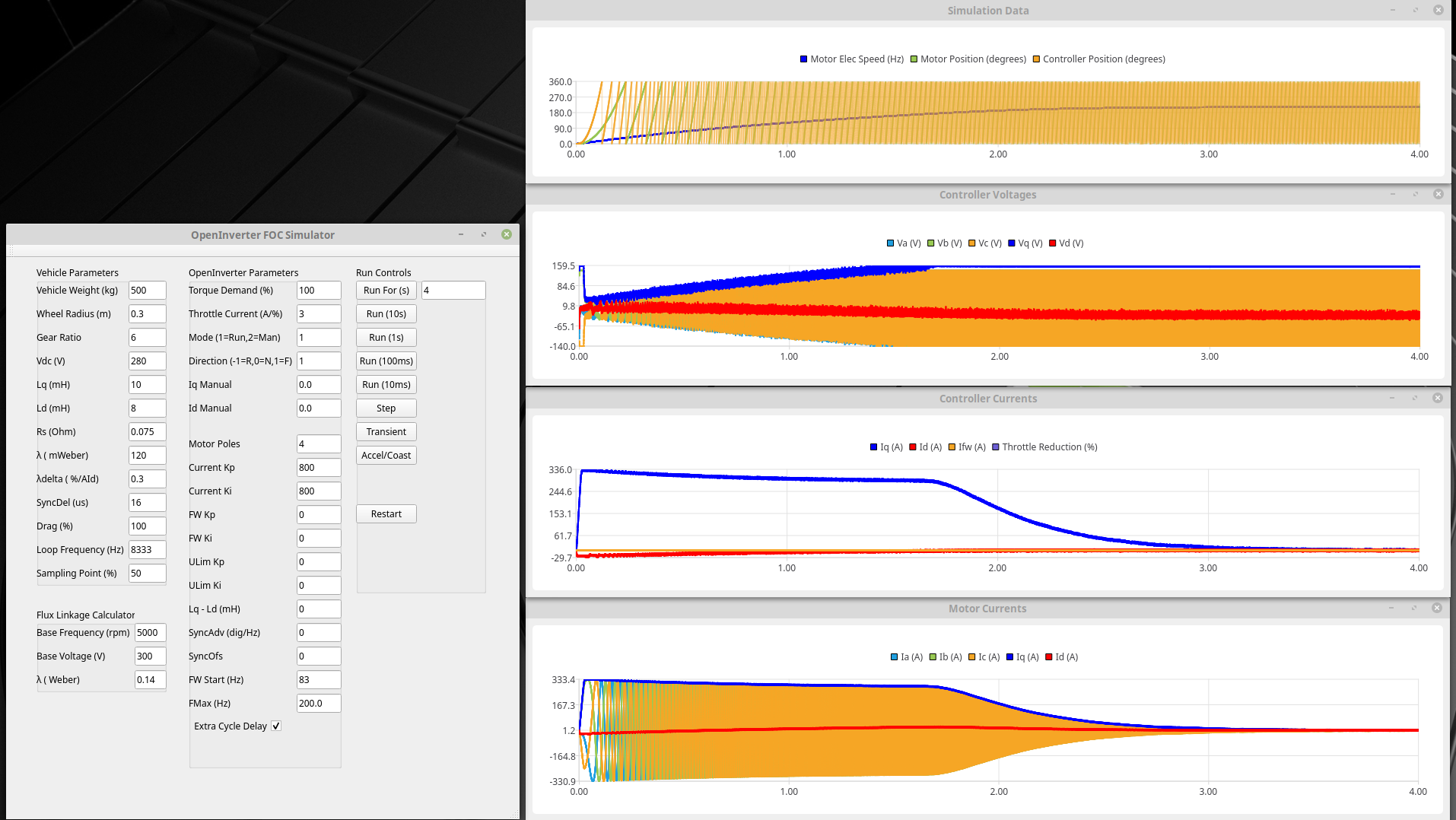

Just for completeness here is a plot from the simulator of a run using standard ki and kp values:
And here is one using the values generated from the above process:
I've tried to keep the scales similar on both to make them easier to compare. They both appear to work but do so in different ways.

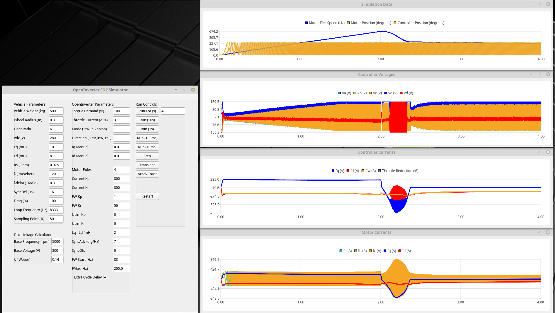

Edit - a plot of uq and ud while accelerating and then coasting down would give a pretty good idea of base speed if your wifi connection is up to it?
Edit2 - 2500rpm does sound too low but then Toyota do boost up to fairly high voltages in their inverters so it is possible? Is the 4krpm with FW or just Mtpa?
Pete9008
Posts: 1801
Has thanked: 102 times
Been thanked: 347 times
Post by Pete9008 »

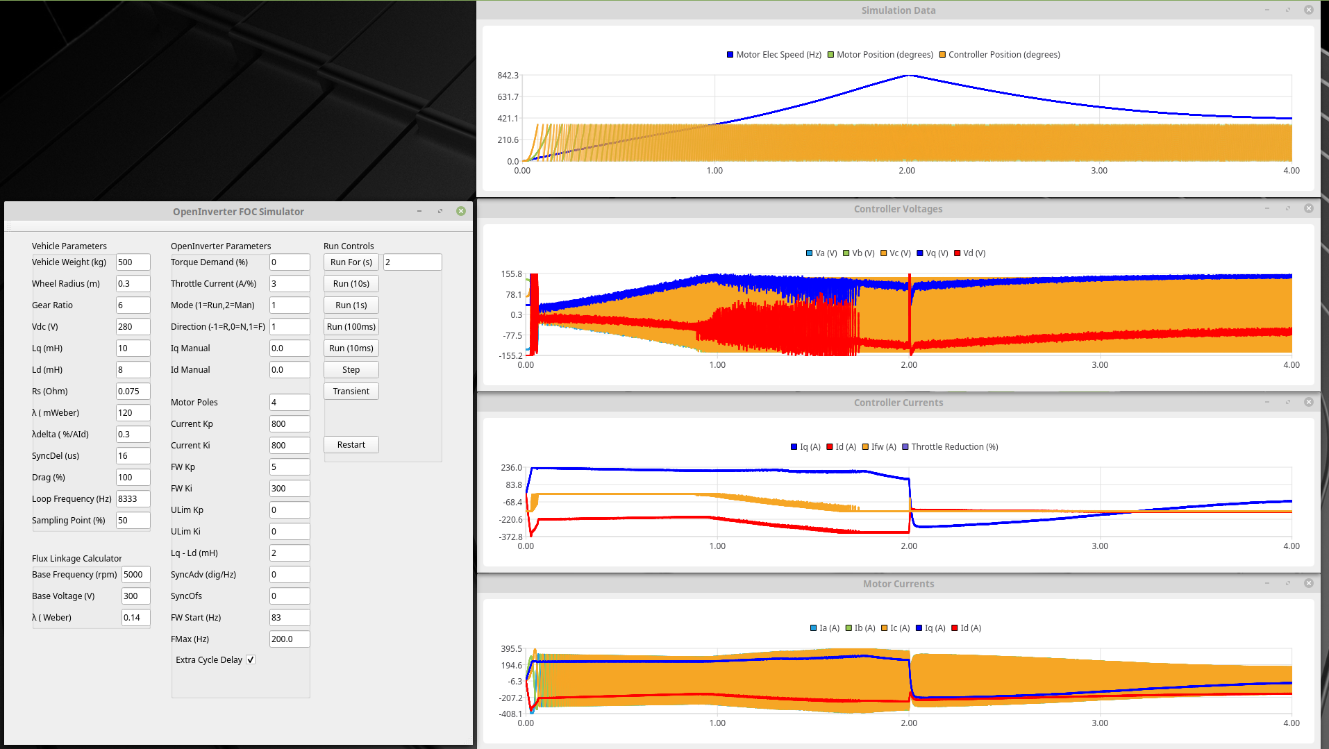

Just had a look with the simulator and if I set flux linkage to 120mWeber (not unrealistic) and voltage to 280V it gives a base frequency of around 3krpm so 2.5k doesn't seem implausible. If I turn Mtpa on it then revs to twice this and does give regen when coming off the throttle (back down to 3k), so this is looking quite likely.

OK, think I have a solution that I'm happy with :D
First a few plots to summarise how it's performing with 5.20 code.
First a plot which is supposed to be similar to EV8's setup, base freq at around 200Hz, no Mtpa and no FW:
Next with Mtpa enabled. This allows it to accelerate past base frequency:
But if you go past base frequency and come off the power you get unwanted regen:
If FW is also enabled then:
Bit better but still get the unwanted regen.
All the above are using kp led tuning, with ji led tuning the last plot looks like this:
Next post will be with the revised approach for FW and Mtpa

I've now changed it so that the Mtpa -Id feeds into the FW controller. If the Mtpa current is more negative than the controller ouput the controller output is forced to the Mtpa value and the integral reset to match. This means that when you come off the power the FW controller holds the -Id for as long as it is needed. If you are below base freq the -Id ramps down in a couple of hundred ms, if above base freq -Id is maintained.
Plots - first the baseline - revised firmware but with Mtpa and FW disabled:
With Mtpa:
With Mtpa and coming off the throttle:
Same as before so the changes don't appear to have broken anything.
Now enabling Mtpa and FW:
This needs a little explanation. You can see the FW coming in from around 1sec with the red and orange traces dropping on the Controller Currents plot and it is held on when the throttle is backed right off at 2sec. There is no unwanted regen but we do now have unwanted acceleration. This is down to the effect I mentioned before where the controller is using the current rotor angle to calculate the motor voltages rather than the predicted rotor angle at the point the new PWM will come into effect. Adding the sync compensation (still using the SyncAdv parameter for conveniance as it's there) allows this to be tuned out:
This looks pretty good. No unwanted regen, no unwanted acceleration, stable -Id and the controller currents and motor currents now agree with each other.
If the compensation is set a little high you get this:
A little but of unwanted deceleration but not an issue. The problem comes if you go a bit too far with the compensation:
The Iq and Id control loops go unstable and we are back to the unwanted regen. No worse than the unmodified code but still there.
Now a value of 5 for the sync compensation should work for every install, it's set by the inverter controller loop frequency and sampling latencies and shouldn't need changing so maybe this is acceptable. The better fix would be to reduce controller latencies but I still haven't worked out how to do that.
Edit - Final plot showing how the currents ramp down below base frequency, around 200ms. This will probably be hidden by the throttle ramps in real life.
Also noticed that the sync compensation value can safely be pushed a lot higher if you are not pushing so far past base freq (the above plots are a bit unrealistic going up above 3x base). If you are only going to twice base then is seems stable up to fairly silly sync compensation values.
Edit2 - what's really interesting about this last plot is you can see the back emf increasing when the throttle is released which looks very odd. What is happening is that the Mtpa -Id is being removed and so it is no longer suppressing the back emf. The Uq voltage therefore needs to increase to compensate for it!
