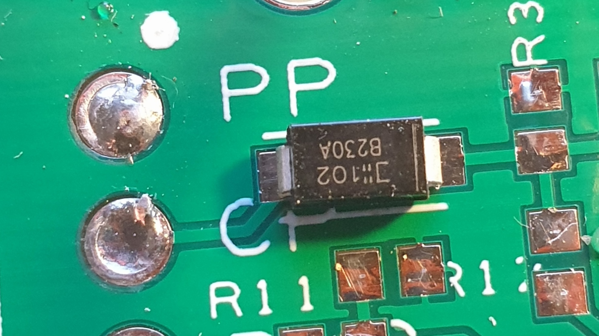

I have a B230A-13-F diode is it suitable as a D1? Also what is the polarity, do you have a picture? Which way the mark of a diode needs to be pointing?
- Posts: 3266
- Has thanked: 80 times
- Been thanked: 234 times
Re: Arduino DUE VCU with analog and CAN control
Yes 30V 2A is more than enough. You just make sure its the correct package to fit.
Also marking is oriented towards the resistors. It is suppose to rectify -12V _ +12V peak to peak evse signal into dc signal.

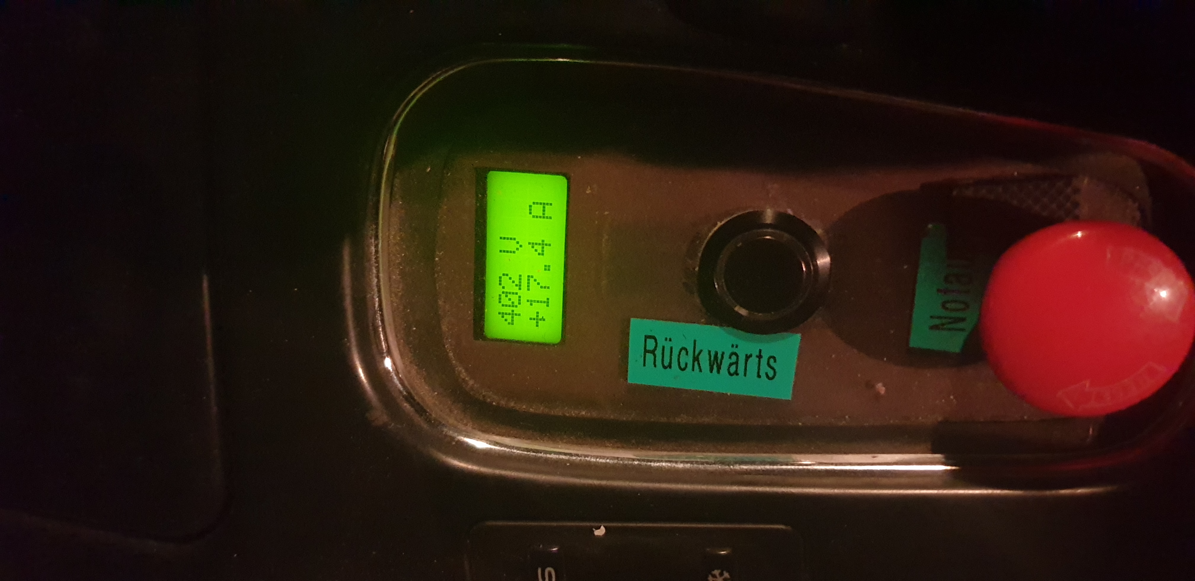

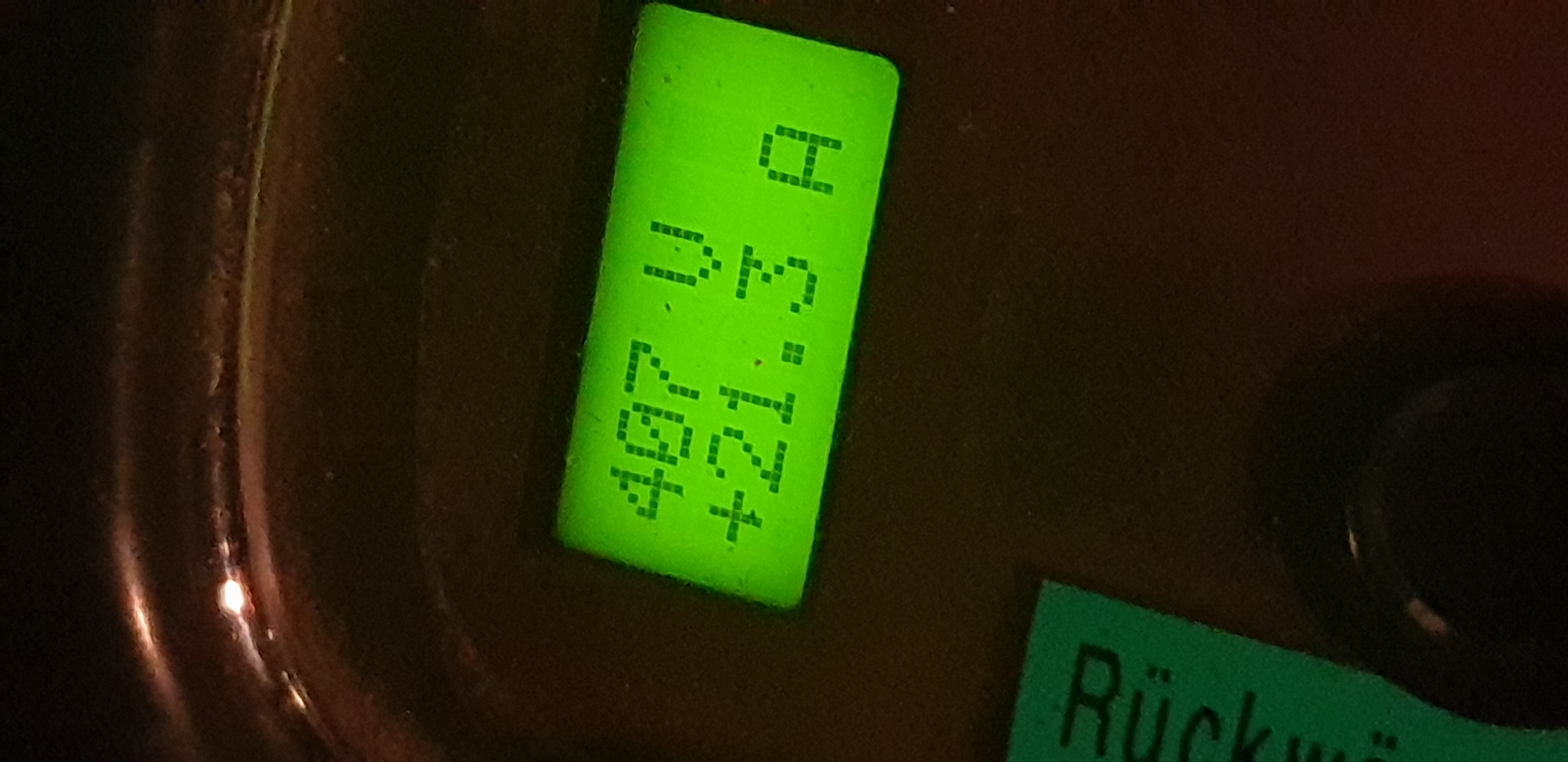

900 asked me how my Gen2 charger is doing with opensource firmware.
I put it in the car now, yay! It was a whole days work. I had to lift a lot of weight under my car, i feel like i had a workout ...
Then i had to replumb coolant and deair...
It is now wired to sense EVSE PP signal and pull in Cp signal. That works by itself and i cant use PP signal for anything else. If i connect my DUE there it would just float and DUE would not sense connection.
My setup is to use A1 output on start and that is connected to my DUE (previous PP) input pullup pin. This works really well and starts my coolant pump and car fans when charger is connected.
Also to stop charger i am using its A3 input pin which is pulled up to 12V. I can pull to GND with BMS output to stop charger.
As for charging above 400V it seems to drive current well above up to 410Vdc which is what i have tested. Today i will continue to 420Vdc and report back. Charger jumps around a bit which is why first photo is just 17A. But that is only transient and normally it keeps to 21A that my EVSE requests.

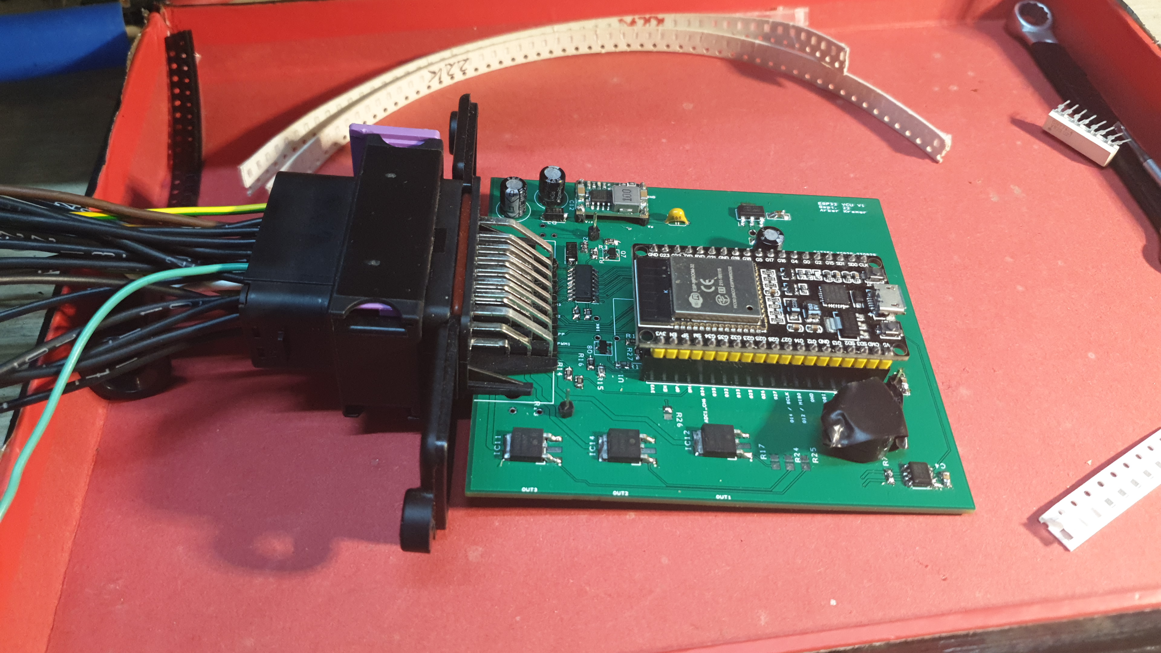

Hm... i can quickly redesign V5 board for use with NCVs.900 wrote: ↑Tue Aug 23, 2022 9:01 am Arber, so been using your shield to drive contactors for a while, it works well except very occasionaly fails to trigger precharge it seems. I'm a bit doubtful about reliability of the ULN2003 chip as Damien has also noticed. Do you think this can be replaced with something beefier for your next version of shield that you're designing? Maybe an array of NCV8401?
I will probably just keep ULN driver where it is and replaced relays to 3x NCVs. That way you could very well use the board as VCU for Chademo with the actual code. If you have interest you can make some boards and test that.
Because of better availability i went from DUE to ESP32. I have the board here and i am trying to recode it via PlatformIO.
I will let you know.

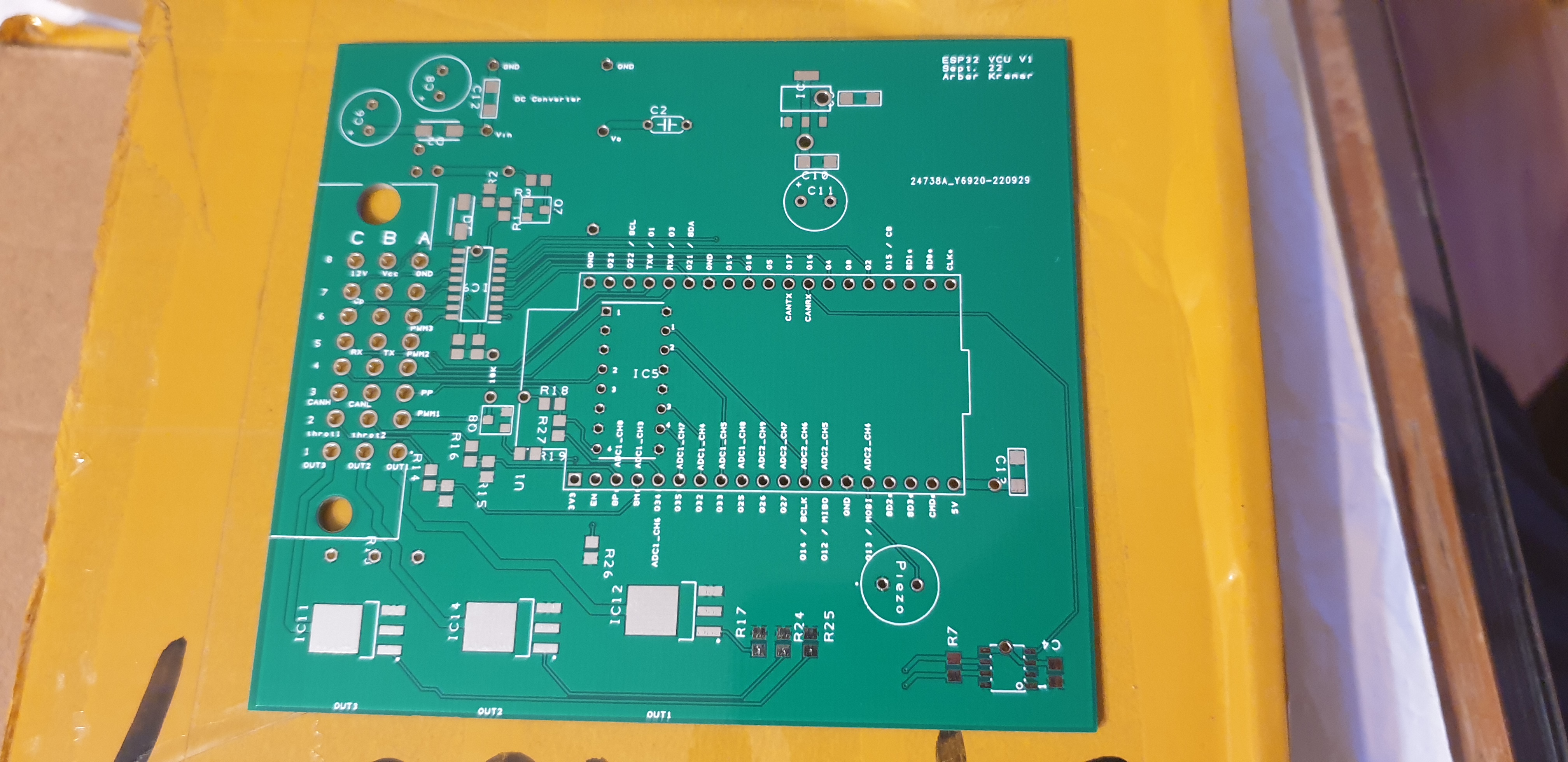

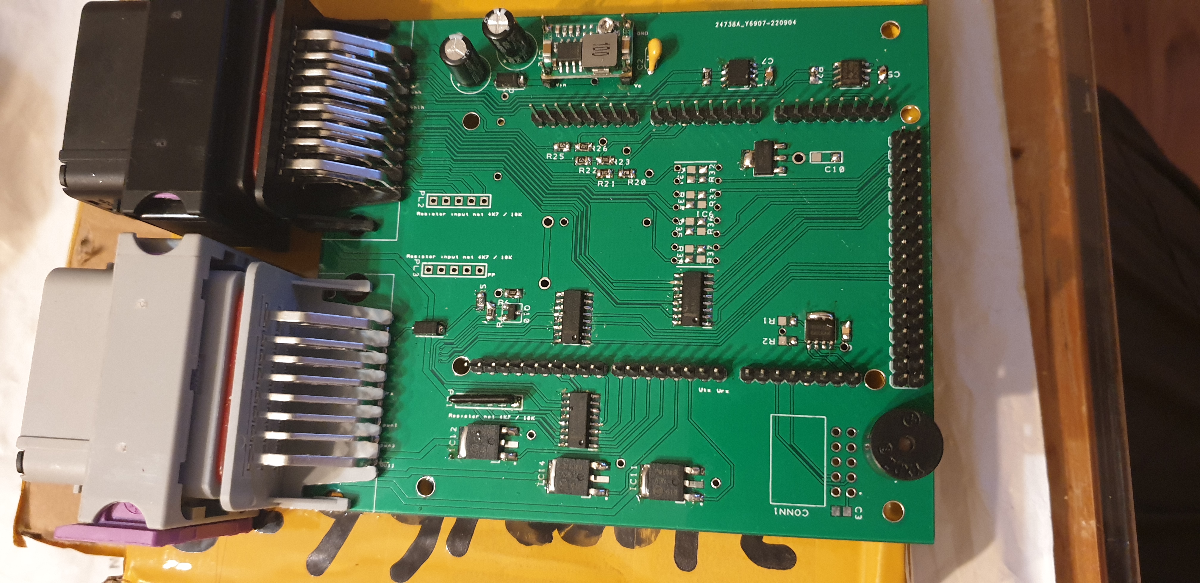

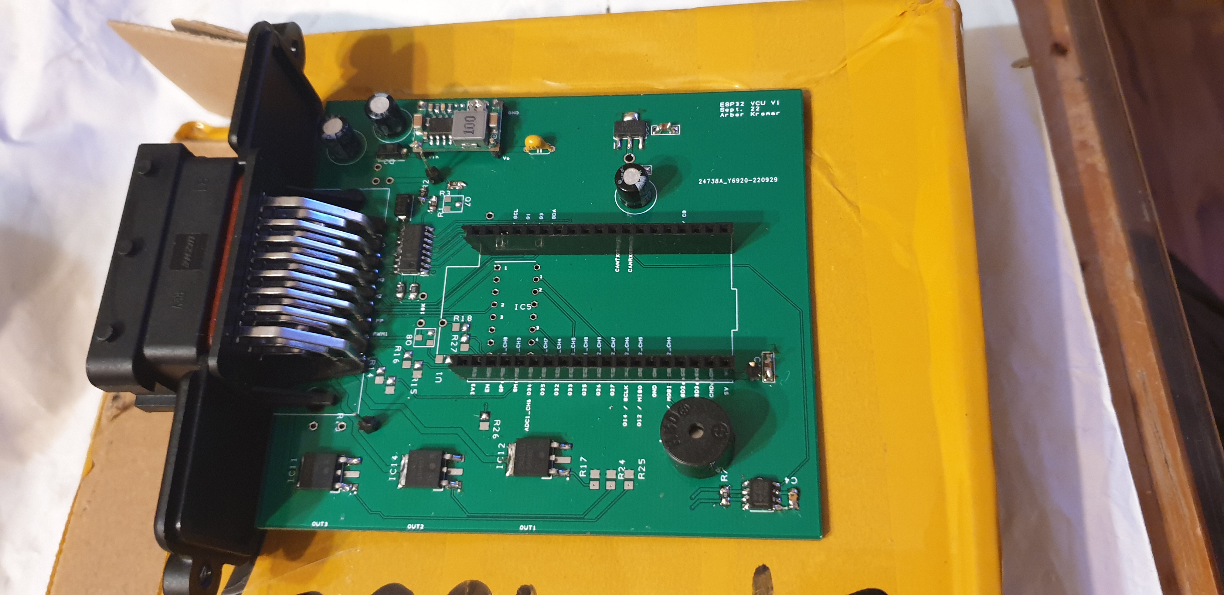

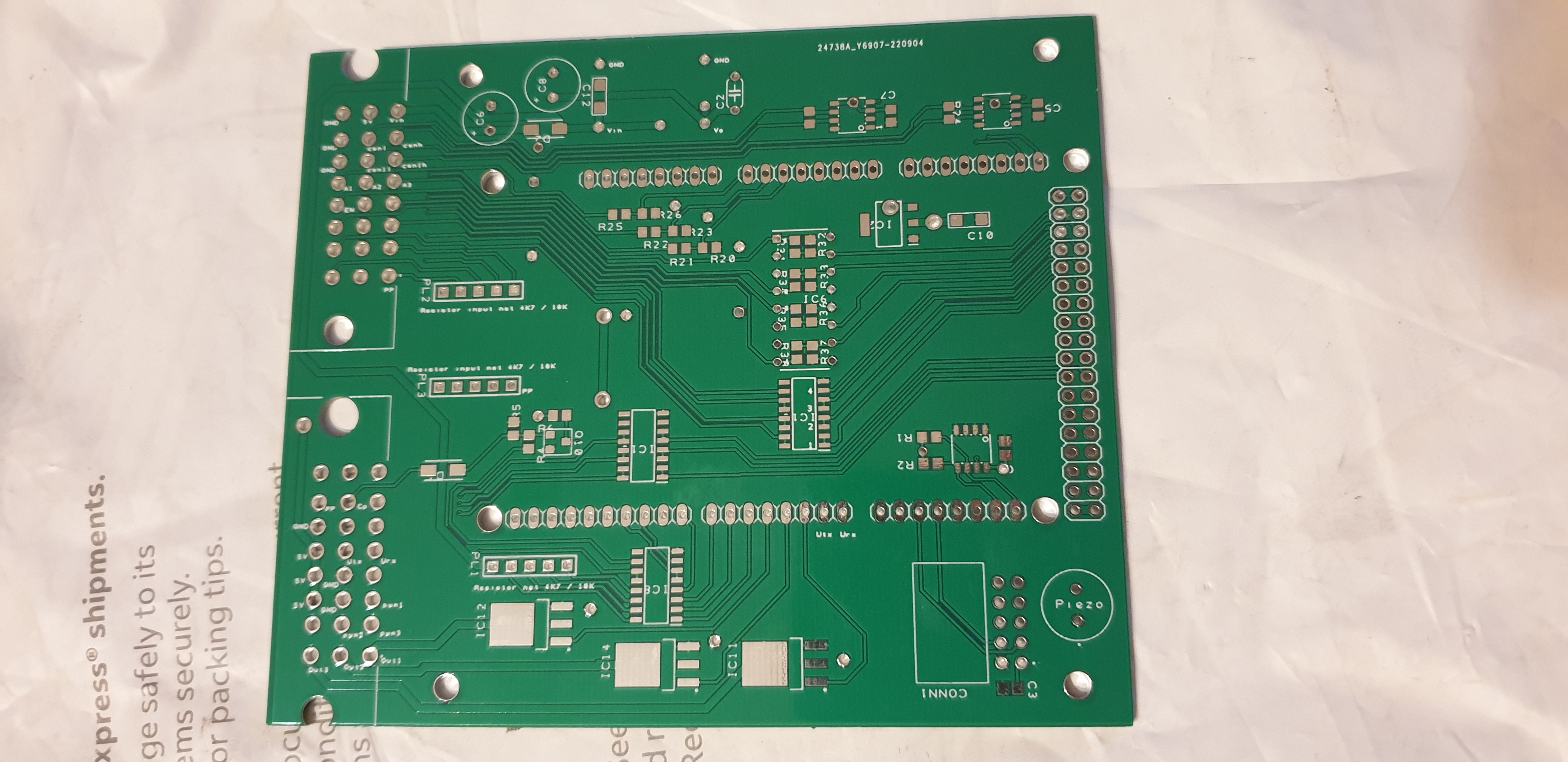

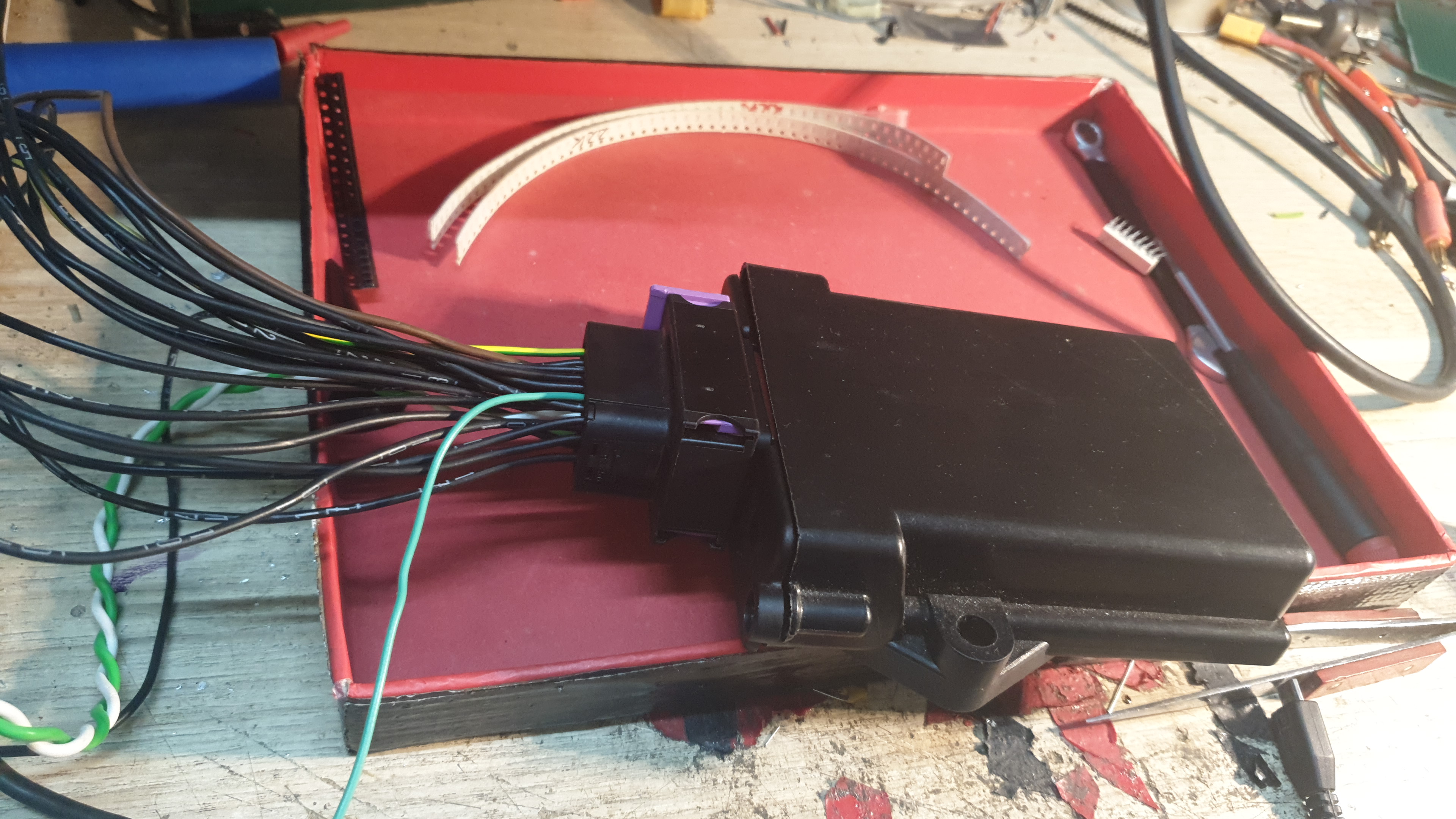

This weekend i designed a shield board with full Arduino due on top.
This is meant as a quick DUE VCU V6. I will probably make 5pcs for testing and later i will develop V6.1 with some more input ptotections.
Could be that DUE board would be easier to develop then ESP .
Case is made of alu with 2x 24pin sealed connector from aliexpress. I couldnt find its 39pin equivalent pinout connector. If anyone has its library it would be much appreciated.
https://www.aliexpress.com/item/3291424 ... 4itemAdapt
EEPROM of course...
3x analog inputs via resistor divider. They were meant for throttle pedals or similar 5V inputs...
Cp pin logging
PP pin input
3x NCV transistors
Piezo buzzer for error reporting.
Quad opto for those inputs that need to be 12V.
Rest inputs i based on resistor ladder pullups to 3V3 and need to be pulled down to GND to activate. Otherwise chip may be damaged.
Likewise i used 3x ULN chips with doubled pins for true 0.5A latching. I am confident those outputs will drive any signal relay reliably.
I reserved one ULN chip to drive PWM outputs. I used 4x resistor ladder tied to 12V.
There are 2x CAN bus chips
There is WiFi connector on serial2.
Board could be used without 5V regulator, since DUE has its own. But i suggest to put one in since various pedals and switches can tax 5V regulator too much...
That's amazing work mate. Would it work with your Outlander charger sketch?arber333 wrote: ↑Tue Aug 30, 2022 8:33 am This weekend i designed a shield board with full Arduino due on top.

Imade some small changes to V6 board.
I put a voltage divider on input pins of the opto. Now they can be used even if you dont have the opto. You just populate those resistors so you can sense 12V signals directly.
I rotated Wifi module so it will clear the casing.
I added 5V to 3V3 regulator. The argument is sometimes 3V3 regulator on DUE can ack up and the second one can provide stable power.
I also needed to reconnect 5V lines and 12V input. 5V is so limited it cant be used to drive logic of DUE board. But just for testing you can use the board 5V output. I recommend you add true 5V converter later for a full product.
I replaced the files in my previous post so you will need to redownload them. I dont want to make 6.1 design before i even have proof of concept made.
I will send boards for manufacture. I only get the bare boards, that is the reason behind this shield conforming to DUE board...
Incidentaly when i made a CAD (carboard) board design i discovered i would need to remove the DUE board power socket. It seems a small sacrifice and i will power the board from its Vin pin anyway.

I got my V6 boards from MFG. Some photos later.
Its a simple dock for Arduino DUE board so maybe not really robust, but i have used that in my Pug for 2 years now. I only had to replace DUE board once and it was my fault... providing 12V into pulldown pin!!! .
For now it seems i can use this VCU setup for at least 4 things if not 5.

Like i showed before i developed a V1 of ESP32 VCU design. I shuffled outputs a bit so i cleared the dubious pins. I still need to test it, but it looks good.
My goal is to develop the code for this board which would be able to run Chademo process a BMS or use it as VCU with option for wifi interface.
I managed to get the CAN bus code working YAY!
I have the I/Os working as well, though not in the way as i intended. I cant get the opto coupler chip working from 12V inputs. I will simply replace that chip by series of 4 resistors and reverse the sensing. This will pull the signal lines to GND and effect signal change in ESP32 chip.
Buzzer coupled with signal on BMS pin is really loud. I had to tape it over for testing. I still need to test the behaviour of AD converter for analog pins and PWM output pins though.
