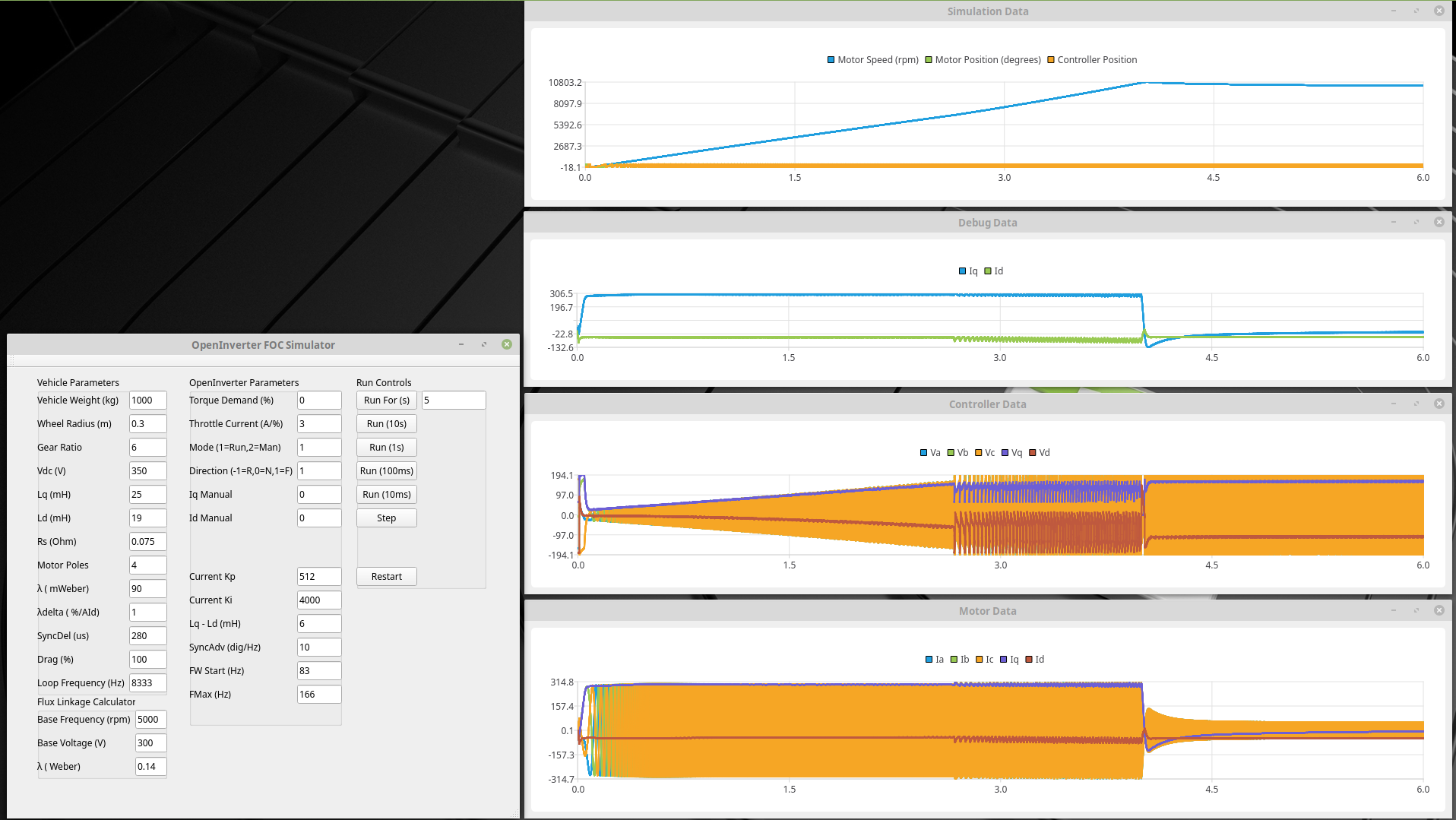

Yep, quite pleased with that result!johu wrote: ↑Fri Aug 26, 2022 5:50 pm That is simply awesome that now this can be modeled instead of putting yourself, your car (driveshafts) or even someone else at danger. Your probably right about the shortcoming of the current FW controller. Could you try this variant: https://github.com/jsphuebner/stm32-sin ... -control-2
in foc.cpp it has a modified MTPA that includes the regulated FW current right away. It does (almost) exactly as you say, trying to keep iq amplitude from maxing out. Of course this only works if measured currents and angle match together, otherwise it can cause unwanted acceleration as it drives current into the motor that is no longer proportional to throttle input.
BTW the speed limiter is not part of the core control loop but it's simply one of the deraters called in vehiclecontrol.cpp
Learnt the hard way that sometimes it's worth spending a bit of time on a simulator as, even if it's not perfect, it can provide good insights into what might be happening. Not sure I would have ever figured out how the code worked without being able to single step though an set breakpoints!
I've had a look at your code and it does virtually the same as mine (except yours is more elegantly coded!). The only different is you call the FWcontroller from the setTorquePercent function while I still have it in the main loop (I prefer the later as it is too easy to change how often setTorquePercent is called without realising the implication). Unfortunately I can't easily simulate it yet as I hacked pwmgeneration-foc.cpp around quite a lot while getting things working, also I only call setTorquePercent when something changes in the GUI (could that be causing any problems in the simulator - had a look and it seemed OK but I'm wondering now).

Not too sure what the best thing to do on this is now, options are:
1) Tidy up the code so that it can be used with a standard OpenInverter checkout.
2) Have another look at the MTPA torque calculations. The equations seem to give torque values for Id currents that I just don't believe meaning the simulation is probably heavily overestimating reluctance torque.
3) Just release it as is but the simulator/openinverter integration is very hacky and likely to cause people problems.
Any thoughts?

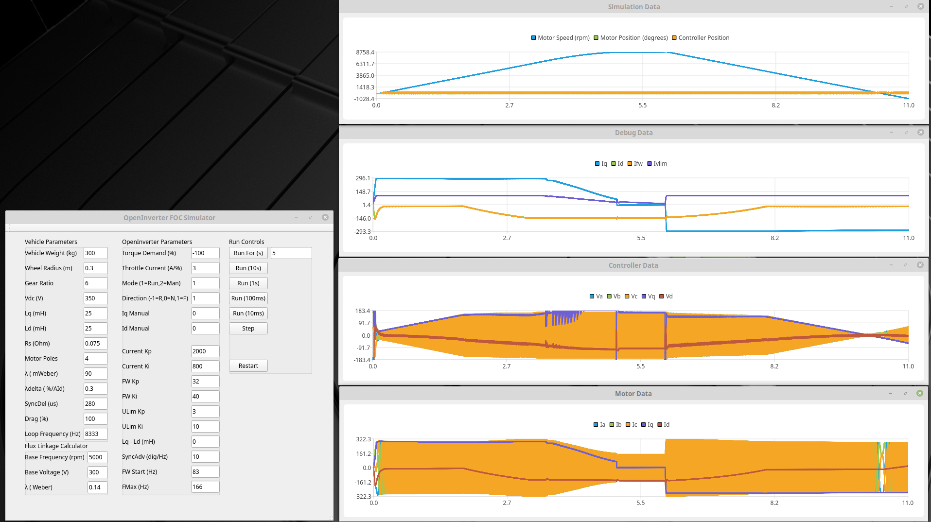

And just for completeness here is the plot with MTPA enabled:
There is also a slight deceleration on removal of the torque demand but this could just be the control loops settling (as they are obviously far from optimal).
I'm going to have a look at the MTPA equations again, as is it's just not realistic.
and to make it easier to compare with MTPA disabled:
You can see the increase in torque, it reaches a higher speed in a fraction of the time. I just don't believe this increase!There is also a slight deceleration on removal of the torque demand but this could just be the control loops settling (as they are obviously far from optimal).

Had another look at the MTPA equations and I'm fairly sure that my model isn't correctly calculating the Id resulting from the input Vq and Vd.
Don't think this impacts on any of the results to date but it would explain why the model is showing so much reluctance torque. Haven't got time to look into it any more now but may get a chance to have a look over the weekend.

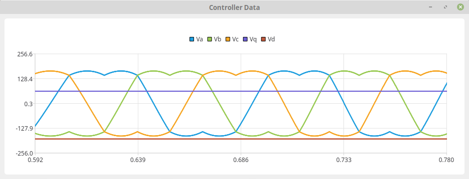

Bit more progress on the code yesterday. I've revised chunks of PwmGeneration::Run() so that both Ifw and throttle backoff are now controlled by PI controllers running off Utotal. The targets are set so that Ifw comes in first and then when it runs out of range the throttle backoff comes in.
In the process of doing this I had a lot of problems with getting the loops to stay stable. Some of this was just tuning but most of it was due to what I think are a couple of bugs in the existing code.
First, I was seeing voltage waveforms (amplitude is calculated from dc voltage * max dutycycle) like this: I believe that this is overflow on the fixed point maths in the FOC class. Changing the function to this seems to have fixed it:
Old code is the commented lines, new code is the int64_t bits. A better solution would probably be to change the FOC module to use one less fraction bit but don't want to do this without @johu opinion.
With the changes the waveforms are: The second issue was with the PI controllers. It seemed that is some cases the I term would wind up, and the anti-windup would kick in correctly to limit it correctly, but it would then not recover once the control signal came back in range. It turns out that if the input manages to go from saturation in one direction (with the anti-windup active) to saturation in the opposite direction in a single loop it would lock up. Wondering if this is what EV8 saw when the car rolled forward?) Adding an extra condition on the anti-windup seems to have fixed it:
With those mods and a LOT of tuning I've got to this:

Final comment - I've got to say I have huge respect for everyone who has managed to develop and tune the OpenInverter on a car. It's felt like hard work tuning it on the simulator (with breakpoints and debug) but doing it on the car must be 1000x more difficult. Seriously well done to Johannes and everyone else for the perseverance and skill it must have taken!
void FOC::InvParkClarke(int32_t ud, int32_t uq)
int64_t u[3];
//Inverse Park transformation
// s32fp ua = (cos * ud - sin * uq) >> CST_DIGITS;
// s32fp ub = (cos * uq + sin * ud) >> CST_DIGITS;
int64_t ua = (cos * ud);
ua = (ua - sin * uq) >> CST_DIGITS;
int64_t ub = (cos * uq);
ub = (ub + sin * ud) >> CST_DIGITS;
//Inverse Clarke transformation
u[0] = ua;
u[1] = (-ua + FP_MUL(SQRT3, ub)) / 2;
u[2] = (-ua - FP_MUL(SQRT3, ub)) / 2;
if ((ylim == y) || (ABS(esumTemp) < ABS(esum)))
esum = esumTemp; //anti windup, only integrate when not saturated or if will reduce saturation

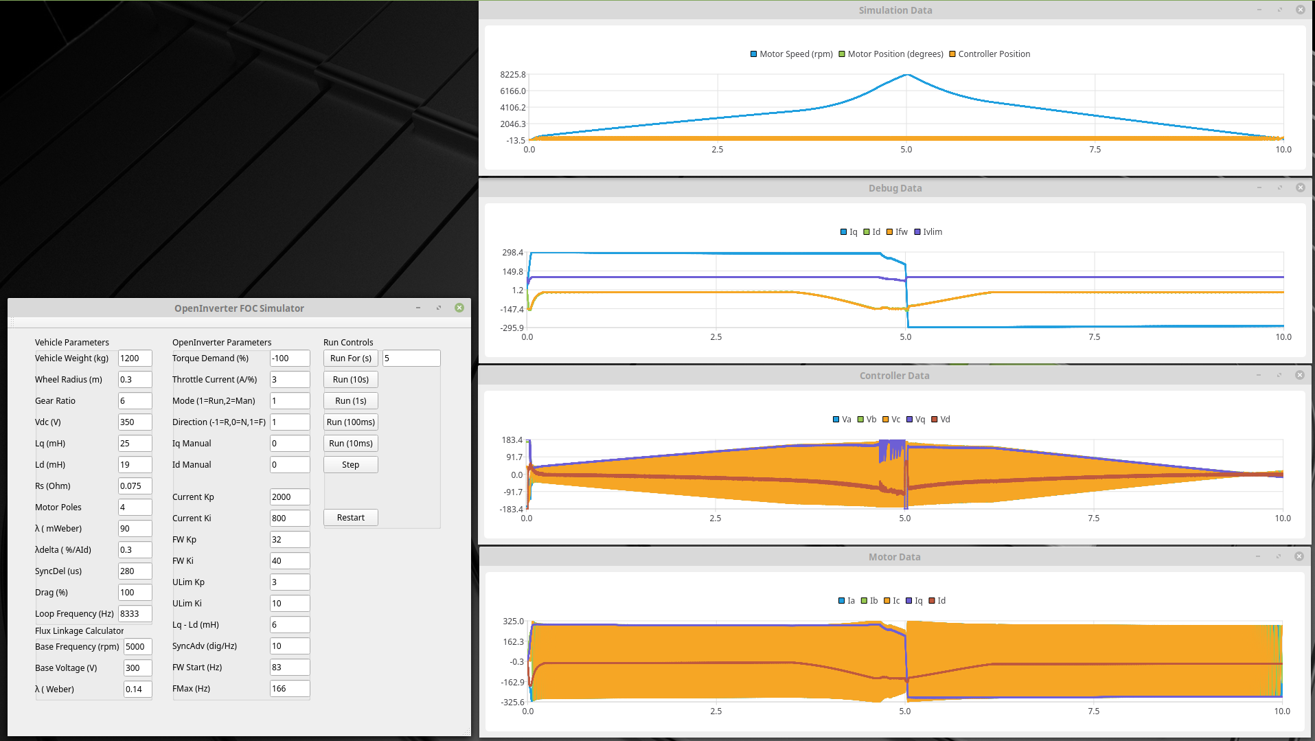

And one more plot, same as above but with MTPA enabled:
1) I don't believe this plot! To get the same speed I've had to increase the car mass by a factor of 4, that's 4x more torque which just isn't believable. I need to review the MTPA equations (both OpenInverter and simulator to find the bug).
2) This plot does not have the 1sec coast as if it is included the motor gets to full base speed and at that point there is no throttle control left to decelerate with!
It does still seem to work though which is encouraging (although there is more tendency to oscillation in the Vq control).
I'm going to leave looking at the equations for now and concentrate on getting the simulator to work with unmodified OpenInverter builds so that I can release it.
Two things to note:1) I don't believe this plot! To get the same speed I've had to increase the car mass by a factor of 4, that's 4x more torque which just isn't believable. I need to review the MTPA equations (both OpenInverter and simulator to find the bug).

The simulator code now works with standard builds. You can just checkout a standard OpenInverter source tree into a project subdirectory and it uses it. I've also ported all my mods into a standard build and can run that too. The only awkward bit is that if using the original code you need to use a new param_prj.h file as otherwise you get build errors.
I've also done a little tidying up so the plots look a little different (forced the q and d voltages/currents to have the same colours and changed motor speed to be in electrical Hz rather motor rpm).
Having both versions available allows for a direct comparison so original OpenInverter code first: Now this uses the original hard coded (so ignore the Lq-Ld parameter in the GUI) MTPA algorith and you can see the high levels of -Id current being added throughout the frequency range. You can also see the FW coming in at higher frequencies.
Next the revised code, firstly with MTPA disabled: And finally the revised code with MTPA enabled and the Lq-Ld value set the same as the hard coded value: In terms of motor power the revised code without MTPA appears to do best but this is probably because the motor model is set up for low saliency (Lq = Ld) mainly because I don't trust the simulation torque calculation for high saliency motors yet.
Next thing to do is figure out github and put the simulator on it, but before I can do that I need to sort out my web browser as it doesn't seem to play nice with github (does anyone else have problems using it with Firefox?).
Edit - the legend on the graph should read 'Throttle Available (%)' not 'Throttle Reduction (%)'

Johu's comments above got me thinking about how I'd implemented things and having had another look I realised that the code should be using dynamic limits for the Iq control loop. I then realised that his code already did and that I had removed them while making my mods Now reinstated.
Also, using the dynamic limits controls the output voltage amplitude much more precisely, which improves control loop stability, so I no longer have problems with overflows on the dutycycles (although I'm going to change the code to match his suggestion anyway as a safety net). With these changes the throttle reduction control loop is fairly redundant; it does trigger very occasionally but since it is in I have left it in place as another safety net just in case I've missed some test case.
This is what the simulation runs look like now. Fist the same 10second run as above: This is more or less identical to the previous except the control loops are more stable and the output voltage is much better controlled. Unfortunately the top speed is reduced slightly as it is no longer over driving the pwm. On the plus side I haven't managed to run out of throttle control authority at all, even at top speed which is a big plus.
Here is a plot of a fun to full speed followed by a 1sec coast followed by 100% deceleration which all looks pretty good: I still want to implement johu's suggestion of moving some of the MTPA calculations out of the main loop but hopefully then it should be ready to test.
One last bug (sort of) with the PI controller. I had been setting ki and kp to zero to disable the FW and voltage limiting functions but it turns out that although the output is controlled the internal integral error term continues to ramp up. Not a problem for loops that are permanently off but caused some odd effects while changing gains while debugging and also on one loop which has dynamic gains. The following code has fixed this:
Edit - 'Throttle Reduction' line in the plots is now actually throttle reduction. 0% means no reduction, 100% means throttle input fully reduced to zero.
