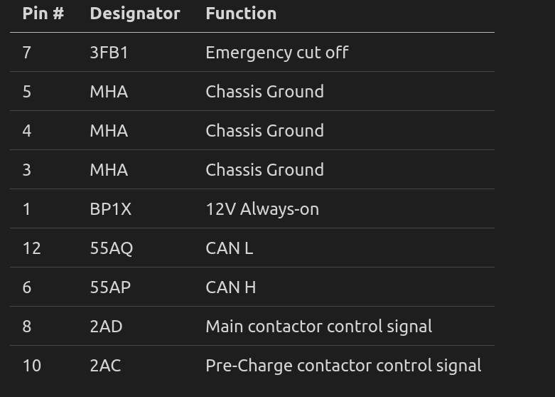

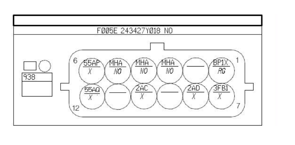

Hi wizo, here you go:
The connector is made by Yazaki, part numbers are 7282-8854-30 for male and 7283-8854-30 for female connector sides, respectively.
You can get them on a lot of online shops, cheapest is probably AliExpress, e.g. here:
https://de.aliexpress.com/item/4000174903780.html
I hope these infos are something you can work with!

Did you connect to the bms-CAN directly ? Which protocol and baudrate did you use ? I've got a 2011 pack from a Kangoo with the "white BMS" and trying to connect to it but yet without luck. Because I always receive a "can-error" it seems to be a very basic problem. When powering up the BMS it only changes CAN levels to high for about half a second and then drops them to low again. No message - nothing. So I have to wakre up this sleepy box by any means. Unfortunately there almost no information to be found in the internet regarding the Kangoo battery. Though the BMS looks like the "white Nissan BMS" there are differences to be found in the wiring. I'm stuck.

I'd check the simple stuff. Powerdown the BMS, disconnect your can interface, check the Kangoo can resistance between CanL & CanH (120ohms). If that's fine then confirm CanL & CanH on whatever PC interface you are using.
The frame you should be sending is id: 0x423 payload: [0x33, 0x00, 0xFF, 0xFF, 0x00, 0xE0, 0x00, 0x00] @ 500kbit/s every 100ms
