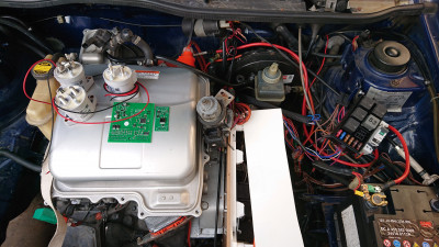

Been a while since an update. We now capable to recharge the High Voltage battery from MG1 out puts in the Inverter!
Been testing the last few days, and hope to write up this part of the process for our wiki once further testing is complete.
Next up, will install cooling and brake booster assistance.
Primitive battery connections are not advised

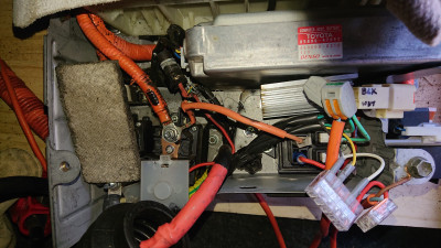

So charging is up and running from inverter and MG1 thanks to Johannes and community. Need to tidy up wiring.
The original prius battery will remain in use for further testing.
Now to get some vacuum brakes working (as I believe there has been some regen issues causing acceleration )

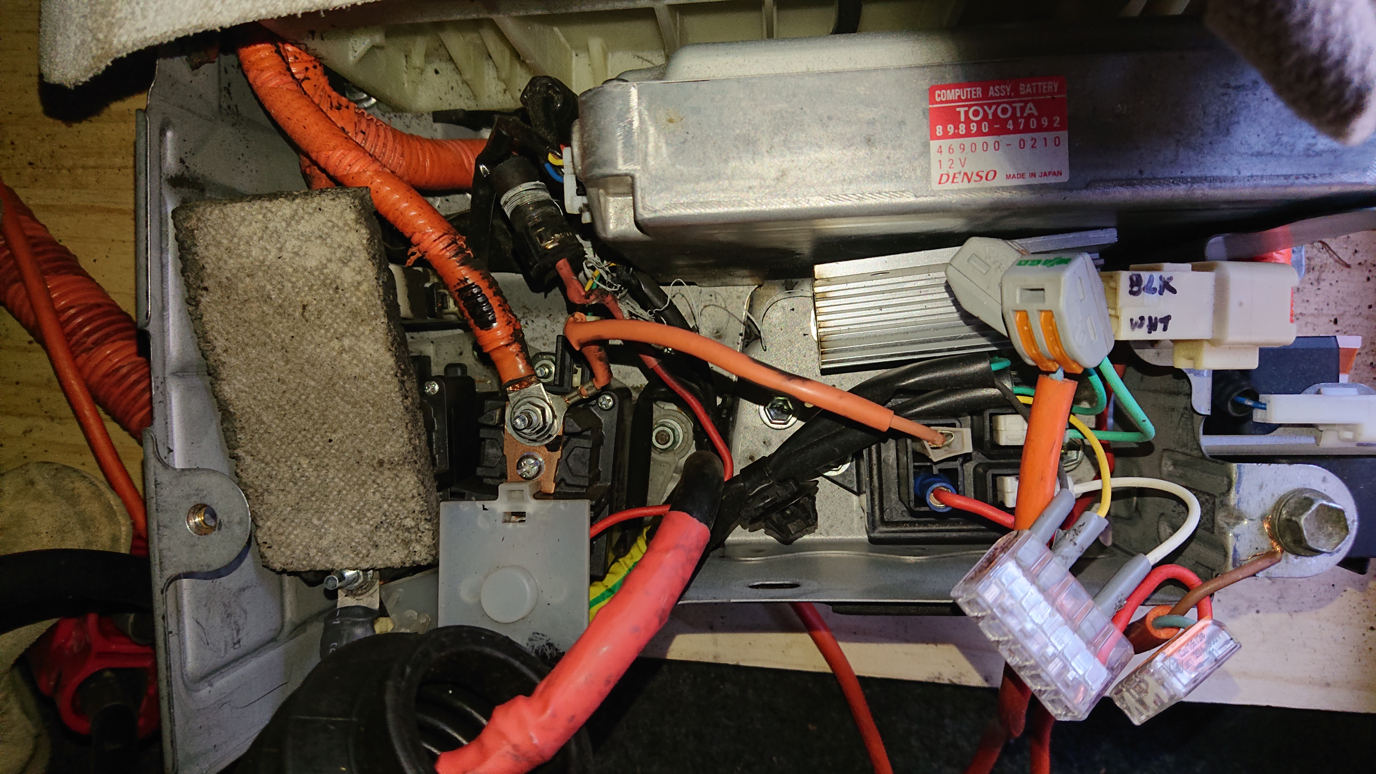

Thanks zookeeper and company, wired up C5 and dc-dc up and running. I used dcsw to activate pins 1&3 on a relay.
Will figure out a 'pull to ground' for pin 4 at a later stage - basically to shut down if voltage exceeds 15v.

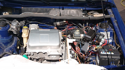

So finally got my brake vacuum setup fitted and wired in. Starting to get lots of wires, so fuse and relay boxes installed to tidy up a little. Pump switches on and off (like when they do a pre flight test of the planes wings.)
Will look into it next, but can start to check out why there's no power - flat lines around 30km/h. One thing for sure is original prius pack @225v is not going to get very far.

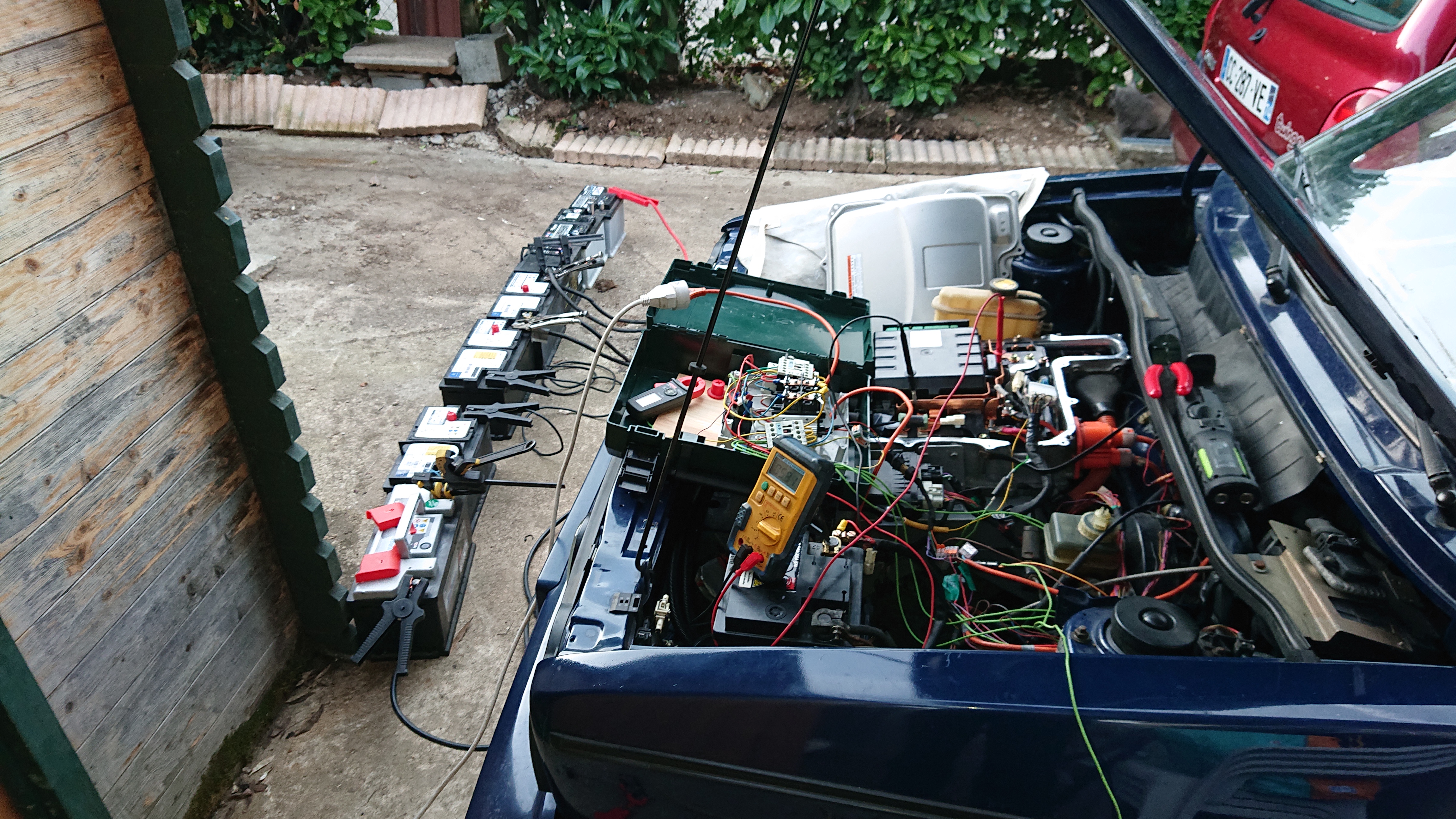

So decided to go back to the start... sort of.
I thought, Damien had his gen3 prius transaxle running pretty smooth during his video with Johu. Albeit without load.
So went to remove any doubts or 'I assume that I got it right'.
Went back to check resolver feedback - nothing happening when carrying out the test sequence.
Did some changes as per Damiens table and resolved the resolver problem.... I'm pretty sure it was fine before, but not going there.
So back to checking stage 2 and homing in on our famous 'syncoffs' value.
At syncoffs = 10000 & manualid =50A, I let out the black smoke.
Seems in manual mode, my setup switched main contacter off and was on via precharge relay. The resistor did not like that and poof. Could have been worse. Pretty freaky when you don't know what popped, and why.
Back to drawing board again .
