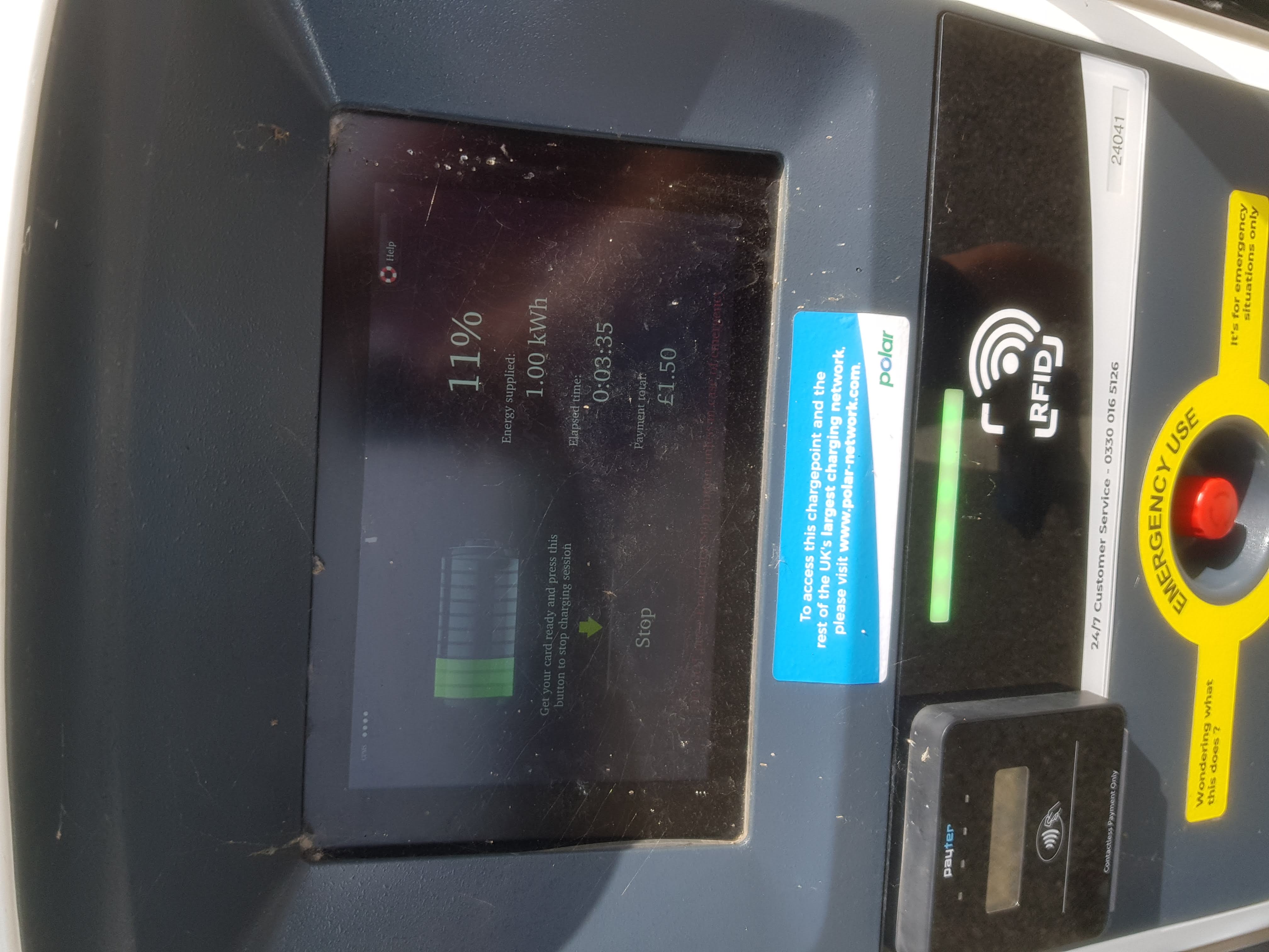

Dont recall advertisements, but they look like this
