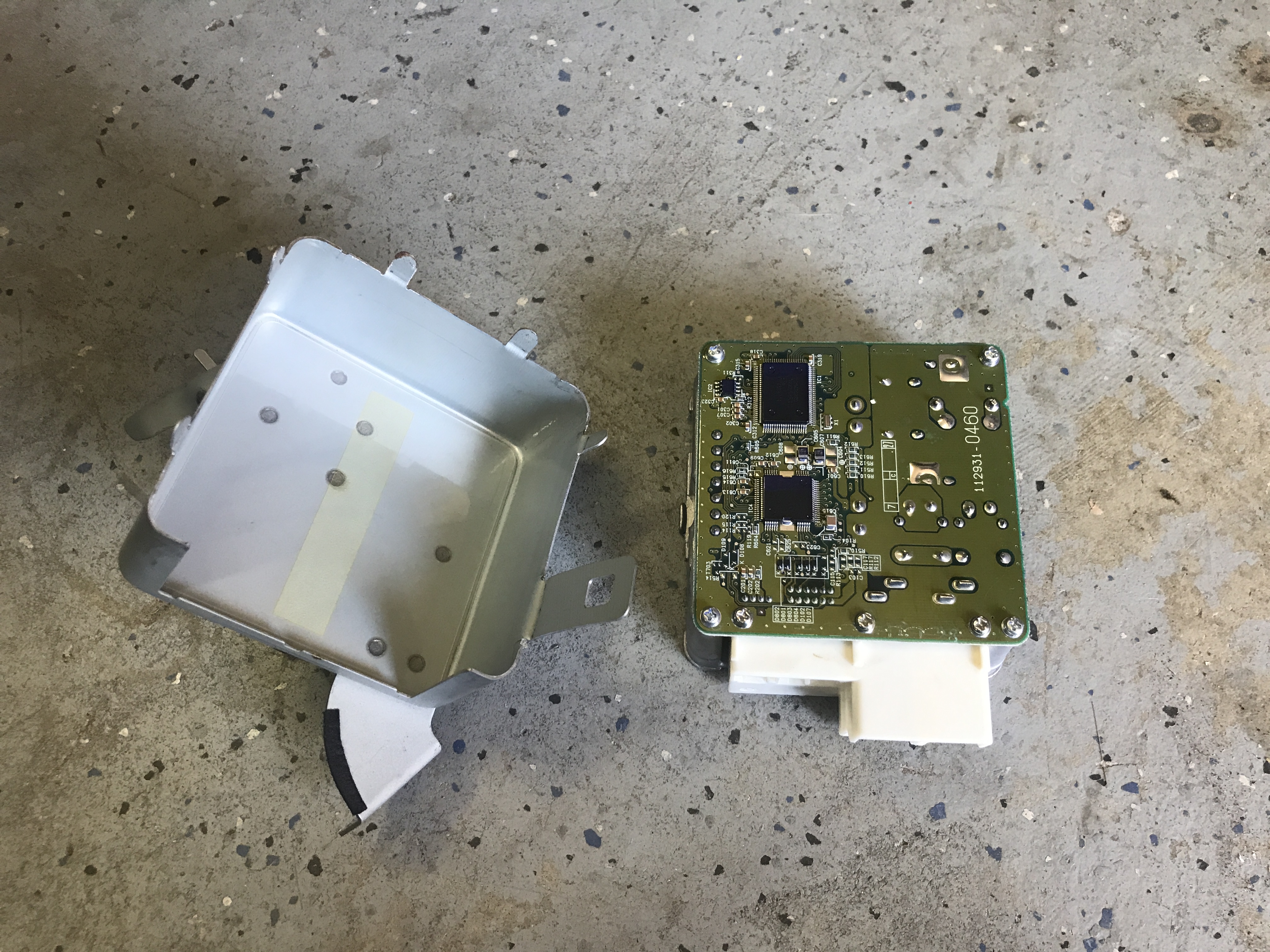

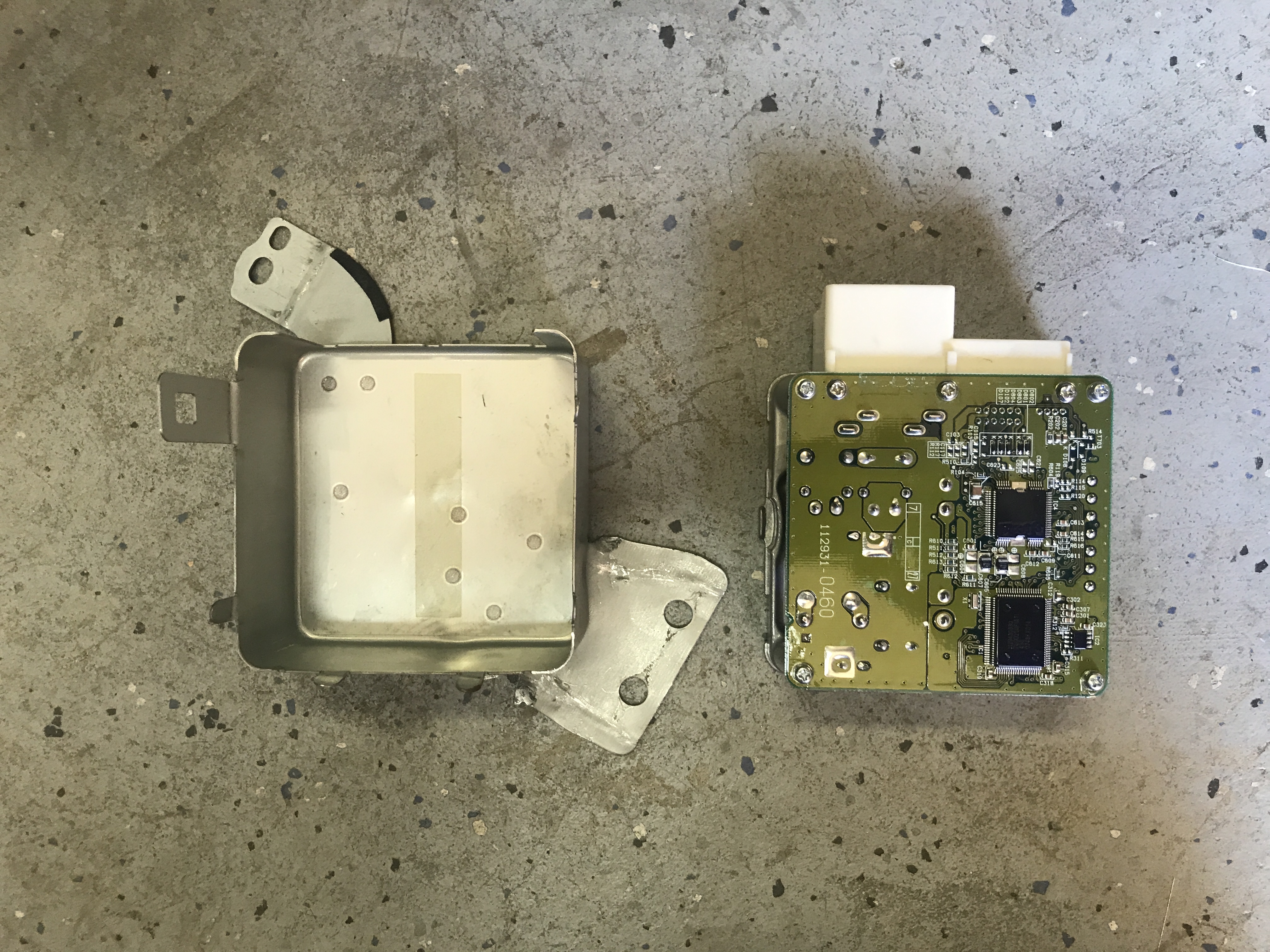

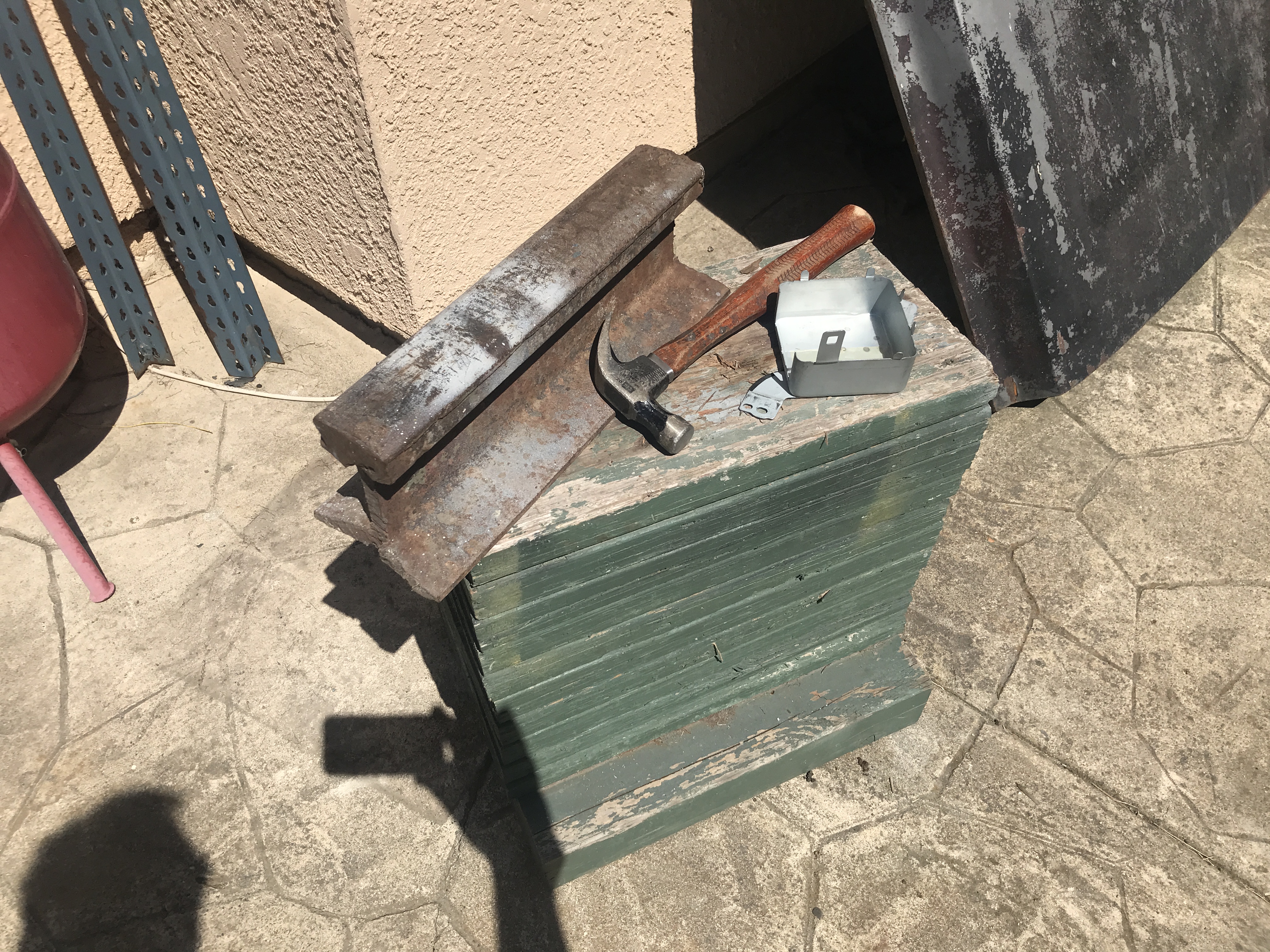

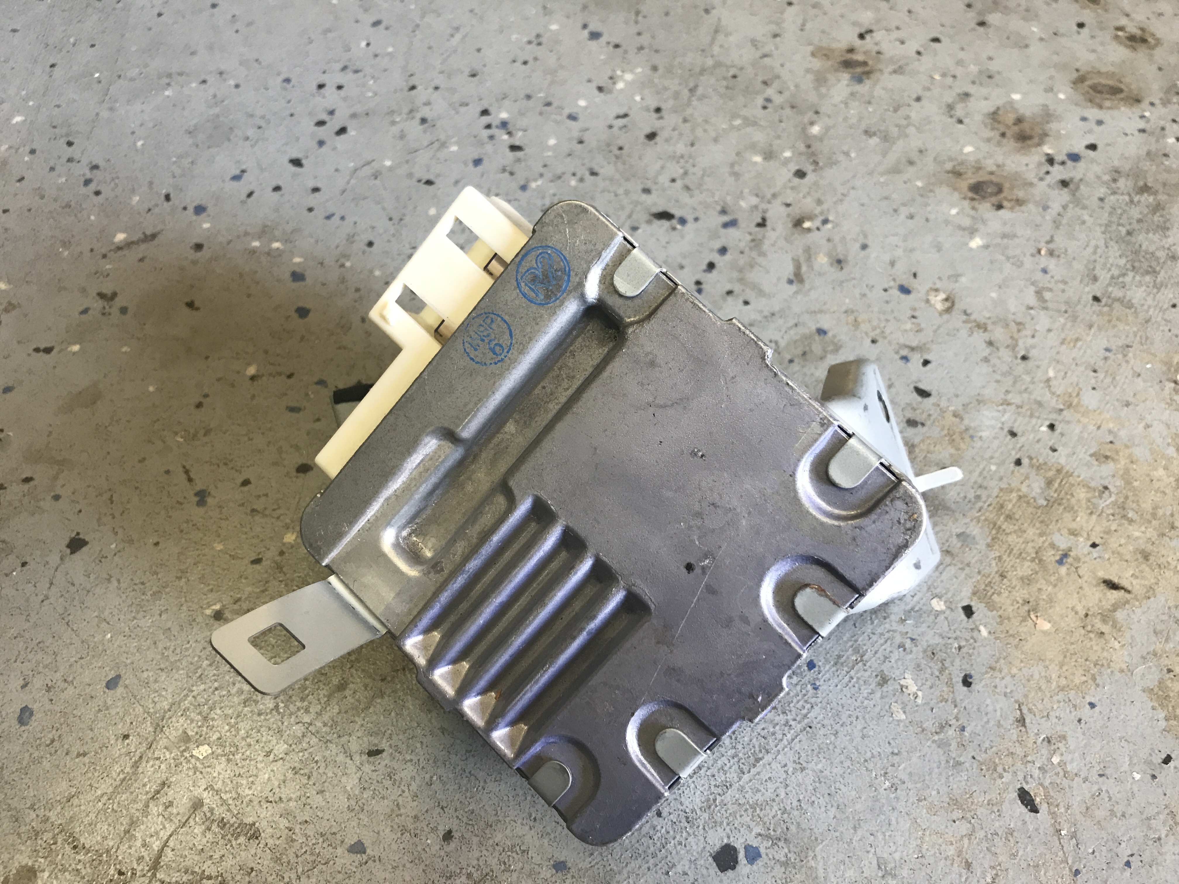

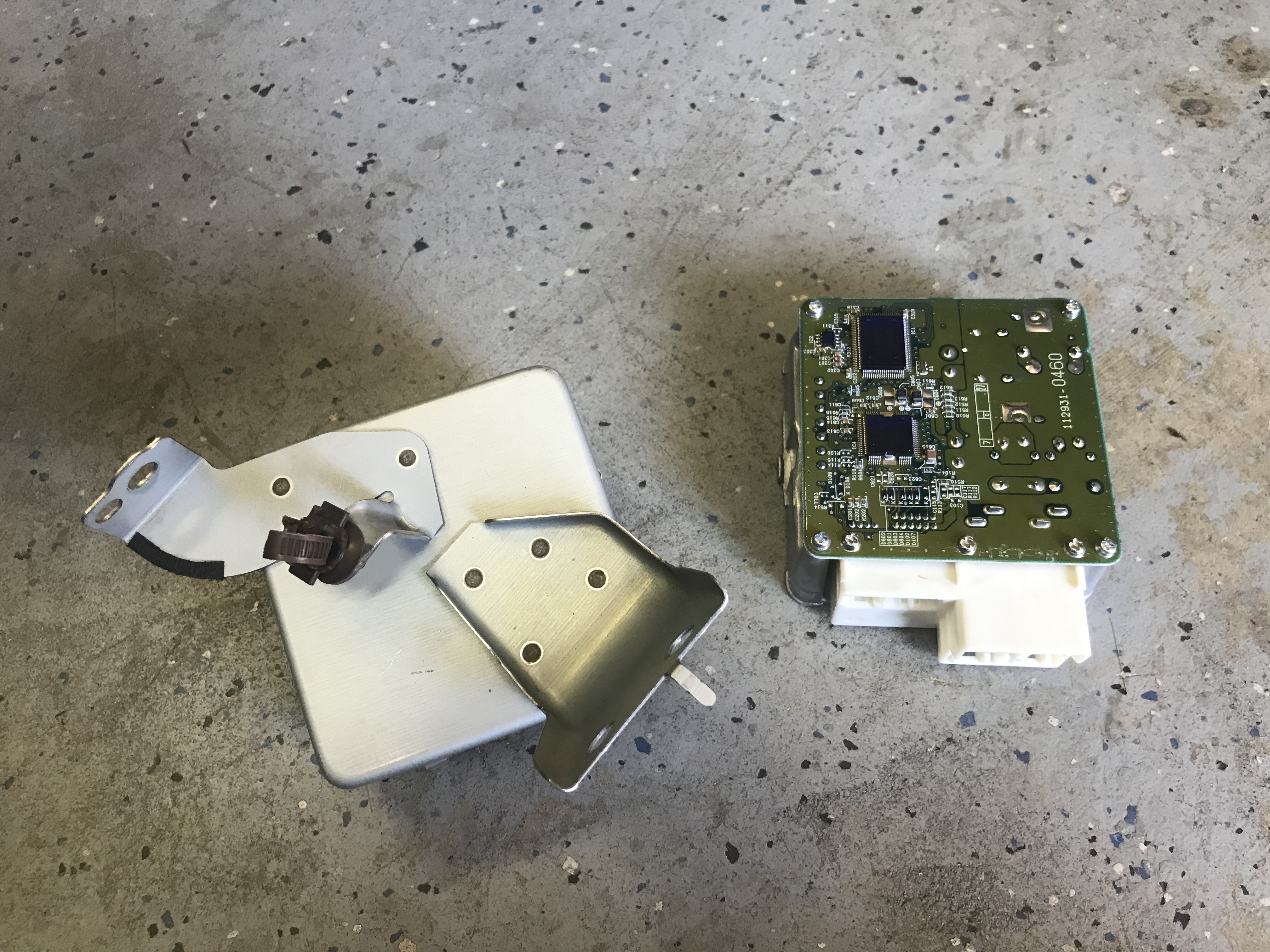

Re: Prius Gen 2 EPAS - Electric Power Assist Steering
so I decided to mount the control box for this thing today and thought you mind find some of this content useful, for instance we can easily remove the lid off of the module and that allows us to flatten those silly OEM brackets on the back of it
