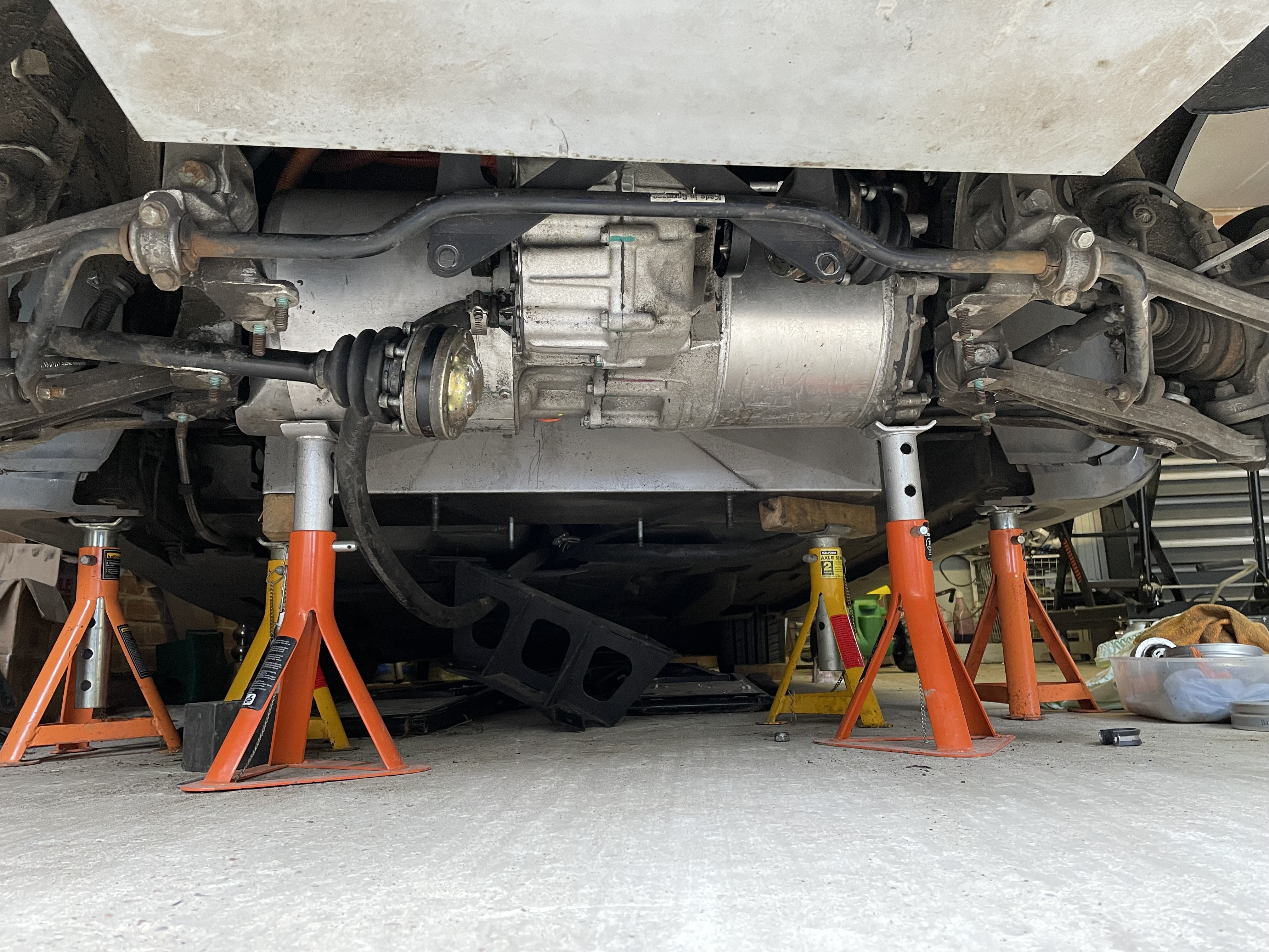

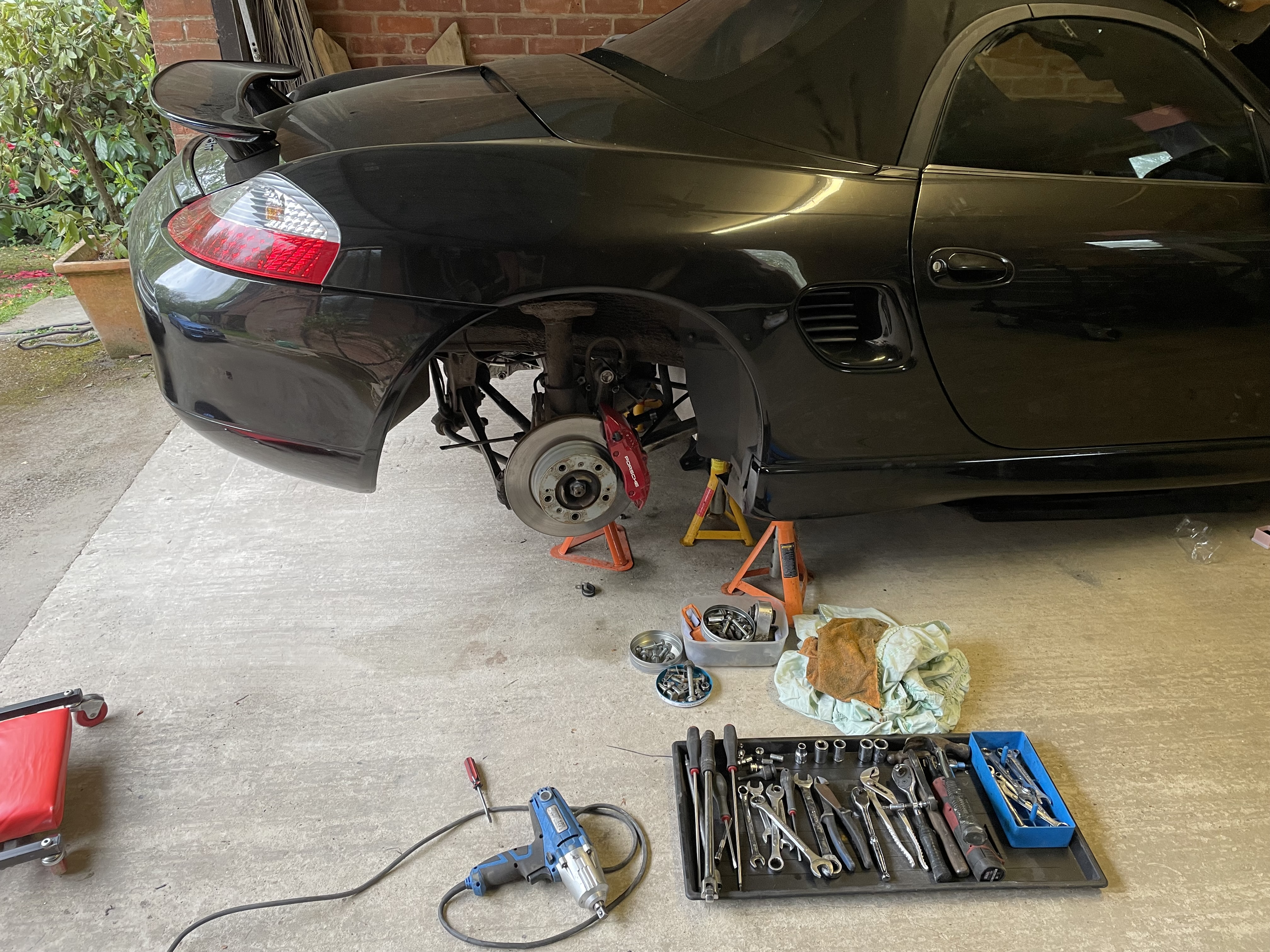

Well it’s been an interesting time of late… When I first completed the conversion give or take a few small issues, the car ran faultlessly for a year or so, which certainly led me into a false sense of security, as over the past four months it’s just been one challenge after another.
The biggest catastrophe was that my Chevy volt DCDC decided to let out the black smoke. I think it got a little damp during the winter months. I’ve since replaced it with an off-the-shelf IP67 rated unit (picture below) and relocated it nearer the HVJB for safety reasons. More seriously, when it ‘let go’, it sent a surge through the CAN BUS network taking out comms (CAN transceivers) to my VCU, ABS unit and gauge cluster. What joy!
The next little project was to fit the spare drive unit that I’d recently refurbished. Thread here. All seemed good initially but as documented, the rotor coolant seal continued to leak and since then I’ve sleaved the seal contact surface as a preventative measure. I’ve also drilled a small hole in the encoder chamber to monitor / dump any future leakages overboard rather than allowing them into the motor.
The key to removing the LDU quickly is having all of the tools ready So pleased that I used green loctite for the drive shaft bolts last time Vacuum bleeding the system
The next episode was that my e-pedal sensor which is original to the car, started to fail. It would exhibit pot readings high or lower than the according pedal travel. At little disconcerting to say the least. A replacement Porsche sensor and throttle recalibration fixed this issue.
So the car was back on the road, but because a quiet life would be far too simple, I thought; I know I’ll update the inverter firmware for fun…. Nope… Car off the road for another few weeks whilst I sorted this issue. It’s also meant the drive unit had to be pulled for the third time in a year to get access to the programming pins on the logic board to manually re-load the firmware with an St-Link. At the same time I took the opportunity to start with a fresh ESP8266 wifi module to mitigate futures issues.
They say the first sign of madness is doing the same thing over and over and expecting different results…. Well, in the sprit of improving this situation for my future self, I’ve modified my logic board to bring physical programming connections to the outside world, therefore if the thing freezes mid-update again, I’ll be able to re-flash it via a hardwired ST-link connection with no drama – that’s the theory anyway.

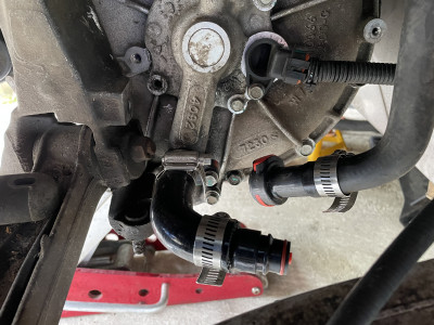

I’ve also fitted these rather nifty coolant quick release valves which mean the DU can be disconnected without letting air into the coolant system.
Well, back on the road for now. What could go wrong next?

Re: Porsche Boxster 986 Tesla conversion
I NEED to know the part name/numbers for that coolant disconnect setup. I poorly designed my cooling system and bleeding it takes forever. This would solve some headaches!

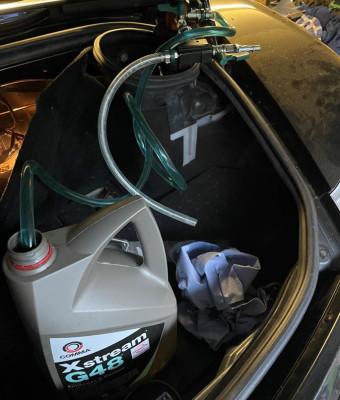

Not specific to this setup, be we'd been using vacuum coolant bleeders for years to obviate the need for "high point air bleeding". I think it was working on one of the low-hood Thunderbirds that pushed me into buying this tool.
Mine uses shop air (compressed air) to draw a vacuum on the cooling system via a venturi device. Any air pockets will have their pressure reduced to "almost" nothing in a few seconds. Then you stop creating/drawing a vacuum, switch a valve, and the bleeder allows coolant to be drawn from a reservoir (your coolant jug) into the low-pressure cooling system.
Works well. The hardest part of using it is flushing the tool of coolant and drying it before stowing it for next time. Since there's a YouTube vid on everything you can think of, let me see if I can find one . . .
I have an Airlift, like in that vid.
It looks like Boxster is using one as well:

A relatively small update for those interested:
I’ve been continuing to experiment with servicing and preventative maintenance of The Large Drive Unit and in fact have had some excellent exchanges on the forum in the LDU rebuild thread located here.. Although, the thread has since grown arms and legs (Google SEO now attracting Rav 4 EV and Tesla Model S owners looking to resolve their LDU issues).

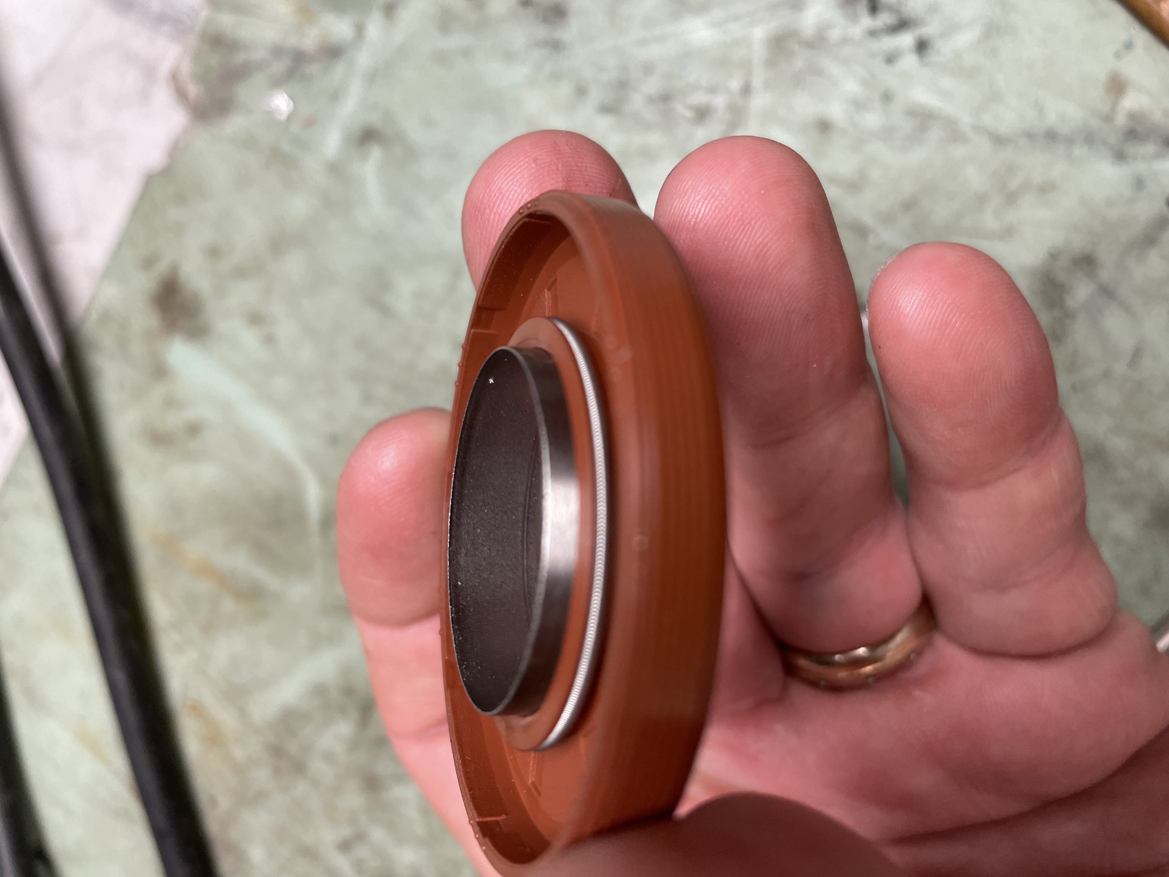

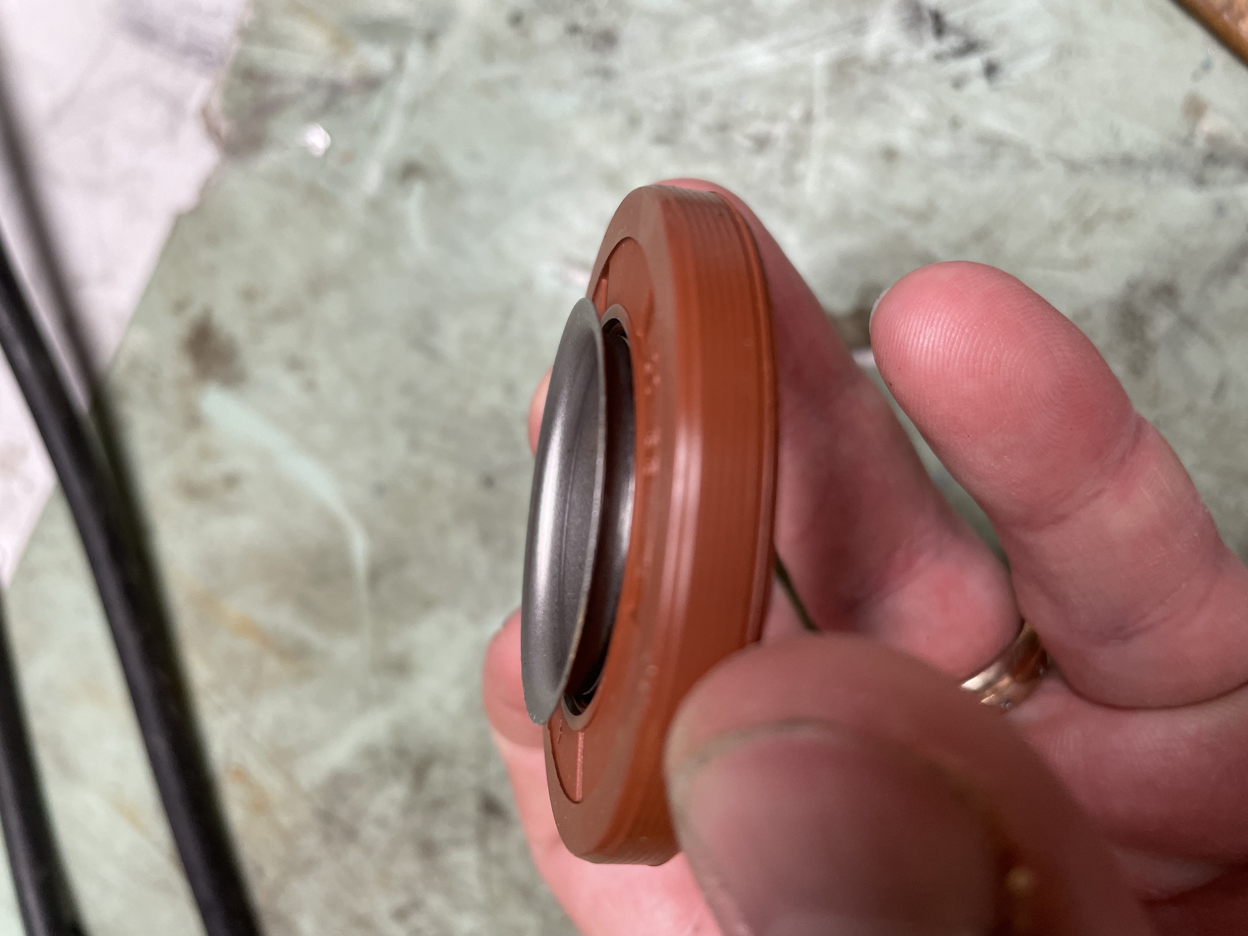

The LDU I currently have in the car is now running the SKF coolant manifold seal (on a SKF Speedi sleeve). At the time of writing I’ve put about 2500 miles on it and cannot detect a single drop of coolant inside the encoder chamber. Fingers crossed it lasts – I’d happily renew the seal every 15k or so miles if necessary.
In other news, some months ago I managed to replace one the Inverter gate drive PCB IGBT driver chips in a spare drive unit. You can read about that here and see the drive unit running here
The car has been driving great and has performed almost faultlessly despite being exposed to a record month of rain during early November. I think the drive unit tune is extremely close to what an OEM would achieve – super smooth in traffic with a nice linear power delivery as RPM increases. The only issue I have is that every now and again – let’s say every 250 miles, I get an overcurrent event when driving in very modest conditions – imagine gently feathering on/off the throttle – that’s when it occasionally happens. I’ve adjusted my regenramp and throtramp settings right down, but the issue persists. It NEVER happens when the DU is under load and to exemplify this, I can light up the rear wheels without ever hitting OC. Advice always welcome…
On the OEM side of things, I’ve started to notice several failures relevant to the age of the car. Sticky door handles, faulty alarm system, worn ignition barrel, noisy rear top mounts and a grumbling rear wheel bearing (I hate changing wheel bearings). I guess this is all to be expected of a 22-year-old car that’s being daily driven and all part of the process. I’ll reserve some time over Christmas to address everything.
Overall, I cannot emphasise enough how much I continue to enjoy driving the car. It’s just brilliant and I’m grateful this community exists to make it all possible!

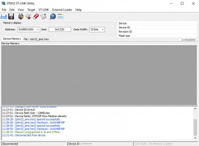

I have been running firmware version 5.14.R for nearly a year. This version had a couple issues in my application. I would get an occasional current spike (causing an overcurrent event) when gently coming off throttle to regen (OC never happened when the motor was under full load). To make the car usable I adjusted brknom, regenramp and regenrampstr to very mild settings to prevent this happening however it made the car feel lethargic under some conditions.
Today I upgraded the firmware to sine 5.20.R using the hex file and STM programming application connected directly to the board (I don't like doing OTA firmware updates). The update went smoothly and I've just put about 30 miles on the car. Initial impressions are that things are much smoother when on and off throttle, in fact, anecdotally everything seems smoother. I've reverted the above regen settings back to normal so I'll monitor whether my spurious OC event returns - so far so good and very pleased.
Few pictures of the filthy car and process:
