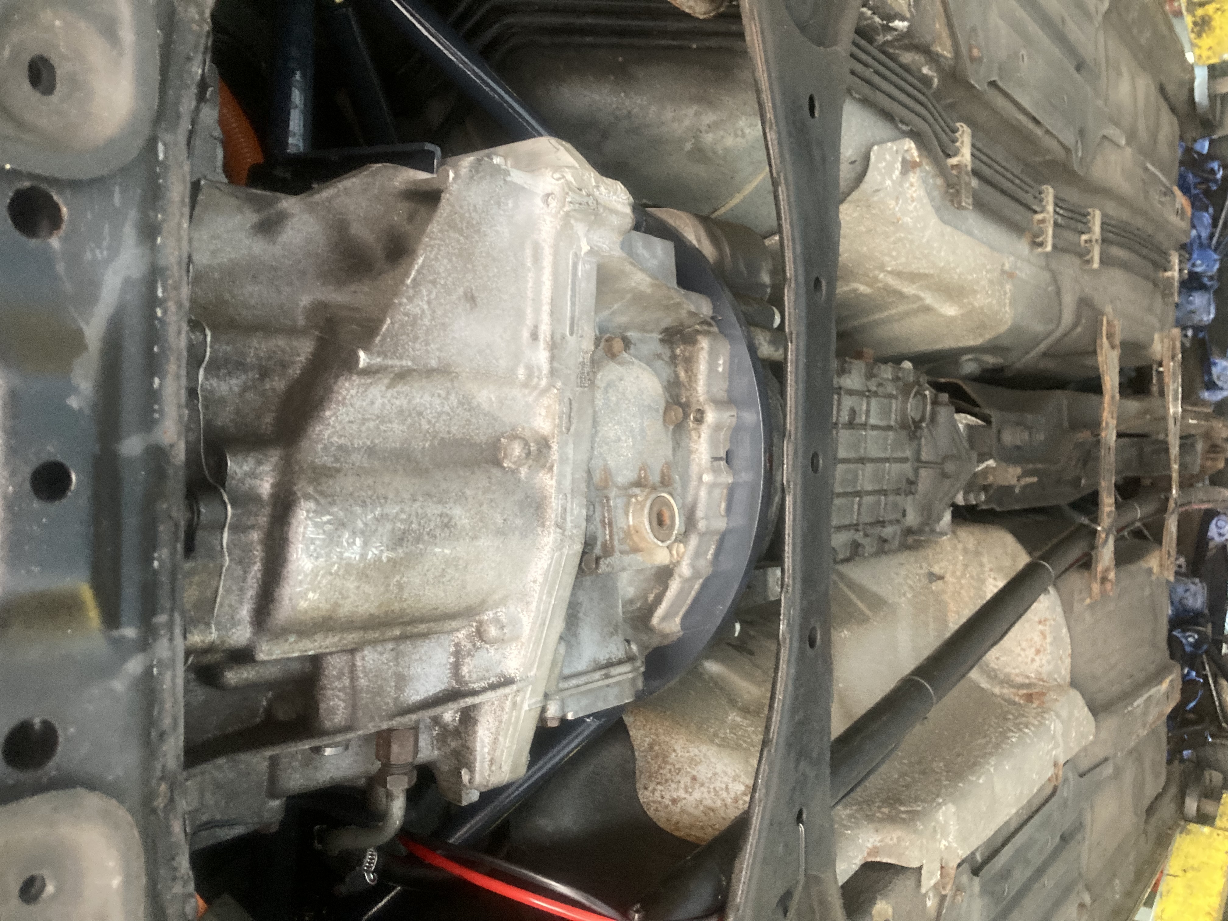

I also think that trying to foc tune 2 motors on the same shaft that are slightly misaligned is a pain in the ass as your having to overcome the cogging of the magnets on the non driven motor

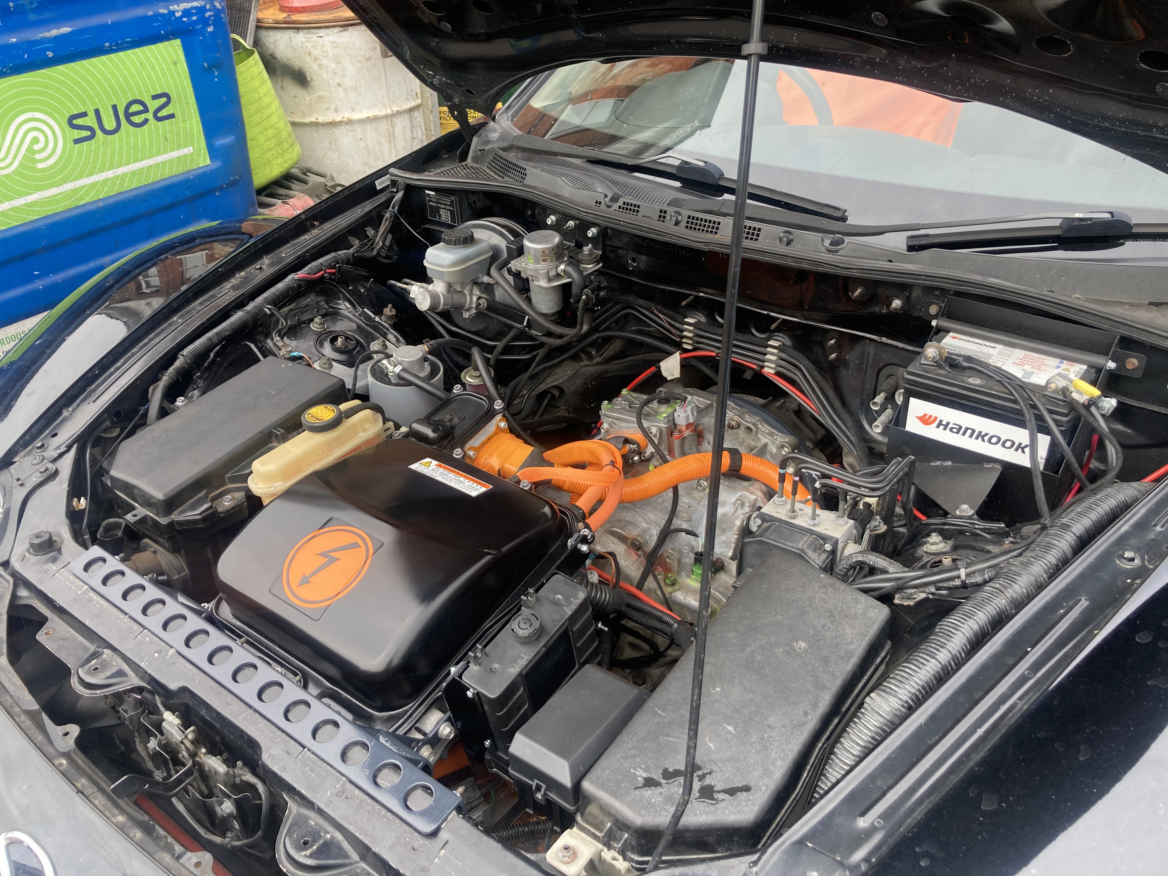

Well with a mostly drivable tune, the wiring tided up and finally finding the right can messages to convince the abs the engine ecu is still there I’m about ready for a fresh mot and some real testing.

Very professional looking project, can't wait to see how much power you can get out of it.

Thanks, I do a fair bit of custom fabrication as part of my job, it’s probably when im at my happiness,
Currently it’s drivable but lacking in power over about 2500 rpm, basically the first upgrade in the pipeline is to up battery voltage

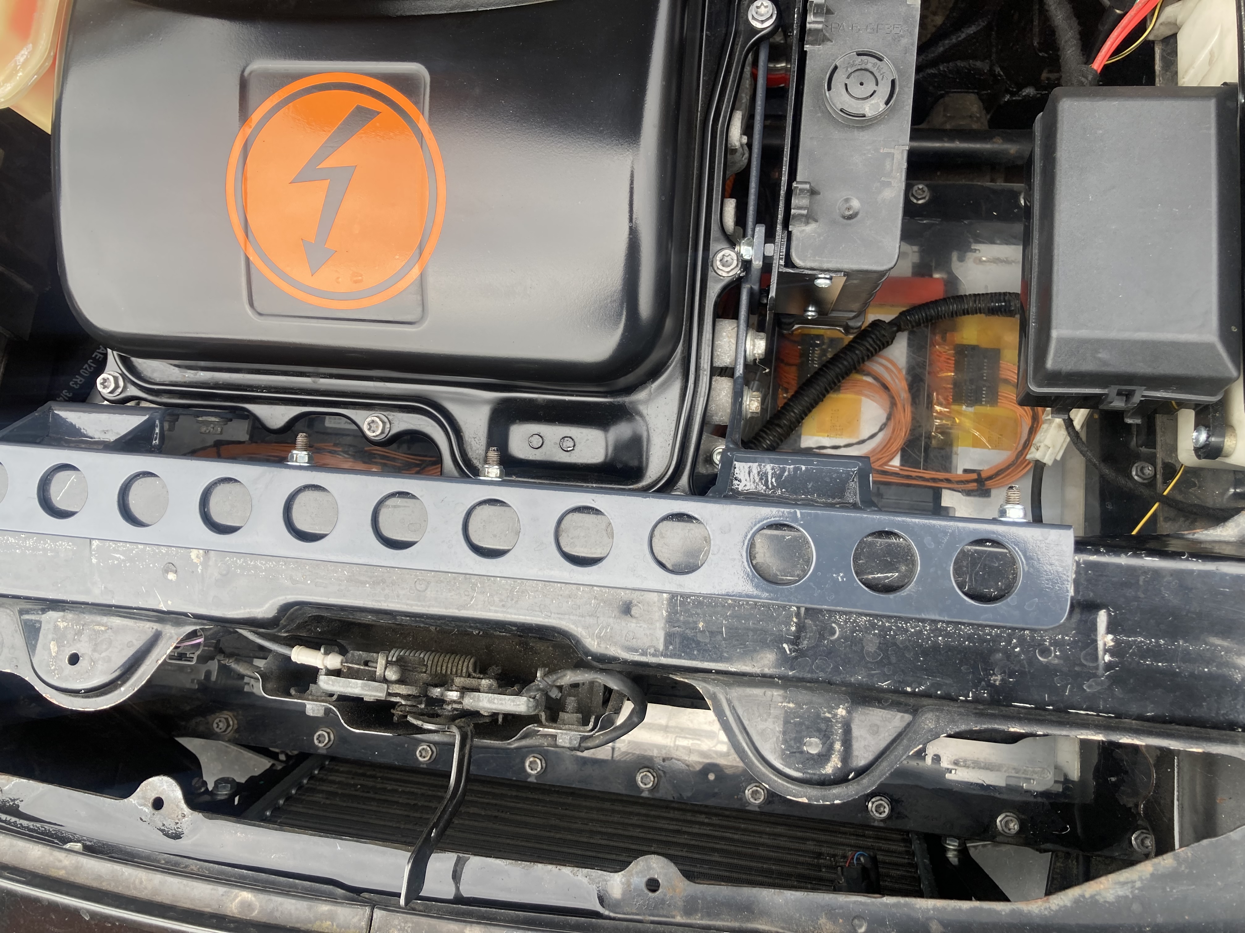

Awfully clean project!! I'm going back to clean mine up before posting anything. Do you have a vacuum reservoir with your brake boost setup? You got cooling all plumbed in too?

Nope no vacuum reservoir, I did on the previous setup that used a Saab pump and switch it needed one because of the lack of hysteresis, but the Audi pump and johu’s board works well without a reservoir,
Cooling is all plumbed into a fiat cinquecento rad behind the bumper,
And the auxiliary oil cooling pump which runs when the motor is turning has an oil cooler radiator beside the left fog light

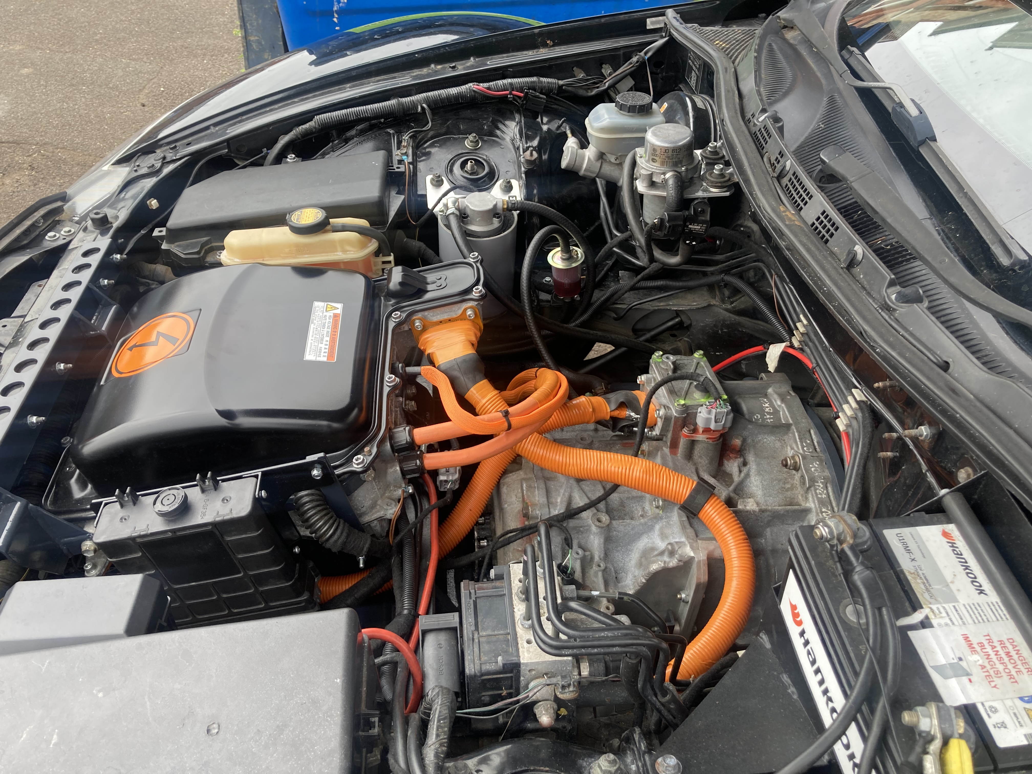

Well it’s been a year off the road and a complete re engineer of the drive system, almost to the point I’ve basically converted 2 cars now, but I’m back on the road Mot passed and drove home, some interesting slow speed drivability kinks to sort out so lots of software tuning to do, but I’m happy to have made this milestone

Ok 1 week on the road and 40ish miles of to and from work, ( I live in 2.5 miles from work so every day is a test drive, not an efficient one either!) I have been playing with syncadv a lot slowly increasing it, I’m up to 14 now with no Ill effects, increasing it certainly helps maintain power higher into the revs,
I like others have experienced am getting strong regen when lifting off the throttle when over 4000rpm which will persist until revs lower significantly then returns to normal with a jolt, I need to test if this is the case with regen turned off or not? If so maybe some kind of regen disable above a certain rpm may help, I only run 5% off throttle regen as I prefer it this way.
Happy with the progress so far,

2 weeks of driving around town and even briefly on the dual carriageway upto 70mph, some more tweaking of the tune, and I’ve learned some more things, like 3rd gear is perfect around town and pulls away fast but I need to change up to 4th for over 50mph so I really need to rig a regen kill switch as turning the regen pot down and up again is too much work, I’m think button on the gear knob or maybe reinstall the clutch pedal with a switch? Not sure yet. Also 3rd gear in this box is damm noisy compared to 4th but 4th is just too sluggish at the bottom end and pull away to leave it in.

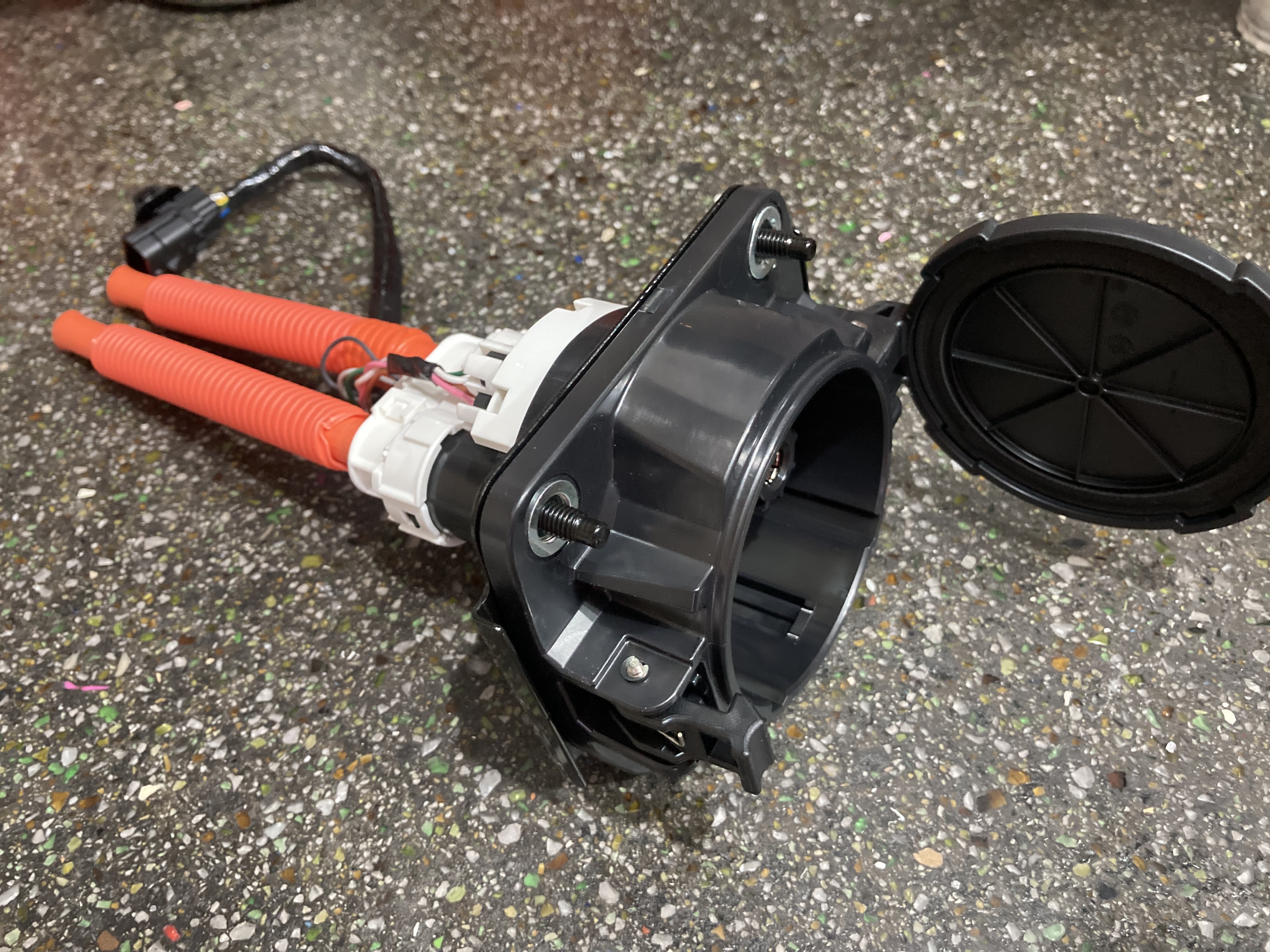

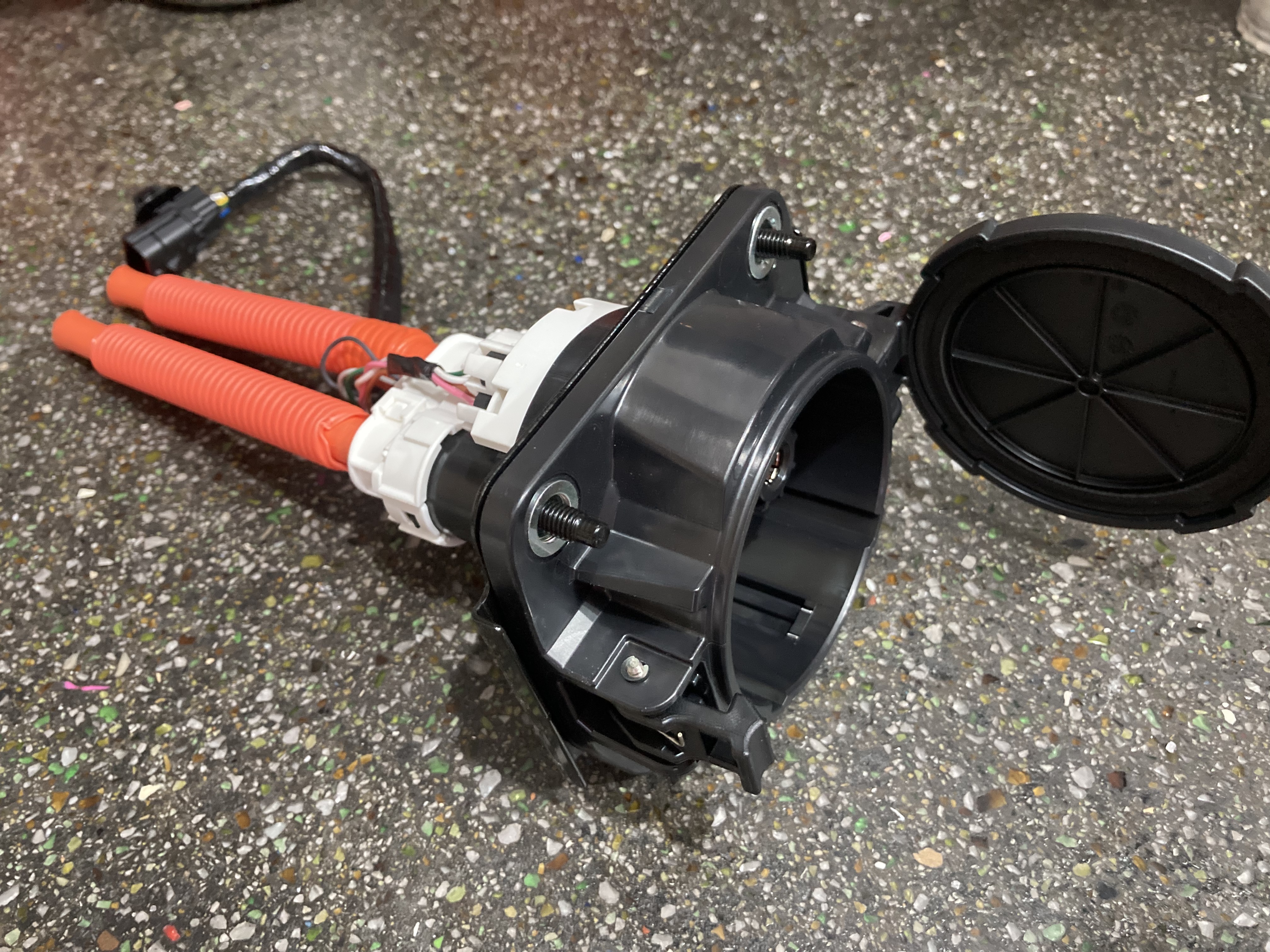

Ok so with the uk weather suddenly turning into 3c in only a couple of days things have changed priorities, I had started project chademo by cutting a hole in my bumper to make a flap to cover the charge port.
Please excuse the crudeness this is currently just wired to a 240v plug as I have been putting the car on charge for an hr before leaving in the morning to warm the batteries a bit, so I will just plug this in at the same time to dry and pre warm the cabin, mid term I will wiring the dishwasher heater into the battery, repurpose the thermoswitch to turn a contactor on and off, and maybe try and put a box around it and mount it better than zip tied to the abs pump!
But now it’s cold and this car is my daily transport so it suddenly beacame a case of I need a heater quick to de mist my windscreen, what can I cobble together out of stuff I have laying around?

How on earth did you cut such a neat hole?

That was my first reaction too. Must be high accuracy laser cutting for sure
EV8 I would like to know how you are heating your batteries? Do you have coolant circulating through them and you heat that coolant with some sort of coolant heater?

To cut the hole I used a fine toothed fretsaw blade, snapped the end of it off and heated it with a blow torch on the end to melt through the bumper to get started, I had masked it all up and drawn it out neatly so I had something to follow,
As for battery heat currently I have nothing other than the warmth they create giving them a charge for a bit, but the front modules are actually sat on heated seat mats in their box but these aren’t wired in yet, rear batteries are inside the boot a stay a couple of degrees warmer,

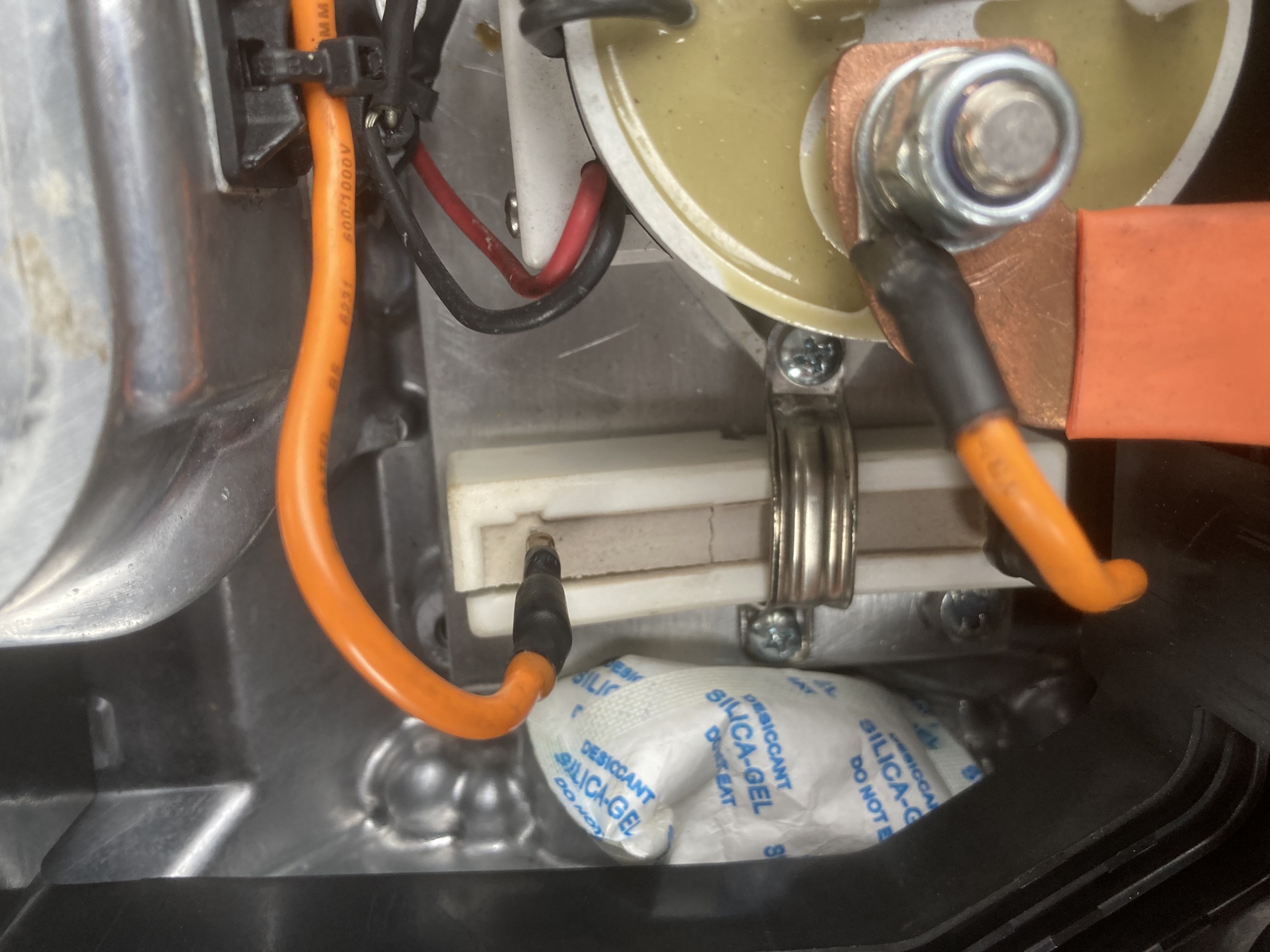

Re: Project RX8 , Prius gen2, Lexus transaxle to rwd
Precharge resistor completely split open but somehow still working!
- Posts: 1801
- Has thanked: 102 times
- Been thanked: 347 times
I'm guessing that moisture has caused that.
The porous ceramic package has soaked up a bit of moisture from humid air and then when the precharge has happened the core of the resistor has got hot enough to vaporise the water and the rapid increase in volume/pressure splits the package. Not too surprising that it is still working as that failure mode wouldn't stress the resistive element too much. You can get similar effect if electronic ICs that have been stored in humid conditions are reflowed without baking.
See you have a silica gel package in there but it is surprising how quickly they get saturated and stop doing much and with the cold weather recently it wouldn't be surprising if it was slightly damp in there.
Well I’ve just replaced with an aluminium bodied 100w 15r resistor hopefully this will be less prone to this kind of failure, I have some silica packages here that are self indicating so I’ll get them in there
