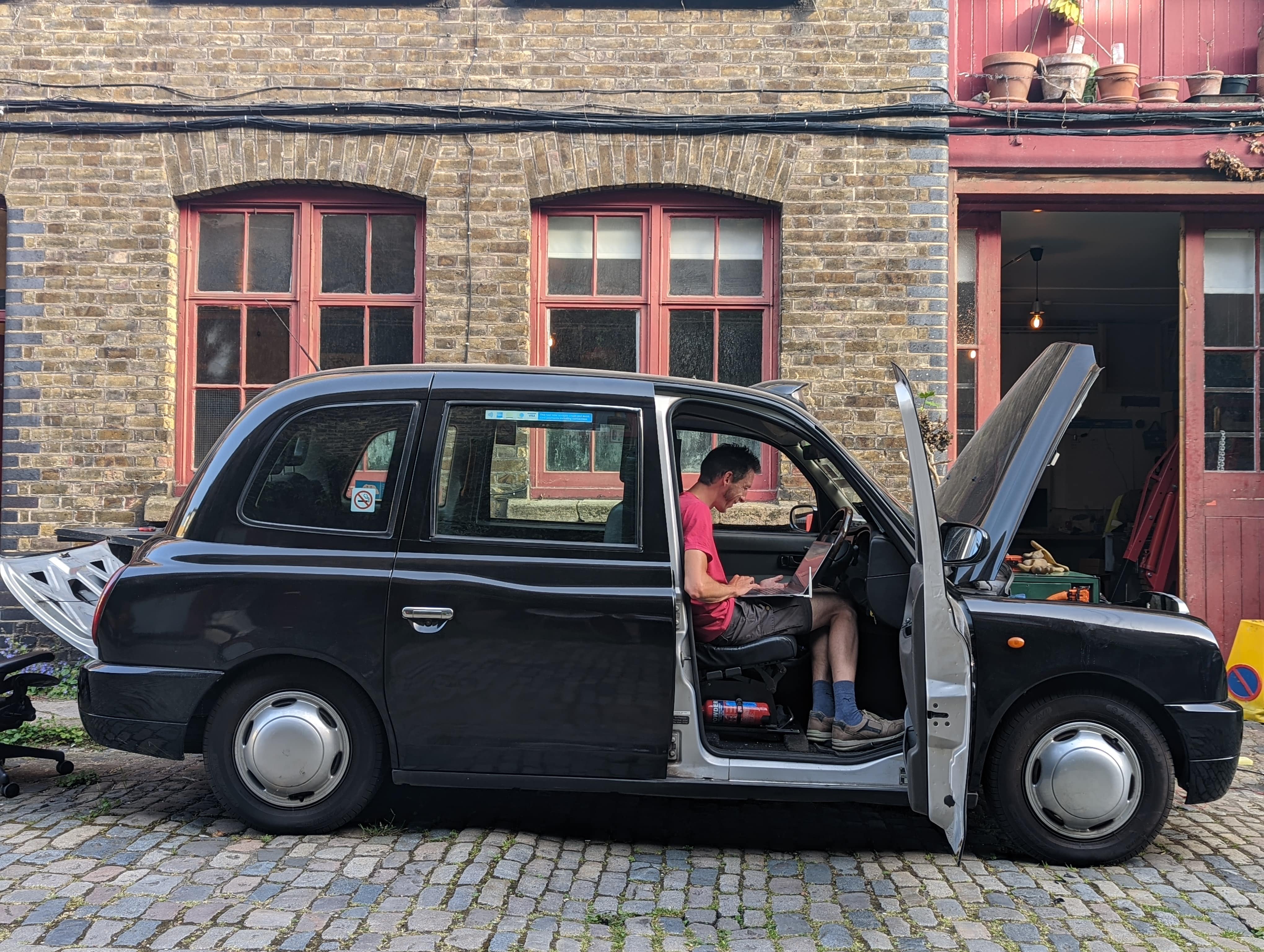

Might as well add some photos here.
Including my trophy shot (god knows how I managed to get myself into a photo with both of them!).

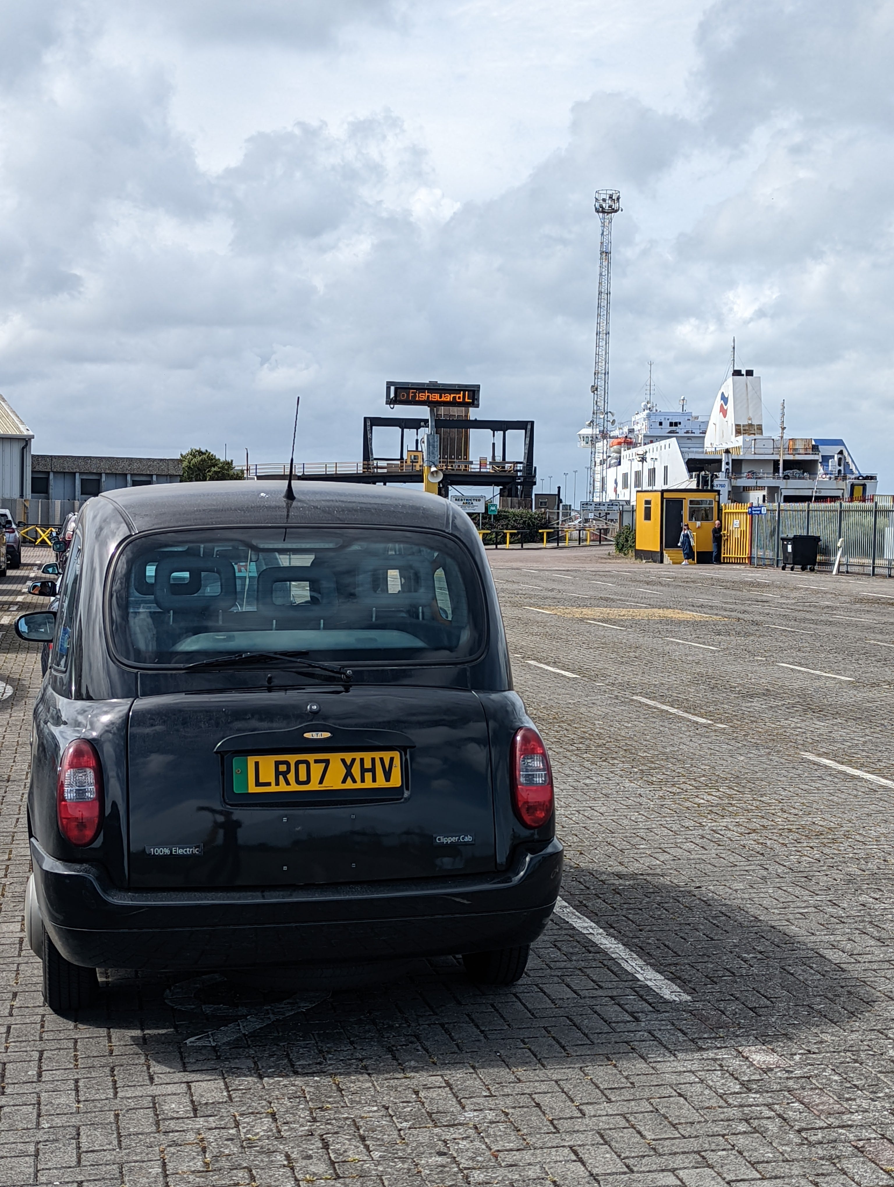

The journey back after delivering Johannes was pleasantly boring, once you know which chargers worked, there wasn't much planning to do on the back-leg.
I skipped the Swindon stop and drove the 250miles from the ferry terminal in Wales to London in one day. No issue or staying up into the early hours, and quite satisfyingly: A typical taxi driver does only about half that mileage in a day.
In total we traveled 755+ miles in the vehicle, nice little stress test. Previous journeys were in the low hundreds of miles.
