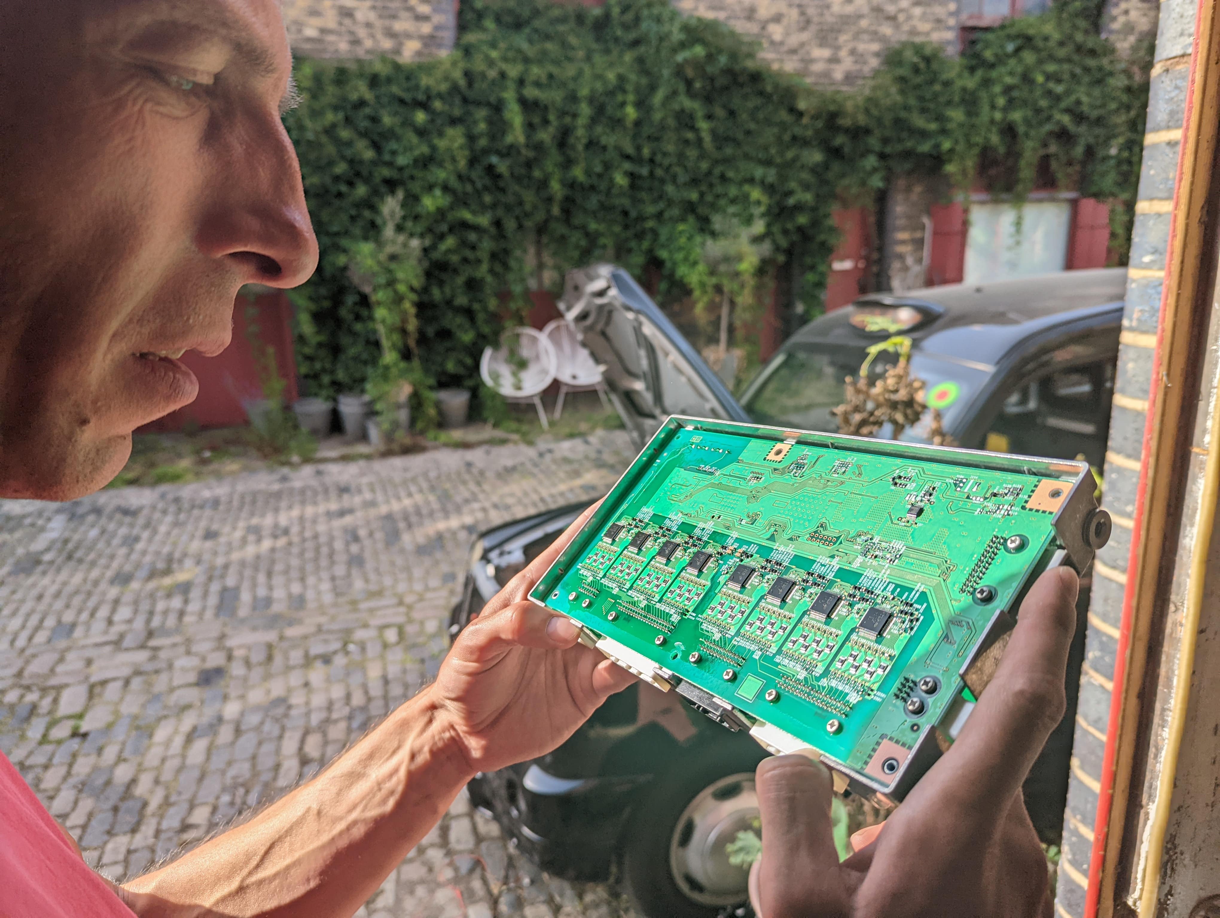

After some charging we decided to start towards Fishguard (that's were the Ireland ferry leaves) on Thursday. Due to a silly mistake we had welded contactors the day before and in the morning I set about freeing them with a hammer. Now the clipper battery boxes with 1/2 pack each are wired up to split the pack up to 1/4 when the safety disconnects are pulled. That sounds pretty sane at first because you're down to like 100V maximum. But the Leaf BMS doesn't expect there to be a continuity break so guess what happens if current wants to flow while the disconnects are out... Yes crackling sounds and a very wounded PCB.
So we put in the only remaining BMS only to find it not working as well. Already thought about booking trains to get to Ireland but then I found just one resistor between adjacent chips had blown - for whatever reason. Replaced it and were back in the game.
