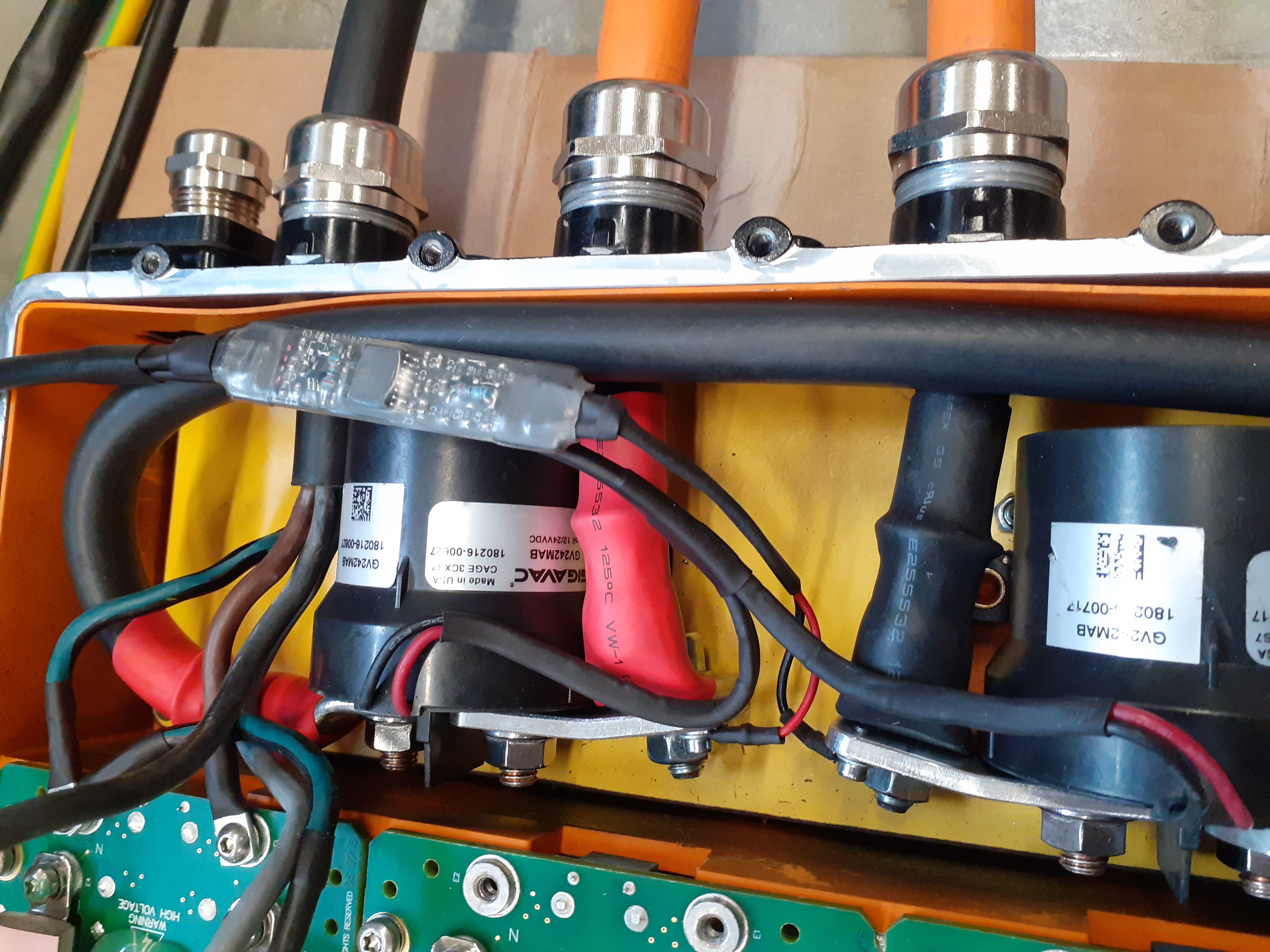

You then need an extra ISA shunt, which must also be connected to the HV line. So it needs as much HV cabling as my solution. I put everything in the charger, so I don't need any external HV lines.
The two thick cables on the right go to the charge port, the two on the lower edge to the battery. The two little orange ones supply DC/DC, A/C compressor, battery and cabin heater.

So I should elaborate on my ISA shunt plan. I don't see a practical necessity for the ISA voltage when I have CAN reporting of the BMS. So it would just run the HV measurement off the CCS contactors to the ISA as Im 99.9% sure the current and voltage can be mutually exclusive. Everything is already planned to be in the same contactor box, so there's no external running of HV wires. But again, thats why Im asking for feedback.
If that wont work, Ill need to move to the next larger sized enclosure, which isnt deal breaker, but I like the compact size of this one.
Re: BMW LIM based CCS2 Controller
Disregard my ISA tangent. I made it all fit. Still need to do some routing and put the isolation cutouts back.
