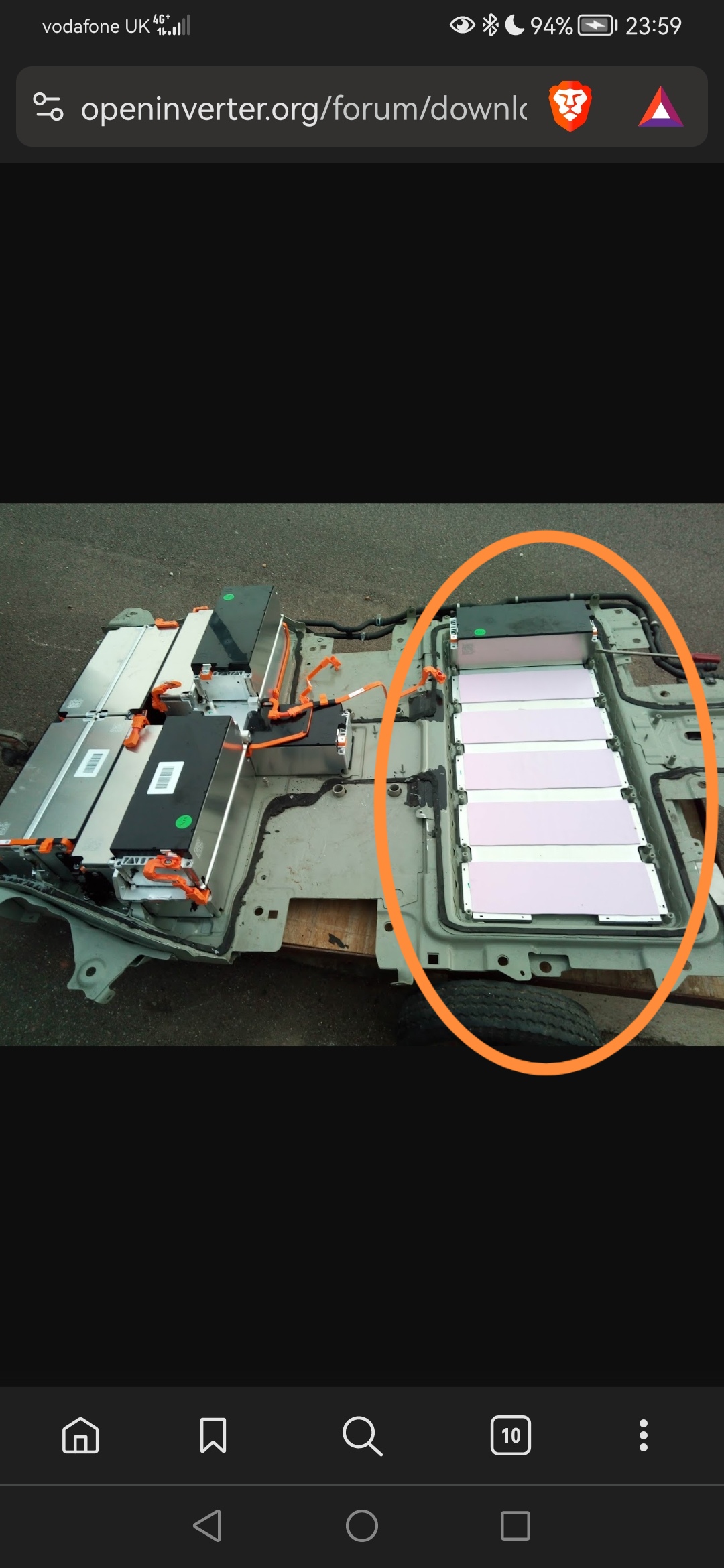

Re: Pugeot E-208, Corsa E, etc. battery pack.
Hi
I would like to ask you if that metal cooling plate is a one part? Or this is five connected metal plates?
I bought E Mokka and it has a same battery, I bought it with damaged battery, and that metal part which cooling pipes goes in to are broken. Also probably the metal cooling plate is broken too. Maybe you have it for sale?
- manny
- Posts: 33
- Location: Netherlands
- Has thanked: 2 times
- Been thanked: 20 times
hi
The part you circled is one big part. I have a empty shell with the cooling plates that i am not using.
Where do you live?
Manny
Where do you live?
Manny

Hi, thank you for your reply. I live near Manchester, but happy to travel to pick it up. As my battery pack was impacted from the bottom and probably that metal plate is damaged as there is a leak of the coolant.
Is there any chance that I can buy it from you?
