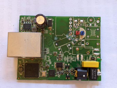

Re: Open source PLC V2G (CCS) using AR7420
I found this article, which shows how to easily modify a TL-PA4010 to remove its AC power supply, power it from 12v, and wire its data lines to DC: http://www.helicopting.de/
I've ordered a couple of these, which I will modify accordingly. This will allow me to verify communication with a CCS charger. I have also ordered a powerline adapter with a QCA7500, to see if this chip supports the EVSE side.
In the meantime, I'll start reading up on the higher level protocols, but step one will just be to see if I can connect to, and ping, an EVSE. I don't know if it's worth trying to buy these chips, but I'll be happy putting a modded TL-PA4010 in a box with a rPi.
I've now modified a TP-Link TL-PA4010. The device now runs on DC, and the data lines are exposed directly. This modification appears to work, and should now be ready to hook up the the CP and PE lines of a charger.

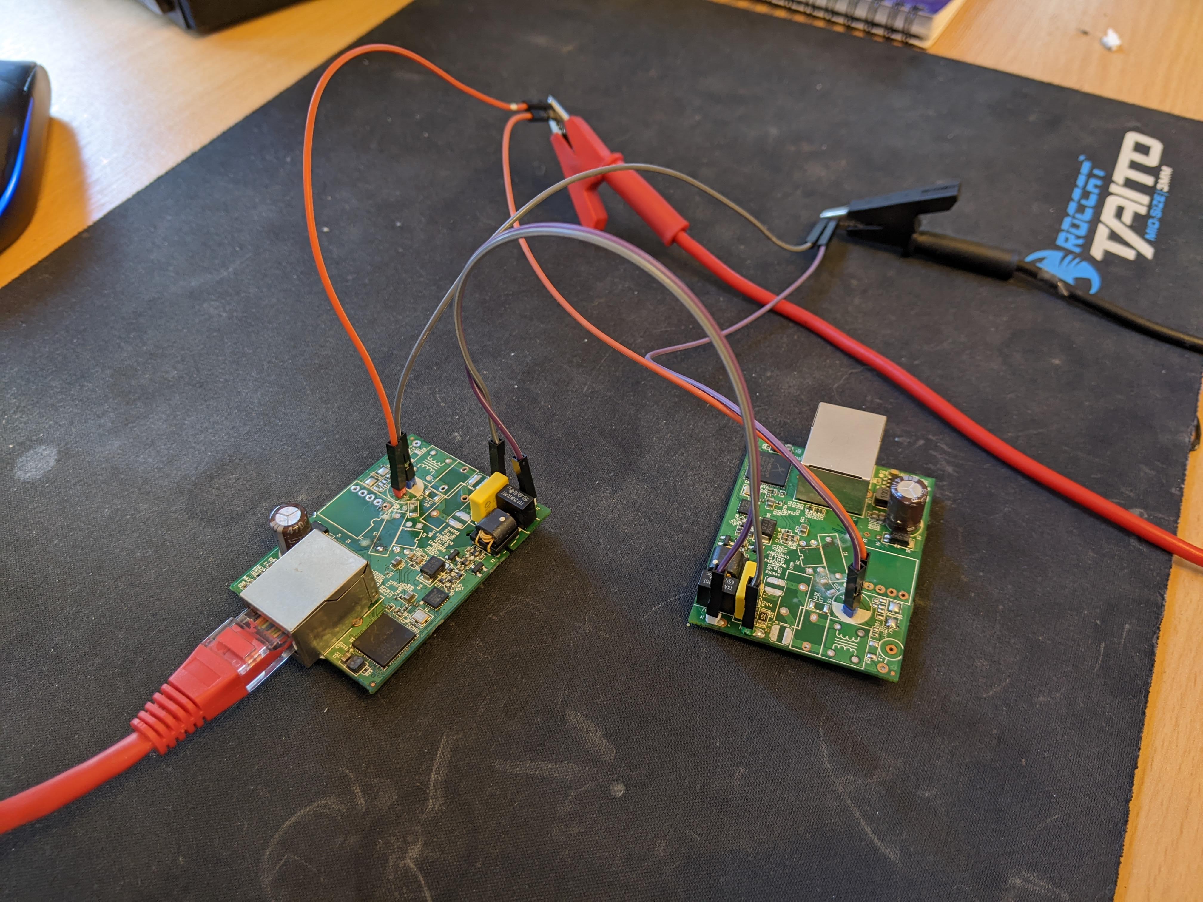

I've tested using two of these boards - one simulating the EVSE and one simulating the EV. The AR7420 does not appear to be capable of signal attenuation measurement, so I've had to fake the signal levels on the EVSE side, but this isn't a problem for this project. SLAC negotiation completes successfully and a network is formed. Definitely need to try this against a real EVSE before diving into the higher layer protocols.
That's a highly interesting project. I used a similar setup for sniffing a "real" CCS communication between the car and alpitronics charger. I experienced, that there seem to be slightly different results depending on the detailed type of adaptor. I now ordered now a pair of TP-Link TL-PA4010 to check also them. With a devolo dLAN 1200+ I could not send nor receive the SLAC frames at all. With devolo dLan 200 AVplus I see the SLAC, but I was not able to set the NMK using the CM_SET_KEY. I'll further investigate.
I collect the current state in https://www.goingelectric.de/wiki/CCS-T ... e-Details/ (in German, unfortunately).
Did you find a data sheet for the AR7420, where the detailed conditions for acceptance/rejection of CM_SET_KEY is specified?
I only just saw your message, sorry! I got myself very worried and spend 4 hours debugging what might not actually be an issue at all!uhi22 wrote: ↑Mon Mar 14, 2022 3:32 pm That's a highly interesting project. I used a similar setup for sniffing a "real" CCS communication between the car and alpitronics charger. I experienced, that there seem to be slightly different results depending on the detailed type of adaptor. I now ordered now a pair of TP-Link TL-PA4010 to check also them. With a devolo dLAN 1200+ I could not send nor receive the SLAC frames at all. With devolo dLan 200 AVplus I see the SLAC, but I was not able to set the NMK using the CM_SET_KEY. I'll further investigate.
When sending CM_SET_KEY to my plug, it returns a failure code. But... it seems to set the key anyway! Interestingly, the Qualcomm SDK treats the failure code as a success...
I'm starting to think there's a typo in the specification. Not sure if I'm going crazy? https://github.com/qca/open-plc-utils/issues/161

So today I finally had the opportunity to connect my TL-PA4010 to a CCS charger. The short version is it works!
I was able to initiate a SLAC negotiation with the charger, fetch the network key, and apply it to my AR7420. I was then able to send a muticast UDP discovery packet to the charger and received an appropriate discovery protocol response, so the connection is definitely established.
Full PCAP of my testing session is attached!

Fantastic. There's a guide here to modifying them which shows a version slightly different to mine. http://www.helicopting.de/
My progress is pretty minimal so far. The next step is to learn EXI, which is required to encode requests.
