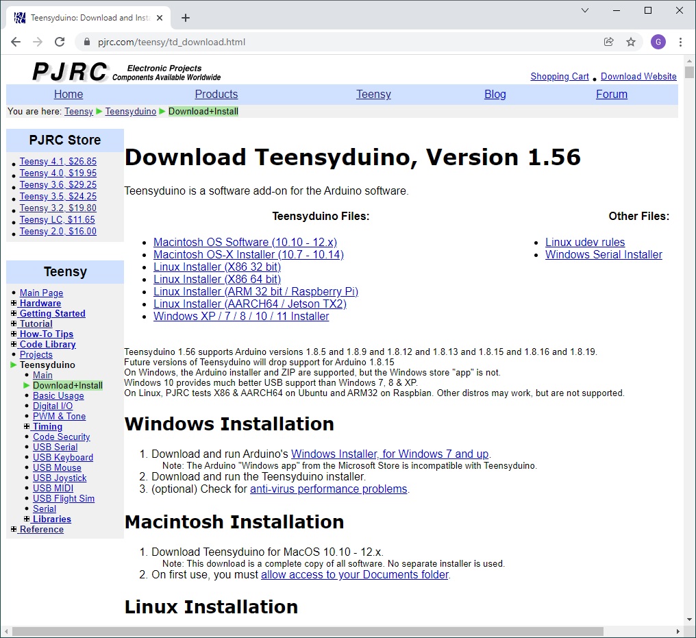

Just a thought, have you got Teensyduino installed? (The Arduino IDE that's been "teensyfied")

mjc506 wrote: Fri Mar 18, 2022 2:15 pm Just a thought, have you got Teensyduino installed? (The Arduino IDE that's been "teensyfied")
yes and got it working with Tom de Bree's SimpBMS
