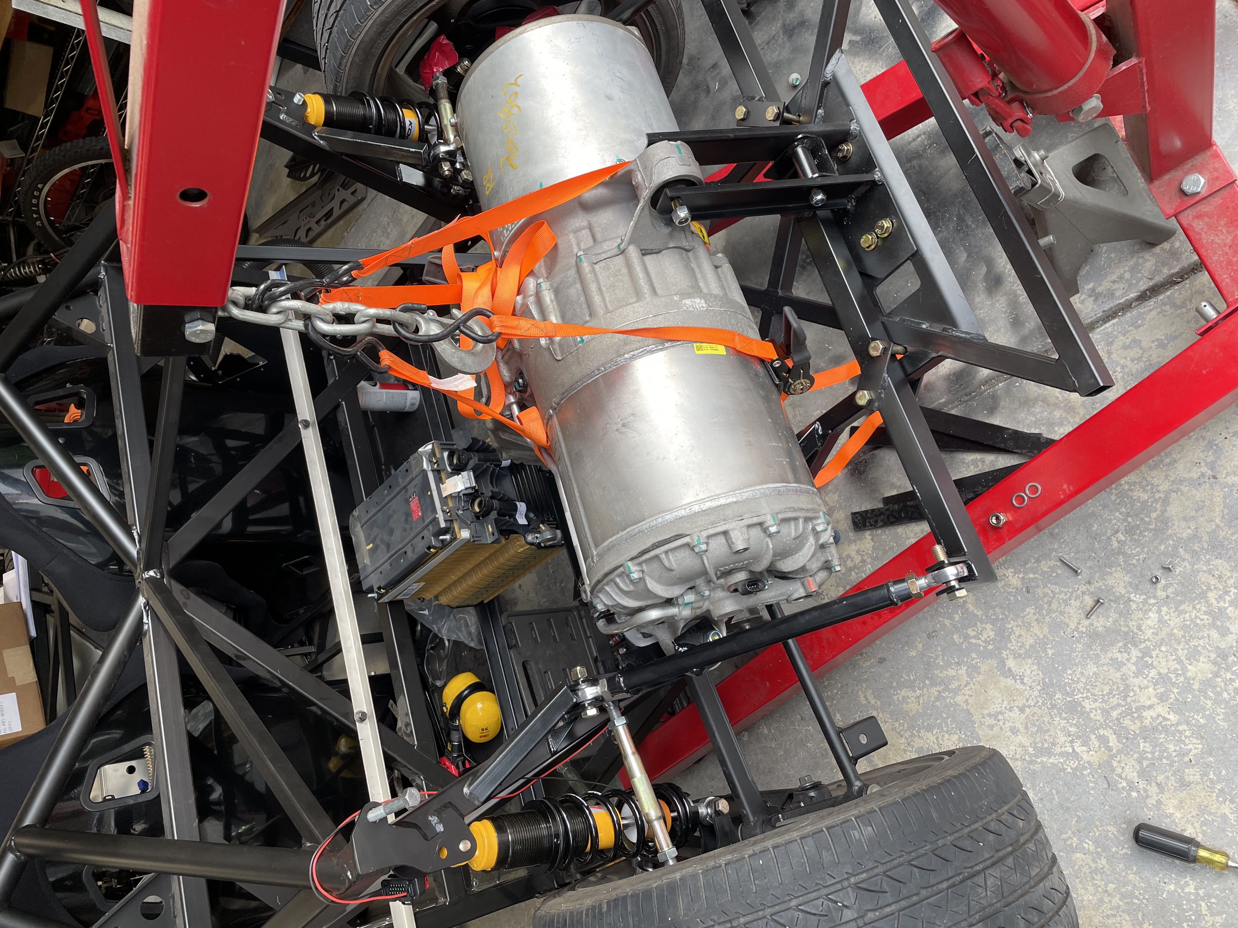

After seeing EV-Control make an 818C a few years back I have always wanted to do my own spin on it. I started the project a few months ago but figured it would be worth documenting my progress here in case someone else wants to do a similar project.
Specs:
FFR 818C
Tesla LDU Sport 2014 - From a Model S
2x Chevy Spark EV 2016 batteries (LG Chem V2 based batteries) - (41kwh)
Orion BMS V1
CHAdeMO
Hopefully, CCS support in the future using the LIM!
2x LEAR 3.3kw chargers
Advantics VCU for Tesla LDU control
Delphi 2.2kw DC/DC (please let me know if you have experience controlling it through CAN I can find any DBCs for it)
Specs:
FFR 818C
Orion BMS V1
CHAdeMO

UPDATE:
I have been working on the project pretty steadily so far. I have mounted all of the batteries (54 kwh in total!)
I was able to score a chevy volt 2017 battery pack for $1000 and it only had 65k miles on the car so definitely a snag. I had to at least try to fit it in the car, lucky for me everything seems to work out.
If anyone has knowledge on the CAN DBC for the Delphi 2.2kw DC/DC I would super appreciate them linking me it!
Also picked up a Chevy BOLT CCS port so I can get CHAdeMO and CCS Combo on the car! I was tempted to pick up the K190 module (PLC comms) but I already pushed the wrecker so hard on the price (I got him to sell me the CCS port and HVJB + all HV Aptiva connectors for $180) that I didn't want to annoy him anymore. I plan on repurposing the HVJB to hold all my HV contactors (4) for my DC fast charger junction box.
I found the service manual for the bolt online and have a full pinout of the PLC module I'm curious if it's easier to reverse engineer than the LIM. My parents got me a Saleae Logic 8 for christmas and I'm really itchy to find someone with a fast-charging BOLT that would let me tap into the K190 boxes comms.

UPDATE
Got the Tesla gen 2 OBC (onboard charger) mounted in the vehicle! I probably spent 4 hours drawing up ideas for where to mount the charger but I'm pretty happy with what I ended up with. A big part of its location is the fact that the gen 2 charger is not weatherproofed (as it sits under the rear seats in a model s. I don't have room under seats and I didn't have enough money to get a waterproof enclosure so it basically had to be mounted in the interior of the car.
The Igus cable came in the mail today. Super high quality and the RAAL 2004 orange looks super nice brand new! Both SKUs of cable I got are fully shielded.
Starting to fab up the emergency HV disconnect mount. I'm making this super overbuilt as the last thing I want is dangling HV.
I got my hands on a Prius electric power steering column at pick-n-pull (I also got an inverter gen 3). If anyone is looking for cheap inverters the Prius gen 3 inverter is absolutely beans cheap for what it is. It was $51 for the inverter and $42 for the steering column + control module that goes with it. The column uses the same spline as the Subaru rack I got off my donor, Perfect! I just cut up the console spaceframe up to get the epas motor to fit. I plan on adding CAN control on the column but I need to use my logic analyzer to look into how the control module communicates with the rest of the car. I've been asking all of my friends but none of them have a Prius with the same year as the donor I got it out of. Just another tangent to go down...
I also got my hands on my JLCPCB shipment of tesla gen v5 PCBs! I will be getting the Huebner firmware as soon as I can confirm that it works using the 5 min of charge time.
That's all for now!

Re: 818C + Tesla Sport LDU
UPDATE
I got a VIN! Luckily the CHP didn't care much for body panels and just riveted on the VIN no problem.
I've been really quite since I'm diving really deep into embedded systems coding. I decided to redo the BMS system and instead leveraging chevy volt gen 1 BMS modules (since the CAN network is completely reversed engineered). I bought most of the LTC6802-2 ICs on eBay and lets just say that although most of them worked have some had some pretty wack mem register values when reading cell voltages this reliably issue caused me to swap. I have 3 months before college starts so realistically I don't think I can finish with how much more I have to learn in the coding department. I'm now using a TMS570 MCU with 4 CAN peripherals. Its a really cool chip that has dedicated ECC memory for each CAN message box as well as super robust watchdog/hardware level clock protection. CCS and HALcogen is still super confusing to me so don't expect any sort of serious leap forwards anytime soon haha.
