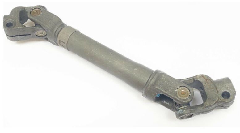

The last few days i worked on the power steering conversion. I use a prius gen 2 power steering and i'm also going to integrate it properly in the canbus so i can adjust power steering support according to speed of the vehicle. The conversion was a lot of work in my opinion but it's the only proper way of doing it, as using the hydraulic power steering is not an option for me.
Most important for me was to keep the ability of the column to retract in case of a crash.
I've cut the impreza steering shaft on the upper part and connected that with the splined shaft of the prius power steering, but i had to have someone fabricate an adapter tube on a lathe: Next i've cut the the outside of the steering column and welded it to the prius motor, that i've cut, too. Also here i've had someone fabricate a proper adapter on a lathe. Then i aligned the steering motor under the dash to make sure there is enough room when using the tilting mechanism.
The product then was half a steering column with the motor: I cut a prius intermediate steering column shaft apart and welded the splined part directly on the outer hull of the sliding mechanism. Also i fabricated a base plate to screw on the lower half of the outer pipe:
Before: After: ^
The lower part of the inner shaft consists of a prius sliding inner mechanism and the Impreza lower end part that goes to the steering rack.
The outer hull consists of the Impreza parts that can retract in case of a crash and the inner part can too, due to the prius sliding mechanism. Tomorrow i will put it all in the car.
Before: After: ^

Was it just hard to source a electric Subaru steering rack?
They are like legos…
