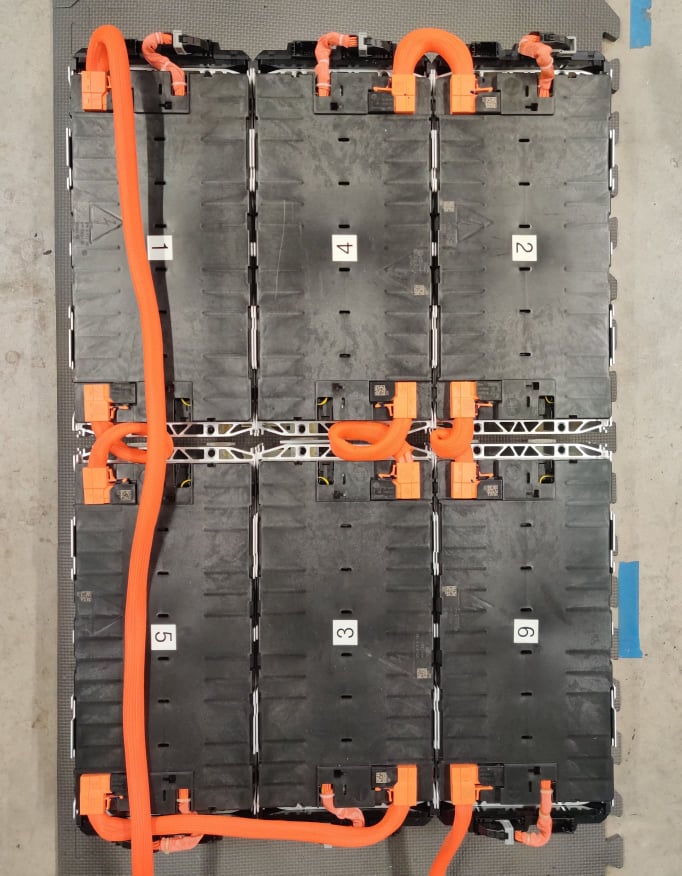

Maybe you cut the OEM cables in the middle, fit a copper ferrule on each end and crimp the extensions to it. Of course you need to put the joints in sleeves and orange tubing...
Or you could take a rigid copper tube and bend it to shape. Then crimp the OEM cables to it directly.

arber333 wrote: Wed May 04, 2022 6:36 am Maybe you cut the OEM cables in the middle, fit a copper ferrule on each end and crimp the extensions to it. Of course you need to put the joints in sleeves and orange tubing...
thank you for that suggestion, I have a second battery pack I am about to open so I can harvest some cables from there also, and for the time being for testing purposes I tried the Anderson connectors but not for cell module to cell module connections but for battery pack to charger or battery pack to converter type of temp hook em ups

and as you may have heard my SSD (computer hard drive) failed last month and i LOST all of my EV pics and Notes but somehow today on Google Drive I found this pic from Sir Artur my EV blood brother and mentor on this project, and here is how he pulled it off with one OEM set of orange twizzlers
the boy is smart, that's for damn sure
