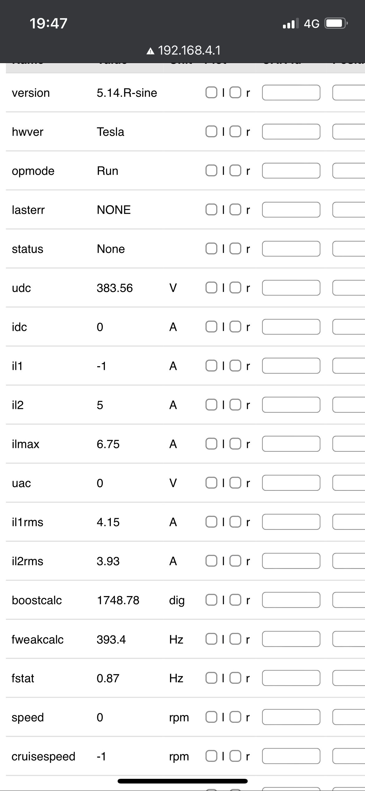

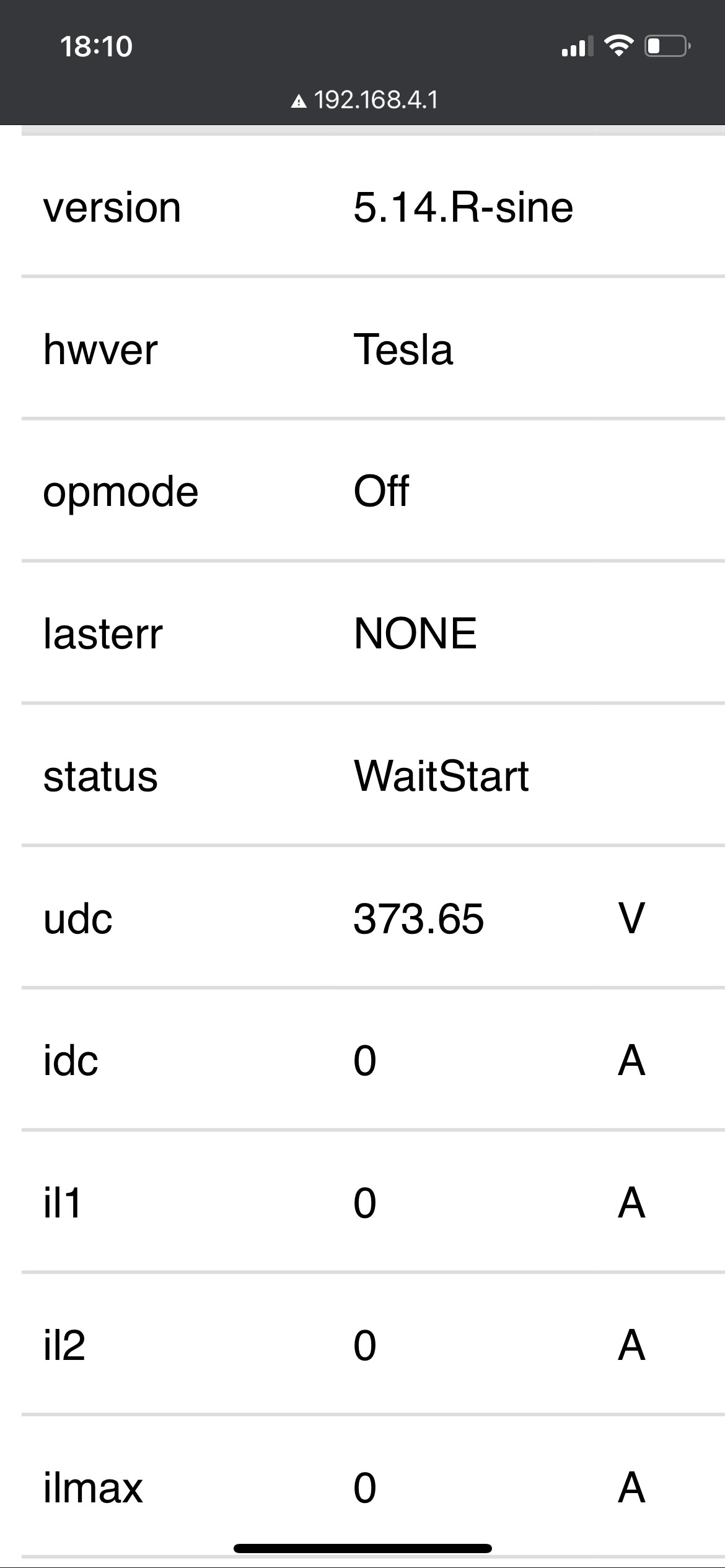

Quick question. My UDC at pre-charge always reads accurately, however very occasionally when closing the main contactor I get an overcurrent because UDC drops significantly when going from waitstart to run. I'd love to resolve it but short of checking the LDU current sensing connections, I've run out of ideas.
Grateful for your thoughts.
Waitstart:
Start:
P.S It's a good opportunity to investigate as I've currently got the drive unit hanging out the car.
Waitstart:
Start:

Are main relais switched on when you turn on the inverter?
Looks/feels like turning on makes the voltage drop itself.
- Boxster EV
- Posts: 443
- Location: UK
- Has thanked: 36 times
- Been thanked: 30 times
The inverter is on and pre-charge completed which registers the correct voltage (pic 1 above). Upon closing the main contactor the logic board is measuring a voltage drop either spuriously or actual (pic 2 above).EV_Builder wrote: ↑Mon May 02, 2022 7:18 pm Are main relais switched on when you turn on the inverter?
The issue only happens occasionally but I’d like to get it sorted.
