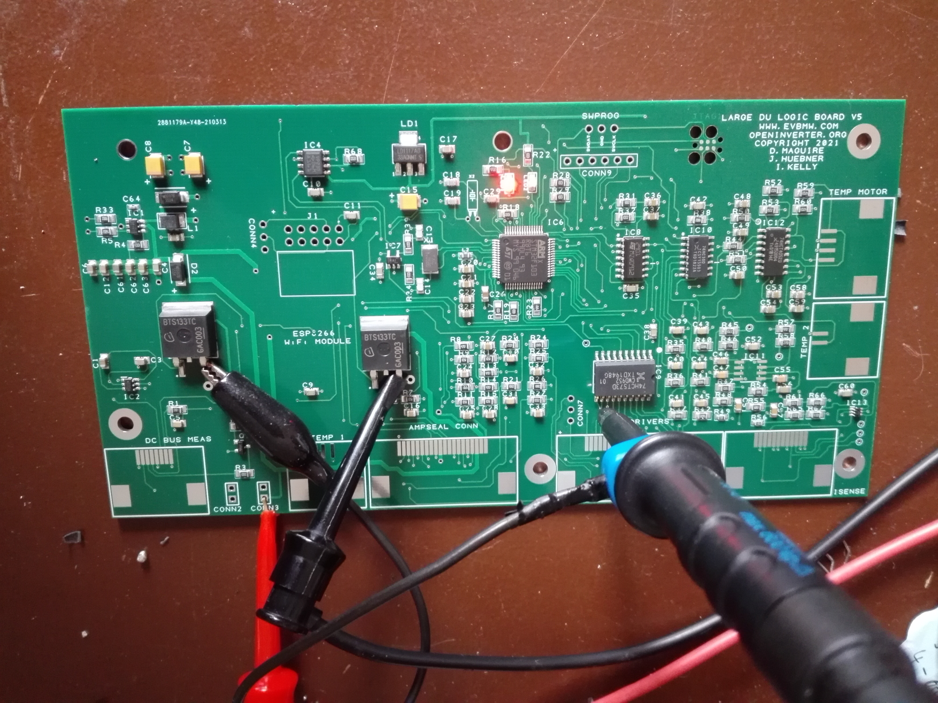

Jack Bauer wrote: Thu Apr 01, 2021 10:08 am If you do such modifications please feed them back into the community.
Sure, or course. Will check one of these days if the V7 is released yet, else just start from the V6.
Posts: 6968
Has thanked: 454 times
Been thanked: 1771 times
Re: Tesla SDU/LDU Update
It's here :)

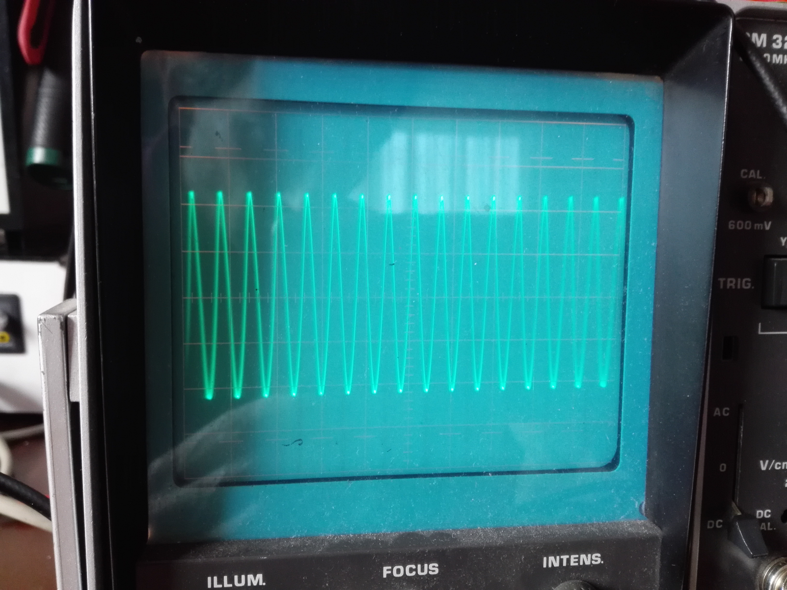

New clock mechanism works well. I don't think the clock actually looks like on the scope, it is just a 10 MHz one. Still waiting for delivery of my PicoScope...
Anyway, thanks Isaac for doing this :)
Will publish the files shortly.
