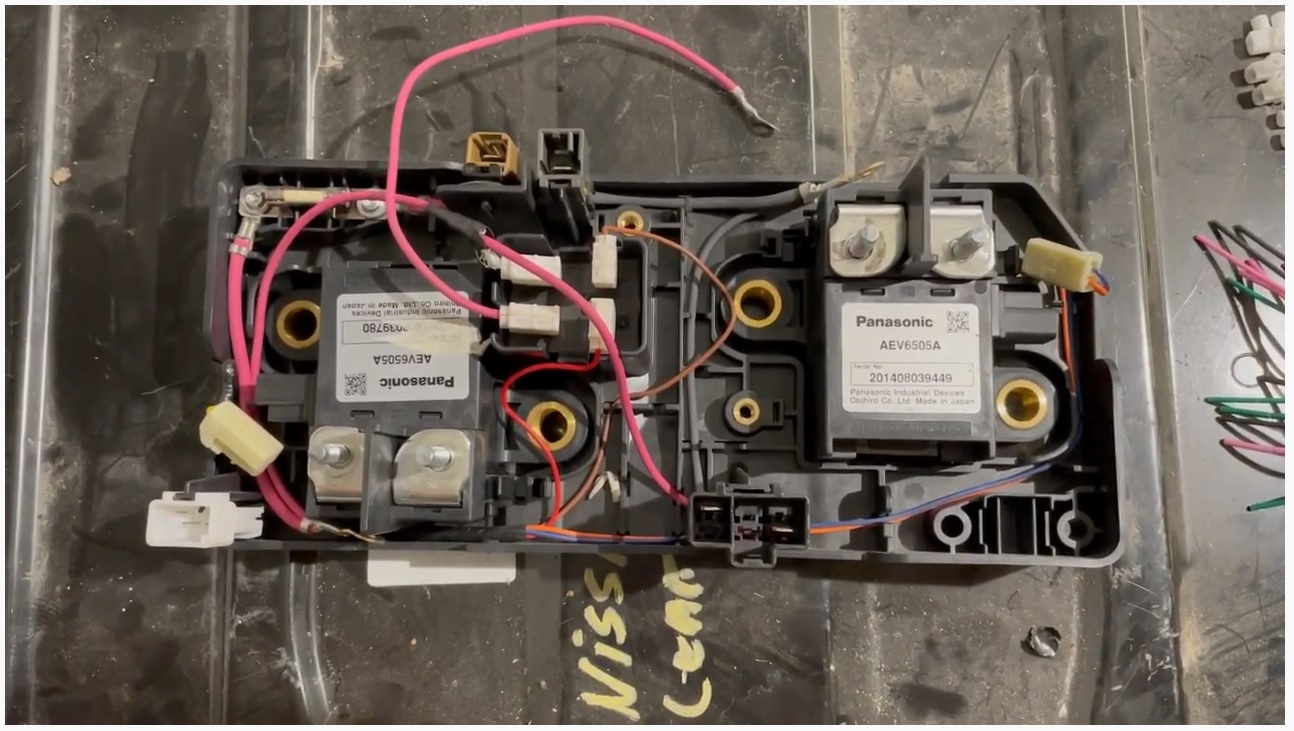

I couldn't help but see the similarities between the BMW Safety box and this one from a first gen Nissan Leaf (YouTube just suggested this video today) thought you may find it interesting
