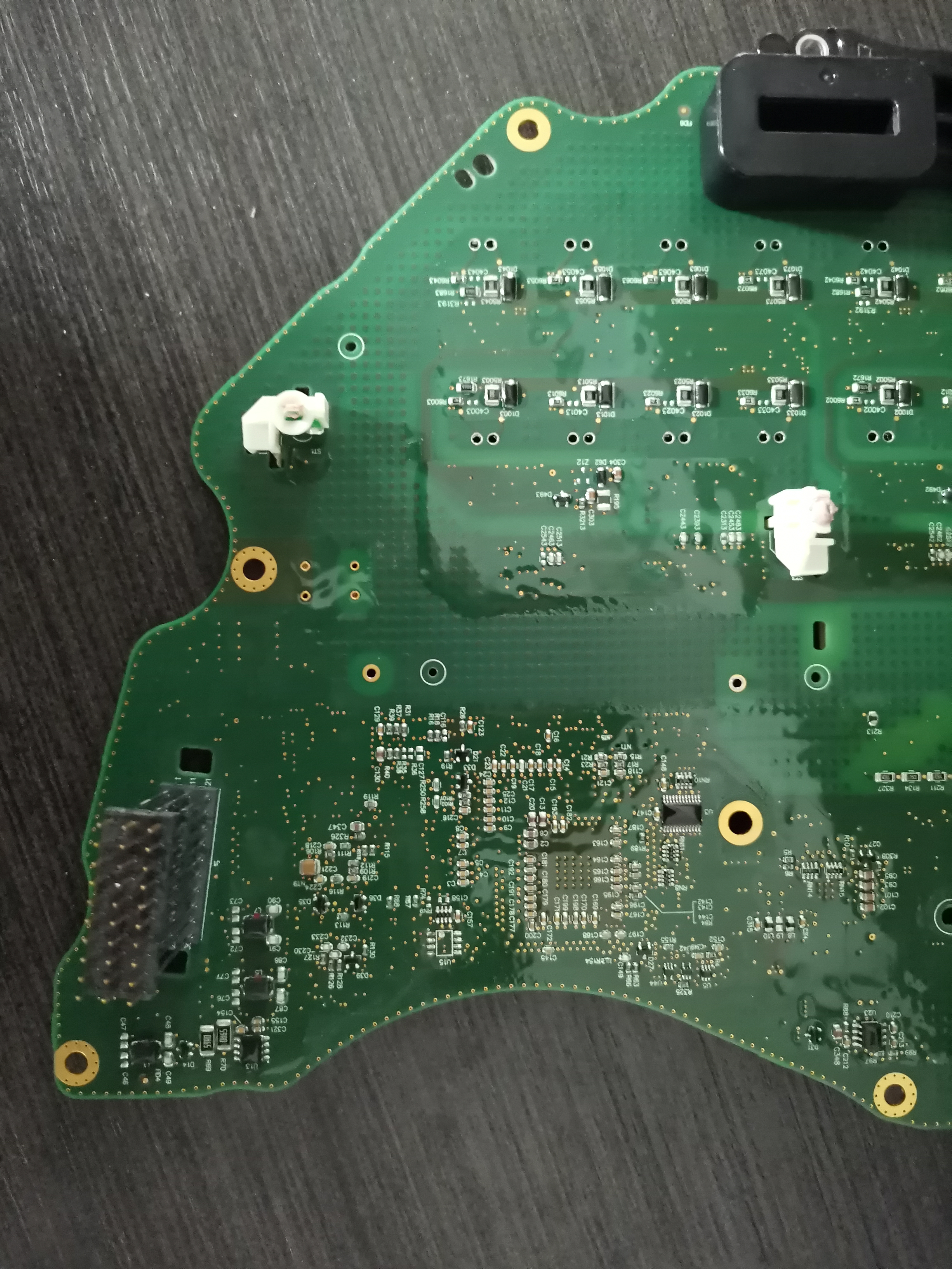

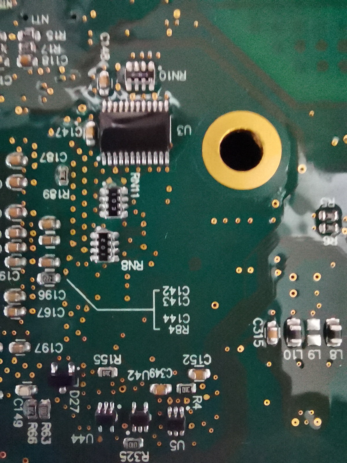

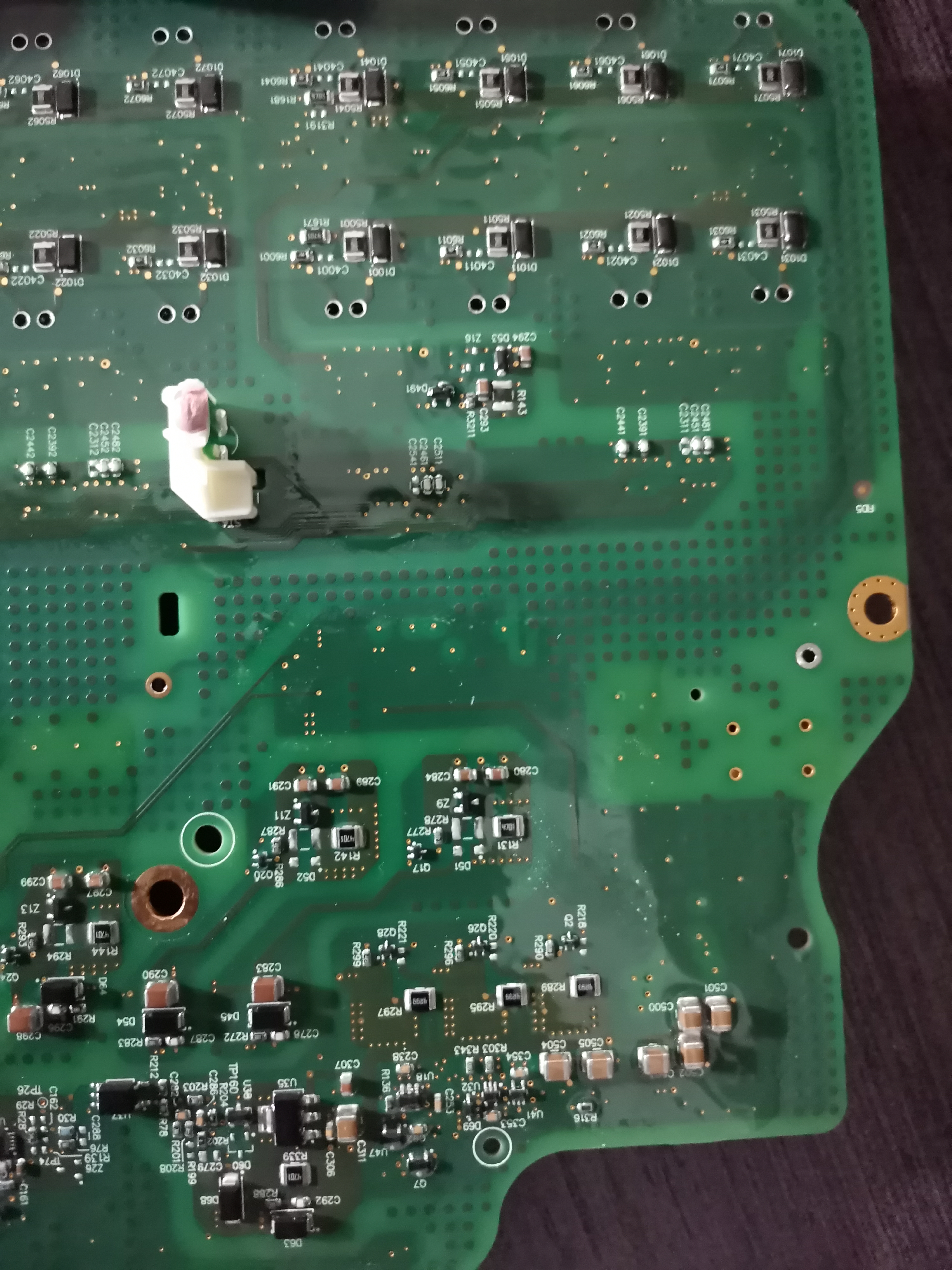

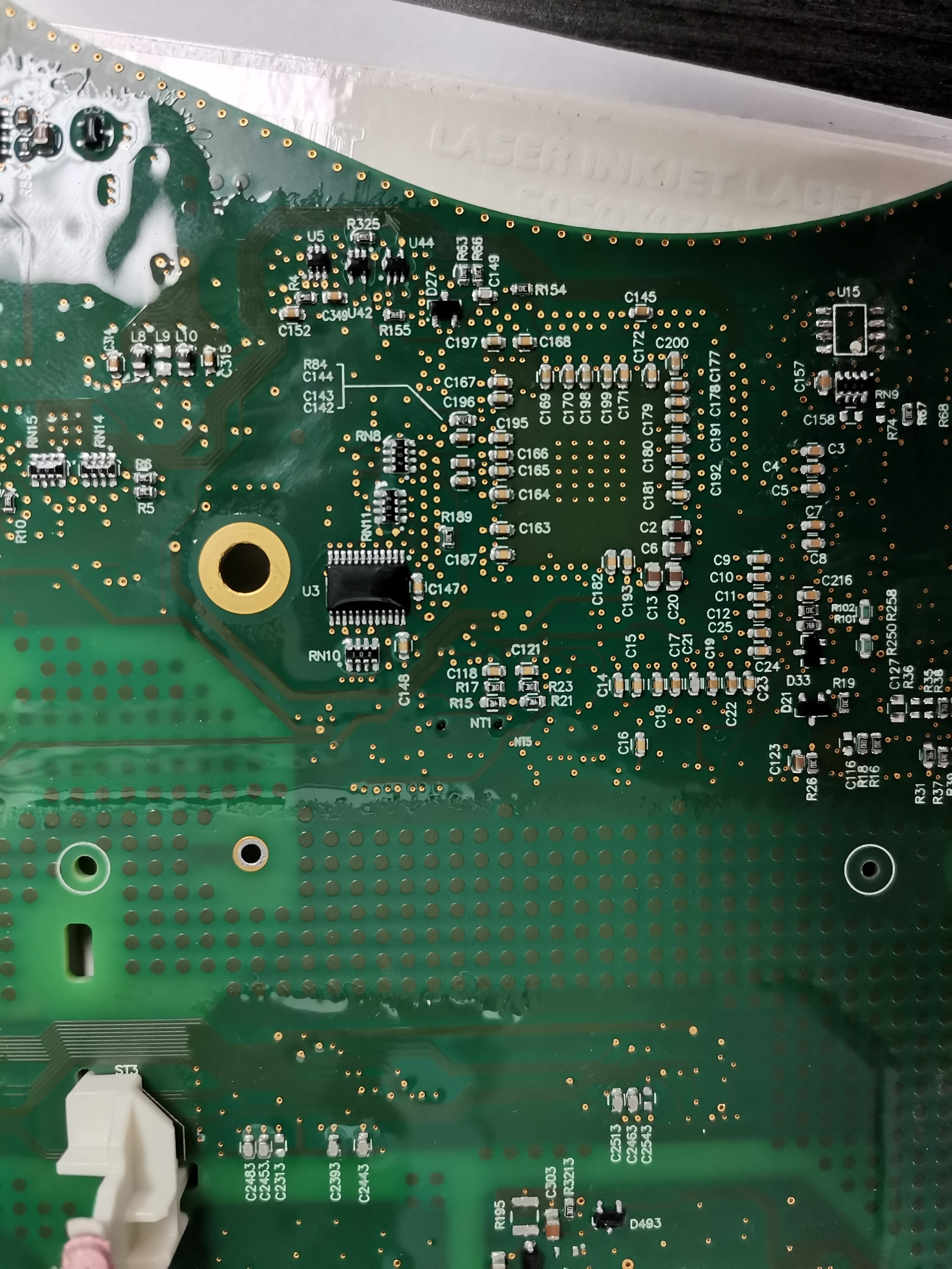

Here is my entire collection of pictures of the rear of the RDU inverter pcb.
- Posts: 215
- Has thanked: 15 times
- Been thanked: 38 times
Very good to have those pics.
In the meantime I identified the transistor pairs - 6 N/P channel MOSFET pairs of
- a ST STD46P4LLF6 40V P-channel and
- a Infineon 3N0408 N-channel.
Also found better isognd and measure now stable -5V permanent voltage at the source/sink gate output of the gate driver.
20V on the MOSFET pair when having roughly 70V on the HV connector.
Not sure if any of this helps. Analog power electronics is clearly not my area.
