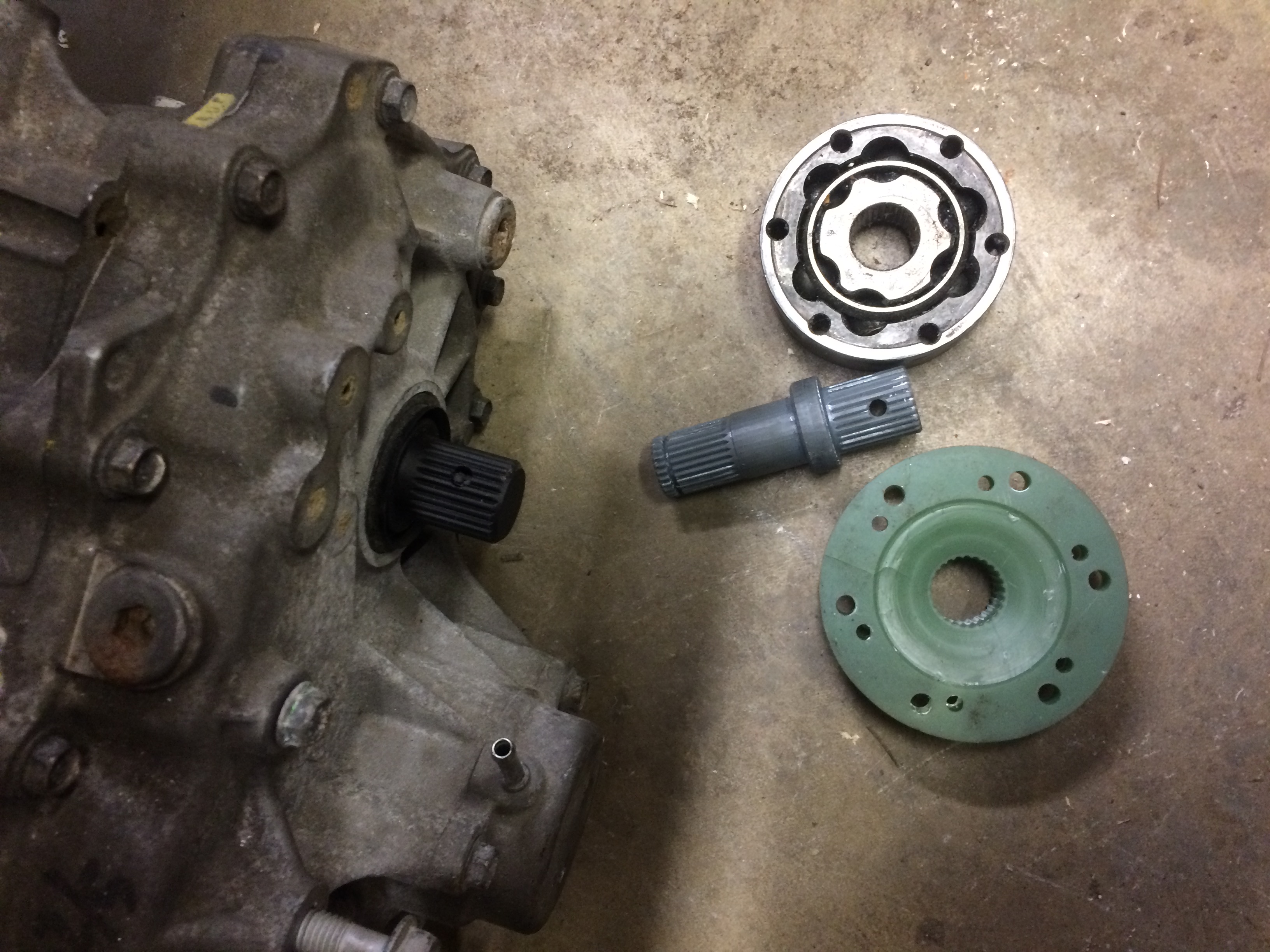

Cera wrote: Fri Feb 11, 2022 10:18 pm Hmm. Is there a specific reason why Leaf motor should be mounted "in front of axle" (as it sits in Leaf itself) when using the Leaf gearbox? Or can I mount it "wrong way around" with the motor sitting "behind" the axle ....
I’ve seen the leaf motor/gearbox mounted with the motor behind the axles, ie “flipped “ in a few conversions.
from what I’ve seen inside the em57 gearbox, leads me to believe there should be no issues running it in reverse.
if you run the leaf inverter via canbus you’ll need to swap 2 phase conceptions and flip the resolver connections, as the inverter won’t deliver full power in reverse.
I’m also working with a local gear shop on making stubs flanges for the leaf gearbox. With vw Type 2 and 930 cv joint bolt pattern.
As I think the leaf stack is such a prefect fit for old vw buses !

Bratitude wrote: Sat Feb 12, 2022 1:09 am from what I’ve seen inside the em57 gearbox, leads me to believe there should be no issues running it in reverse.

Yeah it might be easier to mount the Leaf EM61 or EM57 motor directly to the VW gearbox. An other advantage is that you can select gears to suit you needs, like climbing up a hill or driving on the motorway. You will be either in 3rd or 2nd gear, if I remember the gear ratios of the VW gear box.
I think you can run the Leaf motor + gear box in revers but I looked inside the Leaf gearbox and found that the top of the gearbox casing has a small splash reservoir (oil gets splashed in) which than let it drip on the gears back again. I am not sure if this also works in reverse. When I am back in my workshop I will take a picture of this reservoir.
