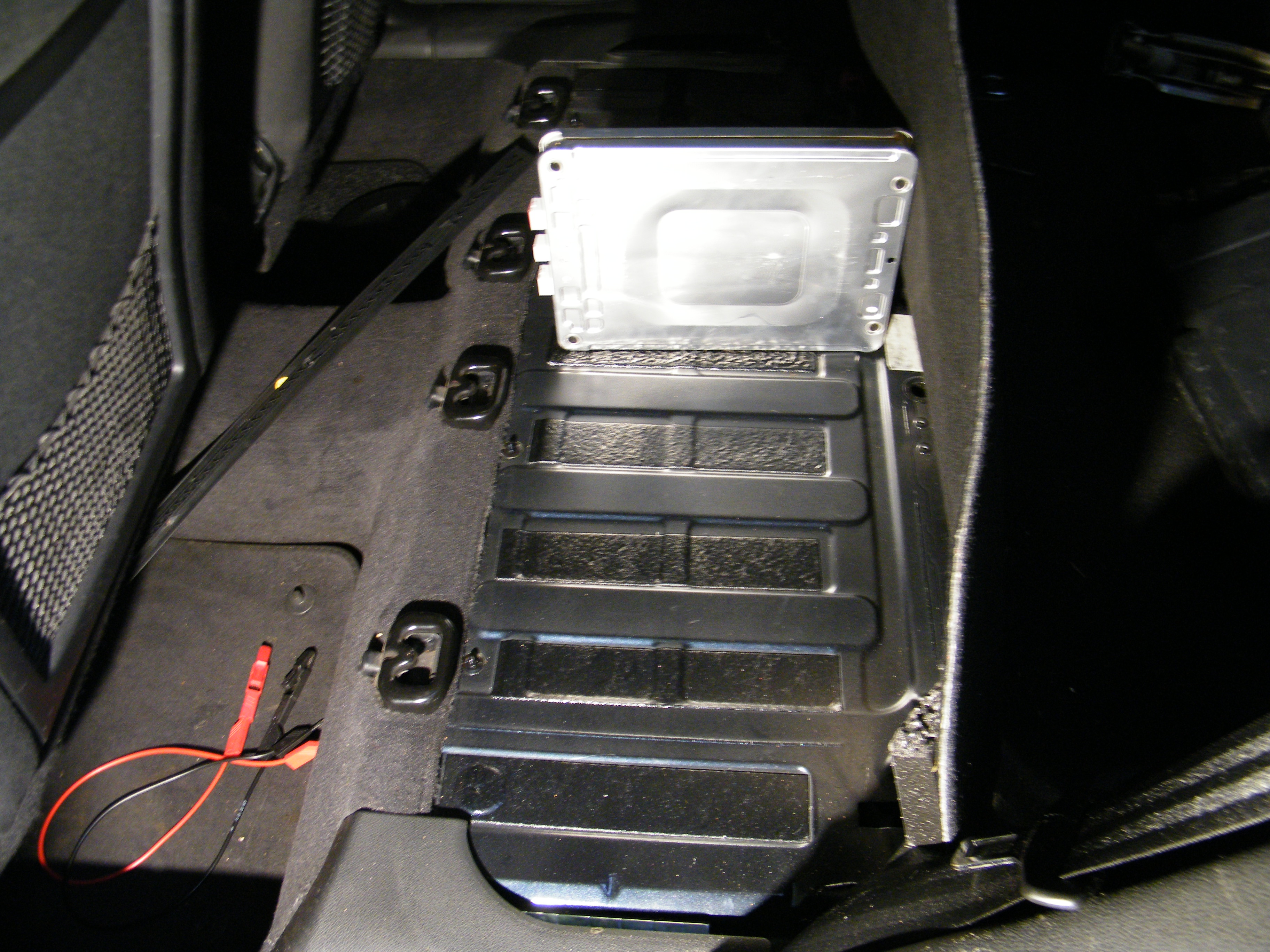

Now, I could use your input again, to have to do less "ringing". On what pins is the throttle pedal and what what pins is the CAN bus?
Should I even try to run the inverter via the unshielded motor harness (including the resolver)? Or is it wasted time?

johu wrote: Sun Feb 06, 2022 3:14 pm Now, I could use your input again, to have to do less "ringing". On what pins is the throttle pedal and what what pins is the CAN bus?
I did run VCU from original ECU location by 20 wire cable BUT got bad behavior. Now moved VCU near inverter and it works.
i think you can run VCU with original AUDI wiring if you find 3 or more shielded cables. AUDI has some shielded wires, but i do not know how many are in your 1.4i version. At least one shielded is for knock sensor.

Did a test run of the VCU today. Will be in the next video.
But one detail puzzled me: throttle runs backwards :?:
The plot goes from 0 to fully pressed. In voltage primary goes from 4V to 1V and secondary from 4.4V to 2.9V . Is it like that or have I reversed polarity? I connected it like written in the wiki

johu wrote: Tue Feb 08, 2022 6:58 pm Oh, and another question: I noticed that my diagnosis tool no longer works since I removed the ECU. Is it possible that ECU loops through the K-Line?
In wirring there was no direct conection to OBD port. Only two wires to instrument cluster (that i do not know, maybe k line) and Canbus.
Will check again. Also will test my A2. Didnt try to plug VCDS.

johu wrote: Tue Feb 08, 2022 6:15 pm Did a test run of the VCU today. Will be in the next video.
I think you can try to reverse +5 vs Gnd. In 1.6 wiring diagram it is stated what pin is +5, in 1.4 wiring there are no markings.

I removed the fuel tank and remaining exhaust parts today and am again delighted by the very boxy space that makes. So I will be able to easily fit 24 Leaf modules (i.e. half of them) where the tank used to be.
We will cut out the floor and place a plastic box (800x330x230) into the void for weather protection. The actual battery brick will then be mounted with a set of angles into the longitudinal carriers. So the battery box has no structural task. The other brick will life directly on top of that, so the rear seats are gone. The owner prefers it that way. But we might also put them into the compartment below the boot. Time will tell ;)
