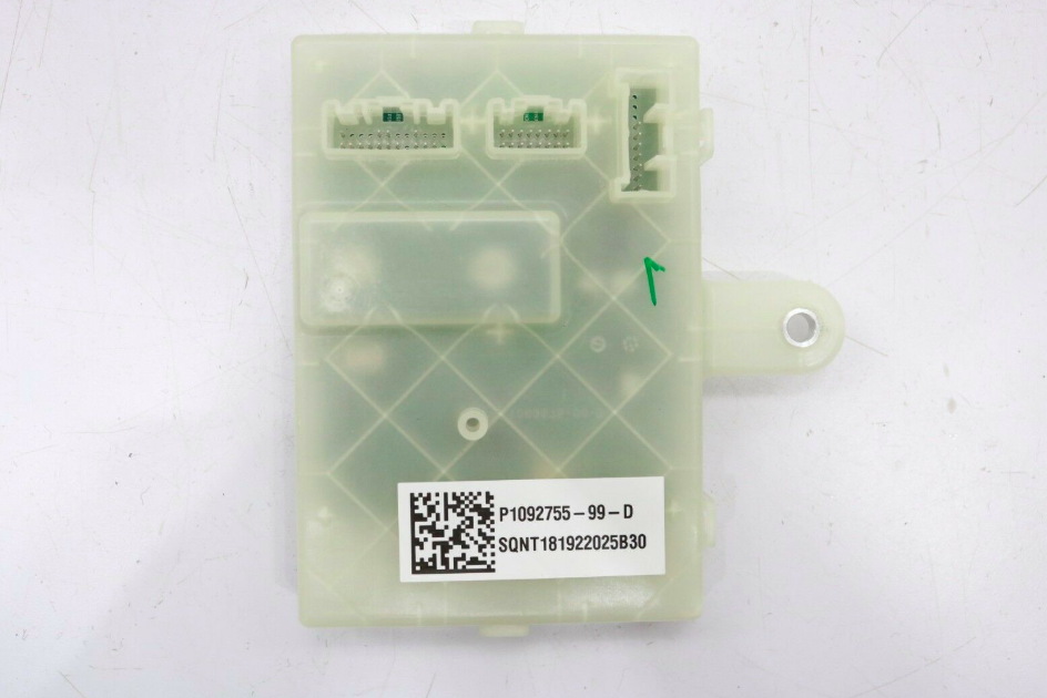

Re: Tesla Combined Charging System (CCS)
The Tesla Model 3 "CP ECU" are readily available from US breakers but we don't know if it is the same hardware or firmware as the European part.
For reference the US part numbers are currently 1092755-98-D and 1092755-99-D.
We now have the US and EU hardware in Ireland
The US Charge Port ECU is a single PCB mounted inside a plastic clam shell. It's clearly been designed for low cost assembly with connectors replaced by individual press fit pins and mounting screws with plastic studs which have been melted to secure the PCB.
ECU Part Number: P1092755-33-D
ECU Serial Number (?): SQNT19051200C630
PCB: FAB 1084808-00-DREV-01
Assembly Version (?): SAXE1PBB4F0 Rev F
The main MCU is a Freescale (NXP) SPC5605BMLL6 in a 100 pin LQFP package (14mmx14mm). A 10 pin connector J7 is mounted close to the MCU and may provide a JTAG port for programming/test.
The PCB is conformally coated and part numbers on other IC's are not visible.
The schematic posted for the US Model 3 (see above) seems to match the PCB pinout. The interface to the vehicle PCS (located in the HV Battery) is just three signals and one (possibly two) CAN bus's
I'll get some decent high res photo's when I get a moment... for now here are some from my phone;

Here are the EU Charge Port ECU PCB connector pins with signal names based on the US schematics;
J1 - X096 "HV Battery"
PIN101 - unknown (measures 123R to PIN102 - possibly second CAN bus)
PIN102 - unknown (measures 123R to PIN101 - possibly second CAN bus)
PIN103 - not fitted
PIN104 - PROX_OUT
PIN105 - CP_LATCH_EN
PIN106 - CP_FAULT_L
PIN107 - CP_CAN_L (measures 123R to PIN108)
PIN108 - CP_CAN_H (measures 123R to PIN107)
PIN109 - GROUND CHASSIS
PIN110 - POWER ALWAYS ON
J2 - X688 "Charge Port Inlet"
PIN201 - not fitted
PIN202 - not fitted
PIN203 - not fitted
PIN204 - ANALOG IN PROX_IN_1_H
PIN205 - not fitted
PIN206 - not fitted
PIN207 - ANALOG IN PROX_IN_1_L
PIN208 - unknown
PIN209 - not fitted
PIN210 - not fitted
PIN211 - not fitted
PIN212 - HIGH SIDE DRIVE LATCH 1 DRIVE 1
PIN213 - not fitted
PIN214 - GROUND CHASSIS GND THERM 1
PIN215 - not fitted
PIN216 - PWM IN PILOT_IN_1
PIN217 - not fitted
PIN218 - GROUND RETURN EVSE_PE
PIN219 - GROUND RETURN GND THERM 2
PIN220 - ANALOG IN TEMP_IN_1
PIN221 - ANALOG IN TEMP_IN_2
PIN222 - unknown
PIN223 - DIGITAL IN LATCH 1 SWITCH
PIN224 - HIGH SIDE DRIVE LATCH 1 DRIVE 2
