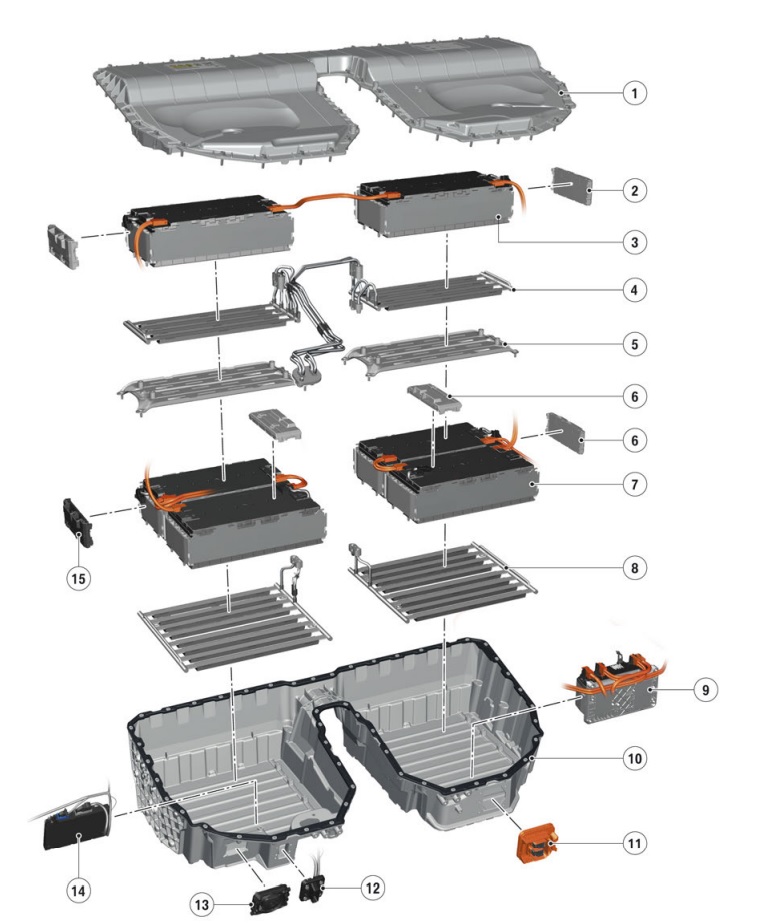

maybe you'll find this exploded diagram useful
