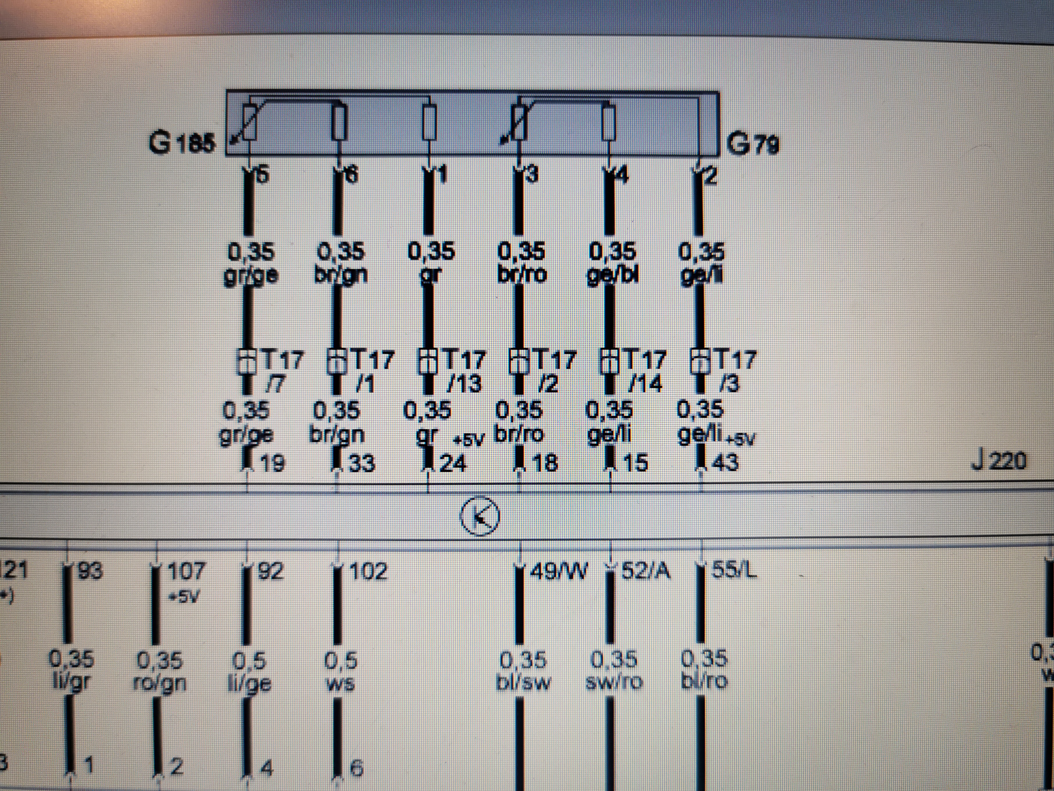

Audi throttle pinout:
First sensor 1 (24 on ecu) is +5V, 5 (19 on ecu) is Gnd, 6 (33 on ecu) is signal;
Second sensor 2 (43) is +5V, 3 (18 on ecu) is Gnd, 4 (15 on ecu) is signal;
