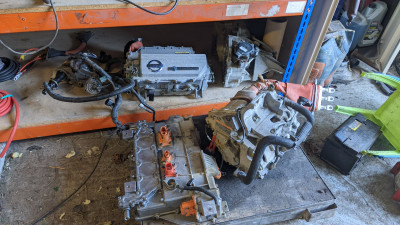

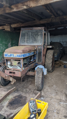

This has been an idea of mine for the last couple of years. I have always thought that an electric powertrain would be perfect for small farm tractors. Ones that get used for an hour or so at a time to do winter feeding or moving bales around at slow speed. Potentially some field work such as hay turning or again bale moving. Nothing too heavy with the PTO.
Well the MG is still not finished and I am about to start the Defender teardown(not electric) but there can never be enough projects! This one came up for sale over Christmas and I have been convincing myself to buy it all holidays. It meets the requirements that I was looking for. Most importantly the engine is not structural, so it can be easily replaced. Allot of tractors used the engine as a stressed member. It's about the right size to be useful, it was nearby and also pretty cheap.
It's also from a now defunct British company which fits in well with my jingoistic car taste.
It will need a bit of cosmetic work and a little servicing, but everything is there and the rust is only surface rust.
The plan:
I have been theorycrafting this for a while and I think I am going to look into a dual motor setup. Something like a leaf motor stack to interface with the gearbox. A leaf motor has around 20nm more torque than the original 55hp engine, so power should not be lacking. I think in reality it really will not draw all that much power moving around at slow speeds.
I was thinking of having a completely separate hydraulic motor and system in order to operate the power steering and loader hydraulics. The main idea being that I can operate the loader and drive the tractor separately without having to worry about a clutch. I am pretty new to hydraulic setups so not sure what sort of power they use. I am doubtfully hopeful a heavy duty 12v pump might have enough power, otherwise there are plenty of other options available to look into.
Battery wise I will just throw in whatever I can find when I get to that point. I don't expect to be doing anything more than stripping this down and doing some light restoration work on this for the next six months at least. Getting the MG on the road will take priority.
Thought I would setup a thread to see what peoples thoughts are on drive train, separate hydraulic system etc. At the moment this is open to any option, nothing is set in stone right now.

Re: Leyland 255 Tractor
I like this project! I have thought of doing this as well but I live in a villa an have no use for a tractor...
Leaf motor are readily available so that will proably be a good choice.
Regarding hydraulics, I think fork trucks normally use one motor for driving and another motor for hydraulics. Maybe the hyudraulic unit integrates motor and pump in one unit? Could perhaps be an option.

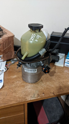

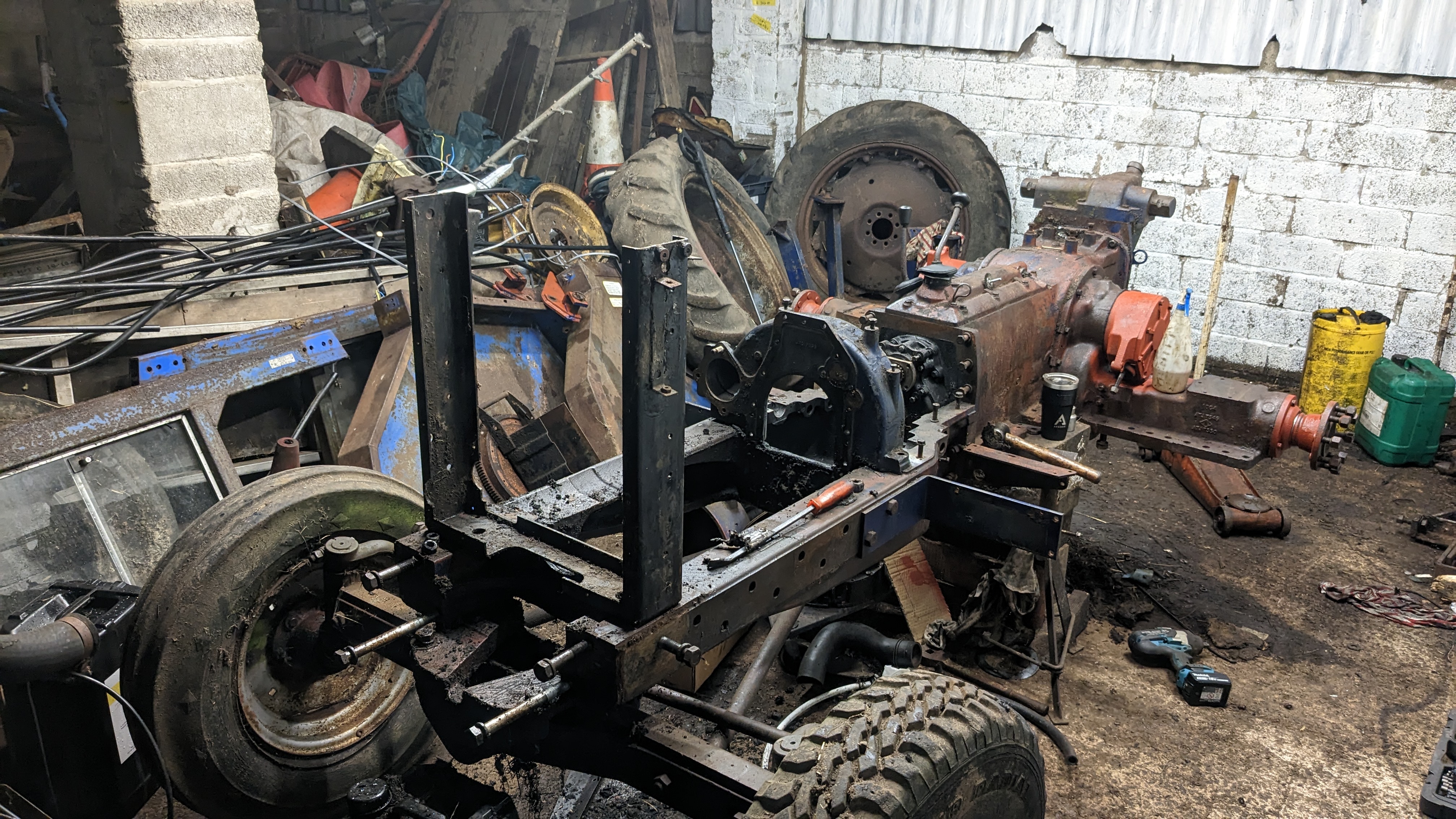

Made a small start on stripping down the Leyland over the weekend. I'm also planning to move my main workshop into this shed eventually so have started to paint up the walls and clean out the clutter. I also need to wire in some lights and sockets. I have been researching the drive train and hydraulics a little more over summer and come to the conclusion that I will most probably keep the flywheel and dual clutch. The main reason for this is to keep the independent PTO, it also makes hydraulics simpler and the user interface of the tractor very similar to how it was originally.
I have also been looking into replacement power steering, which is definitely needed for this thing. Ordered one of these, a Corsa power steering pump the model after what is documented on the wiki here. Looks similar in appearance and I hope operation, will update the wiki with findings.
I don't know if it will be powerful enough for the tractor power steering, but there is only one way to find out.

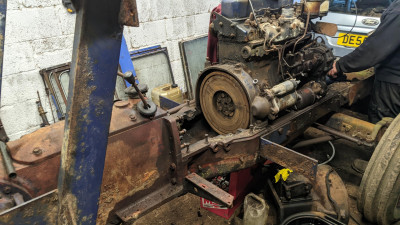

Deep into the strip down and restoration at the moment. Looks like the rust is actually quite minimal and most of it is on body panels that are cheap and easy to replace. For some reason there is a bit of a cult for these tractors and spare parts are commonly remade and available.
I have pondered the motor to gearbox connection. The added complication here is that the PTO is also driven by the motor and there is a dual clutch fitted for independent PTO. This is something I want to keep. So I expect I will keep the flywheel as there is no other way to keep the clutch without it. I am thnking of keeping the engine flywheel housing, which also acts as a very handy mounting point, then adding a bearing to take the weight of the flywheel before attaching to the motor flange. Details will follow when I figure it out. Also been thinking about converting to hydrostatic steering since the original setup is knackered and not amazing even at the best of times. The cost of machining and restoring the original setup would probably not be that far off the conversion cost anyway.

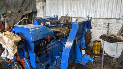

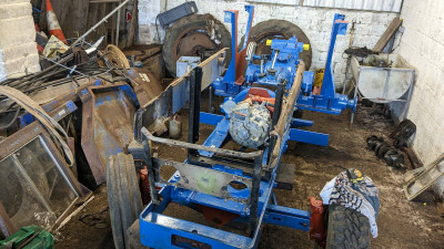

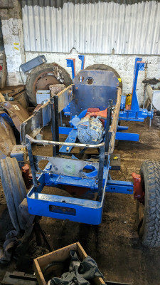

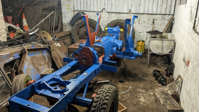

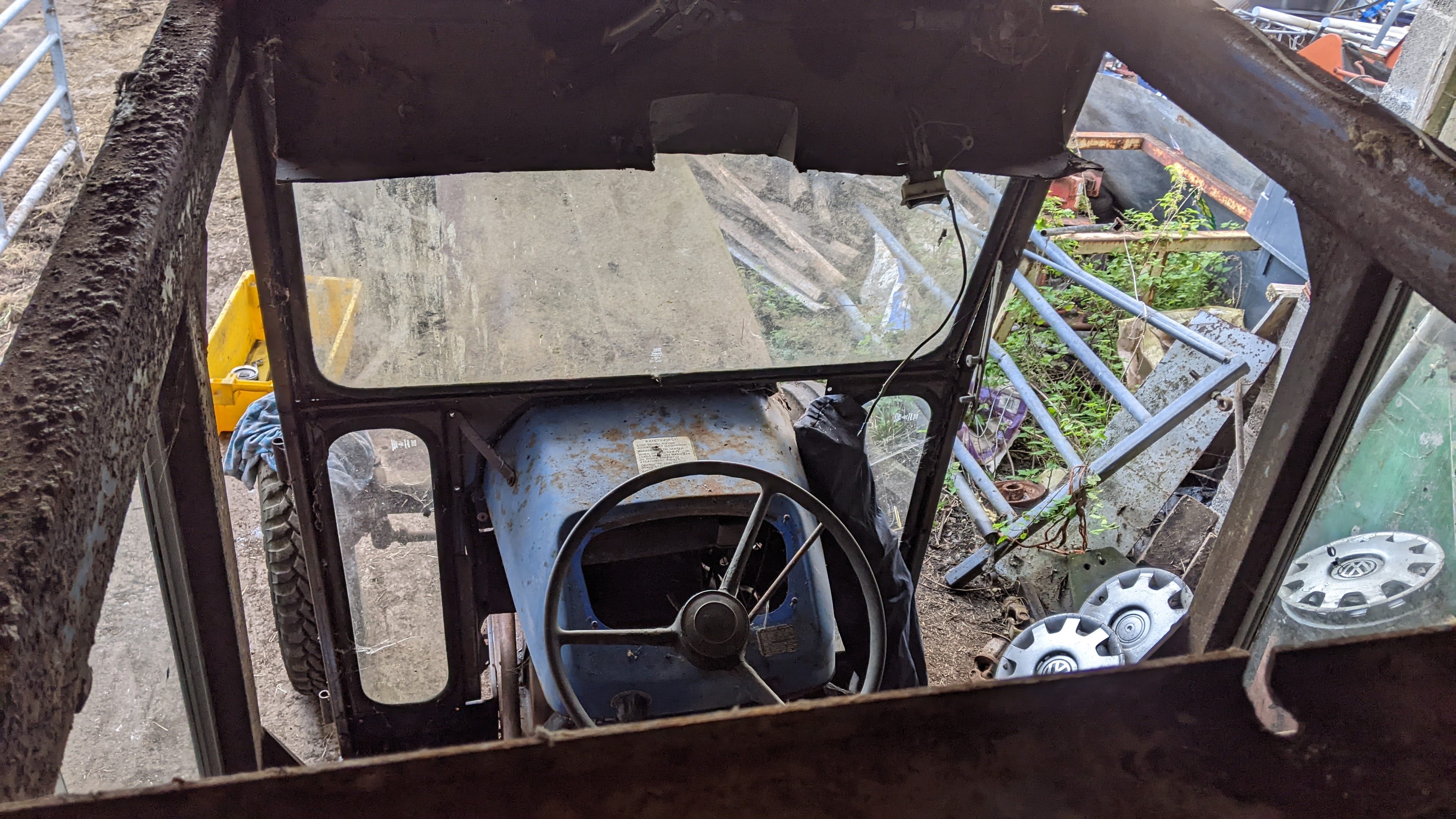

The rear of the tractor is pretty much done now. Rebuilt brakes and replaced leaking half shaft seals.
Removed the engine and the power steering which is going to be replaced by hydrostatic steering, taking up less room.
This shows most of the room I have in the front of the tractor. I am planning to mount the motor to that rear plate. At the front of the tractor is the original radiator mounts. From this the tinwork is attached so this might as well stay. It extends another 30cm or so forward from here so there is plenty of room. Battery wise I am thinking the PSA E-Corsa/206-E 50kWh battery. I can drop two modules to bring the voltage down to what the Leaf inverter is expecting. Plus it has some pretty nice coolant plates, which I think I may need with the possibly higher constant draw.

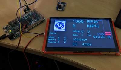

Been quiet on here over the winter. But busy on the restoration stage. Endless wire brushing and painting when temperatures allowed, with the end still not in sight. Spent far more than I was planning on new bushes, seals, bearings etc.
However there is progress on the EV side of things as well. Motor mounts have been designed and fabricated. Leaf shaft sourced from BRAT industries and shrink fit to my flywheel adaptor. Planning to mount the motor next weekend. Then I can make a start on putting all the pedals back on.
EV component side I am expecting to use the VAG charger I bought a few months ago, along with a CCS socket more recently. Going to use a Zombie board to control the leaf motor and possibly BMW lim module for CCS charging.
I've slimed down the original DC-DC/junction box by removing all the contactors and cutting it in half. Keeping the DC-DC and cooling loop.
On the UI side of things I am replacing the original dash with a nextion display. Done a first draft of this over the winter, with changes to be made when I figure out what information is actually useful.

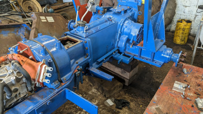

Got the motor in last weekend!
Also threw on some tinwork to give me a better idea of space available for batteries. Planning to put the leaf inverter above the motor which looks like it will fit quite neatly. Rough space available for batteries is around 200,000cm3. The Ecorsa modules that I think I will use take up 100,000cm3 of space. So as a nice change from the MGF project I have tons of space and it's all one big square box. Should give plenty of room to allow for cooling plates, HVJB, charger and other packaging. Sort of wishing that I left the paintjob as it was now, just covered it in rust converter and clear lacquer.
I'm still going to wait until I buy the batteries, focus on getting the inverter mounted plus cooling setup for both motor and inverter, then get the steering upgrade installed and tested.
Took a better look at it this week and realised that the motor isn't quite aligned with the gearbox input shaft. So drilled out the holes on the adaptor plate to give it a bit of wiggle room. Currently printing out an alignment tool so tomorrow I can get it fully aligned before torquing up the bolts once more. Probably should have paid more attention on the prototyping stage there.Also threw on some tinwork to give me a better idea of space available for batteries. Planning to put the leaf inverter above the motor which looks like it will fit quite neatly. Rough space available for batteries is around 200,000cm3. The Ecorsa modules that I think I will use take up 100,000cm3 of space. So as a nice change from the MGF project I have tons of space and it's all one big square box. Should give plenty of room to allow for cooling plates, HVJB, charger and other packaging. Sort of wishing that I left the paintjob as it was now, just covered it in rust converter and clear lacquer.

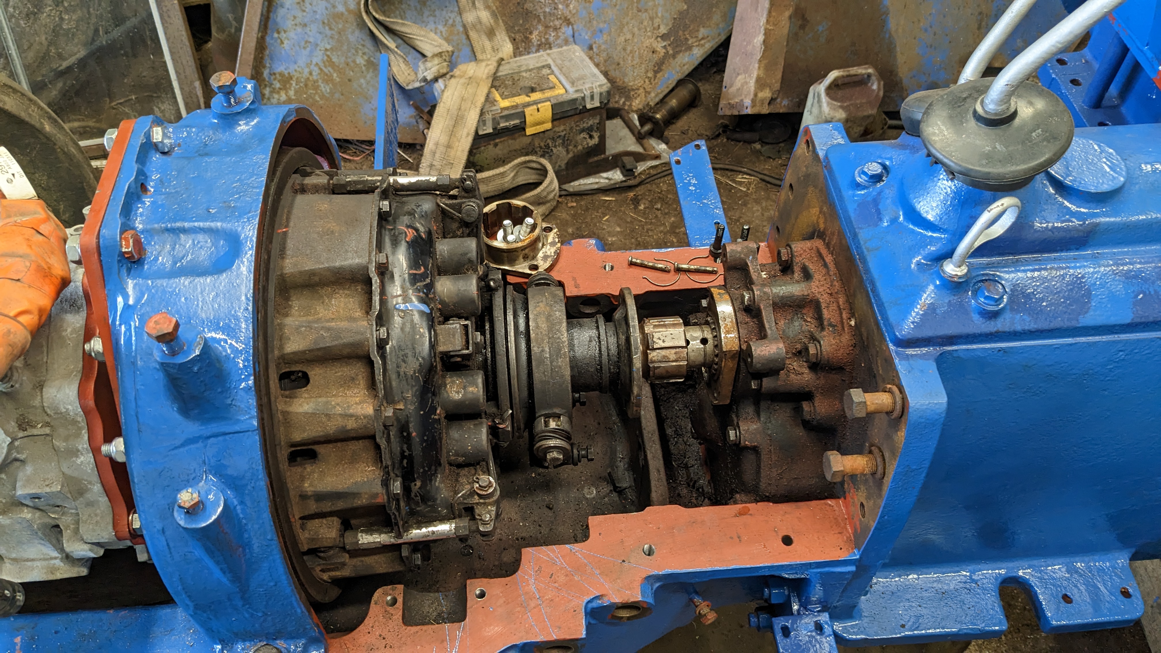

- Posts: 475
- Location: Somerset, UK
- Has thanked: 43 times
- Been thanked: 108 times
Re: Leyland 255 Tractor - Nissan Leaf EM61
I used my 3d printed tool to align the adaptor plate today. Then reattached the motor to the other side.
I then had to lift the whole thing out once more to get the clutch assembly on.
After all that it looks like the flywheel is still a few mm too close to the gearbox, not to worry I have a spacer that I made behind the flywheel that I can turn down to gain this space.
I am a little concerned about the weight of all this, the flywheel and clutch assembly is probably over 40KG, although I did try to account for this in the adaptor plate design by doubling up the support bearings it does still still feel a little rough in part of the rotation. Once the PTO dog gear is fitted thought there will be some weight taken on the gearbox side, so hopefully that will fix that issue.
Alternative is to lose the clutch and just have a solid shaft, not the end of the world but I would lose the independent PTO.
We will see what tomorrow brings.
Got the clutch in just fine in the end by making my spacer a little bit shorter on the lathe.
Making up the brackets for the inverter today which should be finished next week, then I am also planning to start getting the cab parts back on so I can look at fitting the new steering column. Should start looking like a tractor again soon.
Steady progress on this. Mostly wire brushing and painting, with a good bit of welding recently.
Hydrostatic steering upgrade is in on the steering wheel side now,
On the electric side I have mounted the inverter and Leaf DC-DC box, which I chopped in half away from the rest of the junction box.
Next big task is mounting up the steering ram and sorting that out. Apart from that I'll keep putting parts back on while I keep my eyes open for a battery. At the moment the lack of a battery isn't holding me up since there is still a bit to do in terms of restoration.
I did get the motor spinning for a good few minutes with an Ebike controller and my Quad bike battery. Until the Ebike controller self combusted. With that I know that 1) My hydraulic pump works, 2) I didn't put all the pipes back on my hydraulic system and 3) the flywheel doesn't vibrate all that bad for now, which was my main concern.
