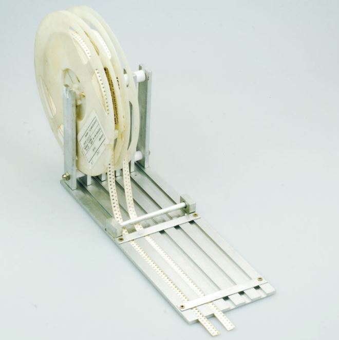

The pick and place is most time consuming.
Just ordered some manual trays, only EUR 11 from aliexpress.
Paste one board only take 20 min.
Heating the board on hotplate and using gun, works great. It's very therapeutic to see solder melt around the components.
I will consider other methods/equipment if the sale take off
