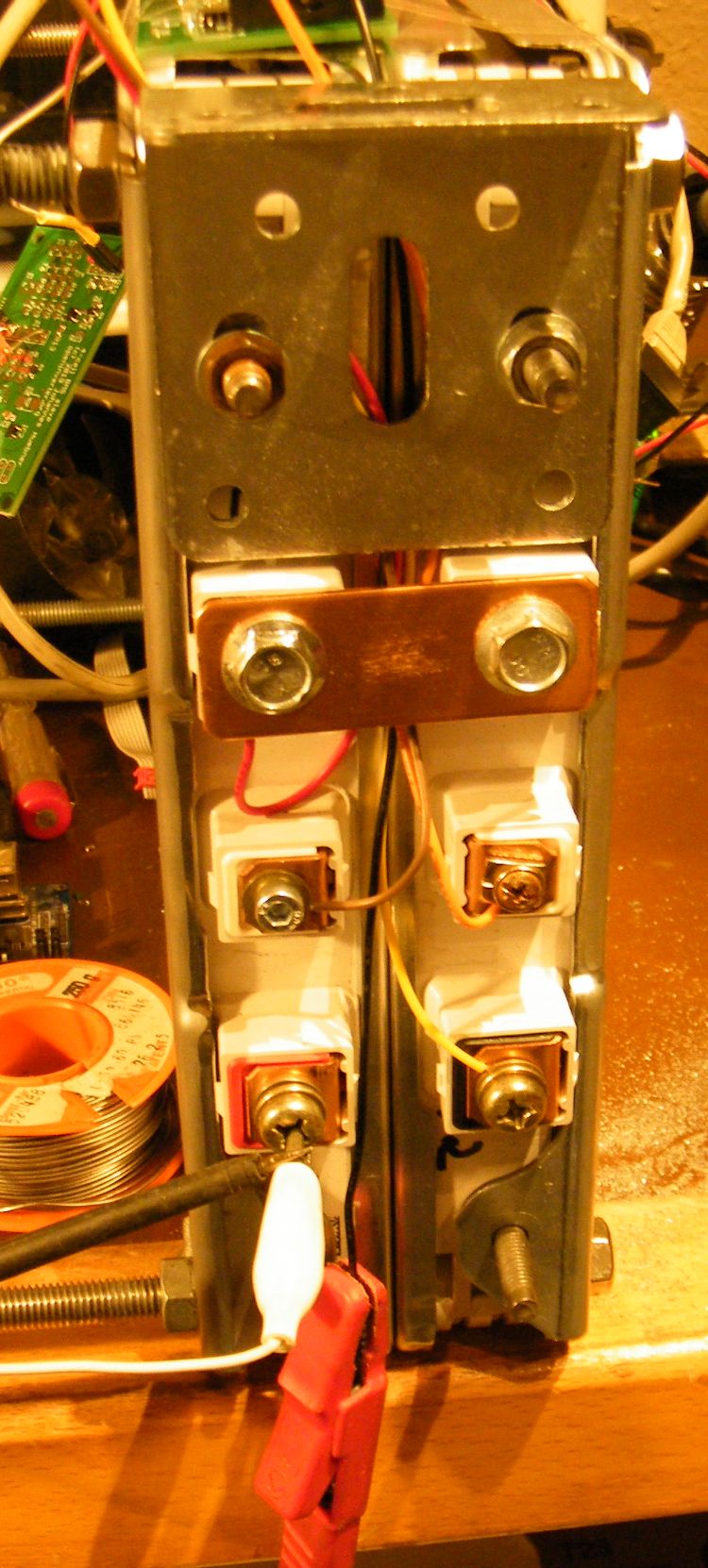

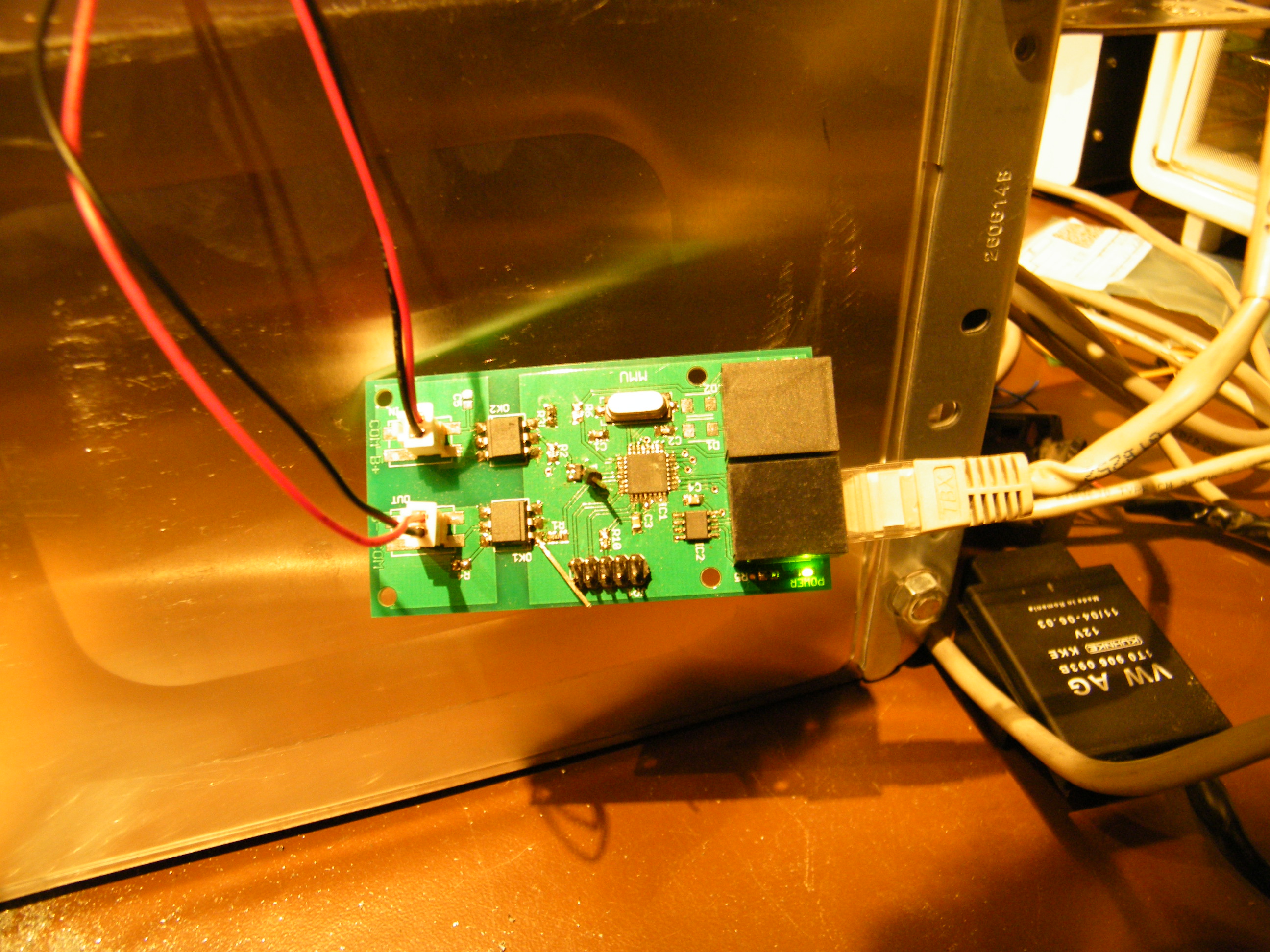

Now I started testing the new BMS slave boards and actually mounted it to the battery today.
I've used that same topology on the Polo except the 1-wire bus (infrared in Polo). Also in Polo resolution is lower and there is no balancing.
- 4 channels
- 1mV resolution from 3.6-4V
- 10mV resolution below 3.6 and above 4V
- 30mA balancing current - balancing is done by programming a voltage set point
- 2mA active current
- 100µA standby current
- 1-wire fail-safe daisy chain bus (it is not dependent of software to pass through messages)
- Self-addressing
- Fully field up-gradable via boot loader

Are you rolling your own BMS too?
Oddly enough I started the schematic for the cell modules for one today. Is 30mA going to make a dent for balancing with the large capacity of these cells? I was thinking of putting the resistors for balancing on a separate PCB, but switched from the cell module.

I did a 1-year test run with LFP batteries. Basically I charged and discharged two packs in turn, measured voltage curves, internal resistance curves, and balancing behavior.
What I can say for sure is that balancing is an extremely overrated topic and thus 1A (or more) balancing currents are over speced. What very basic BMSes do is engage big resistors at the charge end believing that something is then balanced. But in fact two cells at the same SoC will reach different top-end voltages due to differences in internal resistance. Messing around with resistors (or even active balancing) in that case is actually counter-productive.
What really disbalances cells are differences in self-discharge. So if you leave two cells at 100% SoC on a shelf for 1 year one will discharge to 90%, the other to 92%. Those 2% within one year is what balancing needs to make up for. That is very little charge.
As a check you will find that the Nissans stock BMS sports 10mA balancing current: http://www.electricvehiclewiki.com/wiki/bms/
