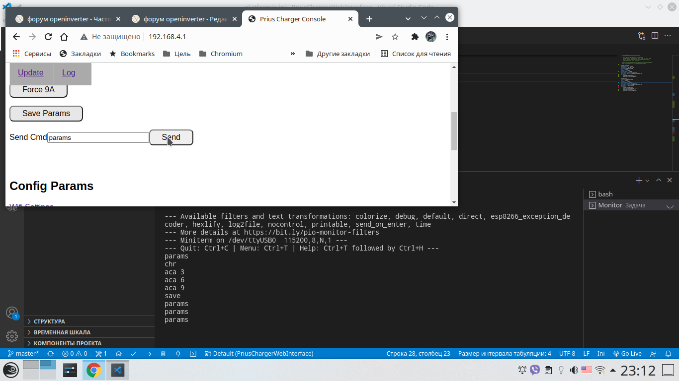

Hello members of the forum! Someone can tell you how to solve this problem - compiling the Platformio web interface gives the following error:
lib/avr/IntelHexParse.cpp: In member function 'byte* IntelHexParse::GetData(byte*, int)':
lib/avr/IntelHexParse.cpp:86:1: error: no return statement in function returning non-void [-Werror=return-type]
86 | }
cc1plus: some warnings being treated as errors
*** [.pio/build/d1_mini/lib6f5/avr/IntelHexParse.cpp.o] Error 1
In my opinion, the parenthesis is where it is needed. But the compiler doesn't like it. :(

Bigpie wrote: Mon Dec 20, 2021 9:15 am if you've cloned from my repo, grab the latest update and try again, I've just made a change.. Just note, I'm not sure if anyone uses the web interface, I went a different direction with charging.
Thanks to! This update helped, everything compiles and loads! It remains to overcome the problem with DHCP
viewtopic.php?f=5&t=2001 :evil:

Hello everyone! Anyone have any success in getting data from atmega to wemos via the web interface? Atmega sends data to the port monitor, wemos sends the "params" command correctly and it is visible in pytty. I connect uart esp and atmega - there are no parameters in the web interface ...
atmega firmware:download/file.php?id=10638 from Bexander. ESP firmware: https://github.com/jamiejones85/PriusCh ... bInterface in which I changed the speed of the serial port from 57600 to 115200 (the same in atmeg) (I did the right thing?)
Posts: 1599
Has thanked: 75 times
Been thanked: 308 times
Re: Gen 3 inverter converter control software
I made changes to the firmware also for the parameters, https://github.com/jamiejones85/prius3charger_buck (out of date with Bexanders firmware), but I've not used or developed it further, I went with a different charging setup.
