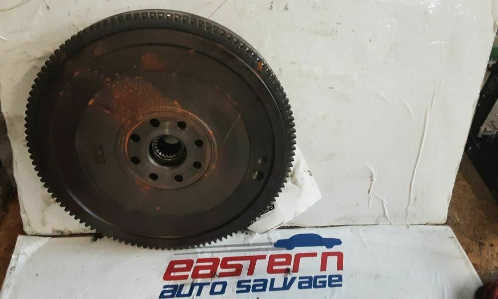

The same eBayer who had the transmission had a listing for the flywheel for $115 so I bought it, I think it came to $125 with tax and FREE standard shipping this time
