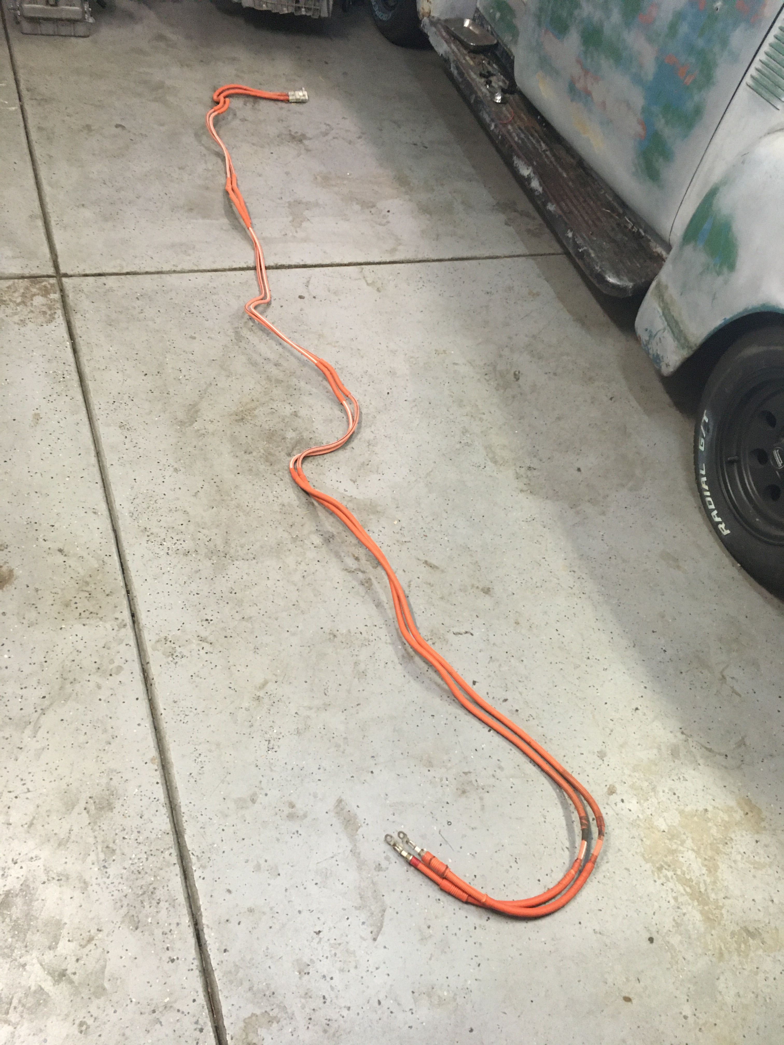

and this is what the stock Lexus battery high voltage orange wire harness looks like, I also bought it with the trans for $100 not sure I will use this one, but this being my first car conversion I want it to be as plug and play as possible

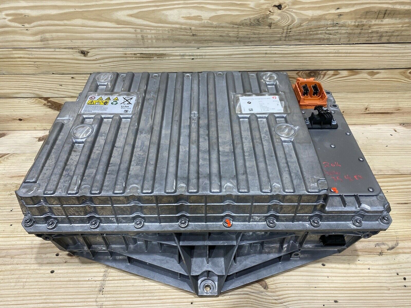

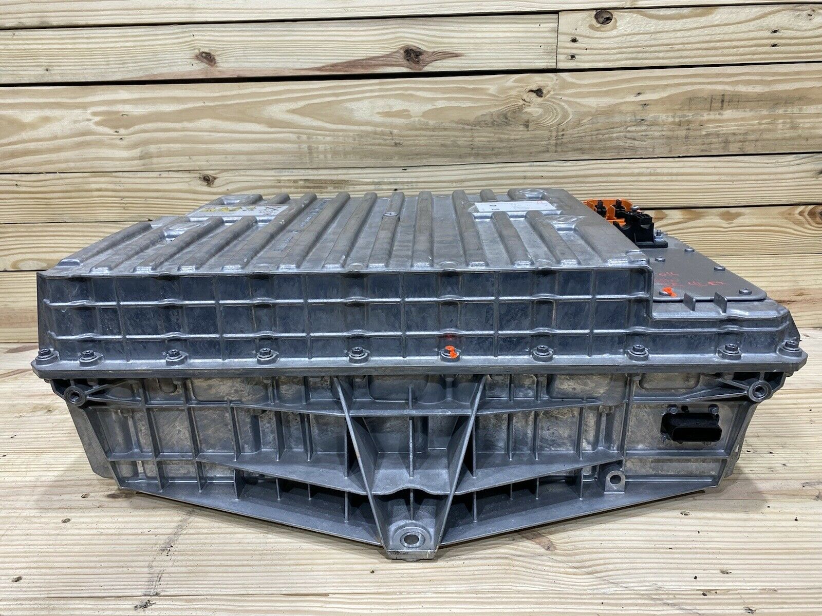

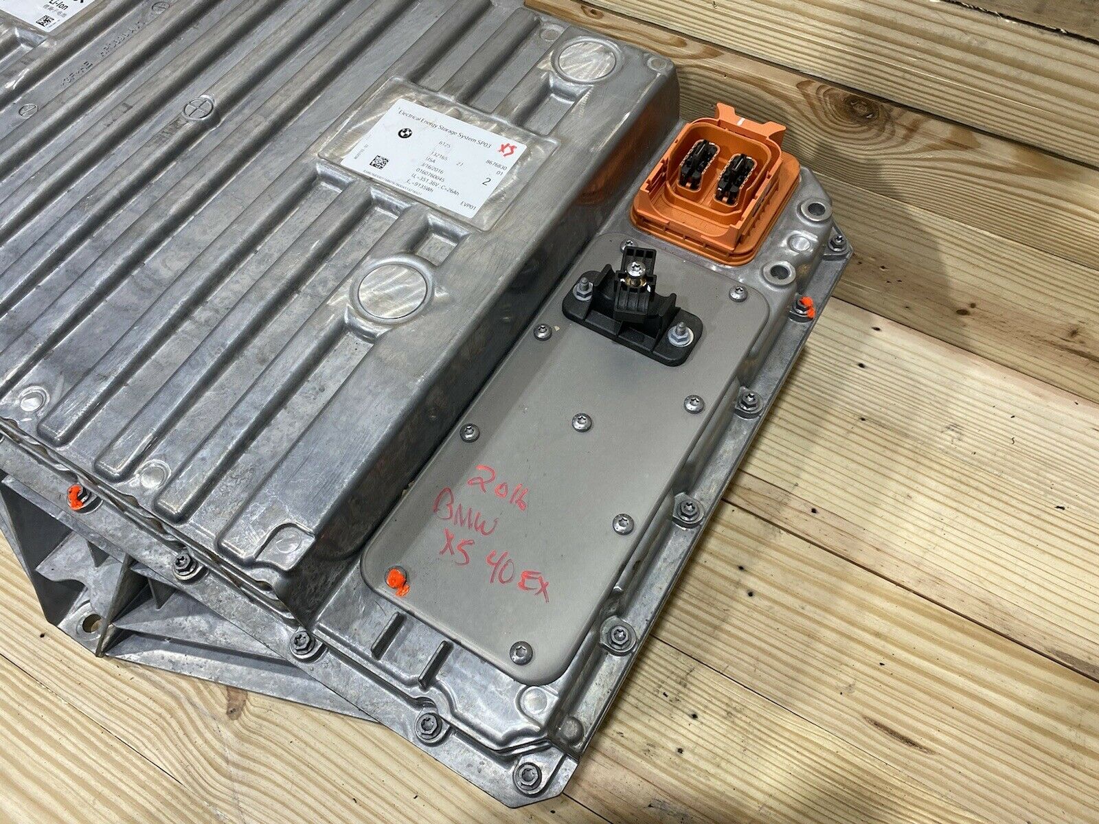

on a side note do to some shady eBayers erroneous listings at one point I thought this is what the BMW 530e hybrid battery form factor looked like, so I was really excited about shoving one or three of these under the bed of my truck
but as it turns out these come in the BMW X5 SUV (if any of you have one of these for sale or know of a guy who knows of a guy, type of thing, please holler at me) thank you

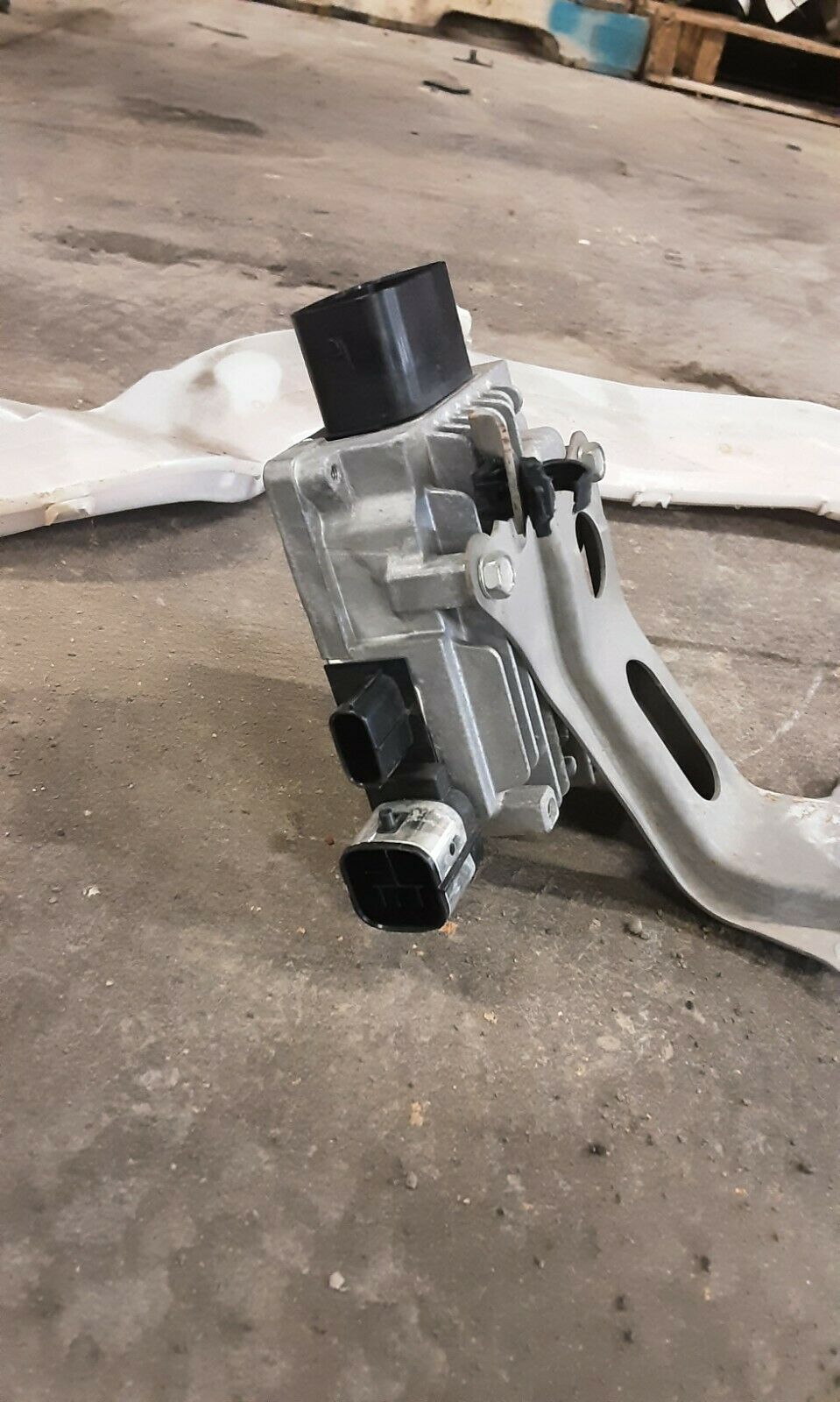

with the big stuff gotten we turned to going after the smaller bits, so got this BMW E46 hall effect throttle pedal, my truck has an ancient mechanical drive by cable throttle pedal so I don't know if, if it was a newer truck with drive by wire if you could use that, maybe someone can chime in and tell us
anyway Damien Maguire uses this pedal, so if it is good enough for him it is good enough for me, having done a number of LS Engine swaps I know to take the path of least resistance when possible as these projects will provide plenty opportunity for headaches anyway, no need to make your life any harder, know what I'm sayin'? and I am not partial to any brands or manufacturers, I just want this thing to work
so found this one on eBay for $40 bucks, the reason I picked it is because it came with a pig tail, ie about a foot worth of wire harness with what's most important is the plug, you see I like to build nice connections and not Mickey Mouse anything so if we have the original plug that is gold!

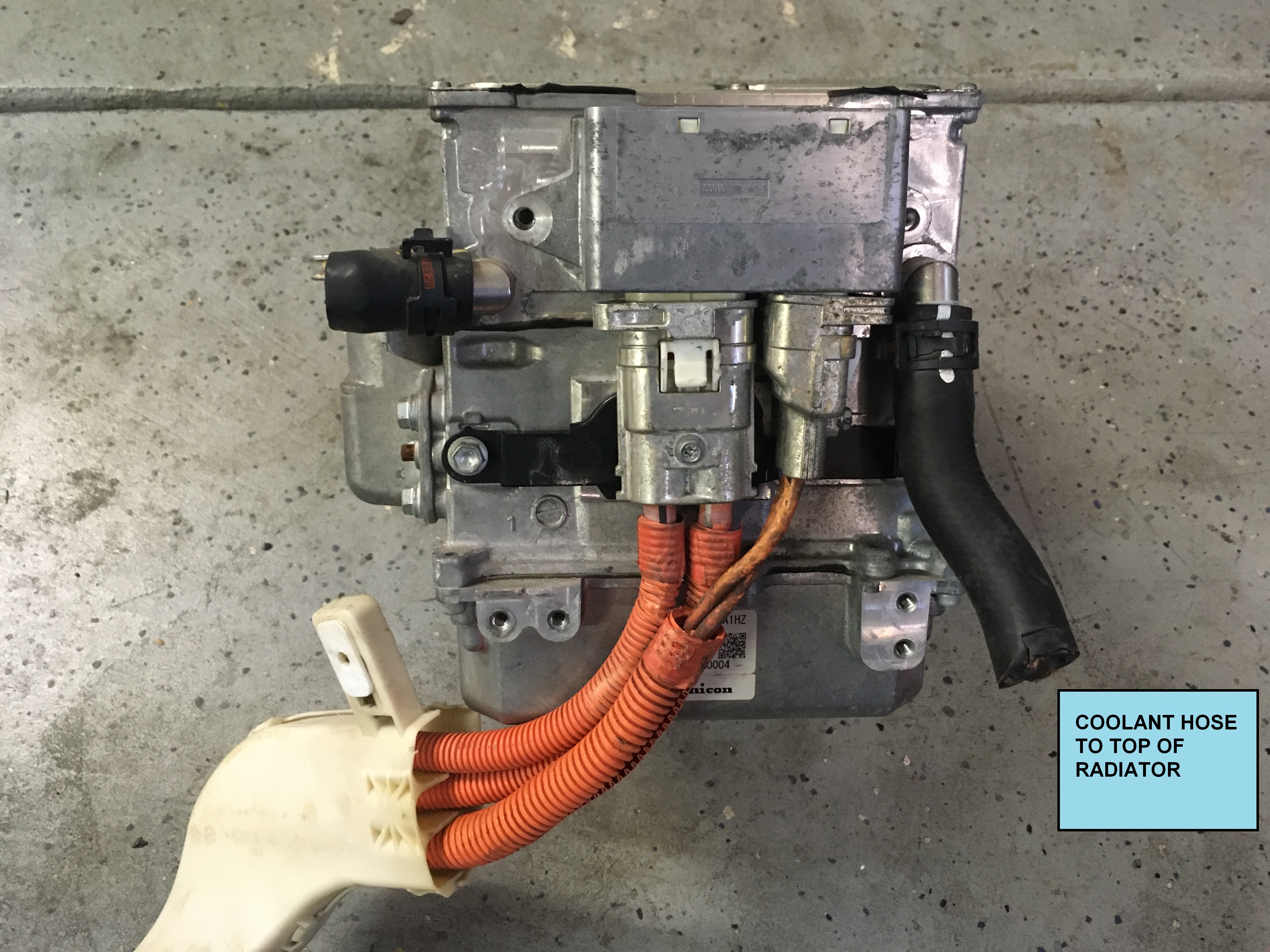

and here's how the stock Lexus battery harness plugged in to the Inverter

since we are already looking at this side of the Inverter lets label the rubber hoses, one goes to the top of the radiator and the other comes from the bottom of the radiator via an electric water pump
