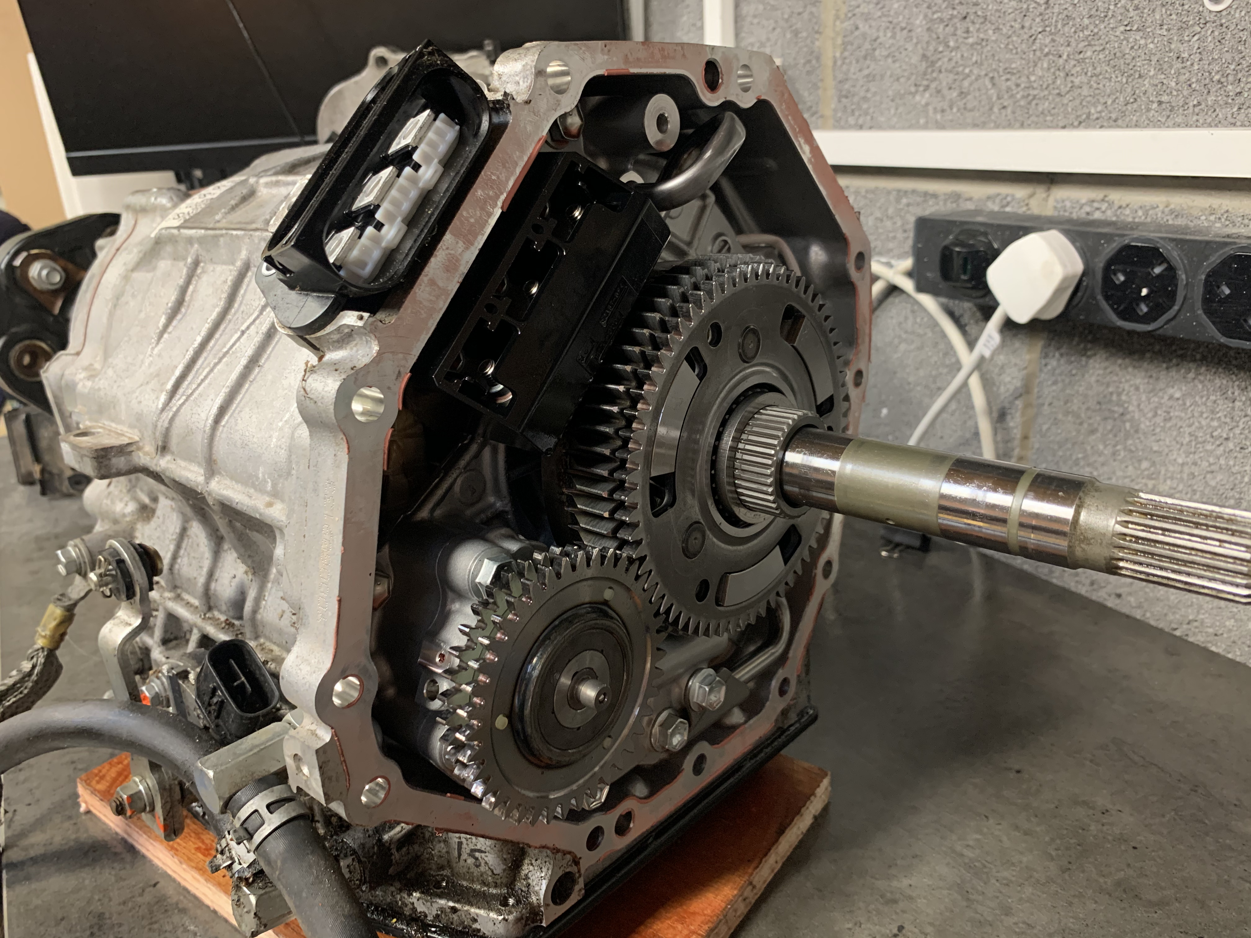

Sorry if this question has been asked before. I have gone through the threads but not seen this particular question.
I am converting a Morris Minor. I have acquired an IS300H gearbox and inverter. Originally had only 30 bhp. So I don't need the combined power of MG1 and MG2. Looking at the box from the outside there is a split so I was looking at taking the bell housing end off with that motor. Looking at pictures from Chrskly (Great info). I believe the mechanical oil pump would be exposed. If this were replaced with an external pump, would it be feasible to remove that front motor? What issues would occur? I haven't taken my gearbox apart yet to have a look. But if the idea is a non-starter I'll have to figure out how to fit the whole transmission.

Re: L210 gearbox
Long story short, this is possible, but it would require some non-trivial machining skills. Here's a photo of the part of the CVT you'd need to be covering over. 1. The input shaft/planet carrier piece can go, but you'll still need to keep the big MG2 ring gear. You'd need some sort of carrier or retainer to hold the ring gear in.Shaf1926 wrote: ↑Wed Feb 10, 2021 11:23 am Sorry if this question has been asked before. I have gone through the threads but not seen this particular question.
2. Since you're keeping the ring gear, you may as well keep the oil pump gear. The upside is that the oil pump will keep working. The downside is that the ring gear and oil pump stand out quite a bit. So your cover that you need to make wouldn't just be a flat plate, but a fairly thick, fairly complex-shaped piece of machined metal.
3. Pretty sure at the top you have an oil channel that feeds oil to MG1. It would probably be fine just to pour straight down, but you'd need to be sure to leave clearance.

Re: L210 gearbox
Thanks a lot for this. Those tasks are probably quite doable. As the machined cover plate would be non structural I don't think it has to be machined out of metal.
Could be machined or of composite. Or even perhaps 3d printed, so long as it isn't porous and is strong enough to be clamped to the casing to make a good seal.
Whether it's worth the effort is a different question but thanks for your reply chrskly
