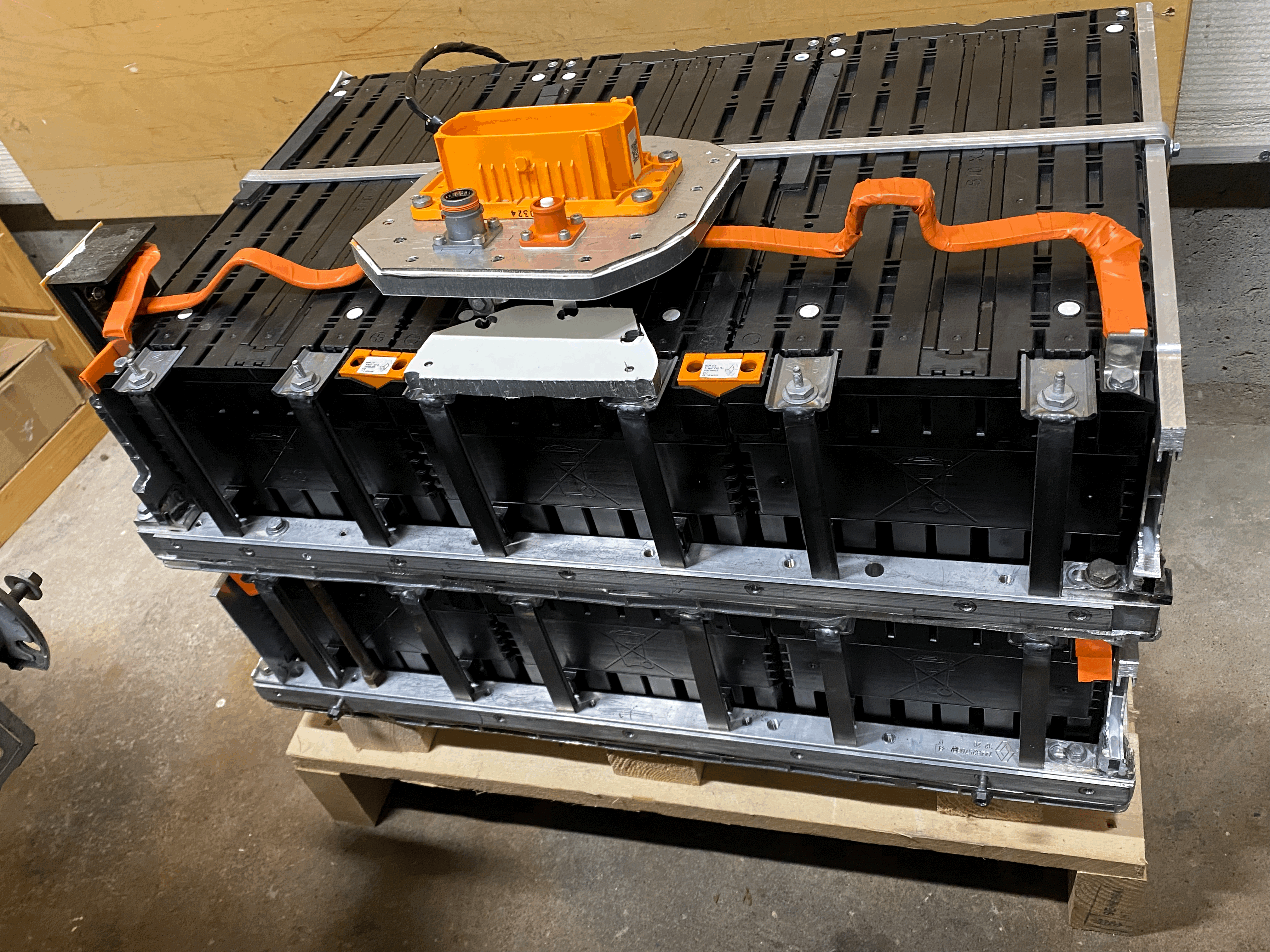

Time for an update=). Starting with battery.
I live in Sweden. EV batteries are 50-100% more expensive here than in Norway. However due to covid restrictions I couldn't travel there for like 6 months. So that sucked. Anyway I ended up purchasing a 2021 Renault Zoe battery for a good price. 52kwh. Consisting of 12 8s modules. 4450wh each. I will be using 6 in the front 4 in the rear. 80s will be sufficient for the leaf inverter. reusing the battery tray. Going in something like this. Fits just barely. More on the battery box later. BMS is based on MAX17823B. I am maybe going to try to make a master board. Bexander here on the forum has already made it work. Awesome! viewtopic.php?f=26&t=1179

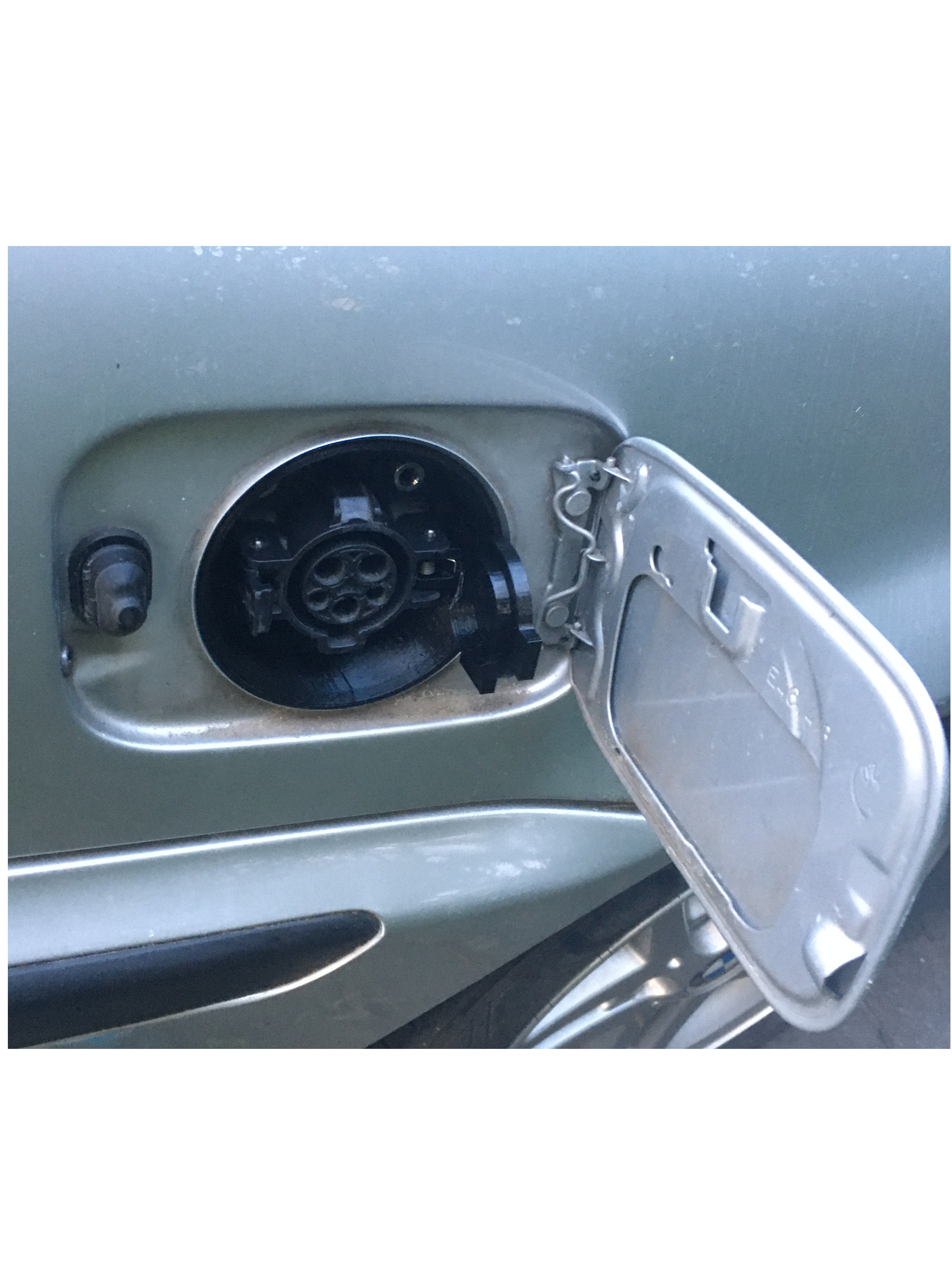

Charge port assembly. J1772. Two 3d printed parts that presses the assembly, holding it together with 4 bolts. Thus no need to weld or drill into the car.

6*4.5kwh=27kwh
Yes, that's only in the front.
Pretty tight however. The modules wouldn't fit in this config if they were 1cm longer.
