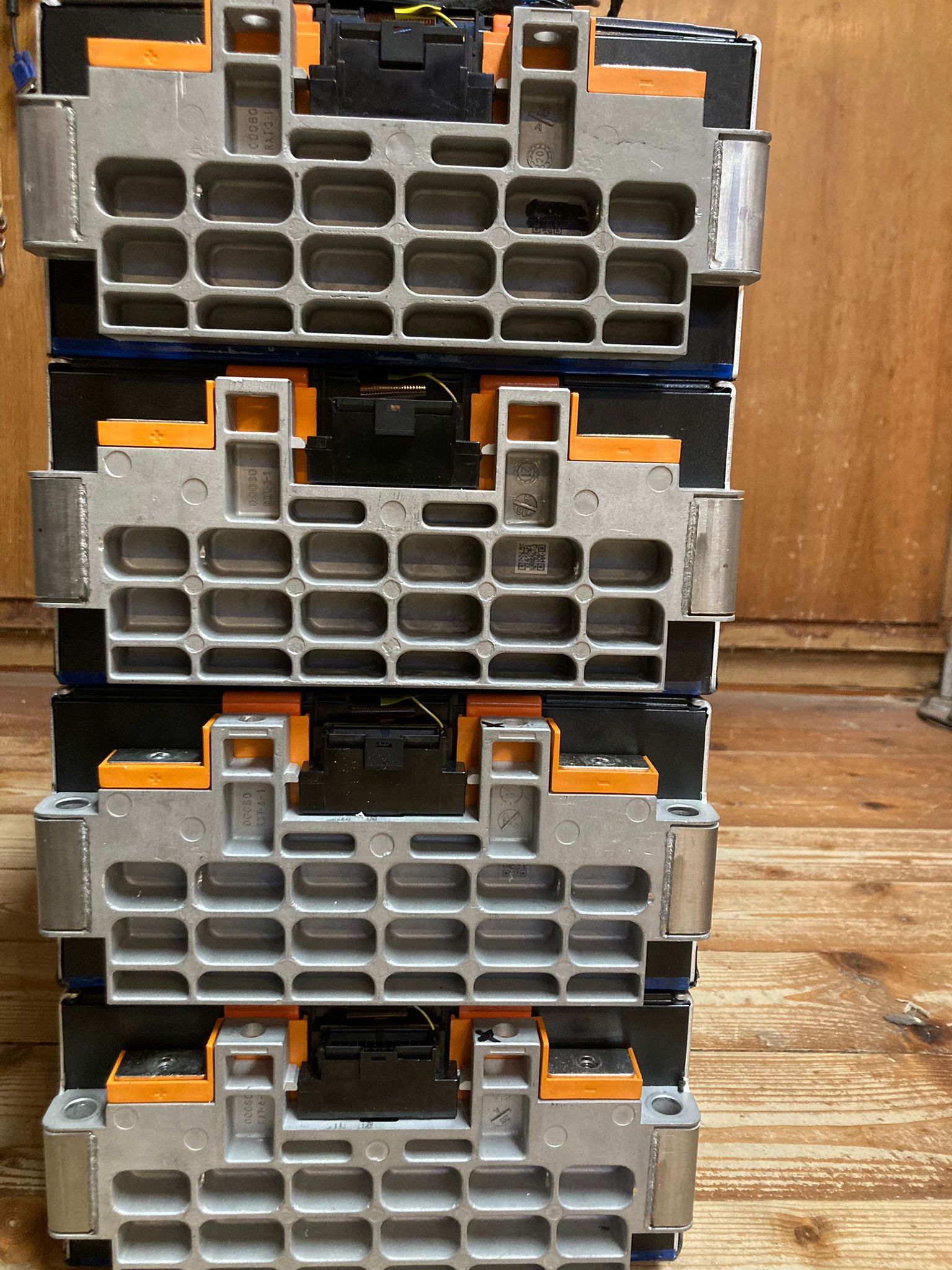

I met the eClassics team and they use all 8 modules in their T2 conversion without water cooling despite charging with 100kW.
The modules dissipate heat via the floor pan while driving. They get all the data from VW including the inverter protocol but are not allowed to share

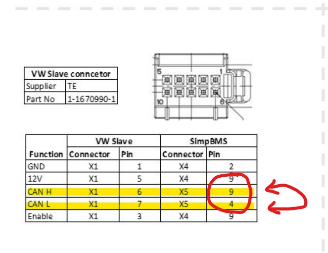

Re: ID.3 and other MEB battery packs in conversions
Correct they are "Dumb" modules, so have the external long black boxes in the packs that function as the slaves. There are different slave modules, with varying amounts of module connections.
Few limitations:
1. All cell tap connectors need to be connected on the slave for it to send plausible data
2. Limited to utilizing slaves with different IDs (so no mixing between packs)
3. No balancing as of yet I require a working internal battery can capture with balancing occurring.
Pinout for the slaves:
Slave Can Connector

Yes I believe the black connector is the 12V and canbus
Which version of the SimpBMS firmware should work with the ID.3 modules and the stock slave modules? Mine is version 210614. I see no canbus traffic to either oneway or 4-way slave module.

VW firmware, there will be canbus traffic if wired correctly.

Hello Raine,
VW ID3/4/Skoda Enyaq oem slave boards bms cable pin-out in MEB battery box
check photo
take off the tape from bms cable, locate green/white(12V pos) brown(gnd), orange/blue(Hi) + orange/brown(Lo)
there you go.
at least this is how I got can-data
best regards Carel

Thanks Tom and Carel for your help. I got the canbus traffic going finally. There was a small discrepancy in the SImpBMS documentation between Can H and Can L in the user guide ver 0.27 at page 12 of the VW slave connector wiring:
Thanks again for your help!
The Can H should be pin 4 and Can L pin 9. This is correct in the page 11 where connector X5 is detailed, but this one at page 12 misslead me.Thanks again for your help!

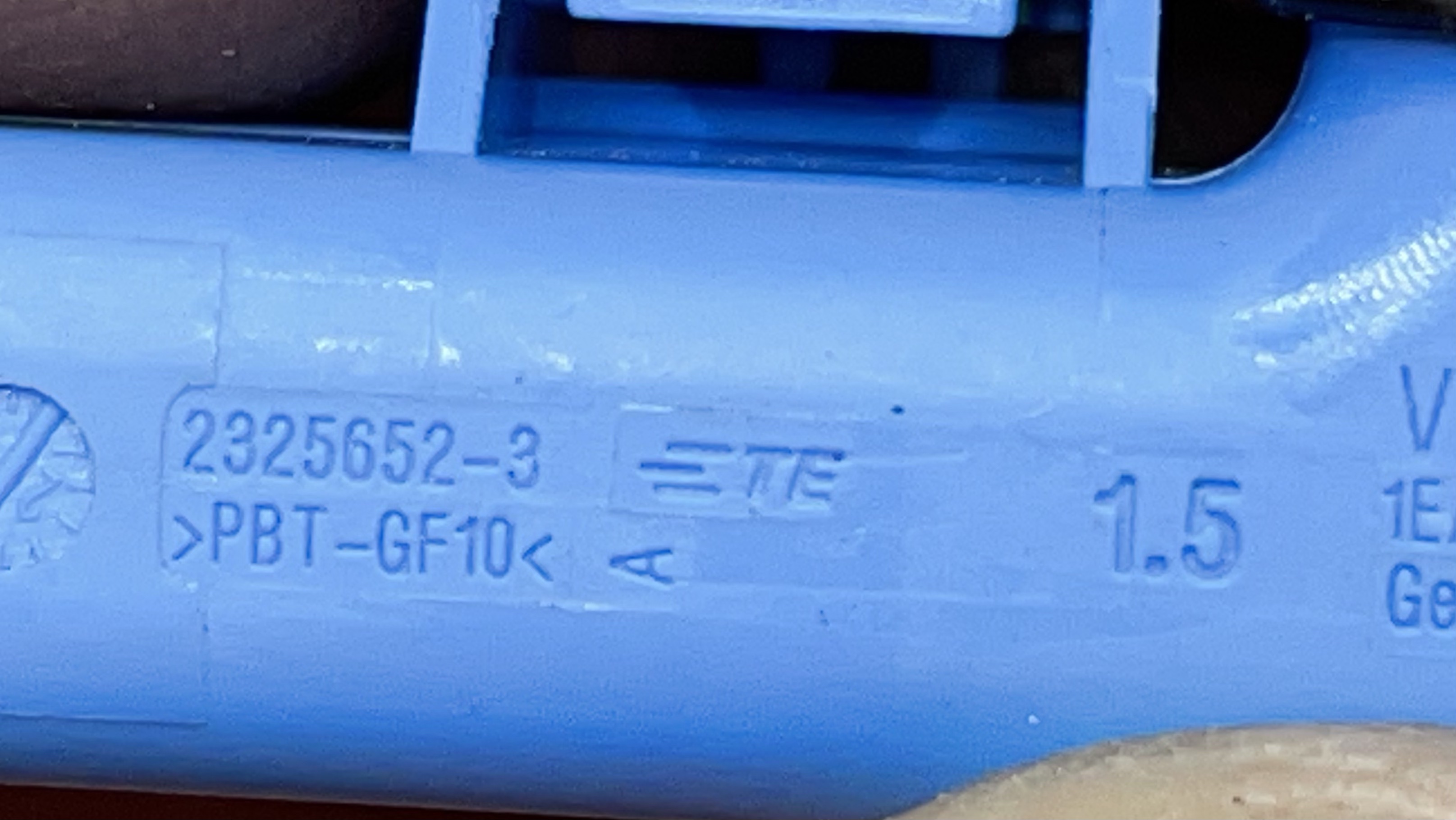

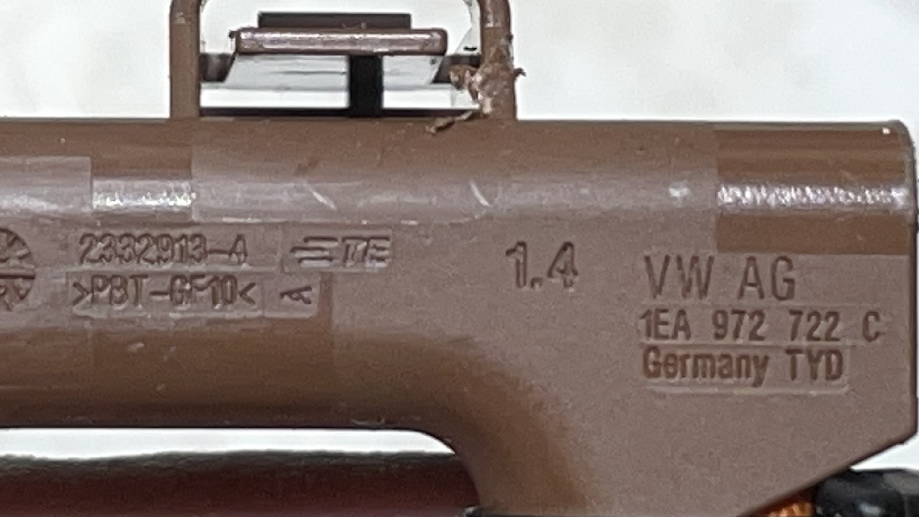

I just registered to this forum because of this thread.
My conversion project is at the beginning and I will use these accu modules from VW's MEB. I got a bunch of them. Mixed 8S and 12S.
First I figured out the pin configuration of the 22 pin "BMS connector". I was also able to order the connection cable to that socket at a VW dealer.
But today I learned, that the plugs of the cables are keyed for 8S and 12S modules. In the socket there is "nose" which prevents plugging in the wrong cable. I do not know, whether there is more difference than this in the cable.
Below is a photo of the cable for 12S modules. Actually I am looking for the part number of that cable for 8S modules. If someone can help... Thanks a lot!
Best regards, Jochen

Thank you Carel for your offer. I gues I will use it, if I understand what happened today.
I am playing around with a 12S version of such an accu module. There is this 22 pin black connector. It contains the 12 voltages and 2 NTCs.
I expected 13 Pins for the 12 voltages. But the lower most voltage and the upper most voltage can be found twice at the connector. Does anybody has a clue for what reason this could be the case?
So I selected arbitrarily one of the possible two pins on each side of the row and connected a balancer. Since all voltages were visible, I started balancing. But it worked for some seconds only. Then cell 12 was disconnected. The used pin for plus pole of cell 12 is dead now. What could have happened here? Should I just try the other pin, where plus of cell 12 is connected?
Is the balancing of the iCharger to strong? I have to admit, this was the very first time using this fancy device. (In the manual 2A maximum balancing current is given. I looked for that after the accident. )
Does anybody has a clue what happened and what should I do next?

They carry the end cells in duplicate because the BMS receives its supply voltage from one and measures the cell with the other. Thus, the jumps in the current consumption of the BMS do not interfere with the measurement. This solution is called the “Kelvin Connection”.
https://www.voltech.com/support/technic ... nnections/
The balancer wires are protected by a 750 mA internal fuse. If you tried to balance with more current than this, you have blown the internal fuses.
Jochen,
till date we have seen LC CHEM or CATL produced MEB battery modules,
LG CHEM, completely sealed brick,
the CATL MEB variety has a removable top, so one can access the cell-tabs, flex cable and front cell-tab connector
We've experienced the blowing smd fuses too, but managed to find a work around with the CATL brand produced bricks (kudo's Bernhard)
best Carel
best Carel
check facebook page: facebook.com/carel1956
