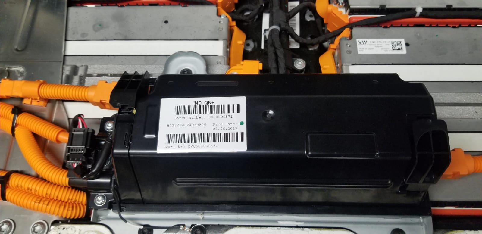

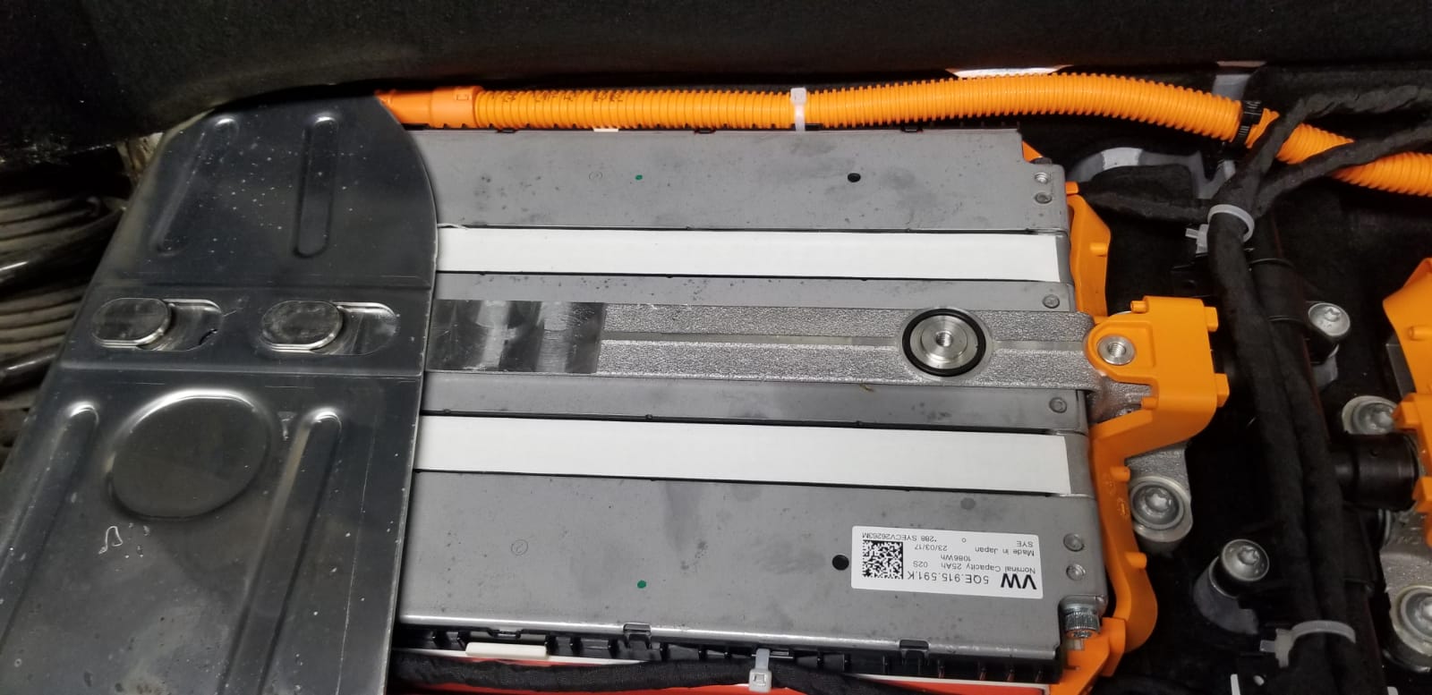

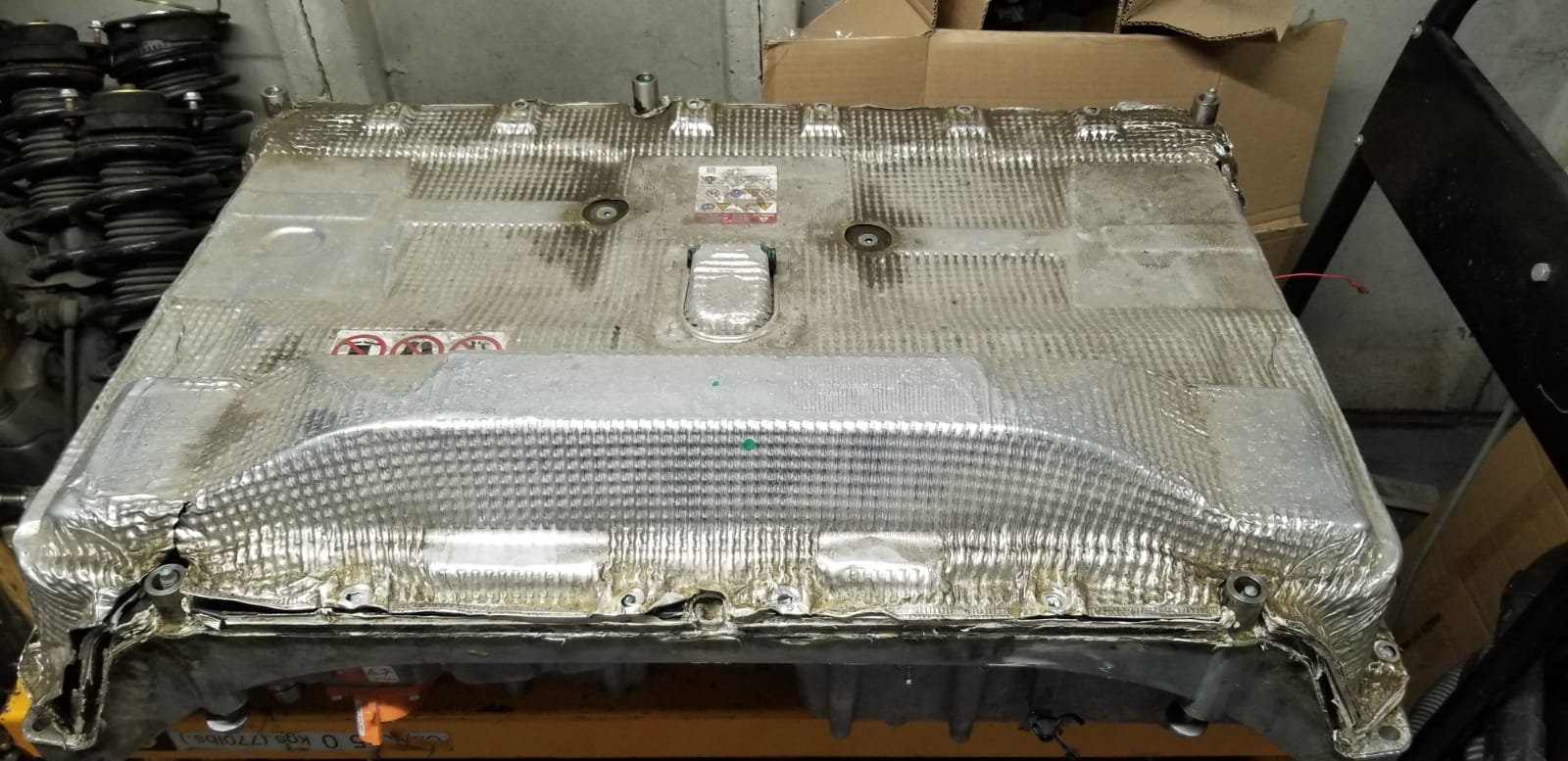

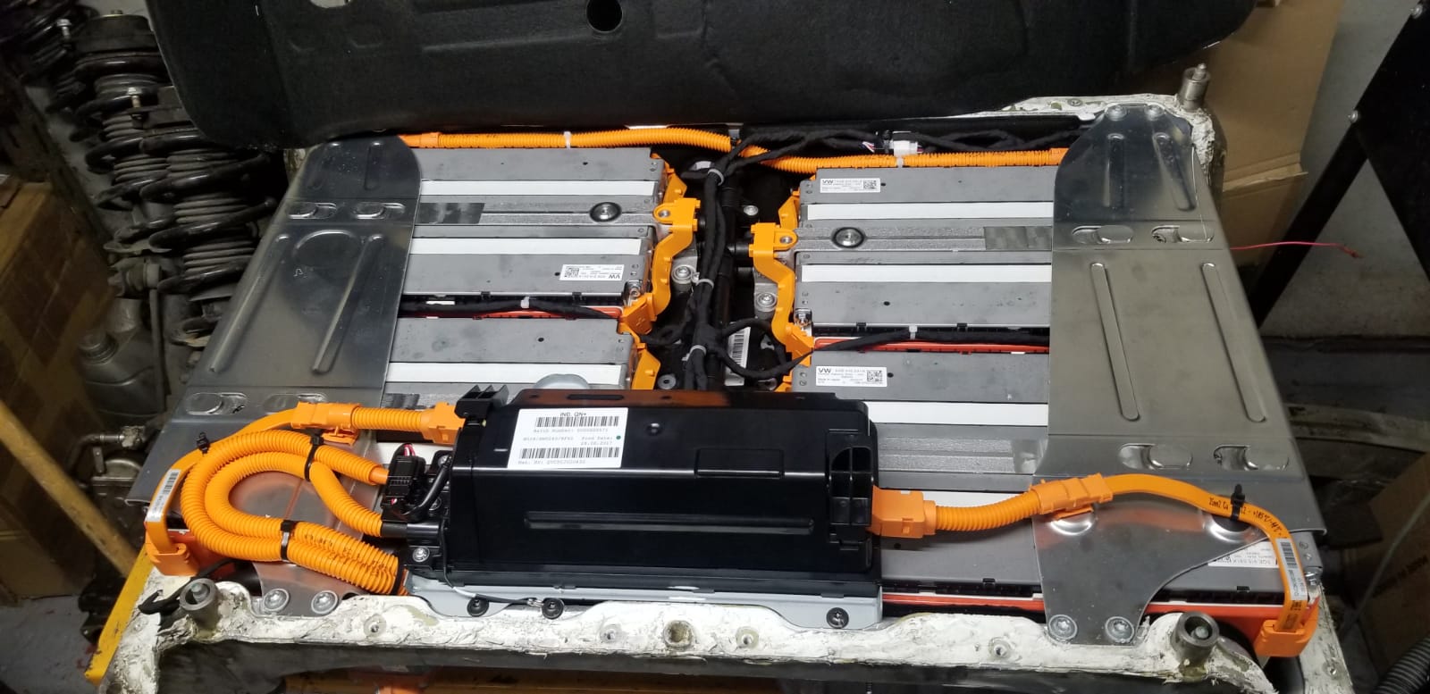

Hi All,
Heres some pics of the Golf MK7 GTE hybrid battery its 8.7kw watercooled. the bms communates to the battery modules thru canbus.
if any one has a golf GTE or Audi etron near London who wouldn't mind letting me plug my diagnostic into to get the canbus control messages would be mega helpful. i would like to control the linbus controlled ac compressor.

Hi this is the pinout for the battery external connecter as near as i can figure.
External Pins GTE Battery and E-up
1 Can H Power
2 Can L Power
3 Airbag Crash
4 Pilot (In)
5
6 12v (30a)
7
8 IGN (15a)
9 GND
10 12v Safety (30a)
11 Pilot (out)
12 Airbag Crash
13 Can H Hybrid
14 Can L Hybrid
you need two 75ohm resistors on the pilot line to remove the safety errror

On the contactor control board, the left most white wire, and right moat white wire, do you have any clues as to what they are for? Maybe the safety interconnect? I butchered the cabling before checking where they go.
The 2 reds next to it are 12v in, the black can low, white can high(battery can) the next black is GND, the black with a ring terminal had 5v on it, assuming it's used for some isolation tests?

I've got a second pack to play with. I've been able to get the contactors to close from the hybrid can thanks to some logs from DomT177
0x3A6 58 02 11 00 00 01 00 00 byte 1 (0 indexed) increaments to 0F and restarts, not yet sure if it cares about that. Byte 0 is always the same, so for 0x02 byte 0 will be 0x58.
https://github.com/DomT177/GolfGTE
This is the pinout of the external connector. To close the contactors 0x09C & 0x3A6 are needed on the hybrid can.0x3A6 58 02 11 00 00 01 00 00 byte 1 (0 indexed) increaments to 0F and restarts, not yet sure if it cares about that. Byte 0 is always the same, so for 0x02 byte 0 will be 0x58.
