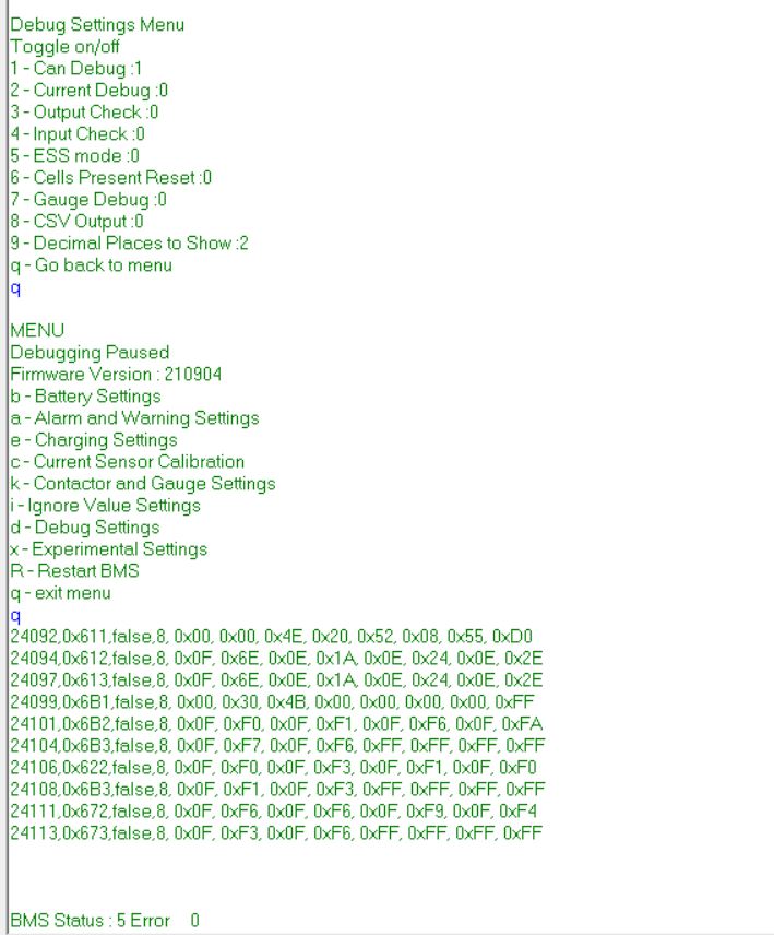

CAB sensor reads out like this during CAN debug (contactors open, did not cycle ign):
ISA sensor reads like this (nothing) during CAN debug (contactors both open and closed, cycled ign during this screen grab):
exiting the menu didn't have any effect, no data showed

tom91 wrote: Sat Sep 04, 2021 8:47 pm you need to only turn on candebug and then fully exit the settings menu. It will the show the scrolling debug and between that all the canbus traffic.
Sadly this isn't showing anything when ISA shunt is selected, just the regular serial interface with no additional data. Here's a shot with the CAB300 in debug mode, I don't see any raw CAN traffic:
thanks Tom

So this is what I get when enabling can debug. Since you have modded some of the code something might be getting broken.

Hey Tom, found the [Serial.print] line of code that was missing and got an output from the ISA shunt showing in the debug menu. Looks like I'm getting CAN but still nothing making it to the BMS itself. Maybe we're parsing the message incorrectly?:
Contactors open:
Contactors closed and current flowing:
Bryson
Posts: 179
Location: California
Re: Simp BMS
Post by Bryson »
Got it. The variable CANmilliamps was trying to pull from the rx buffer and not the can message buffer. Set CANmilliamps as below and we're good to go! ISA shunt compatibility B)
CANmilliamps = ((inMsg.buf[5] << 24) | (inMsg.buf[4] << 16) | (inMsg.buf[3] << 8) | (inMsg.buf[2]));
