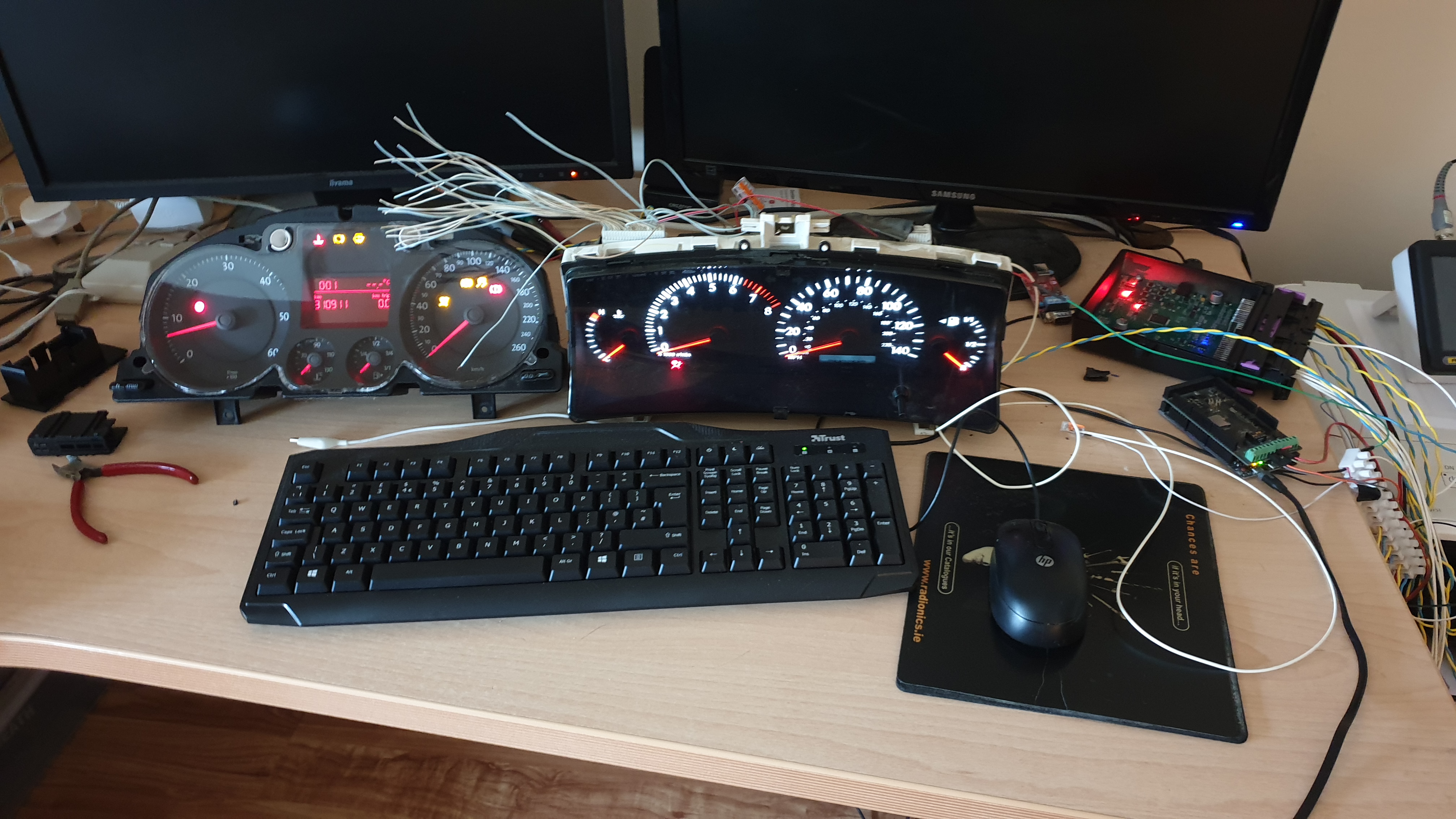

Zombie munching on some VAG and Toyota clusters.

Jack Bauer wrote: Sat Aug 21, 2021 6:13 am Zombie munching on some VAG and Toyota clusters.
You're a tease! :o
Where's the video. :cry:

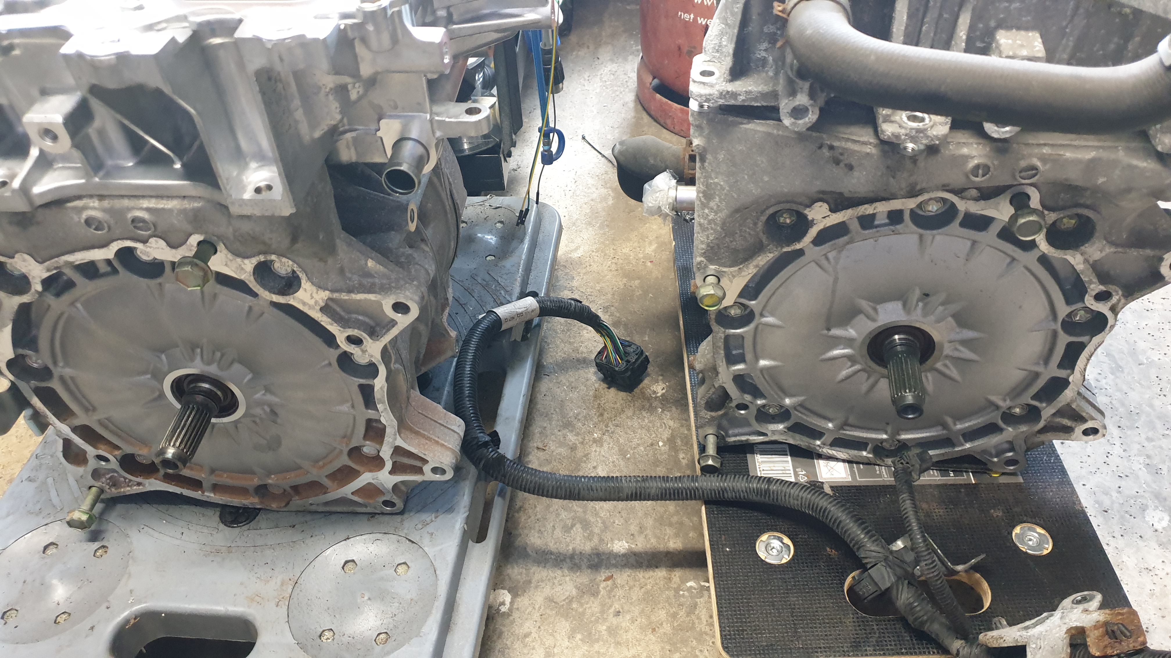

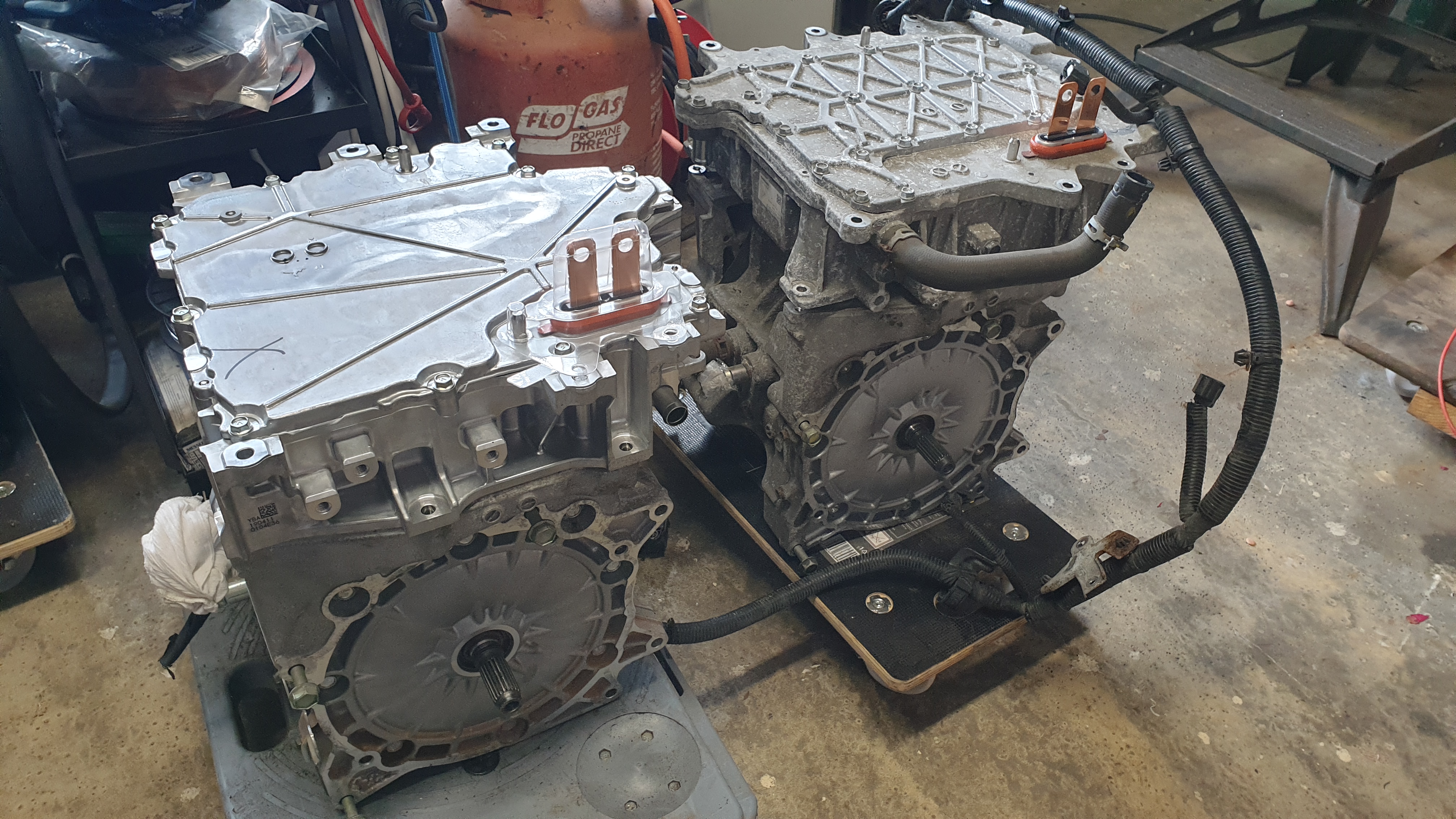

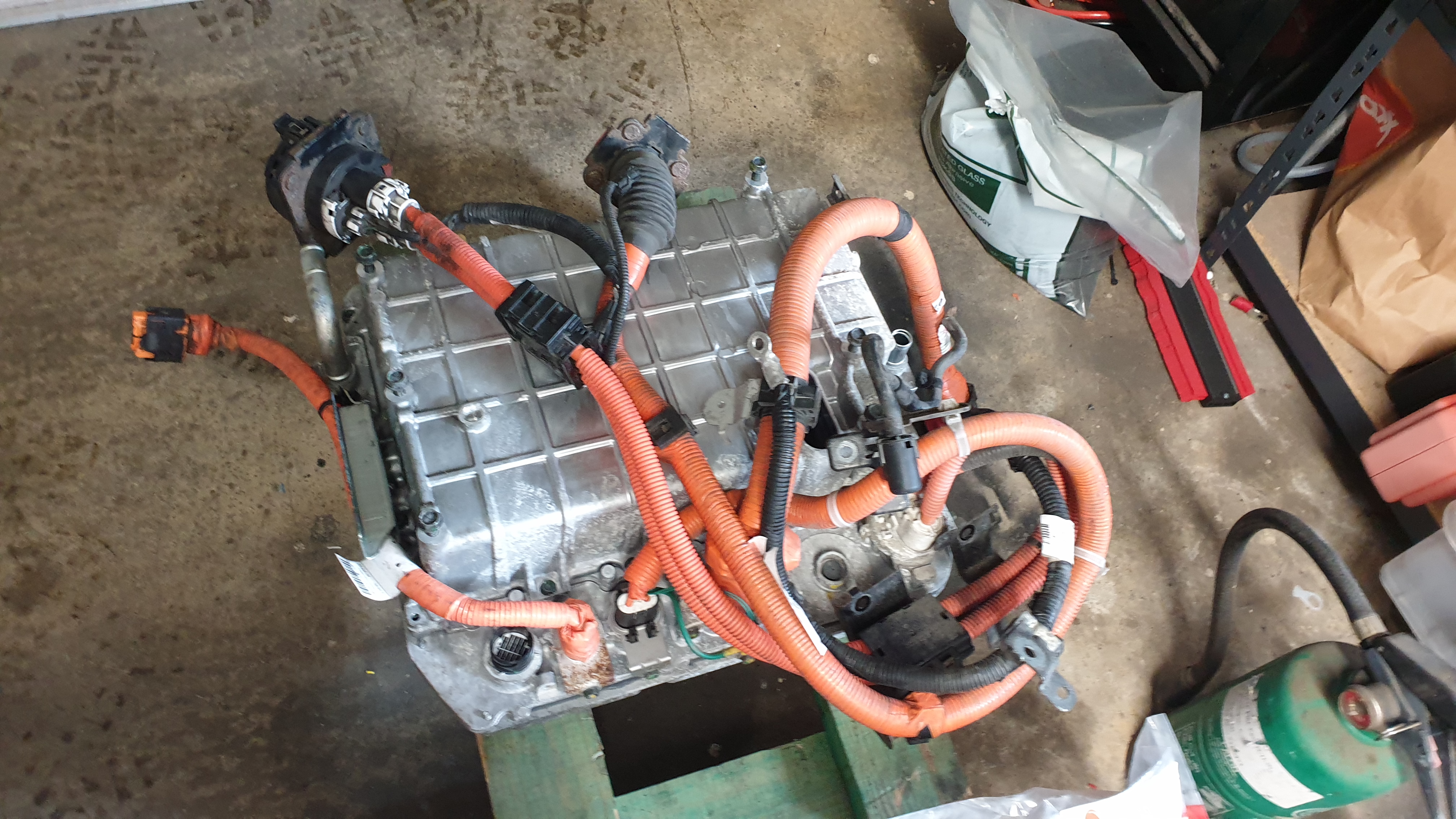

More Zombie food. Complete stack from a ENV200 Van and complete stack from a 2018 Gen 3 Leaf. Soon all you will have to do to run stuff like this is choose the right option from a menu. Whatever happens folks DO NOT contribute or help with this project. I get much more of an ego boost ripping off other people's work and passing it off as my own.

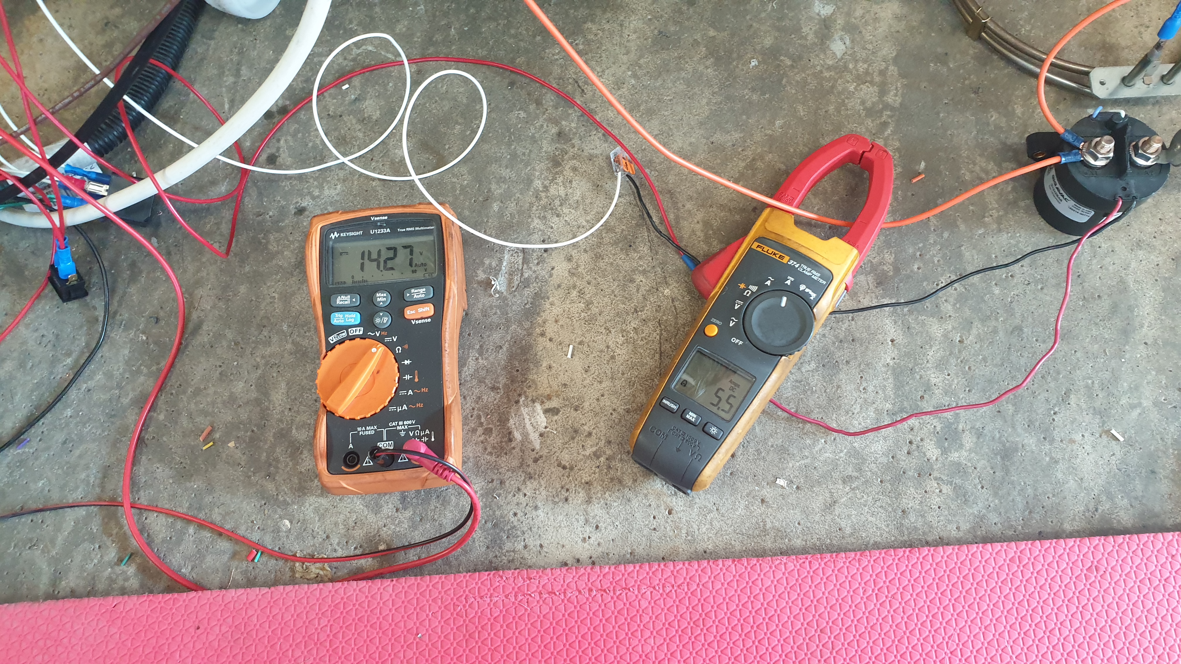

Posts: 3563
Been thanked: 87 times

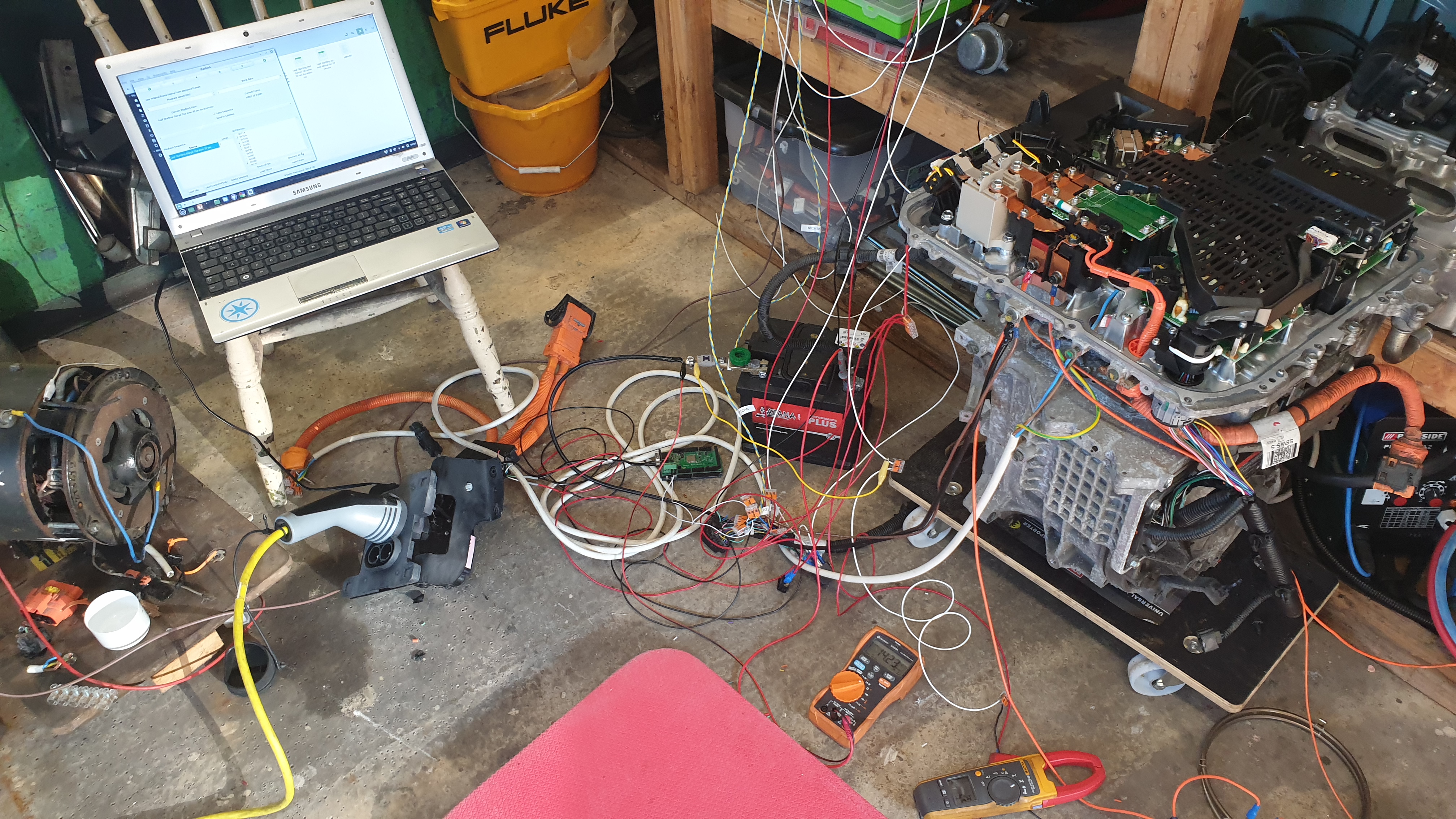

Leaf gen2 pdm now under Zombie control.
Posts: 5806
Has thanked: 160 times
Been thanked: 1037 times
So now we can use the entire "power tower" without any disassembly, nice work! (Provided you find a car that can accommodate it)
