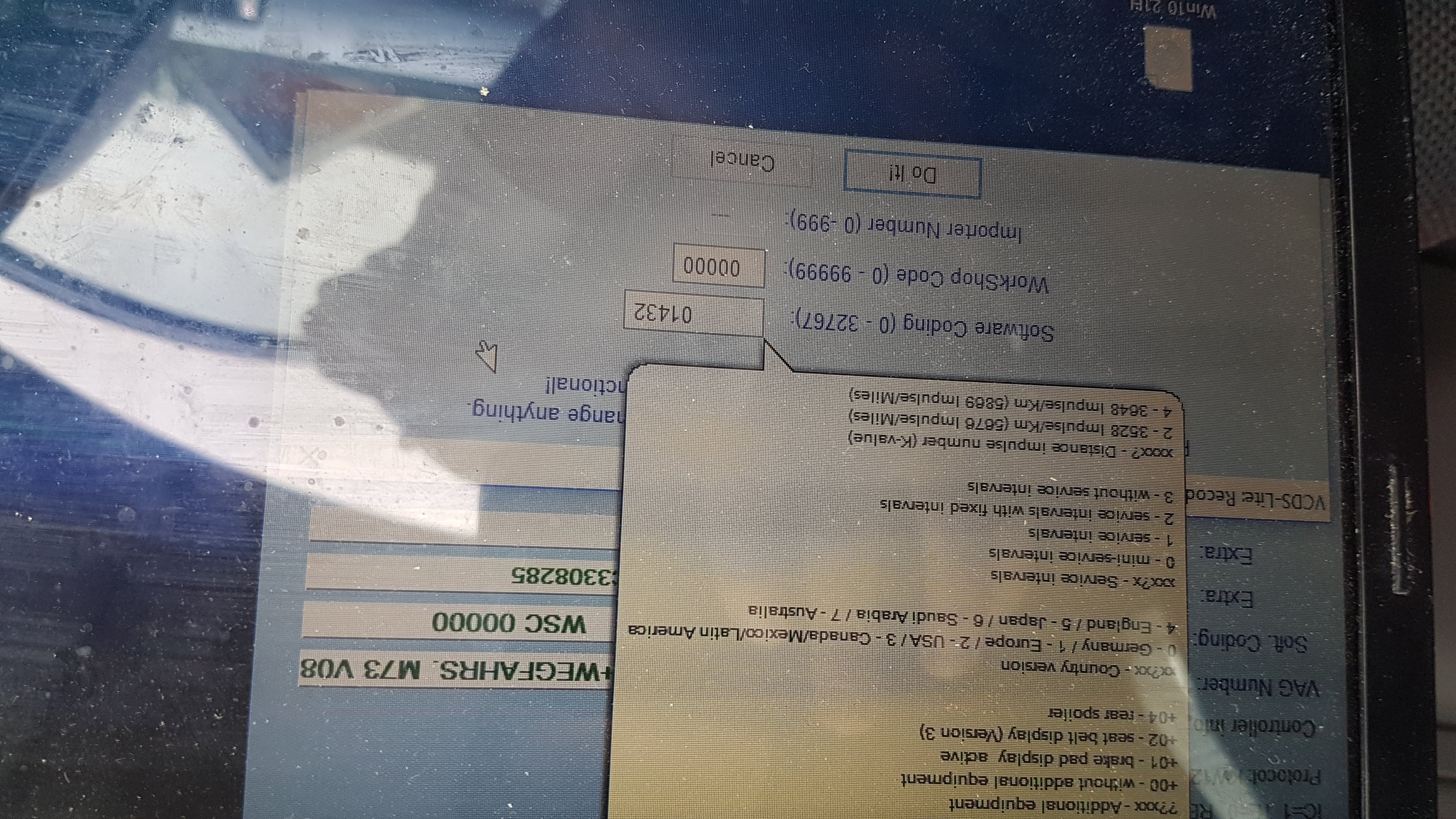

Thanks, managed to disable it, it was a little different to Johannes in that I had to change to softcode instead of adaptations.
Changing the second to last value to 3 did it. No Service intervals. Still got a few more issues to chase on the car errors front but that's one ticked off.

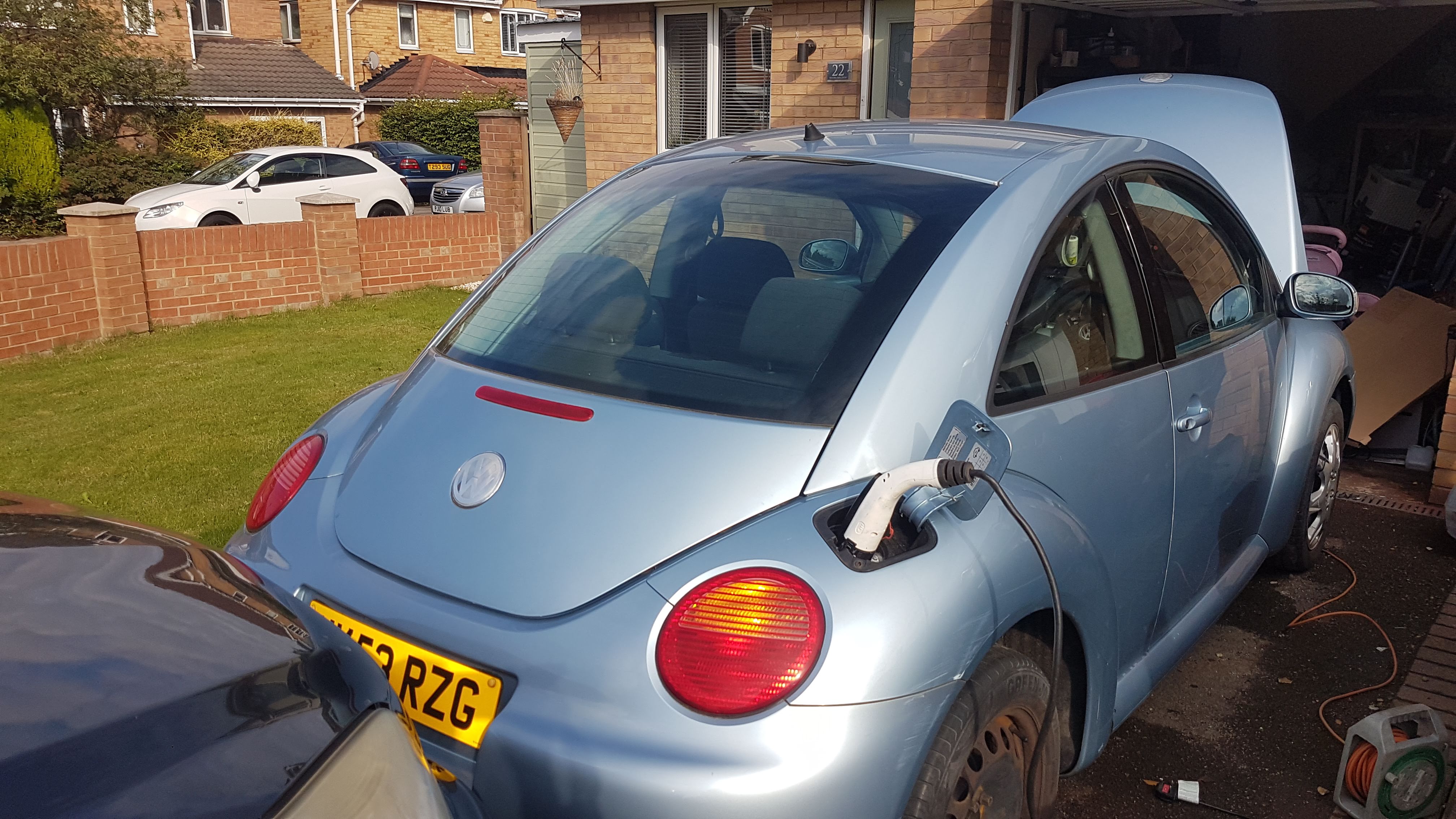

First time charging the car, only left it running 10-15 min for testing. Should be ready for MOT in next week or 2.

Re: VW - Beetle 2003

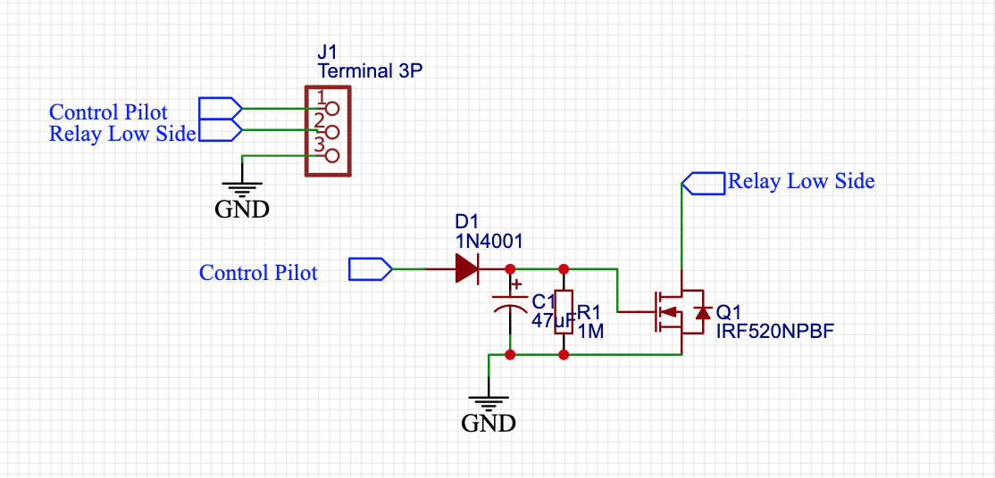

My planned solution is a switch on the fuel door
That is the solution that should be on ICE cars too. No go if charge port/fuel door open.
I use Arduino DUE with a dedicated PP sense pin. When PP is connected to EVSE it will pull to GND and DUE will sense connection and sort out charging, disable the car and start coolant pump. When car is on it will keep DCDC alive and whatever i require. I developed this interface into a version V4.1 where it could even serve as CHADEMO interface.
https://leafdriveblog.wordpress.com/202 ... it-module/
https://github.com/arber333/Arduino-Due-CAN-shield
On my previous conversion cable from charge door oxidized and virtually rotted in a year. I dont recommend this route unless you use tinned cable, and still...

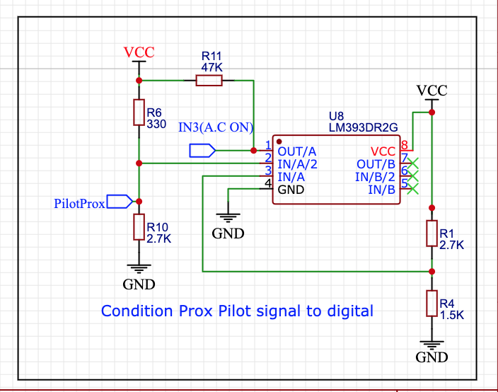

I'm going to use the CP signal with a diode and a IRF520 with a capacitor to switch on a relay to power up the VCU, Simpbms and inverter, with diodes to prevent powering up the rest of the ignition. A comparator for the PP pin for pulling AC present high in SimpBMS.
That's the plan at the minute anyway.

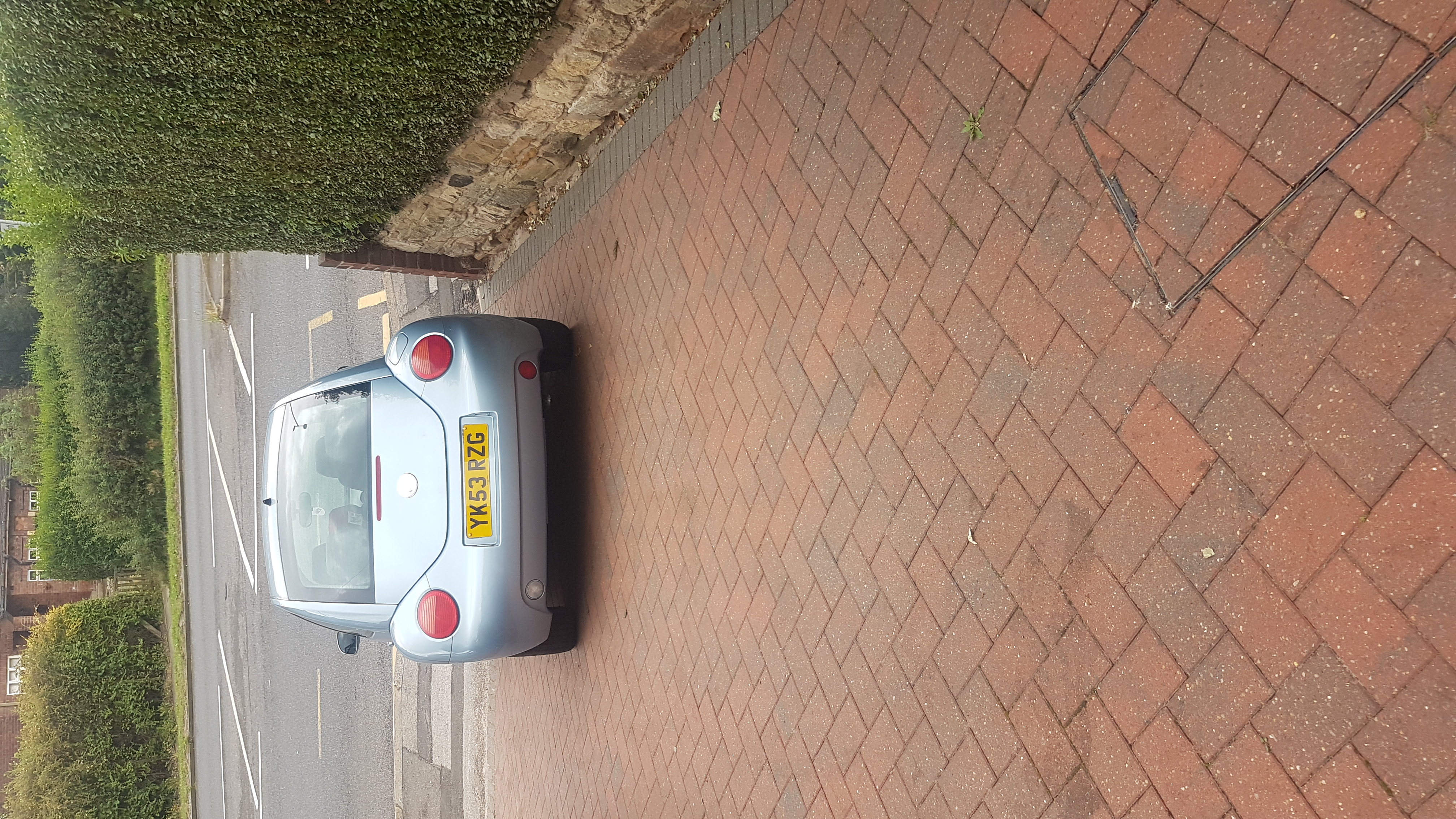

Well I got insurance with Keith Michaels and had a little test drive.

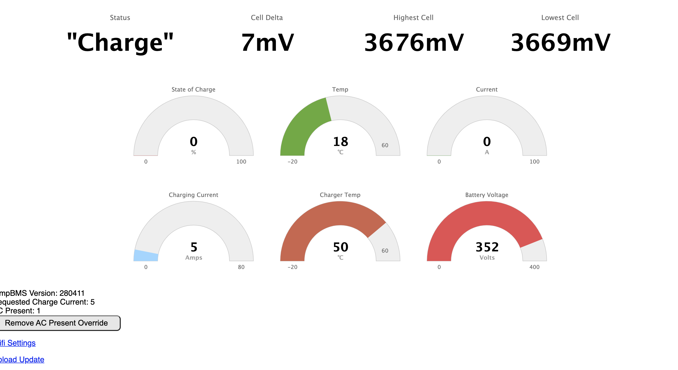

It's getting some Beetle Juice now, only at 5 amp for now. Still got a few bugs to squash in my SimpBMS Web interface but it's looking good.

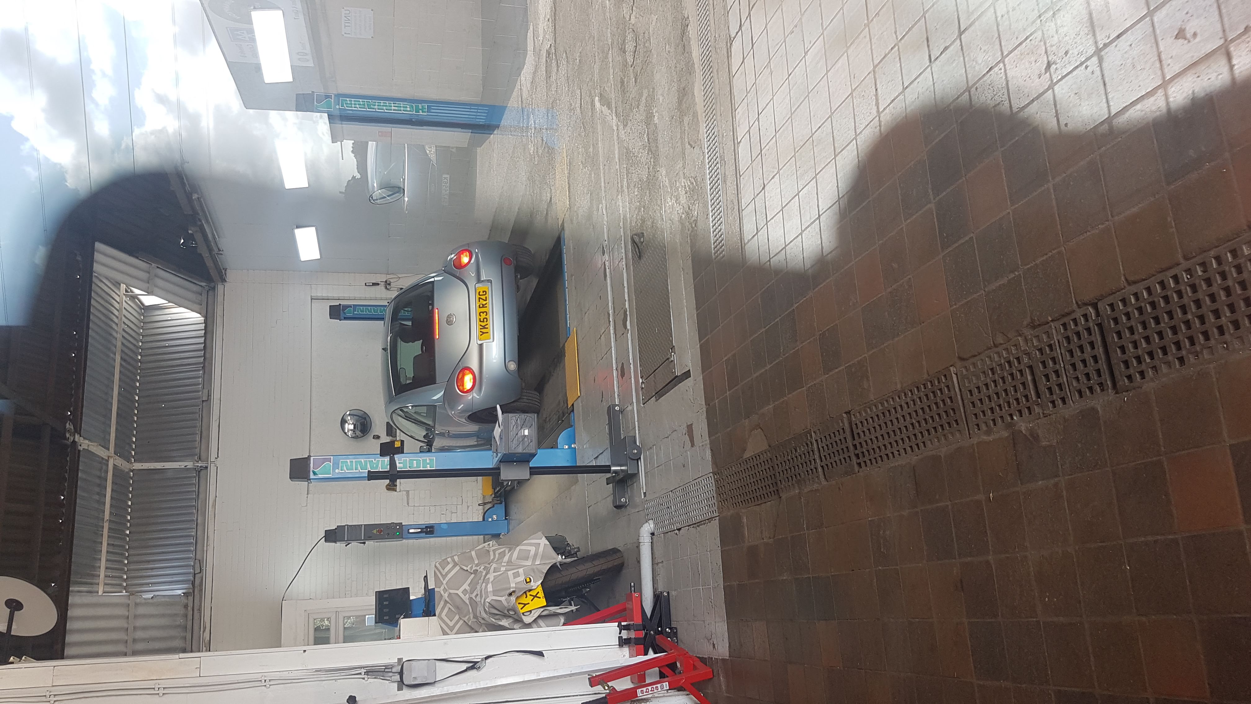

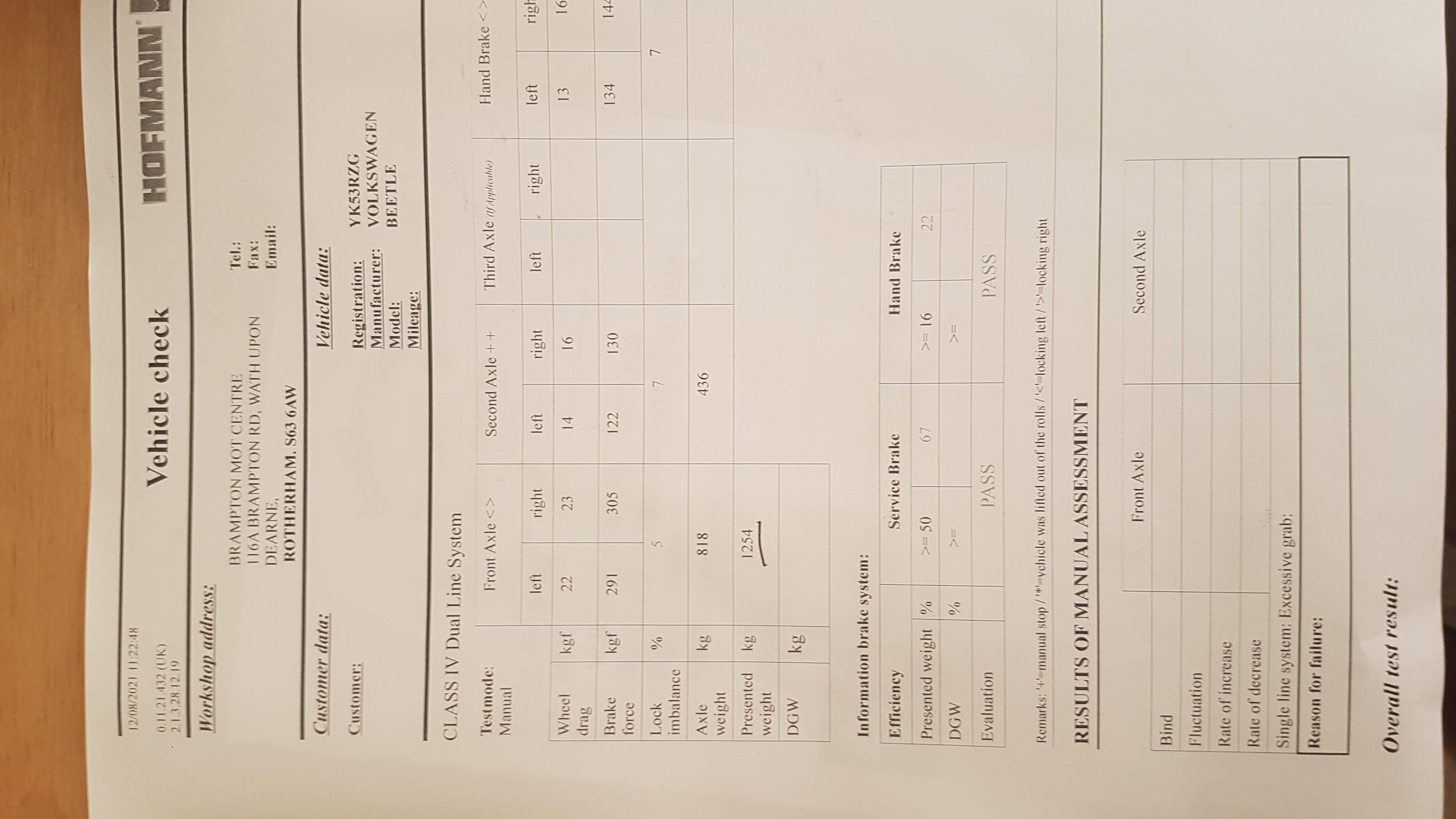

MoT test passed today Got a nice print out of the axle weights too.

Congratulations, now onto the round of continuous improvement that follow

yes, need to get more 'beans' it needed a push off the rollers.

I thought they were heavier, cool!
