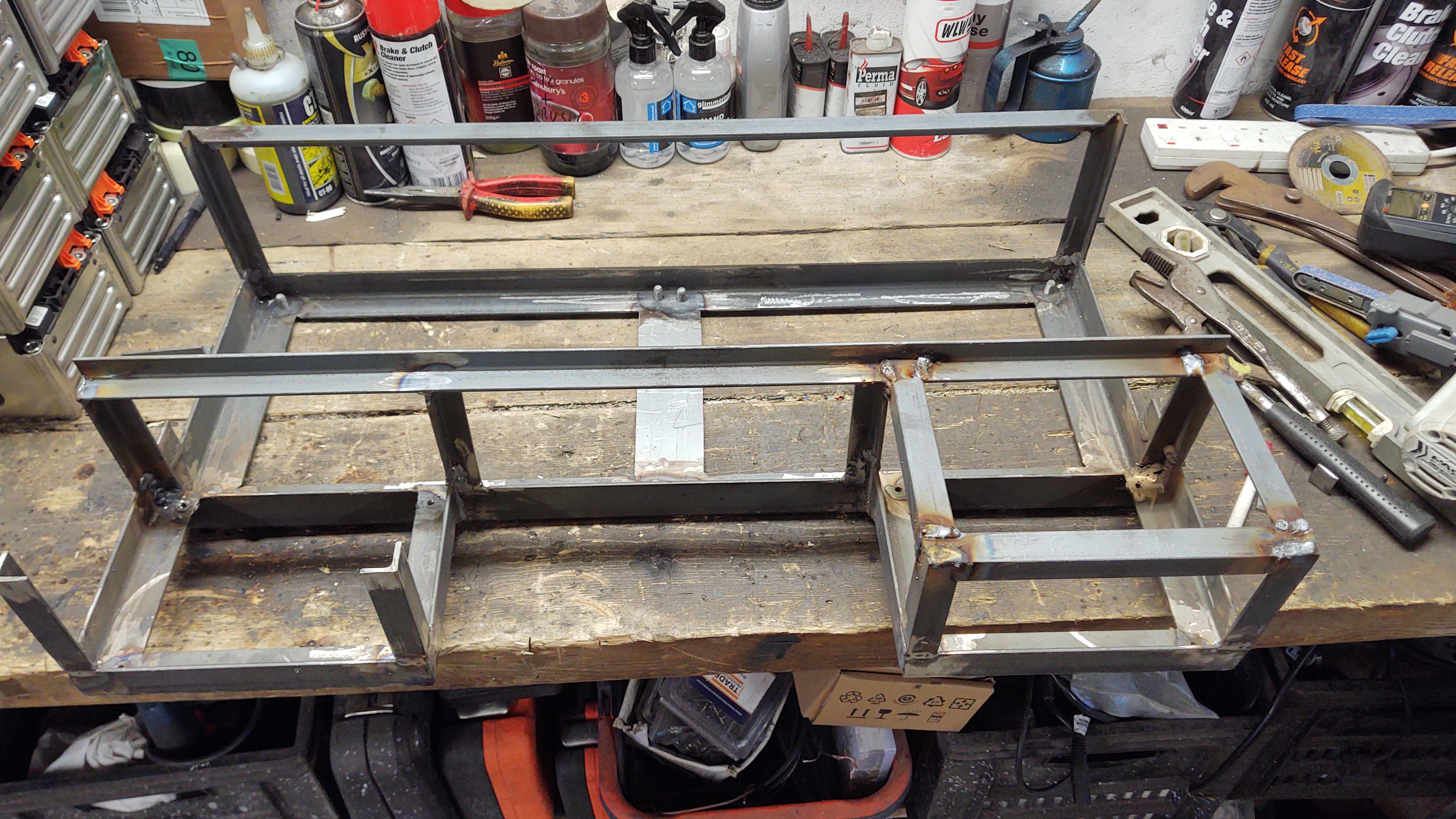

I have to admit I'm a bit embarrassed to admit this battery box frame is still not finished after many hours working on it. The space available is very complicated with lots of curves and bits sticking out never mind a rear diff that is mounted on rubber and can move so a simple box will not fit and I have to allow enough clearance for normal diff movement.
This means every time I think I have the shape sorted I realise I need to change something. On Sunday I finally I got it to the point where I was ready for a trial fit once the uprights were welded in. I lowered the rear subframe, secured it in place and found the bottom was a bit too close to the propshaft.
I cut another 15mm off the height when I saw how close it was but this meant I had to change the way the small modules are secured. Originally I had welded nuts on the inside of the frame but this left the gap at the top of the modules too tight, so I had to cut and grind the nuts out and drill through the angle, tap it and weld nuts on the bottom.
To make matters worse I started with the intention of using M8 bolts or threaded rod but they fitted so tightly in the modules it left zero room for error in my marking and drilling. So after doing the usual mark it, drill it, find the hole has somehow moved, wiggle the drill around to make it fit then give up and use a bigger drill, I was left with big ugly holes and no easy way of welding the nuts to the bottom of the frame without possibly overheating the module. After messing up one side like this I decided to stop, weld up the holes and use the original M6 bolts. This gave much more room for the inevitable drill wander and I also had the sense to drill the holes the correct size to allow them to be tapped.
You can't see from this photo but after tapping the holes in the Angle I screwed bolts through the holes so they poked out the bottom a little, fitted nuts and then welded the nuts to the bottom to increase the thread depth and make it a little easier to seal the holes.
So now I finally have the modules secure I can finish the top of the frame and think about fitting the sides, after welding in another two uprights on the sides that is. The front of the lid will be higher than the back to allow for sticky out bits in the car.

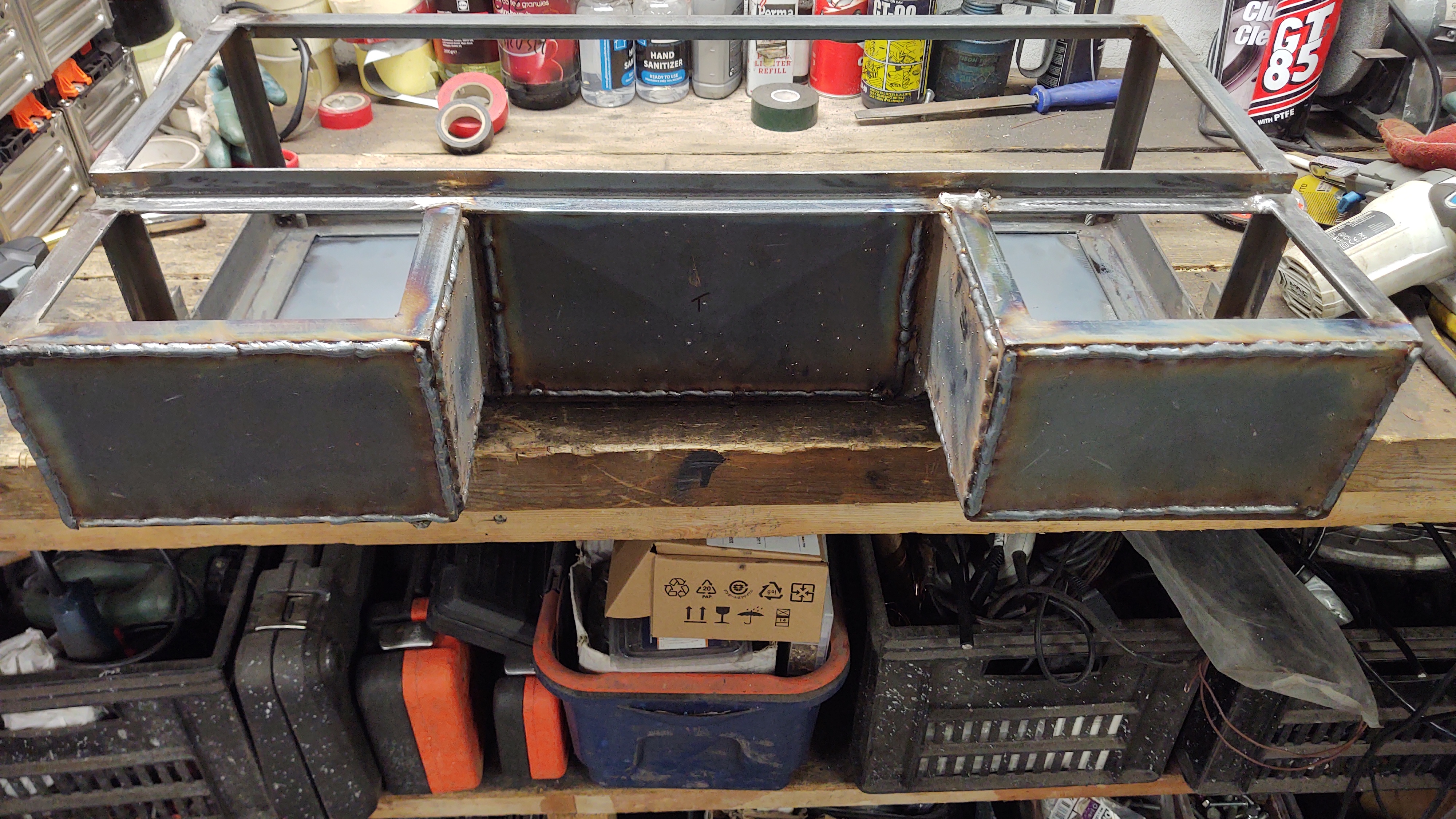

They need a bit of grinding before the next stage of course. ;)
I'm thinking of investing in a new welder torch and hose as I find mine is very inconsistent. One second it is welding beautifully and the next it is spluttering and making terrible welds and the only reason I can see is I'm at a slightly different angle.
Any thoughts from you welders?

What welder do you have? I had a cheapy Clarke Welder for a while and that was never all that good. Got given a similar welder last year but it was from the 90s and seems to be a little better quality. The Clarke Welder is just used for gasless welding now in situations where we don't have time to wait for the wind to die down and we can't get it inside to weld.
I found investing in a good welding helmet also helped me improve allot. Turns out it really does help if you can see what you are welding! I do find myself on the R-tec website allot looking at the AC-DC tig welders though.

It's a Clarke EN160 gas/gassless so not the cheapest but not the best either.
I have a good helmet which makes the world of difference to what I can see but it doesn't help when the welder is spluttering.

First of all, make sure you've got a really good earth clamp connection to the workpiece. Check your earth cable connections, all of them, right back inside the welder too.
The Clarke MIG welders are, or certaonly were, pretty good budget units.
If the transformer actually has enough Iron and Copper to perform well, then the performance comes down mostly to wire feed.
The hobby welders usually have a permanently wired torch, that will use a plastic liner. The wire not feeding smoothly through the liner is often a cause of trouble. You should keep a comple of replacement liners on hand and try a new one when you're having trouble. Make sure you prevent the reel of wire from rusting, the quality of the Copper coating on the wire makes a big difference, but keeping it very dry is the best solution.
Replacement hobby torches are surprisingly expensive. Fitting your welder with a Euro connector and industrial torch can help quite a bit. They use a spiral wound steel liner and feed much better.
The term MIG (Metal Inert Gas) is rather misleading. When you're using CO2 as a shielding gas, it decomposes in the arc and actually generates additional heat, which helps low current welders. The correct technical term for the process GMAW (Gas Metal Arc Welding). You get quite a lot of spatter with CO2 and an upgrade to an Argon/CO2 gas mix should result in much cleaner welds.
I've heard reports that "Pub gas" CO2 isn't always as dry as it could be. It's not going to affect the beer, but could give you grief when welding.

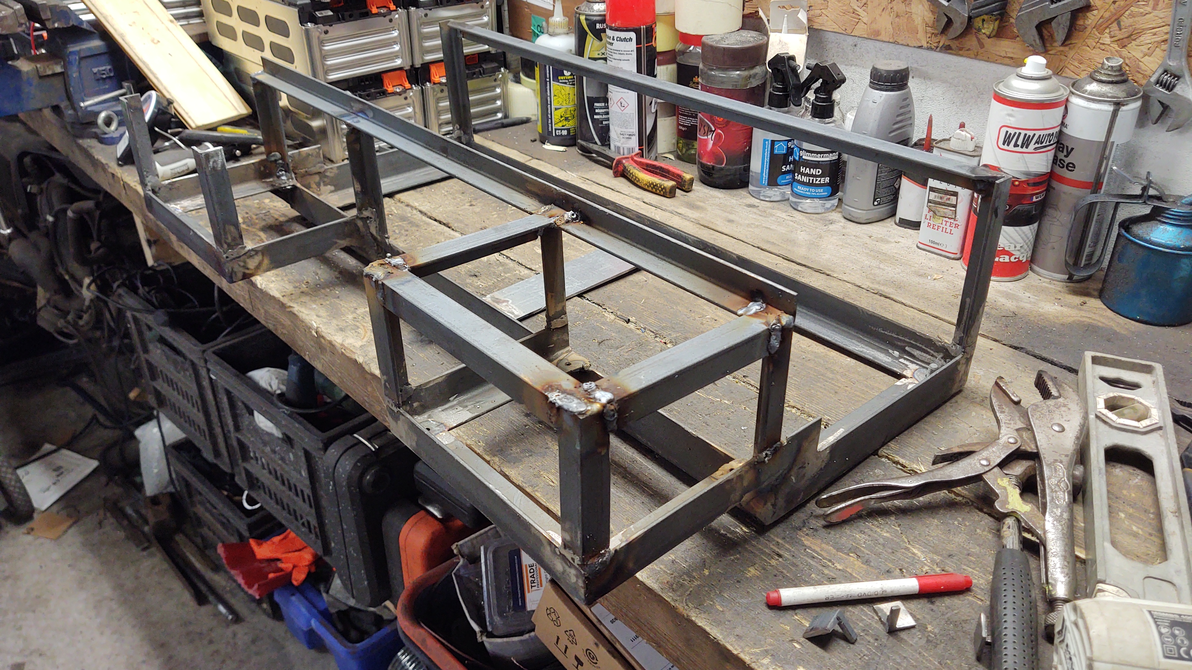

This is it after another couple of hours.
Now to start the cladding.

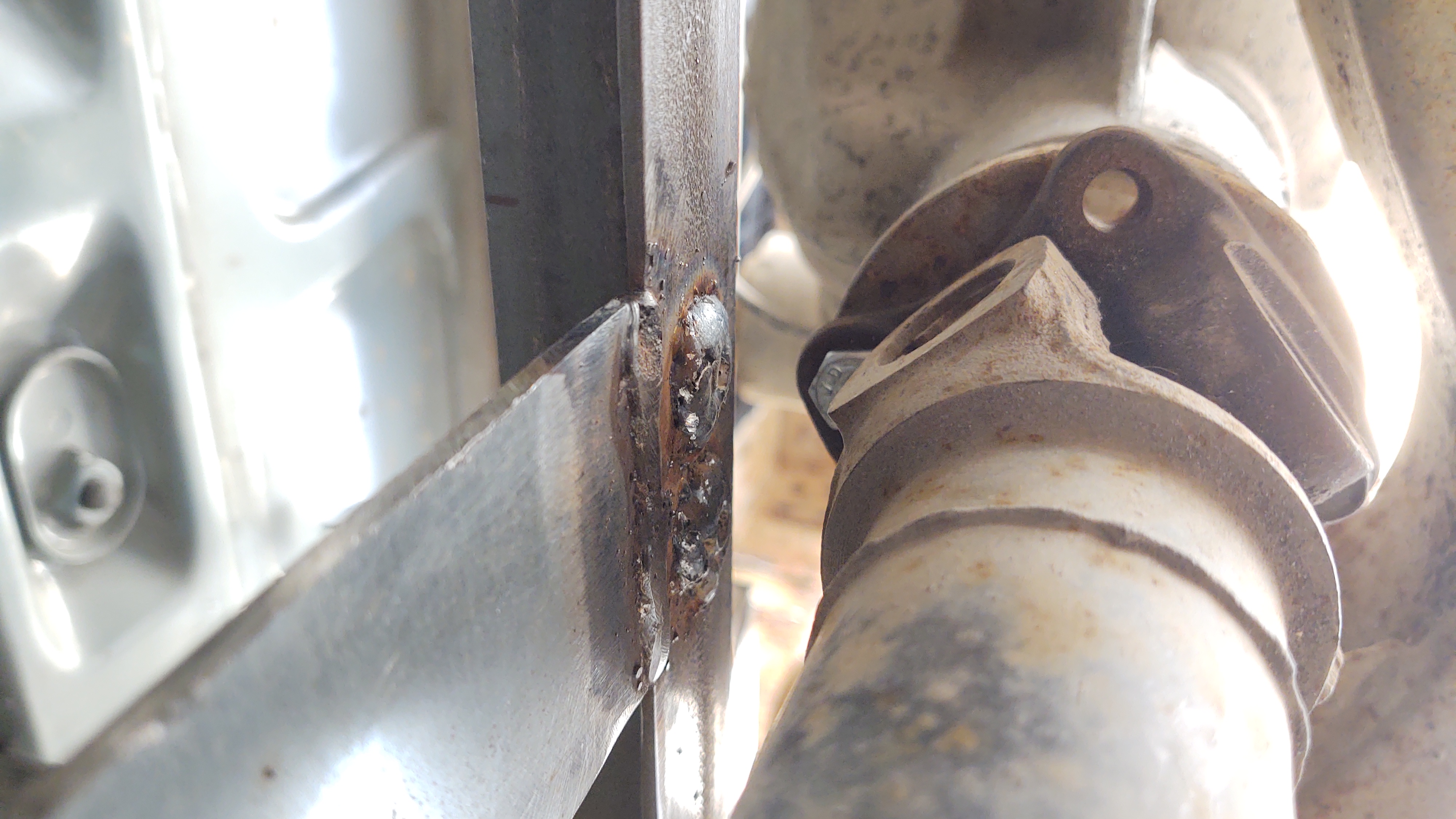

New earth lead fitted with a 400A clamp and 25mm2 cable. New Euro torch adapter kit on the way. I'll report back when I get it fitted.

Euro Torch fitted and welding is now only poor because of me, not terrible because of me and the welder.

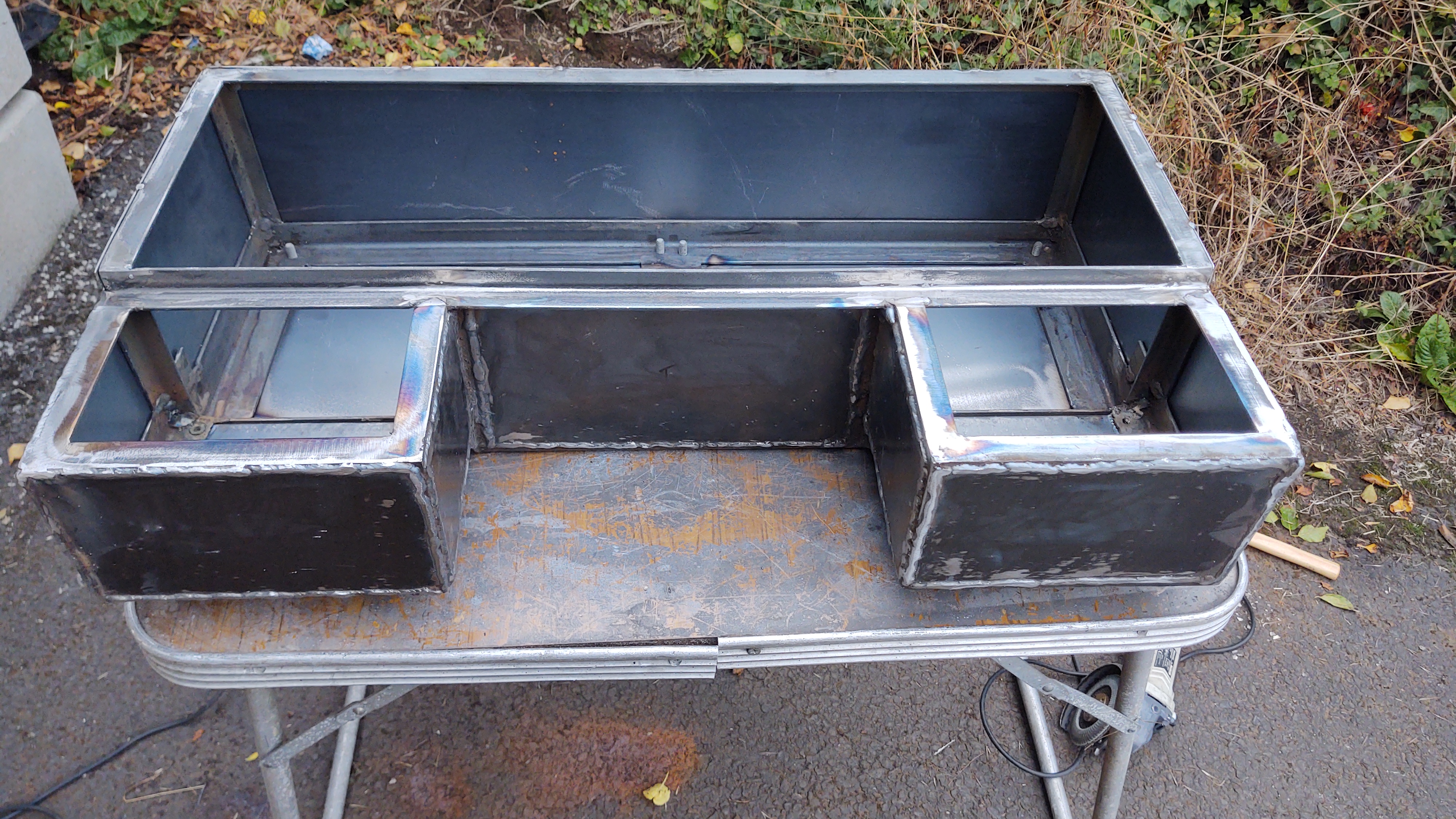

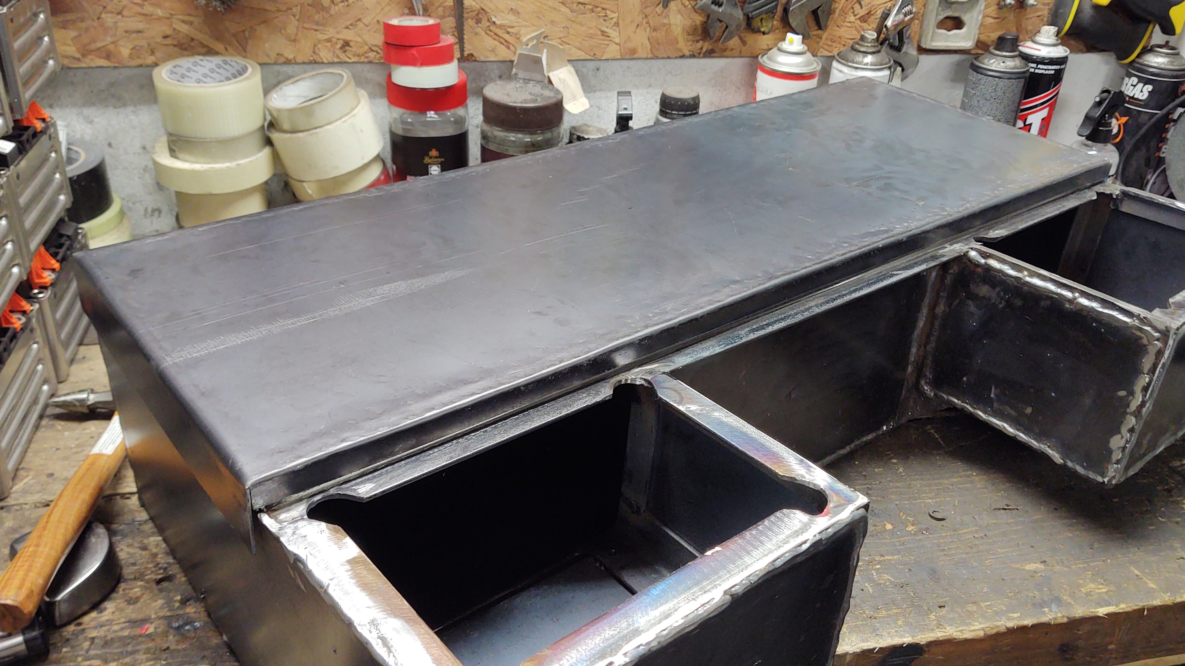

With the welder now working properly I got a lot more done to the battery box.
Then made the lid

The battery box is now painted and I'm now officially board of battery boxes so I decided to try and mount some of the stuff required under the bonnet.

Cool! Really like how you made the L-profile and hammer bend on the lid.

I think I have room for two large modules on this level with maybe two more above and two below but this is still to be confirmed.
In the pic below I have an alternator in the approx position I plan to have it. The idea is to use it to drive the Freelander PS pump with a short belt using an ebike controller and 48V battery. This might prove to be a dumb idea but I'm going to give it a go, it seemed to work well when tested being much quieter than the Zafira pump.

Is this also going to be 3mm angle iron frame?

JaniK wrote: Sat Sep 11, 2021 6:13 am Is this also going to be 3mm angle iron frame?
All the angle I have is 3mm but some is wider than others so yes the frame will be 3mm angle.
I don't think I need it to be quite as overengineered though and may not have a complete skeleton. I might try to cut out the box in a single sheet and bend it at the corners, a bit like a cardboard box is made from one piece.
Having said that having a battery box at the very front of the car is not ideal from an accident point of view so it would be better being stronger.
I'll probably just make it up as I go along like usual. 8-)

Alibro wrote: Sat Sep 11, 2021 8:29 am .....
I woul propably atleast not make the front box "flimsier" than others.
Making up along the way is nice if ideas come to life.
