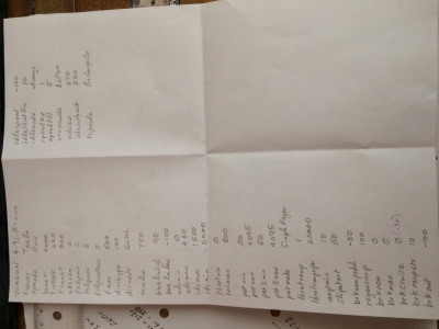

Hi Johannes. I tried your suggestion, sadly it didnt provide regen. I have my settings here in case something else is inhibiting regen.
Please excuse the settings via picture, I must work out how to copy them to PC from my mobile. Thanks once again. Peter

Update. Setting throttlemin to -100 and brknompedal to -25 (regen rate varies with value) allows me to have regen via brake pedal but pot2 doesnt seem to provide a variable regen. Investigation continues... :-)

maybe it's because your brkmax is at zero?

Solved the issue, thanks to all. Settings as per Johannes suggestion and kept throttlemin at -100. Set brknompedal to -45 (in my case) and made sure pot2 min value was below the minimum value of the pot.
