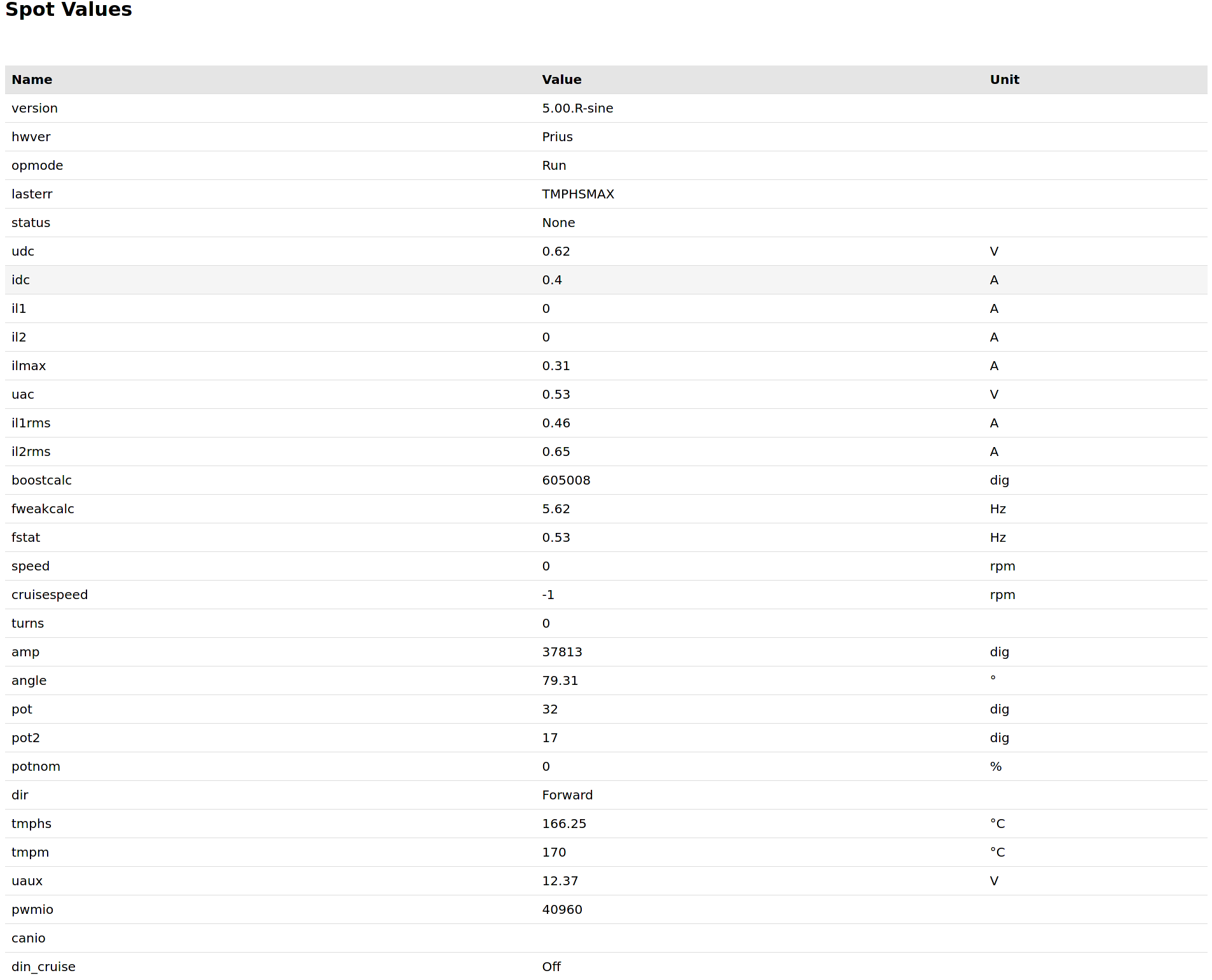

I have a prius gen 2 board wired up and ready for a test on real hardware (inverter).
Before doing that I want to verify that everything is working correctly.
I have it on the bench, powered with a 12V PSU. See parameters attached. I can start the inverter in manual mode, however get opmode returns 1 and in the Spot Values I can see opmode is run and not manual run.
I probed all pins of the 12pin connector, and none have a PWM signal.
Is there anything I am missing?
Thanks!

start pin constantly high? Also set udcnom=0 for testing.
Re: Prius Gen2 bench test
20pin connector only has +12 and GND connected, I can see that my opmode switches to RUN when touching +12 to the start pin.
I'm getting the following error msg:
[97950]: DERATE - TMPHSMAX
thmphsmax is already maxed out to 150°C , but tmphs is at 166.28°C
Got around the tmphsmax by hard coding it to a random value within limits and recompiling the FW.
I still can't start the inverter in manual mode.
error memory shows
STOP - DESAT
I can get opmode to 1.0 by holding start pin high, but still no PWM out. Starting inverter in manual mode won't change opmode (stays 0)
error memory shows
STOP - DESAT
Have you connected ALL inverter pins on the 12 pin connector? That will give you a valid temperature and remove the DESAT error
This test was board only (no inverter connected). I wanted to verify the output on the bench first, before connecting it to the inverter.
I was hoping that there is a way of testing outputs without inverter, but I guess it's easier to test with the board connected to the inverter ...
- Been thanked: 1914 times
oh ok. Well then connect a the desat input (MFIV) to 6V or more.
