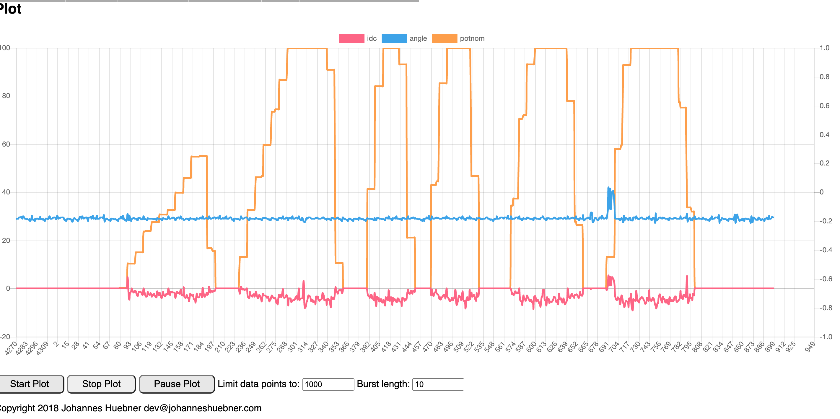

Re: VW - Beetle 2003
Pot Plot from VCU:
Savvycan says:
Average inter-frame interval: 46.758ms
Minimum inter-frame interval: 9.966ms
Maximum inter-frame interval: 4.29496e+06ms
Any ideas/suggestions?
Pot plot from Inverter
Still think I'm having can bus issues, it's set to 10ms in the VCU.Savvycan says:

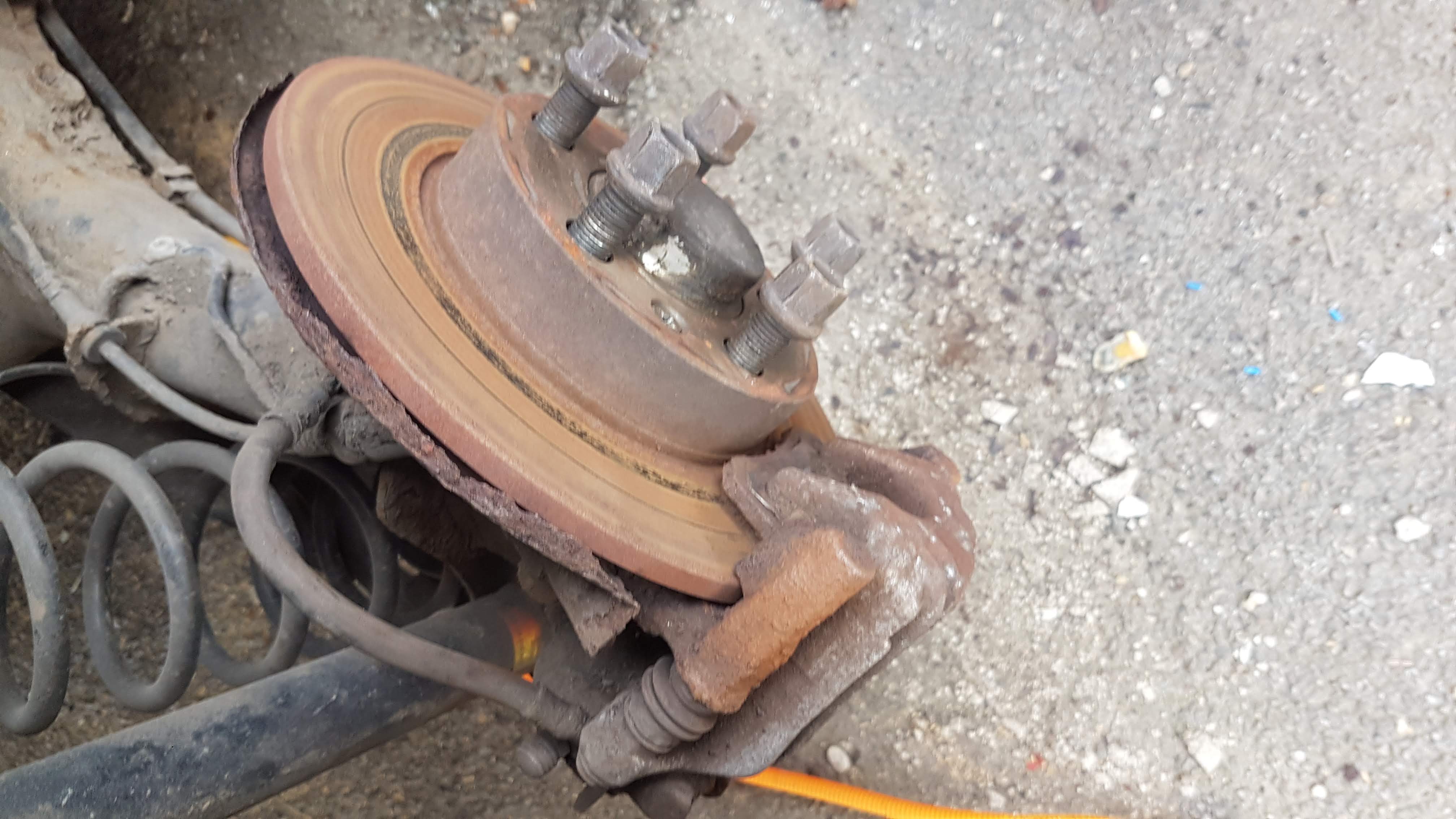

Motor is spinning again, not sure why, but also got the rev counter working.
I checked the MOT history and just before I bought the car it failed:
"Rear Brakes imbalanced across an axle Axle 2 (1.2.1 (b) (i))"
"Offside Rear Service brake excessively binding (1.2.1 (f))"
So I'm awaiting new pads and discs to be delivered, hopefully that and cleaning up some corrosion on the calipers will sort that. While there, I noticed some corrosion around that also needs addressing and a patch welding in on the sill.
