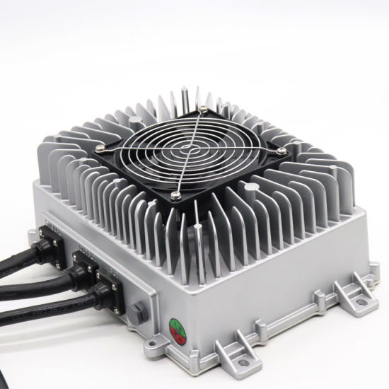

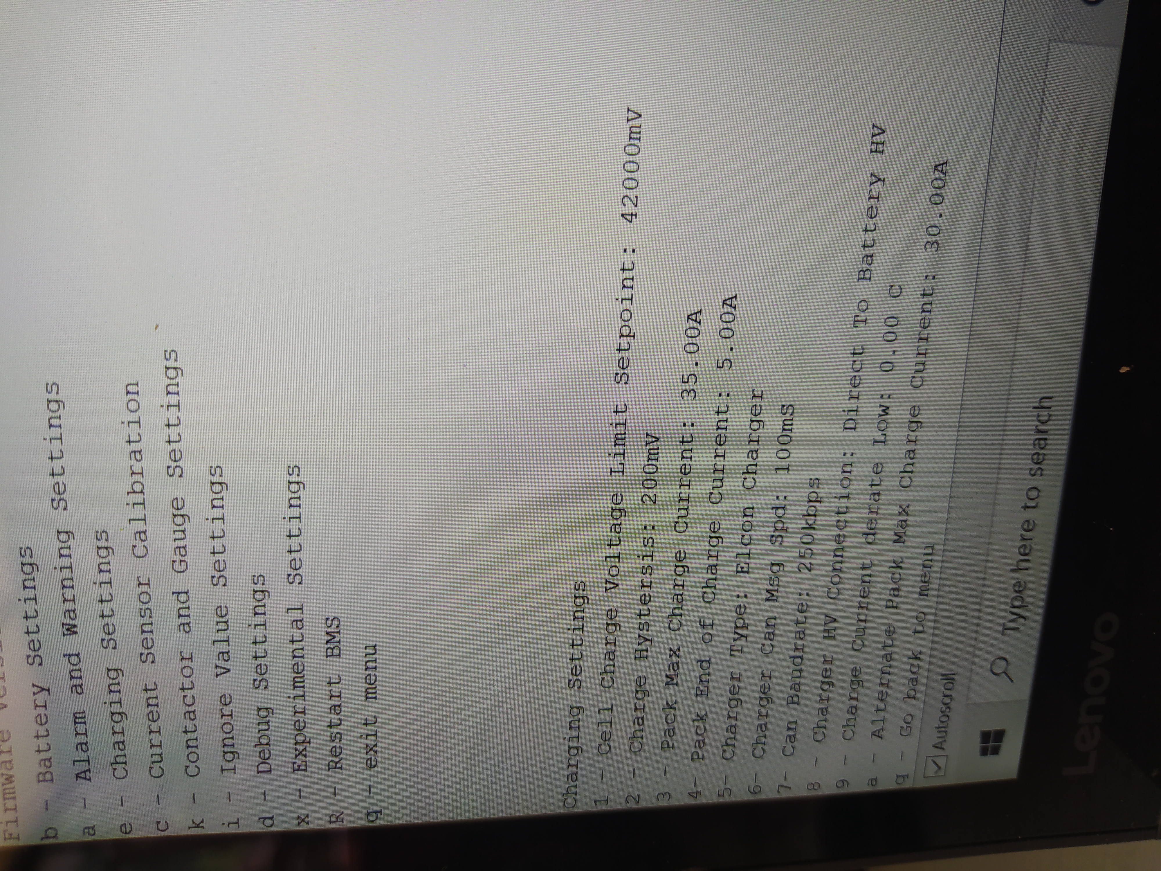

Got my SIMP communicating with my "elcon" charger. The charger flashes red and the fan kicks in but there is no output whatsoever... tested with clamp meter and is reading 0A also no voltage whatsoever. The simp is happy and believes its charging.
I ordered an Elcon UHF 3.3kw charger from evlithium and after 4 months they sent me out a knock off basically and refused to replace it with a genuine elcon charger. be careful of this company!!!..apparently the can comms is identical to the elcon and it is communicating. Evlithium aren't being that helpful, I presume it must be a fault with the charger itself perhaps an inboard fuse has blown ?
Modules are tesla x 4 serial. currently sitting at about 88v.
please see image charger, the information on it is terrible/non existent!!
Also my settings...
Many thanks!

why is cell votlage limit set to 42000mV instead of 4200mV?

tom91 wrote: Mon May 31, 2021 10:22 am why is cell votlage limit set to 42000mV instead of 4200mV?
not sure have put it to 4200mv now.
on the main screen its saying no charge current limit set but it is set to 35A on the charge setup...also the CP current limit is fluctuating quickly from zero up 4000A in a random fashion.
BMS Status : 3 Charge | AC Present | 24
Out:0010 Cont:0000 In:0010 Charge Current Limit : 1 A DisCharge Current Limit : 400 A CP Current Limit: 1800A No Charge Current Limit

Looks like a TCCharger, they should work fine.
This is a long-shot, but try setting param 6 Charger CAN msg spd to 1000ms (1 sec).
LE: is it flashing only Red? or combination Red/Green?

Please leave the CP input disconnected for testing. What do you have connected?
If nothing is connected please tie this input to 12V.

tom91 wrote: Tue Jun 01, 2021 12:11 pm Please leave the CP input disconnected for testing. What do you have connected?
The CP is connected to pilot out from simp charge via a 5k resistor... this pin appears to be getting voltage once charge has initiated but the voltage isn't steady... around the 3v .
OK so i pulled the CP pin all together and now getting a nice 30A from the charger!! SUCCESS IT WORKS! but what about the CP line? what is its purpose? why was it stopping the charger outputting...

Jackk wrote: Wed Jun 02, 2021 9:44 am
Thanks!!
The manual states this feature is still under development. I have not yet had time to fully finalise it. The CP line is a PWM signal used to determine the
maximum allowed AC current the charger can draw. The biggest challenge will be getting it reliable, as it will be some what susceptible to noise.
