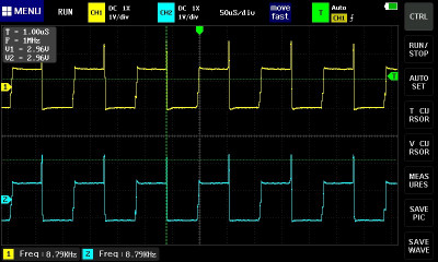

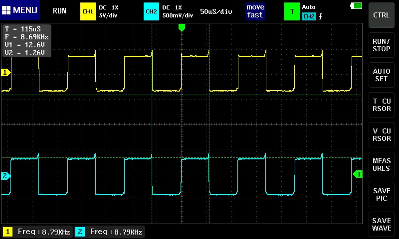

Hi again everyone, It seems that I had more than one problem with this - and many thanks to all who offered advice.
The first thing - I bought a new scope - one that gives me proper waveforms. Then I found there was no output from one opto-isolator.
I replaced that and it works (but I messed up a couple of solder pads doing it. I'll need to replace the board for the final job).

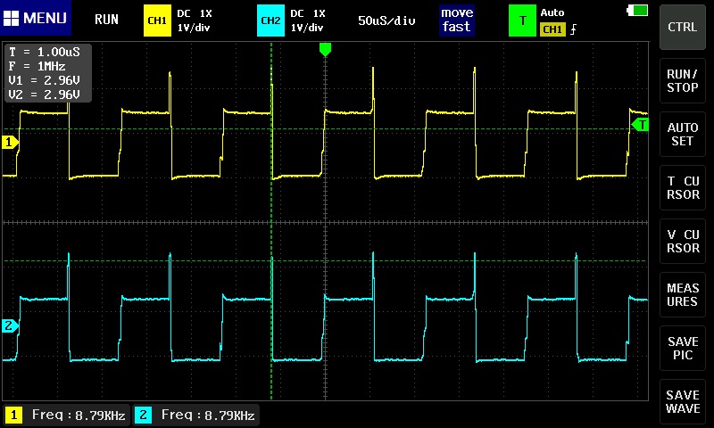

I now get 6 lots of square waves from the driver boards..... but.... there's no dead time between the top and bottom outputs - even though I set "deadtime" to various values up to 200. I get the same sort of wave from the Igbt bus even with no voltage applied. Applying 12v to the bus, I get stable outputs on the phases (still no deadtime apparent on scope). I'm obviously doing something wrong here. I've posted some screen shots of traces. Comments please. Thanks....Steve
A). from driver output,
download/file.php?mode=view&id=9255
and B) from phase output using 12v bus.
download/file.php?mode=view&id=9253
- Posts: 5791
- Has thanked: 157 times
- Been thanked: 1025 times
Re: Ver 2 and Enova Motor
The bottom output should be inverted to the top output. I don't think you're scoping right. Also at that time base it will be hard to see dead time.

Hi johu, thanks for your quick response. I'm still learning how to use this scope, so bear with me. Maybe I need to trigger differently?
I'll check a different timebase to give a better view. Thanks for your advice ..... Steve

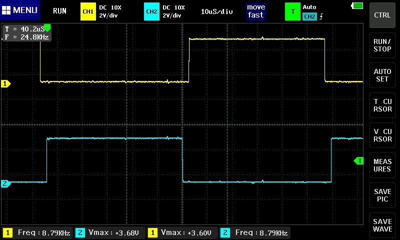

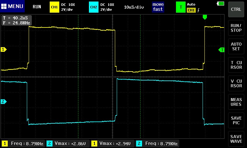

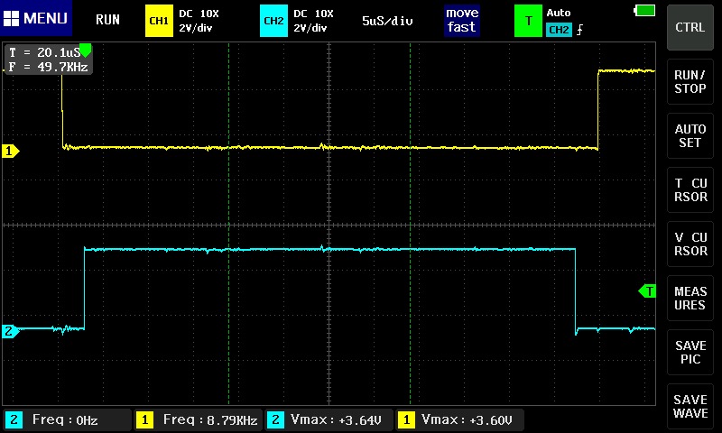

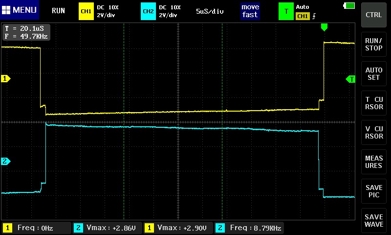

Hi johu, I've looked again at the traces for the driver boards. Traces are similar for each board and this is what I get -
1st. 2 pics Driver Board Input at 5uS and 10uS both 2v/div.
2nd. 2 pics Driver Board Output Top/Bot Gate.
From what you say, this is what I should have. I think I see deadtime in operation here.
Thanks again for your advice - now more testing..... Steve
