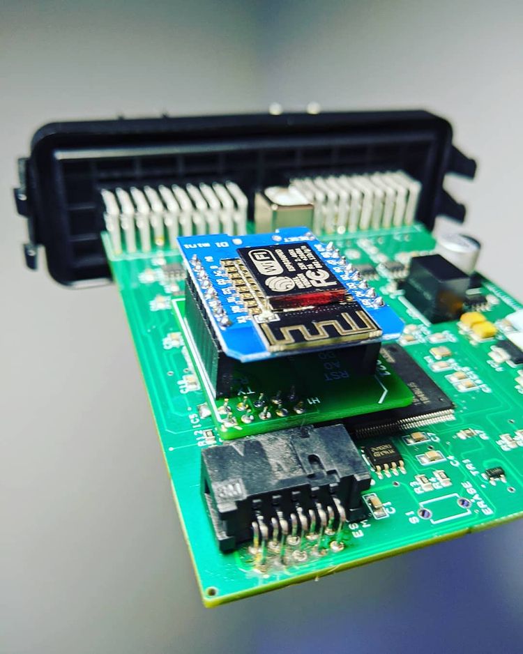

WiFi module update Got 50 more of these little adapter boards in for anyone that is struggling with weak wifi signal with the OLIMEX esp boards. Allows using the more robust WEMOS D1 type board. They are available for 10US (incl. shipping) in the USA, or 18US shipped to EU.
