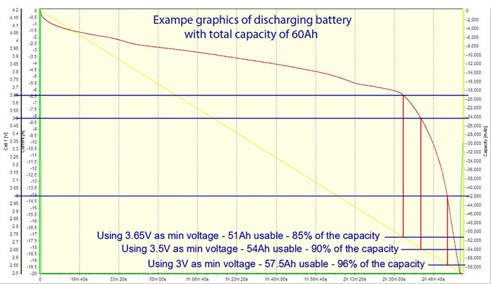

ZooKeeper
Posts: 507
Location: USA
Re: Uggh! Too many options = brain fog
Post by ZooKeeper »
Bratitude wrote: Fri Apr 23, 2021 9:45 pm I’d set your max cell ceiling to 4.18 when you really need the full range. 3.8v majority of the time.
I did some more digging, this time for photos and found the attached. Seems like lower than 3.5 and I'm off a cliff and marginal benefit much over 4.1v. This would put the center point at 3.77v (3.75 nominal is often quoted) and agrees with some LeafSpy data suggesting 4.17v is a 100% SOC number. That means, for 40 modules, the pack voltage should be 332v when "full", or as full as it needs to be.
That should work well with 4.03v zeners, which would result in 322.2v on the pack, suggesting a 320-325 volt upper charge limit will not overcharge anything. Turtle mode should come in somewhere around 3.6v/cell or 288v.
